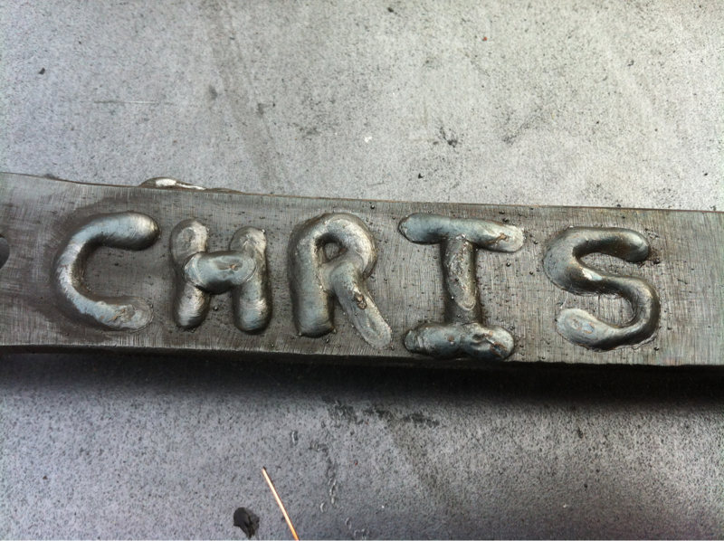

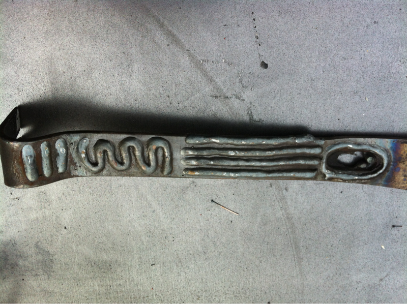

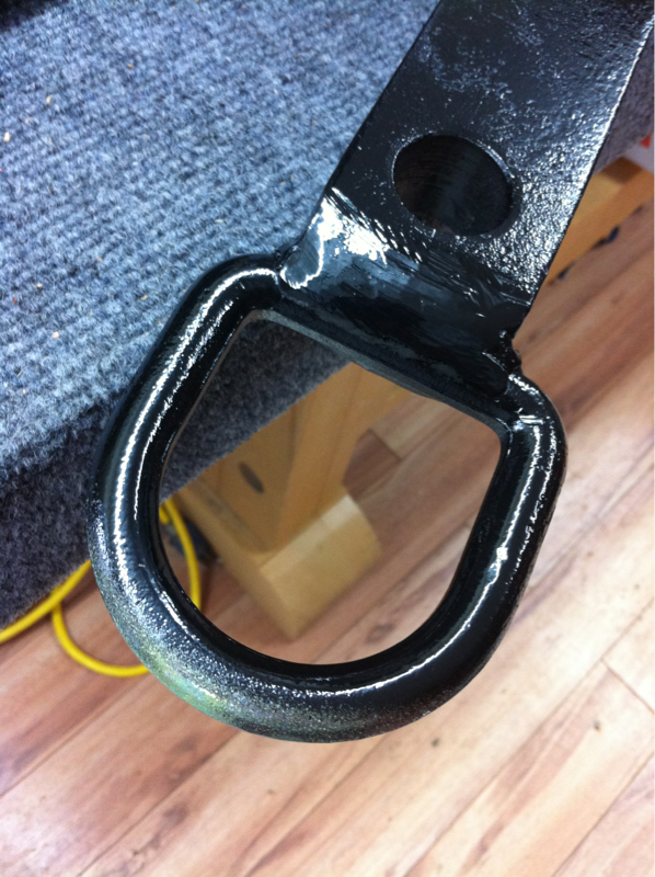

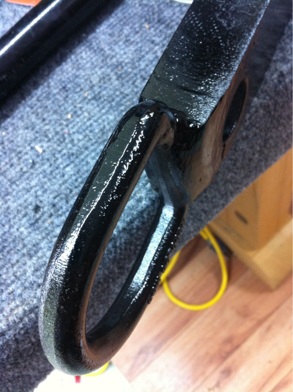

So I haven't done welding of any sort for 25 years and had never done arc welding of any kind. A month ago I picked up a Lincoln 180 and a tank of c25. I watched a million videos online and dove in. So far I have used up about 4 lbs of .030 MIG wire. That is my entire mig experience.
I follow the feed/voltage chart on the inside panel pretty closely and much to my surprise I was making ok welds within 10 minutes. When I say "ok welds", they look ok to me. :). Can't be this easy????? Honestly, I don't have a clue if my welds are good or not. No idea if they are structurally sound. How do I tell?
Here is a couple pics of some practicing I did on a 3/16" thick pry bar. Can you guys tell me what you think?

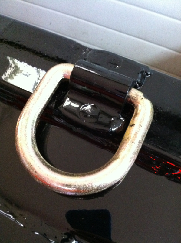

Also a d ring I attached to my bucket.
Cheers.
Chris

/ Please scrutinize my welds.
#2
Drawbar. 3 passes per side.

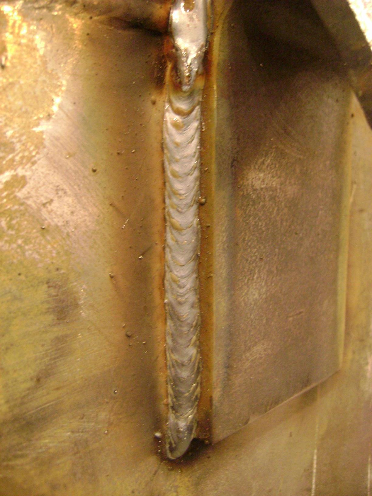

Here's a vertical up Mig weld I made with Lincoln's L-56 wire. See how hot it's burned in? For structural Mig welds you want to run as hot as you can handle it! ;)
Shield Arc said:
I'd throw that chart away! The welds in the second picture are a little cold, (or your travel speed is way to slow). Back off on the wire speed / amps, or turn up the volts.
Here's a thread I did on testing Mig welds. Did other tests you might be interested in too.
http://www.tractorbynet.com/forums/welding/212146-mig-break-test.html
Thanks so much. So when you say "cold" you mean poor penetration correct? So wouldn't I have to slow down my travel speed or turn up volts or both???

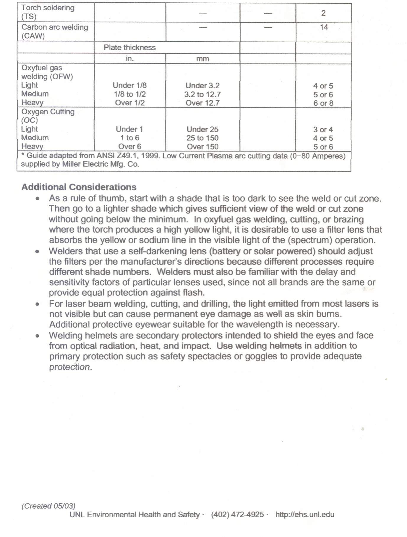

Also, I have a # 11 filter. I feel like its a little too dark. What can I safely use??? 9?

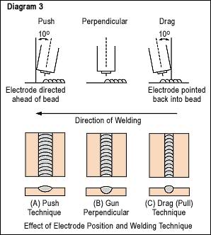

/ Please scrutinize my welds. #8

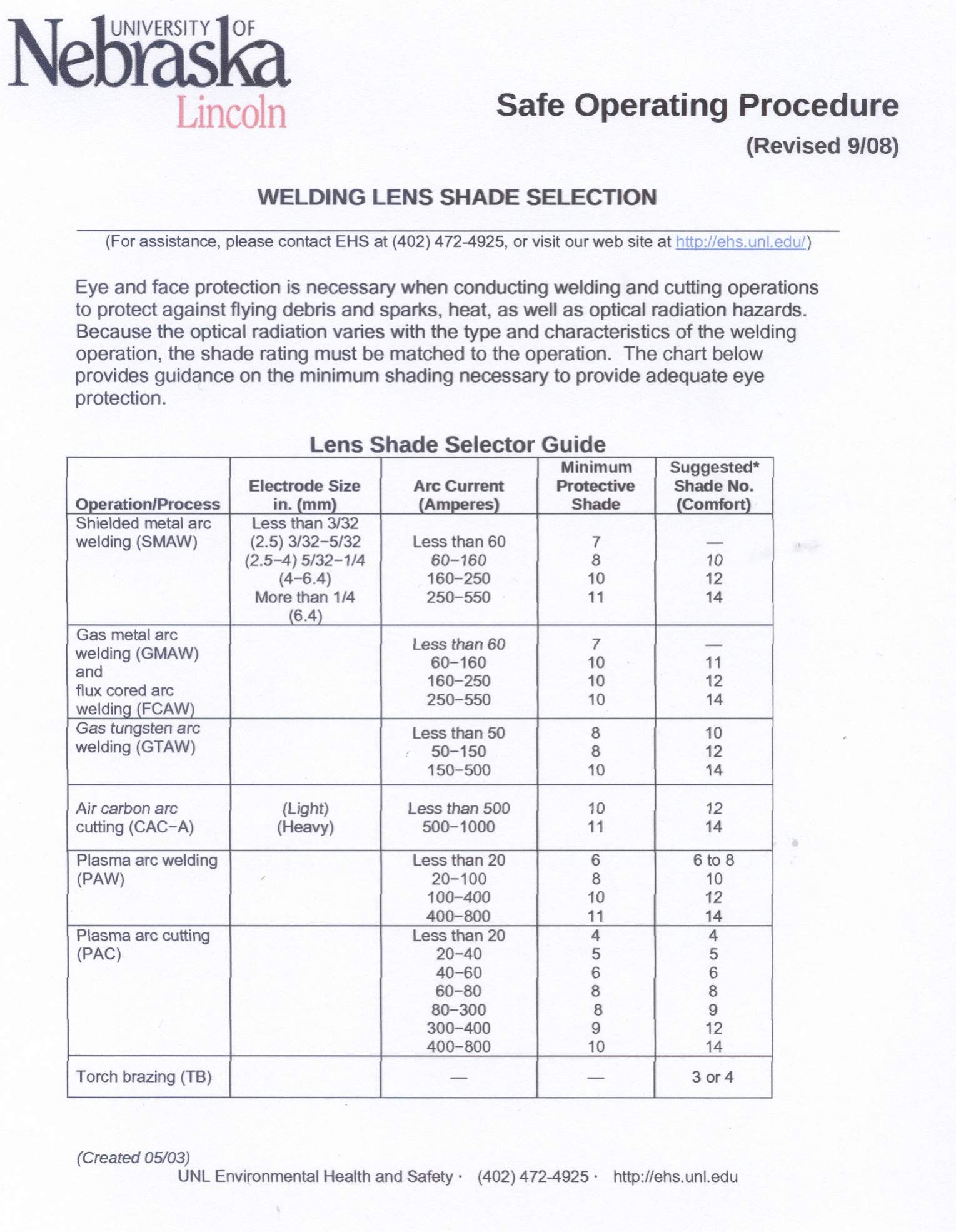

Cold as in too high of a profile / lumpy.
I use a #10 lens for most all my welding now a days.
But here's some charts for you.

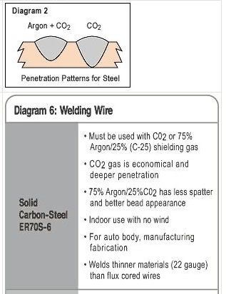

/ Please scrutinize my welds. #18
Over all I would say he is correct as you have cold laps the length of the weld, this typically means poor penetration as well. Also keep an eye on your start stop points as puddling (Craters) can lead to crater cracks which will resemble a star like pattern in the middle of the puddle. Look over your draw bar ring as I cannot clearly resolve it very well without an actual eye on the item, but if your cold and lack sufficent penetration, you will typical bridge the root,this will be evidient looking at the end of the weld (cross sectional).
Think of a weld as something you want to be very uniform on the surface, small ripples are fine providing they are tight. What happens is tensel stresses run up and down the length of the weld,and if you have abrupt changes, those stresses tend to focus on that point, and present a weak point in the weld. Also be sure to keep arc strikes, and spatter off the weld and out side the heat affected zone when you clean it up as these will also direct tensel stresses to those areas, be carefull when using power tools such as right angle grinders and such as well as any notches will do the same. Typically is we can catch a finger nail on it (1/32") it rejectable, this mostly applies to undercut though.
It seems as if their are many here more knowledgable on performing the welding process than me as I am the guy many welders hate....
A Visual, Magnetic particle, dye penetrant and ultrasonic, ASME certified Inspector.
Stay at it...rust never sleeps.
