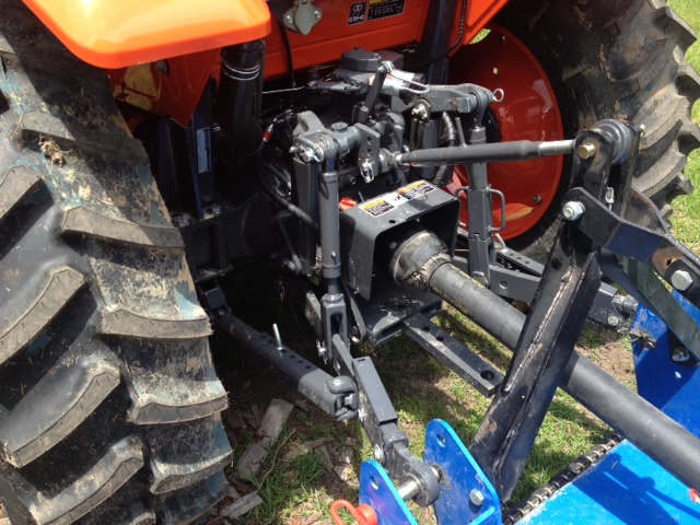

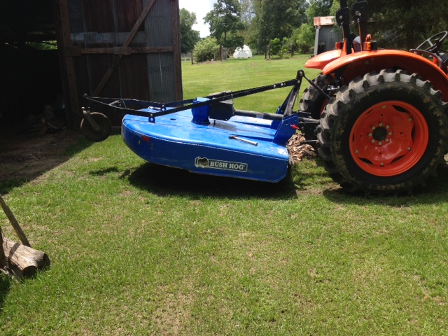

Hey guys,

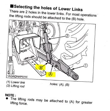

Got a brand new M5140 and when I attached my 296 BH cutter, I realized the 3-point hitch does't raise the cutter as high as my previous Ford 4610 did. It is set as it came from the factory. The lifting rods are screwed down as far as they can be and they are attached to the lower links in the "A" hole per the operator's manual. This is the hole that the operator's manual says is for maximum lifting. It says the hole "B" is used for most operations but it looks like if I used the "B" hole, it would not lift as high. I'm confused and not sure what to do. With 3 point lifted as high as it will go as of now, the cutter is maybe 14" off the ground and drags at every dip and depression the tractor goes through. Hopefully there is something I'm not adjusting right. Please help.

Looking at the pic, which hole are you using for your lower links? Hole A or B?

First, is your left hand side link collapsed all the way? Be sure that it is and then level out using the right hand side link.
Second, use the A hole.
If this is done, that is as high as you will get it using the OEM equipment without modifications, might be time for a hydraulic top link.

Yes, the side link is collapsed all the way. I'll change the hole location in the lower link to the "A" hole as suggested and see how much that helps.

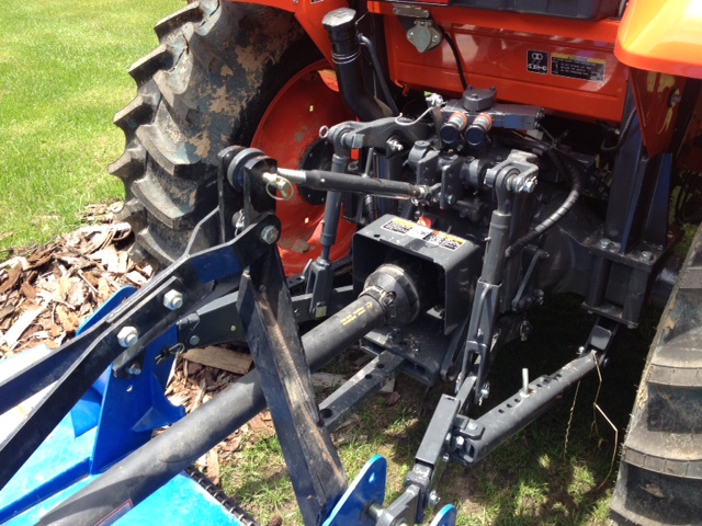

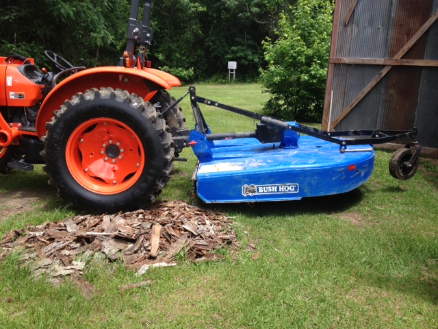

I moved to the "A" hole as suggested and it only raised it 1.5". The first pic is in the "B" hole and the second is the "A" hole AFTER I adjusted the top link for more pitch. Either way, my Ford 4610 lifted it at least a foot higher than this Kubota. There has to be something else I can adjust otherwise, I will be very disappointed.

Something is definitely wrong. :eek: You would not even be able to raise a rear blade at all. In fact you would have to have the top link retracted quite a bit to even get hitched up.
Contact the dealer and let them fool with it, that's one of the reasons of purchasing a new tractor. You've paid to have him deal with these things, inform him of the problem and have him deal with it, because it certainly is not right. :no:

From what research I've done, it seems that I need to adjust the feedback rod. Now, if I only knew of its location and how to adjust it...

On your top link of the three point;try the top hole(the picture has it in the bottom hole of the tractor)mine is in the top hole(L4240) and I don't have a problem.

That would give me even less range. I'm pretty confident that its the feedback rod adjustment. The 3 point doesn't even begin to lift until the lifting lever is over 3/4 of the way up. In other words, say the highest the lifting lever can go is 10, it doesn't begin to lift until after 7. 7 and below, the implement is on the ground.
Check out post #3. The rod is at the top of the left lift cylinder. Shorten it for more lift. Too short and the FEL doesn't work because the hydraulic pump will go into relief at the top of the lift (3PH lever all the way back).

How'd I miss that? Thanks. Hopefully, this is the solution.
Since I have rear remotes, guess I'll go ahead and get a hydraulic top link while I'm at it.
