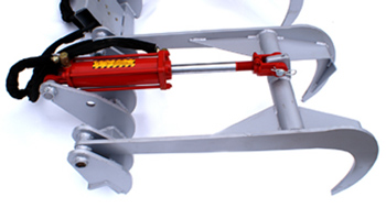

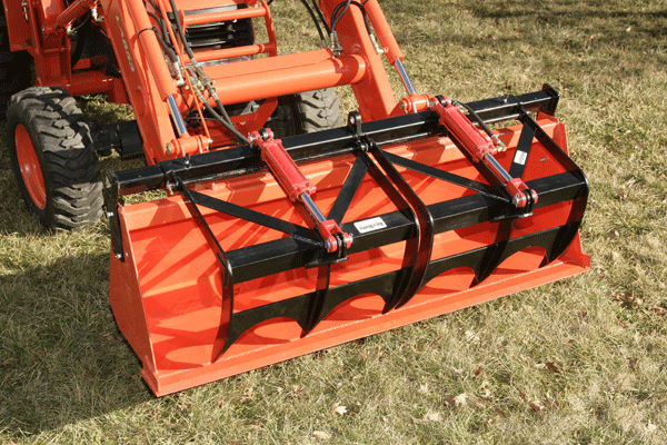

I am assuming that you are comparing something like this. It's like comparing grabbing something with two fingers as to grabbing something with the whole hand. Go for the full grapple .

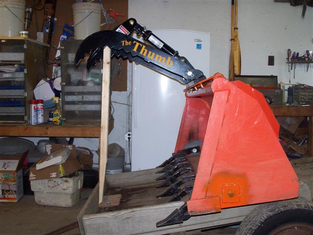

I added a thumb and tooth-bar to the bucket of my L4240 and that combo works fine for brush piles,may-be not as well as a full grapple but a little less money.

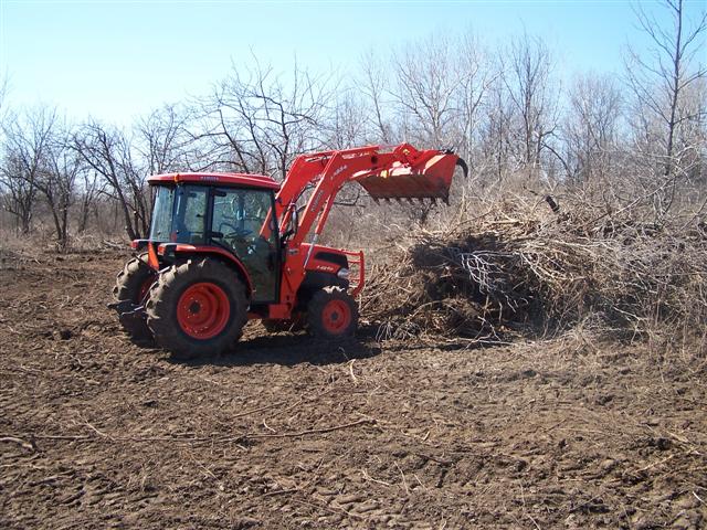

Another picture being used,we did 8 acres this spring.

Adding a welded or bolted on grapple to a standard bucket and controlling it with rear remotes is by far the least expensive way to go if you don't already have a skidsteer universal adapter on your FEL.
There is no easy way to quantifiably compare that set up to a true grapple but I'd guess that if having a bucket allows one unit of brush clearing etc and a true grapple allows ten units then a bucket grapple would come in around five. Not as effective as a grapple but way more effective than a bucket with hooks and chains. There are many advantages over not having any form of grapple and only a few real disadvantages compared to the grapple. A bucket grapple is not so good for carrying logs (sides get in the way) and you'd need to add a toothbar $$ to get much root digging done but otherwise you'd do pretty much the same work. Some advantages of bucket grapple too especially for carrying firewood and smallish rocks or sticks.

I've been considering one of these for at least a year: Add On Grapple
My problem is I keep talking myself out of it and the price keeps going up. Considering we're probably headed for some inflation in the next year and metal prices are going back up, I need to talk myself into it!
I already have a Toothbar and there's no way I can justify the cost or storage involved with a full grapple. It looks small enough that it would be easy to put on or remove by hand, but would easily double or tripple the load of logs or brush I can carry. Not to mention the manual labor involved with getting it balanced on the bucket. I already have an extra valve spool available from when I added a hydraulic "top" cylinder a while back.
