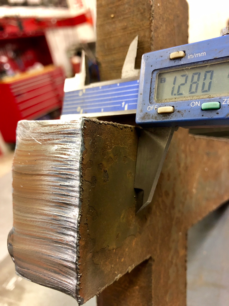

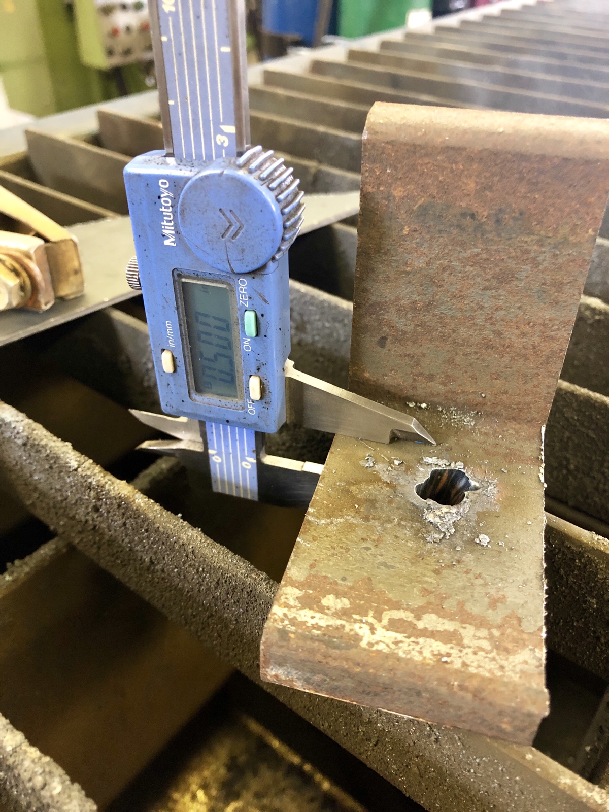

Victor Cutmaster 42 will cut 1/2" pretty well but would struggle to pierce. Not quite like the Powermax 45 will though. Back to the Killowatt thing again. I have a 42 and enjoy the low air consumption compared to my 82.
You got me wondering. I don’t think I ever had to pierce 1/2” so I tried it with my 40 amp Miller.
EZ PZ

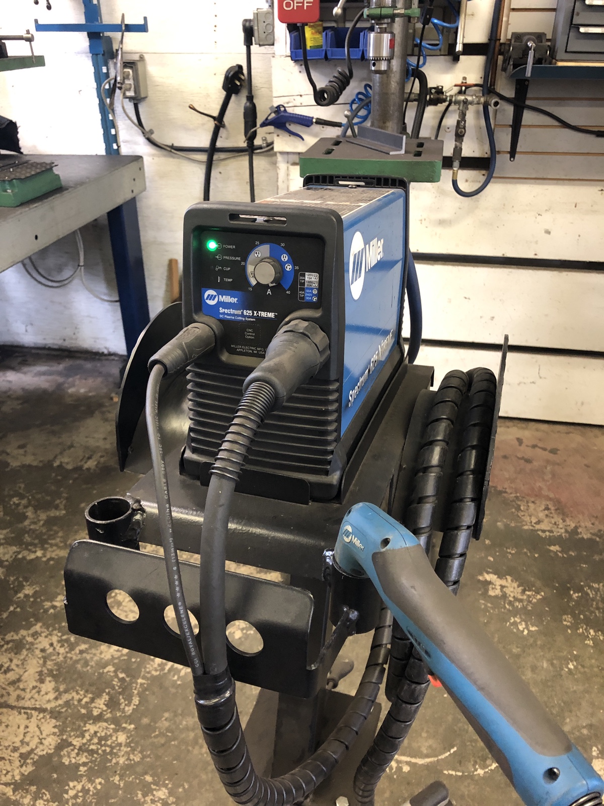

I don’t know about Hypertherm, but I don’t drag on 1/2” material with my Miller 625 Extreme.
I drag on 1/2” and 3/4” with mine, no issues. I used to have pics of some 1/2” I pierced then cut. Had a pic somewhere of two 1/2” plates stacked and (roughly) severed from an edge start. I don’t recommend that, it’s messy, slow, and pointless.
