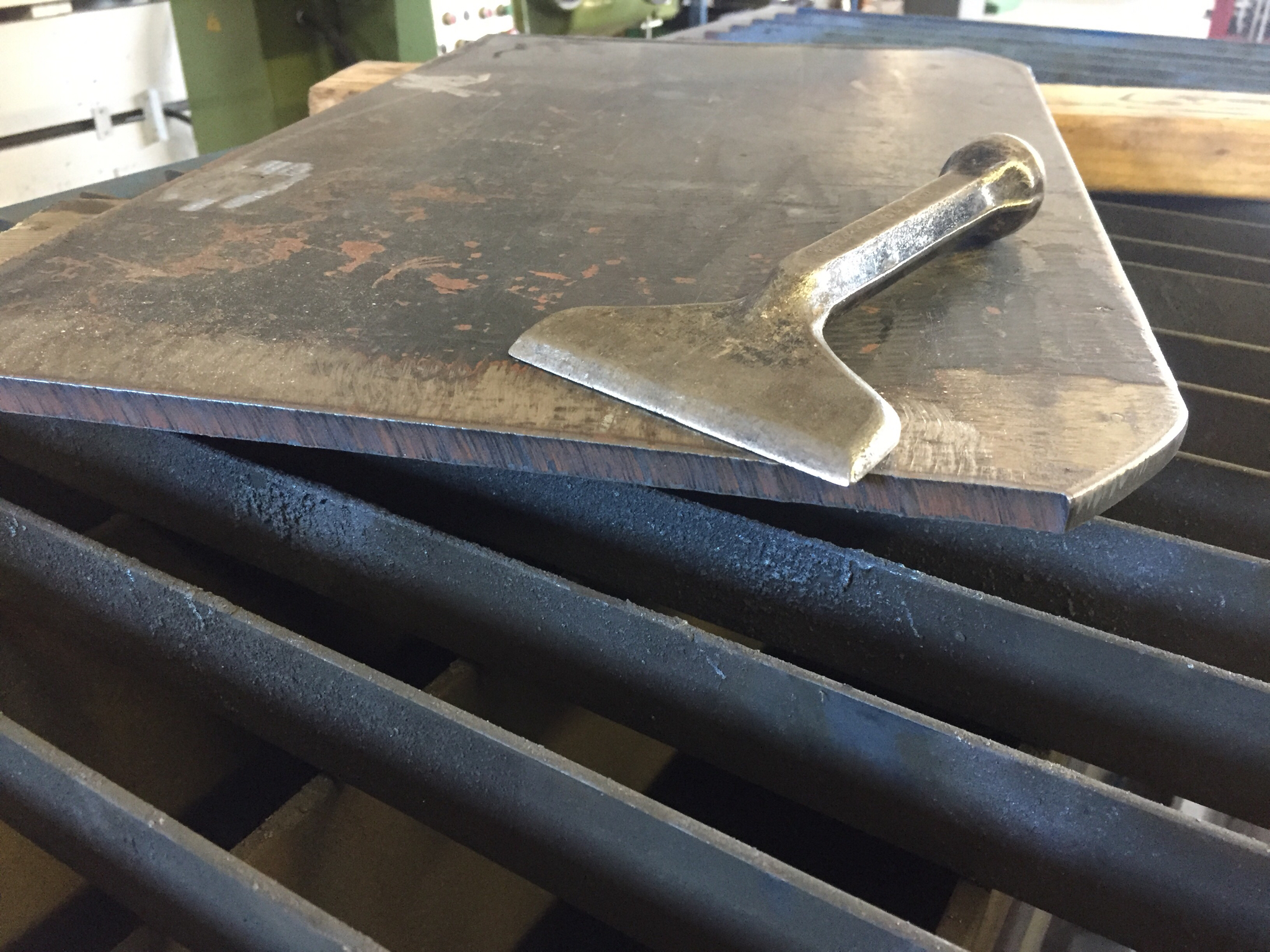

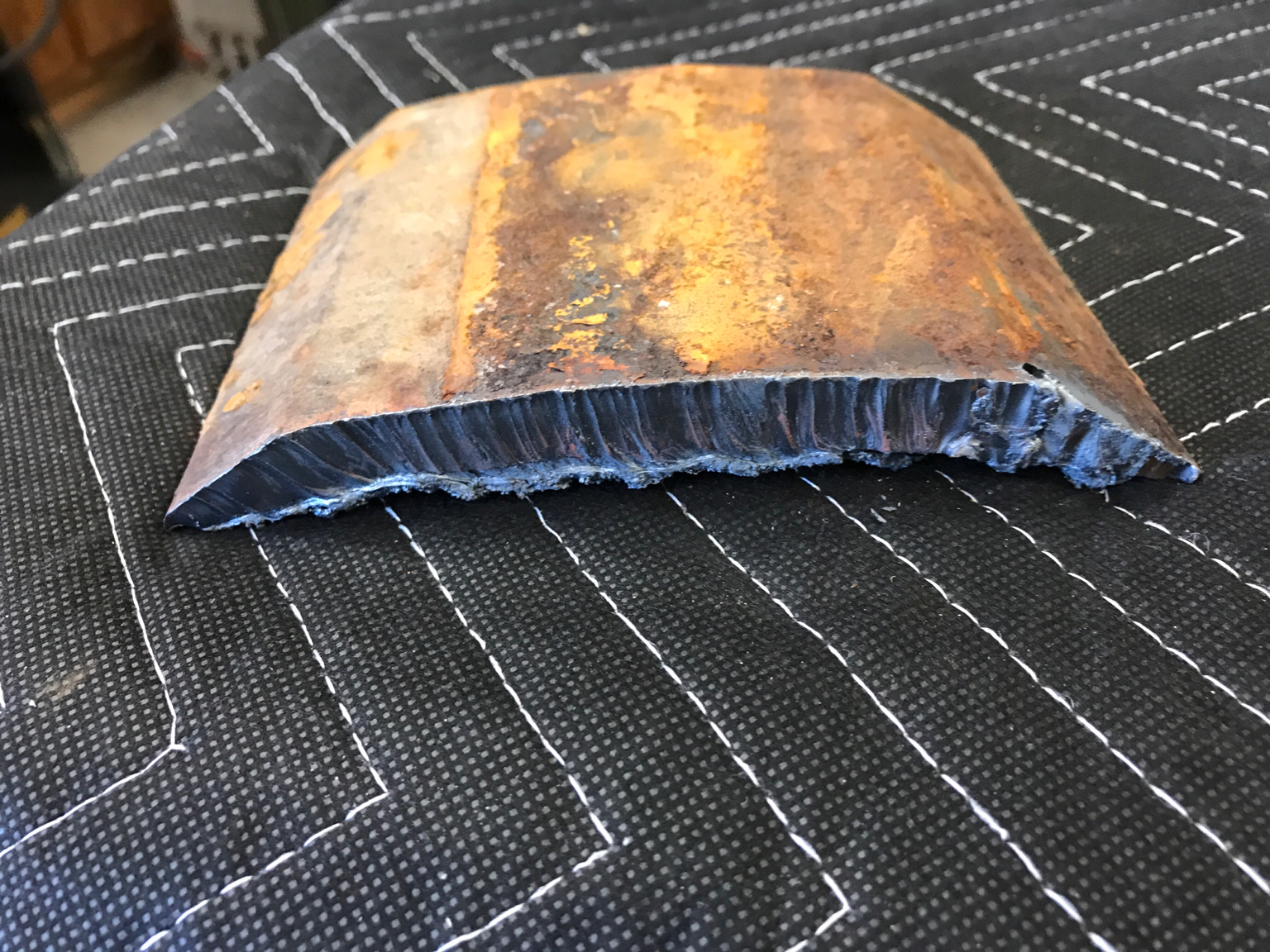

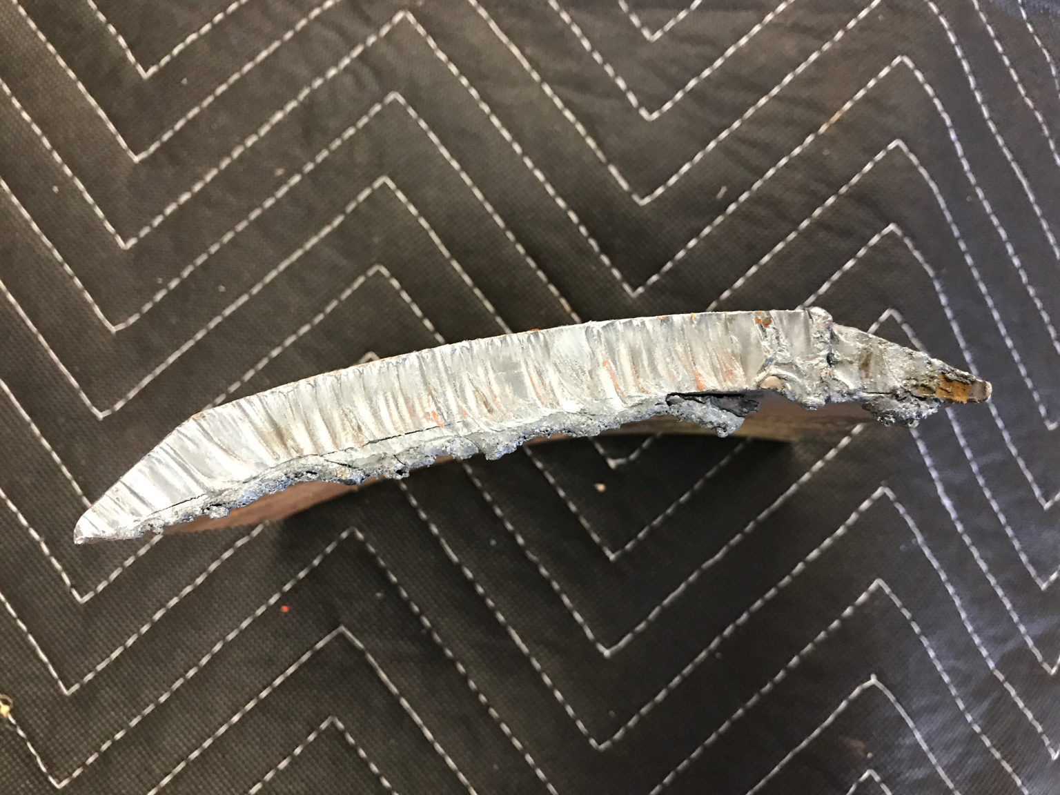

I took a picture of some material I have cut with my 45, top is 3/4", middle is 5/8" and bottom is 1/4".
The 3/4" and 5/8" could be cleaner if I had better hand control and slowed down a little. View attachment 504580

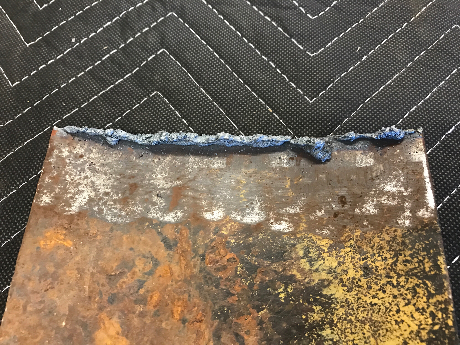

Today I was shortening my 6ft back blade to be more compatible with my BX. I ran into cutting problems when I tried cutting the cutting edge which is curved and tapered from 1/4in on the ends to 1/2in in the middle. At max power, and going as slow as I could, it wouldn't cut through in one pass when I reached the max thickness. After another pass I severed it, but there was heavy dross and a rough cut. I was using the standard drag tip and I estimate my speed was about 15in/min at 1/2in. The manual says max speed for 1/2in is 30in/min. Any ideas on what I am doing wrong?
Note also there was lots of paint and rust in the cut. At first I thought it was a bad/weak ground. I improved that but no difference. My guess is the extension cord is restricting power. I know the ext. cord is way undersized at 10gauge but I'm not running long cuts. And... yes this is temporary until I can properly rewire my shop adding a dedicated sub panel and several circuits for 110 and 220v outlets. Is the extension cord my problem? I am not tripping the 30amp breaker.

It's odd to me the number of people that are commenting on having difficulty cutting painted/dirty/rusty metal with their plasma. I have a hypertherm 45xp, and the cutter doesn't really seem to care about the surface condition - can't really tell the difference cutting painted or bare metal. Now, if you're trying to get a really nice cut with a straight edge, a rough surface will be harder to drag against at a constant rate of speed. However, for free hand cutting which is adequate for 98% of the repairs/modifications that I do, I don't have an issue.
If the rust is really thick, then it doesn't cut great with the plasma. However, I find that's even worse with oxy - since oxy actually burns the metal, doesn't just melt it like a plasma.
Tip condition and tip speed/angle are the most important parameters. With a new tip, I can get pretty decent cuts on 5/8" material. With worn tips, sometimes 3/8" is tough. And if I'm trying to get a nice cut, I run the torch along the straight edge etc before powering it, to make sure I'm in a comfortable position for the cut, and to make sure there are no rough spots that would mess up my travel rate.
Very nice cuts. I see nothing wrong with those. Using a Drag Tip? Using a Guide?
3/4 was freehand, 5/8 and 1/4 were with a guide I believe, I just grabbed a couple peices i had in the shop to show what the 45 can do on thicker material.
All were done with the std. sheilded/drag tip.
