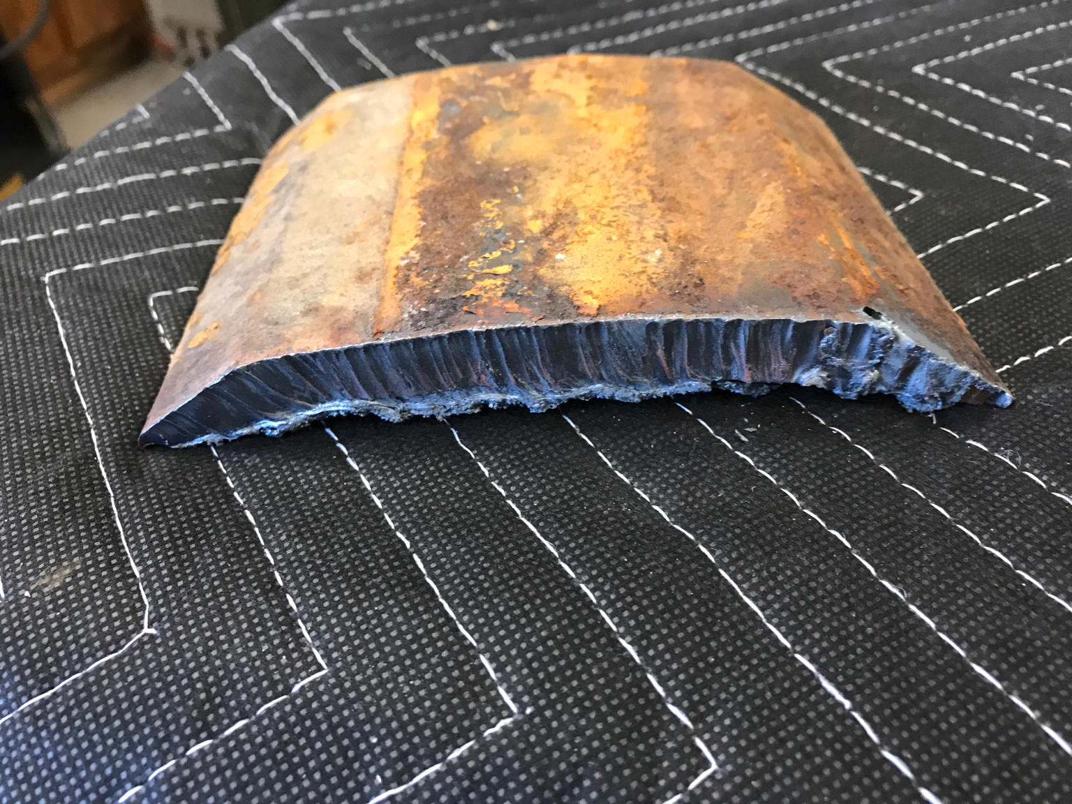

Thinking voltage. Here is the cut...
/ Plasma cutting - what am I doing wrong? #23
Will be interesting to see/hear opinions. Appears your speed is good. The cut is very rough though. Assuming you were using a guide?
I'm not qualified enough to discuss the slag. I actually don't worry about that too much.
Are you still using the same tip and electrode that you cut the blade with?

Remember that there are 2 types of Dross (slag) Low speed from too slow of travel speed and High Speed from too fast. Low speed dross is easy to remove and High speed dross is difficult to remove. Your pics are what normal hand held cutting looks like whan not using a stand off or guide. Most times the cuts like these are fine, Knock off the dross, Touch with the grinder and weld. Even with a flat plate and a straight edge you will get some dross because you will have a hard time keeping the perfect speed. The little ripples in your cut are simply motion. No Worries, Cuts look normal.

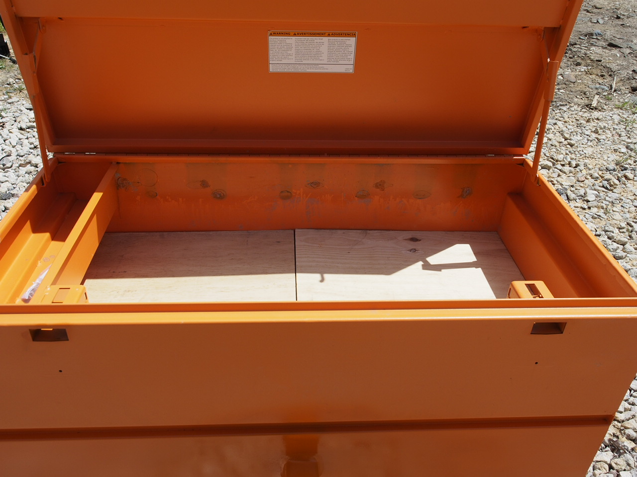

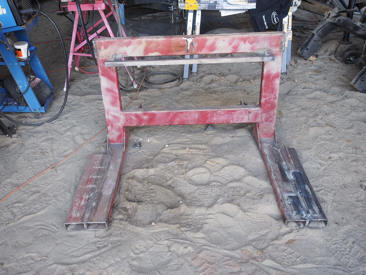

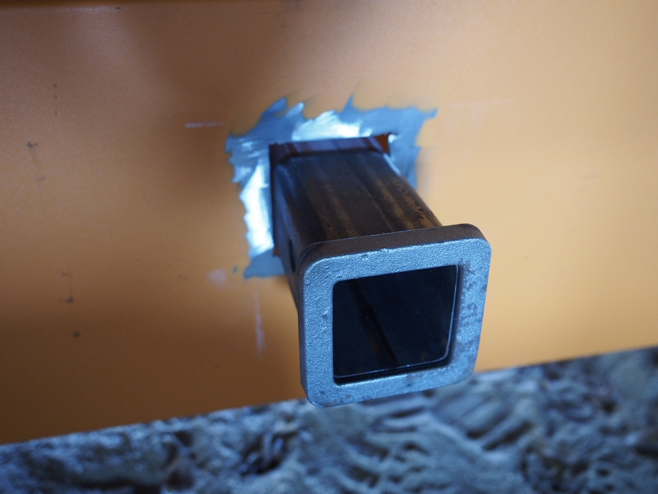

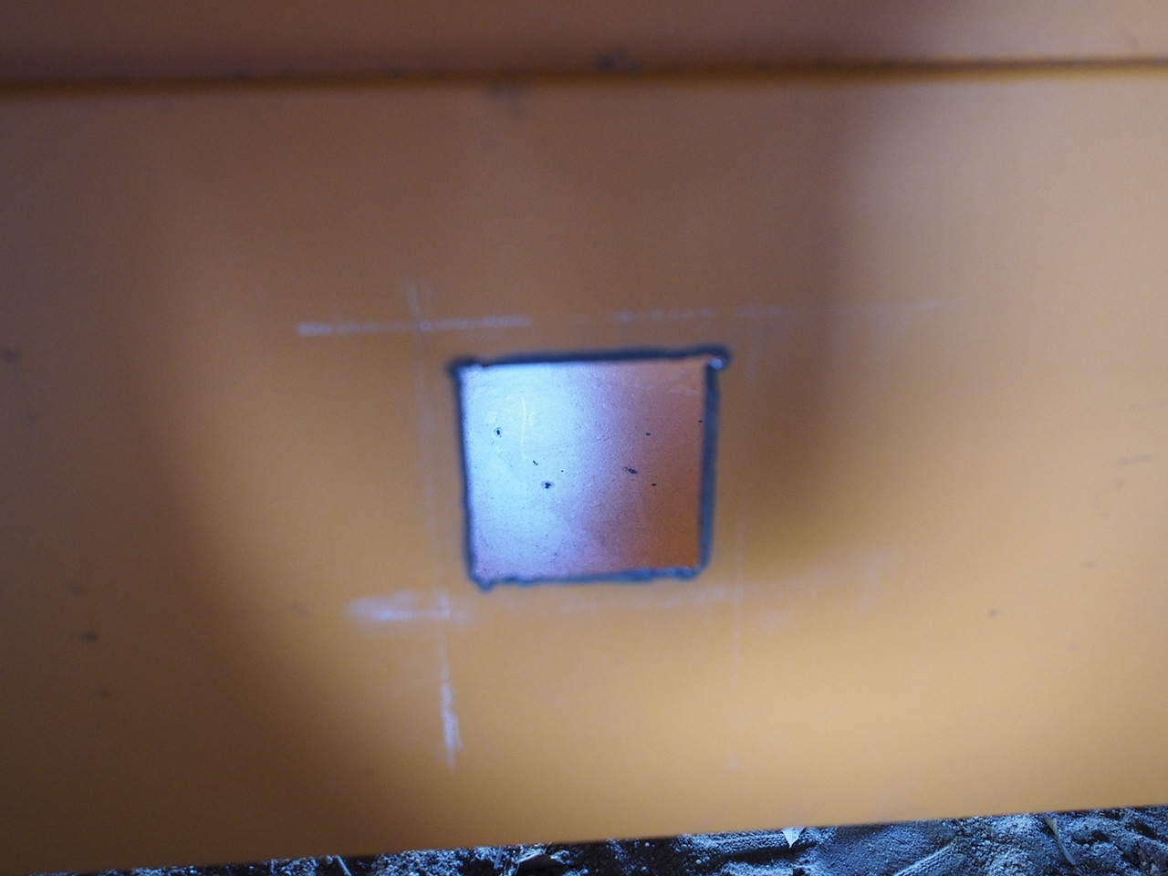

Contact tips are optional, which I have yet to purchase. I have no photos of it in actual use. Attached are a few pics of a weigh box just completed with lots of help from the plasma. The 3PH pallet mover tines/support arms were cut to length with the plasma and then welded parallel with the pieces left to allow more support for the weight box. Also cut the holes for the 2" receiver, along with cutting off a bale spear type contraption. All of these cuts would have been much more difficult with any other tool. Angle iron guides used for all cuts except the spear which was free hand.
Box weighs 1240# measured and has internal storage space or enough room to add more weight if necessary.

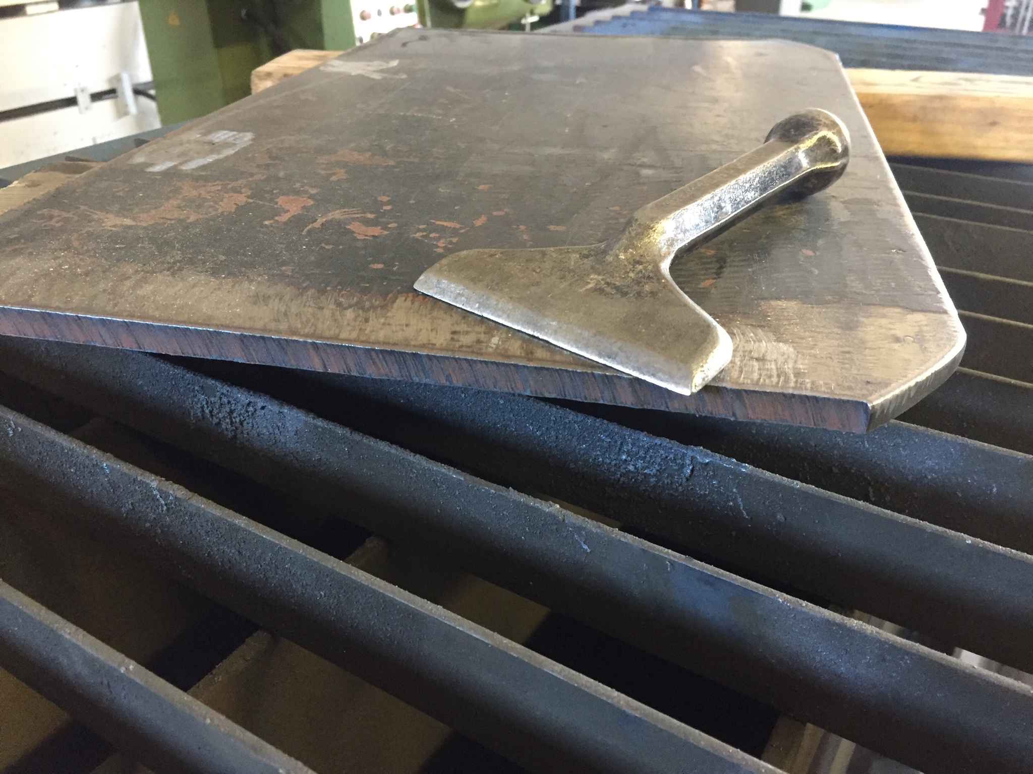

Here's a pic of 1/2" plate cut with my Miller 625 Extreme (and
and from what I can gather a LESSER capacity machine than yours).

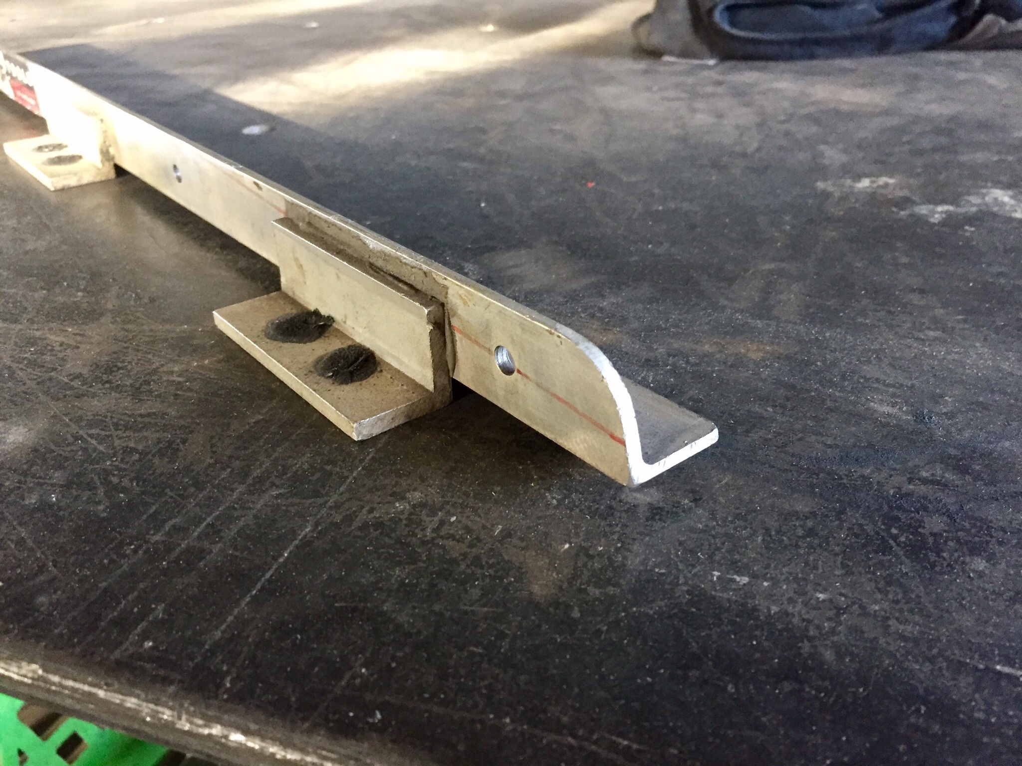

Richard. My first Miller Spectrum plasma I purchased almost 20 years ago didn't have elevated drag tips.
I made this straightedge guide to maintain correct cutting height for material over 3/16". I JB welded 3 aluminum vice jaw protectors to a length of aluminum angle iron (at appropriate height) for the plasma's retaining cup to slide on.

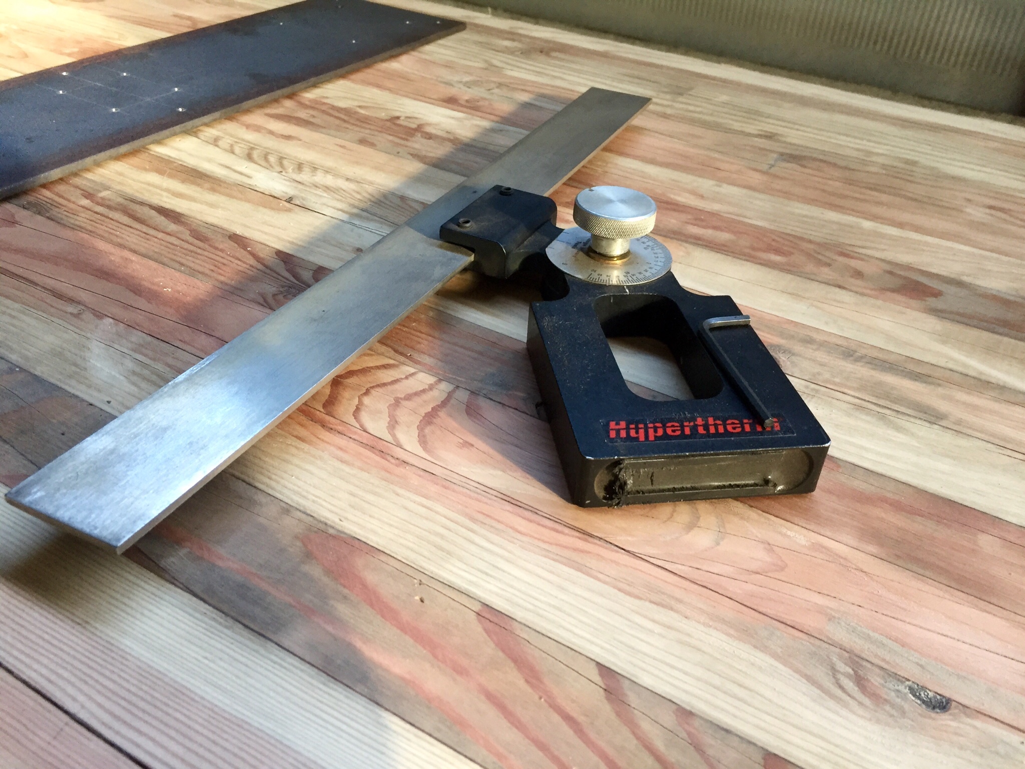

I also have a short magnetic guide for smaller cuts. The edge is elevated at the correct height for NON standoff tips. It's branded "Hypertherm" but I'm quite certain it's made by Flange Wizard.
The dross did NOT come off easy. Had to take a grinding wheel to it and it was still a bit of work. The cut looks crappy compared to other 1/2in cuts I have seen. Also realize it took a second pass to sever this. I did use a piece of metal that I bent and clamped into place. Similar to how I cut the 1/4in blade shown here.

From the info you give I would guess that your air quality is not an issue and you are not getting the amps you need due to your restrictive extension cord.
Wide blade chisel pictured makes short work of dross removal. View attachment 504523
That's is more what I was expecting. The whole reason I decided to go with the 45XP vs. the 30XP or Miller equivalent.
I think when you are able to wire a 50 amp receptacle you'll go a long way toward solving your problem. My 45XP cuts on 1/2 look a lot like Big Barns and I have to use a guide.
Yes, I am pretty sure it is my redneck 220v wiring to my shop. I am planning to extend my garage to have a bigger dedicated shop so I have been waiting to run wire from my main panel until I can do it right. If I ran it now, the sub panel would not be where I want it later and my run would be longer and maybe in the way of my foundation work.

If your are not tripping the circuit breaker, I don't believe the extension cord is causing the problem. .
Just so you know, an extension cord would not cause a circuit breaker to trip but it would reduce the voltage at the machine due to line drop so the power the machine had to operate with would be less. Breakers trip because too much current is being pulled from the circuit, not too little voltage being delivered.
Thank you, Mr. Foster, for correcting that error.
You can easily trash an electric motor from low voltage without ever tripping the breaker. As my neighbor who went through 4 sump pumps in his hard in as many years. Inadequate wring by the previous owner, who also went through sump pumps and never figured it out. :confused2:
Nice cut Terry. Perfect speed, smooth tip control, sharp tip/electrode.
My machine is same model. I had the earlier, large bulky 625 before. I like this smaller model much better. Comes with it's own carrying case. Easy to be mobile.
