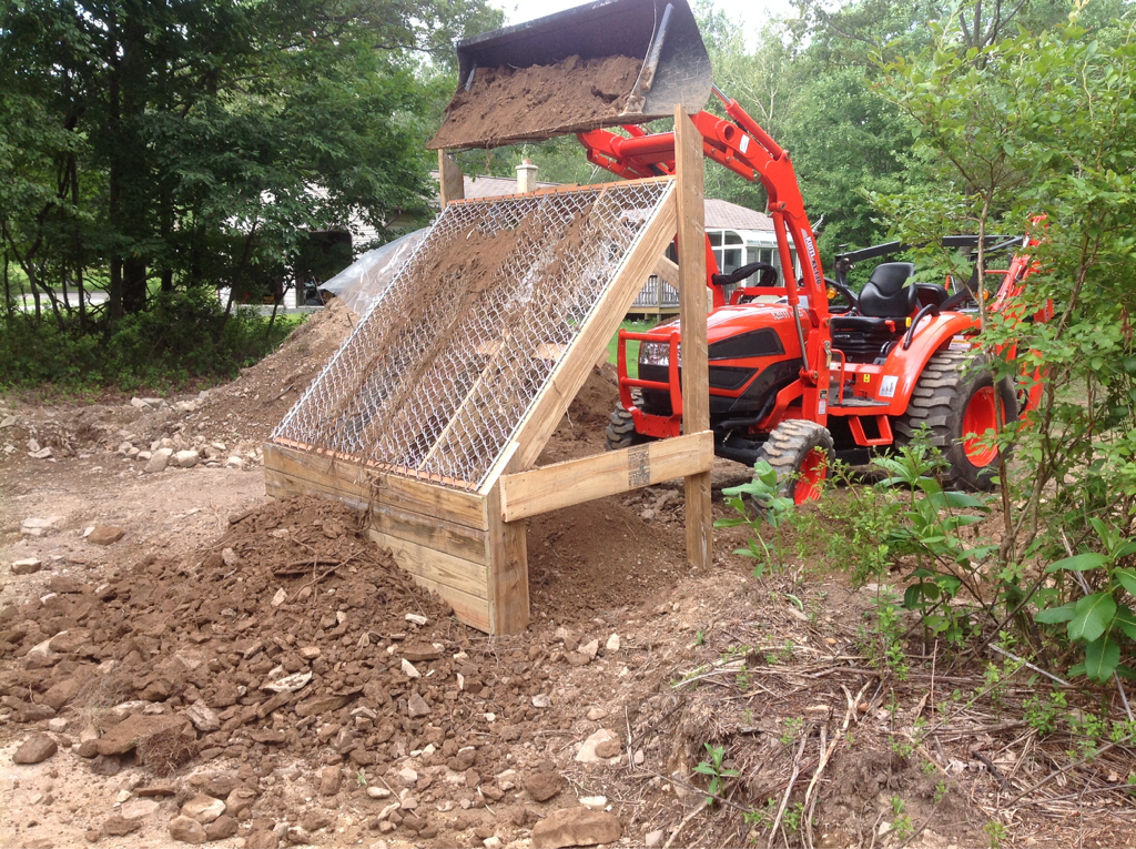

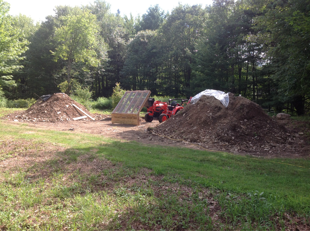

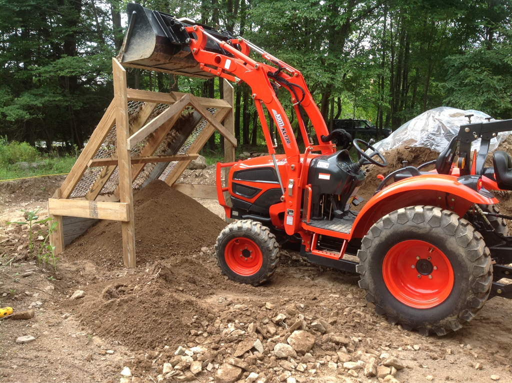

A few years back I built a 50'x75' garden by scratching the area with my backhoe 18" deep piling it then screening it all. The screener I built was on the cheep but worked better than expected. Total cost $50 for the piece of 9 ga. chain link fence and metal strapping,had the pressure treated lumber from a deck I removed. You have to go to a fencing co. for the fence, the big box stores only have 11 ga. crap. I didn't stretch the fence fully since the holes would be to big, so I tightened up the openings and secured it with the strong back straps in three places. Basically used a 9' length of fence in a 6' run.
Since the pictures I have added a couple more boards to the sides to better contain the soil.
The only downfall I have found is that some odd shaped rocks, roots, and branches will sometimes clog the screen, so I keep a metal leaf rake handy. Other than that I am very happy with the results, dig a hole with backhoe, place screener in front of hole, screen out soil, rocks roll into hole.

Nice work! How long did it take to build?

Consider making the "screening panels" easily removable - I have three screening panels for mine, all of which use 2 x 4's (on edge)
The one I use the most is 1" square wire netting ... works good to clear most all debris down to around 1/2" - 3/4" diameter.
The second uses a cattle panel from TSC, which I believe has around a 4" mesh - good for larger rocks.
The third uses hardware cloth with 1/4" mesh ... good for cleaning dirty gravel.
Weeks of planing and about a day and a half to build. I actually built it in the shop in my basement ( like a boat), only I was able to partially disassemble and send it out the basement door for transport and reassemble.
I tried to pull the larger rocks out by hand, 8-10" a and over so as to not damage the fencing.
   / plans for soil screener #10
Thanks. Couple of other questions: what angle is the screen at? Looks to be about 45*....
And the metal strapping- where did that come from?
Can you remove the screen by hand, or only by using the tractor?
