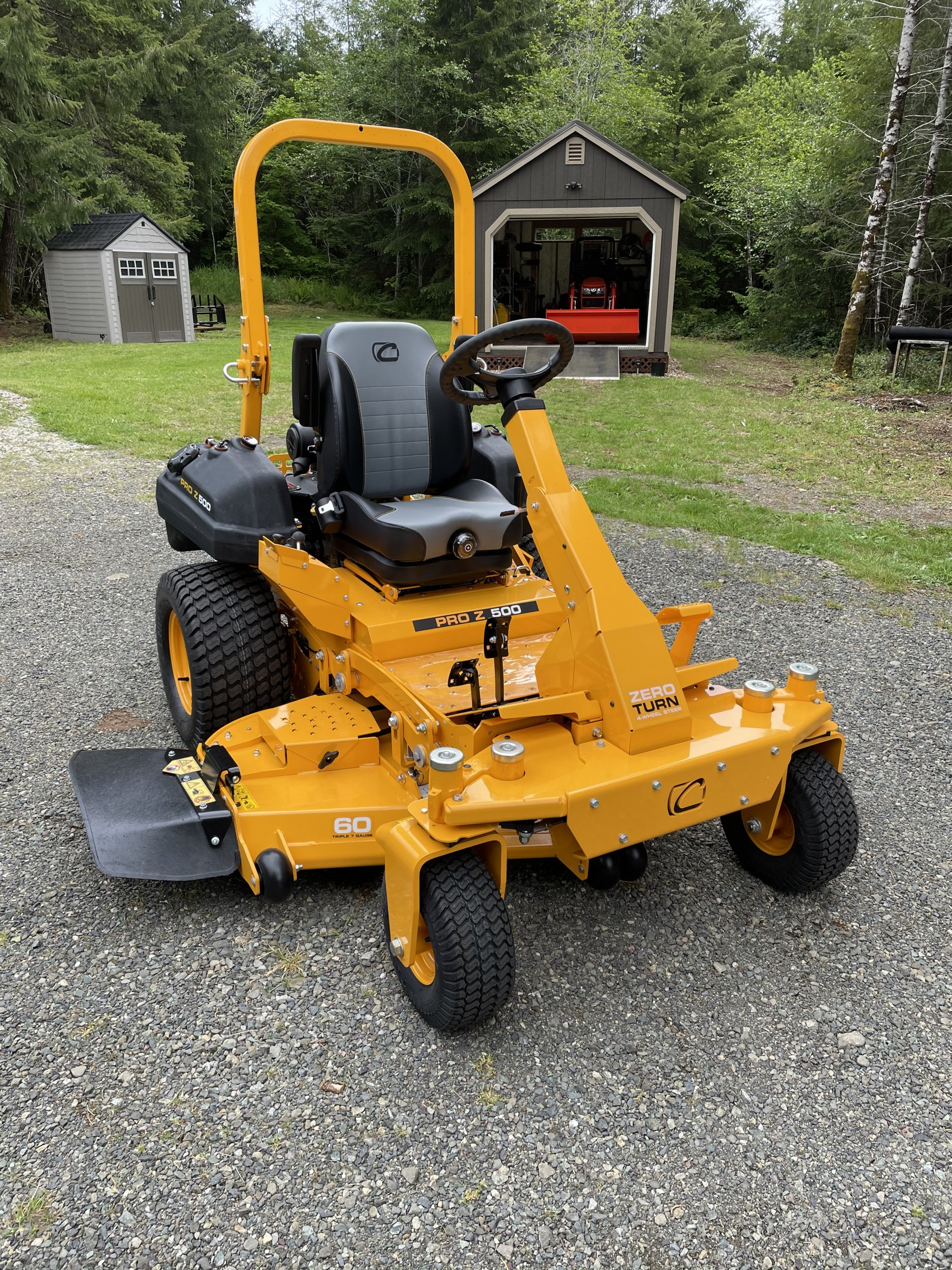

The Cub Cadet Pro Z are fantastic ZTR’s for hills and slopes!
It solved all my hillside mowing issues and saved an hour of mowing time! I highly recommend them.
Mike

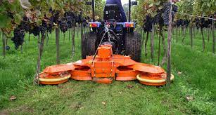

The HP requirements will depend on what the mower attachment requires. This also effects the time spent mowing. There are mowers that will mow around trees or fence posts.
