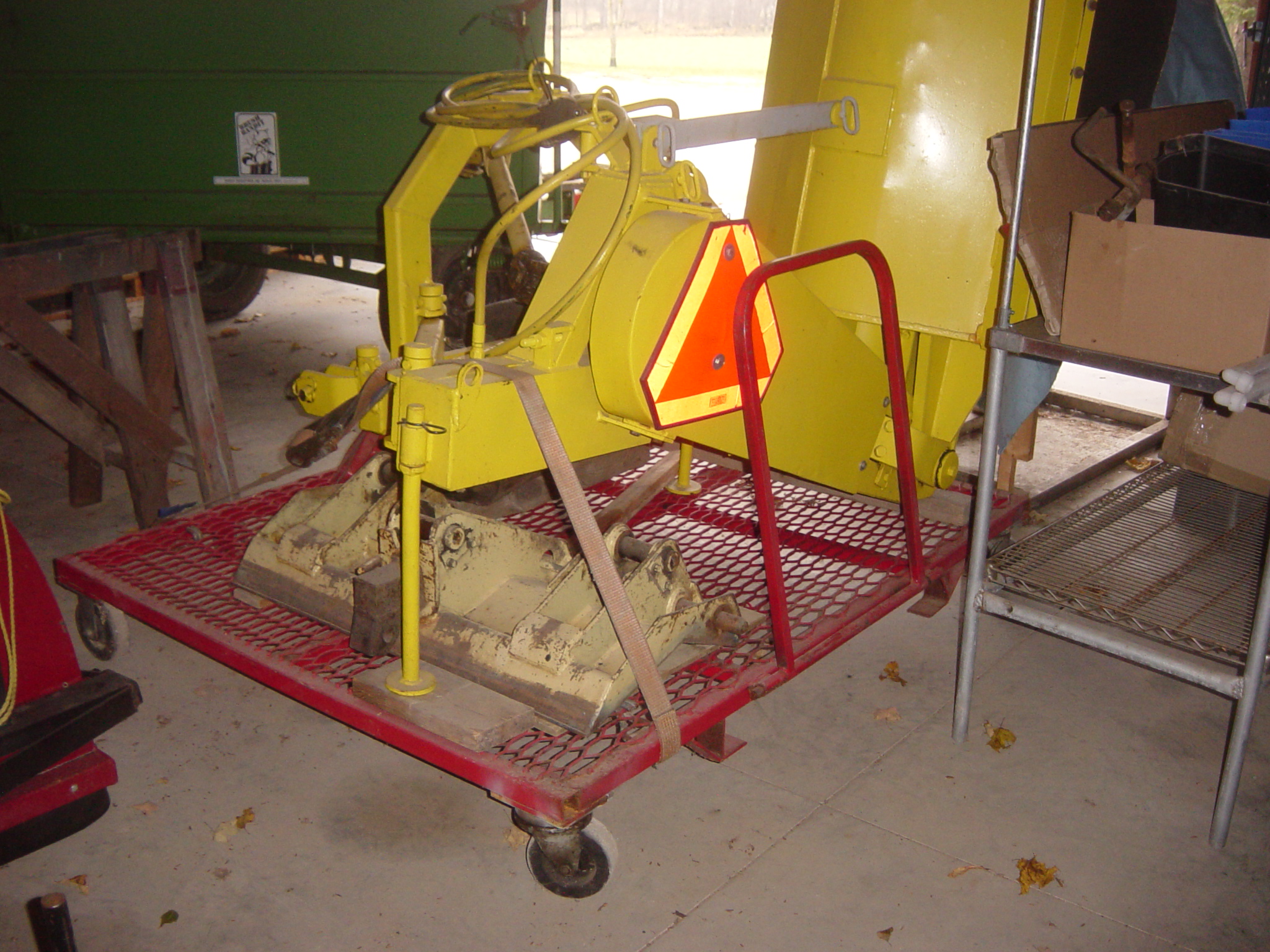

This winter I want to build a steel pallet to park my BX25 BH. Hoping someone in TBN land has done this and can share plans or good pictures for me to follow. I have never believed in re-inventing the wheel if someone already has, probably several times already. FEL won't lift it; so will install wheels and a tow bar. Thanks in advance.

I will try and take a picture of a large pallet I made for my ditch mower. Basically a tubing frame, expanded steel mesh and heavy castors. It has fork pockets but also a hinged handle for manually pushing or pulling it around.
The handle can be attached at either end. The fork provisions are garbage though. I thought this would suffice, but learned that tubes would be much, much better.

One of the things with tailored load and prep for forks; you have to be pretty close on the center of balance. You don't want a heavy side if avoidable.
