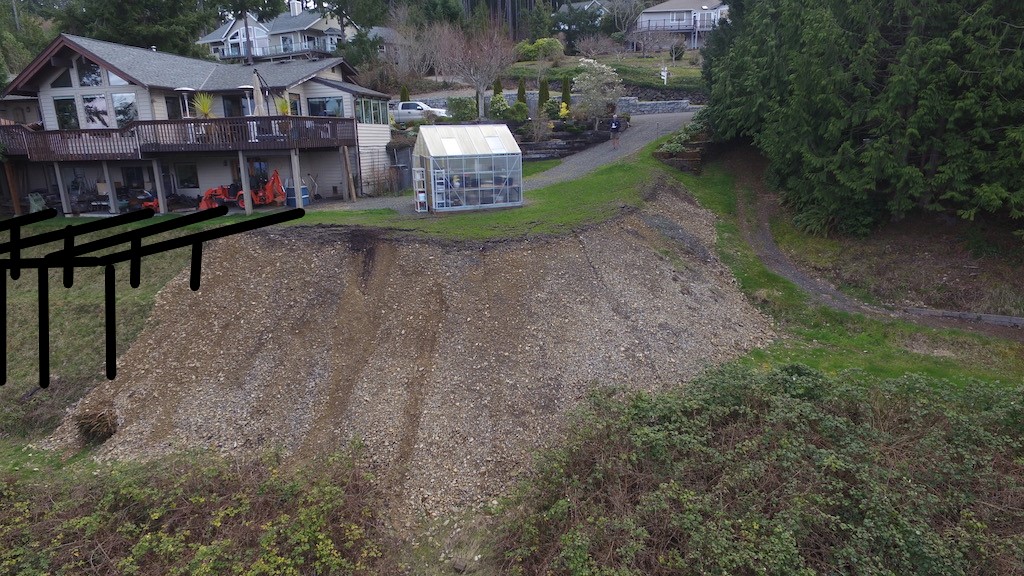

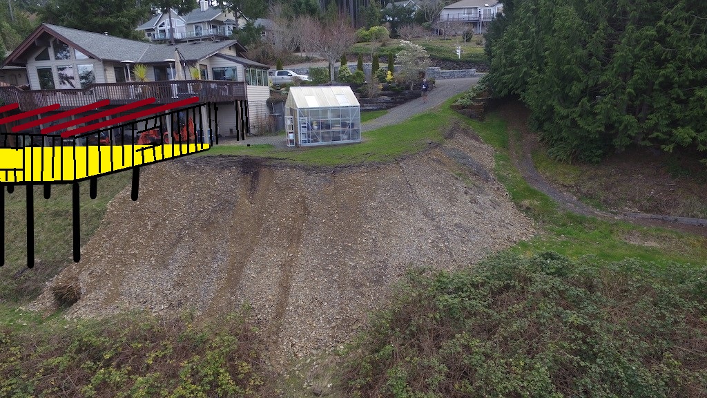

MossRoad's drawing surprised me. I wasn't expecting you to build in that direction. He also inspired me to try to draw my idea onto your pictures like he did.
To me, as a builder, it would be simple to set posts into the steep hillside. Build a scaffold platform out of 2x4's and 2x12's to work from, and dig the holes for the posts by hand. Slow, but not overly difficult. You just have to get down far enough for your soil conditions. Ten feet wouldn't be that big of a deal. Set your posts so you can build a deck that extends out from your concrete pad. But used 3/4 or even better, 1 1/4 tongue and groove plywood for your sub floor. Basically building a pier and beam house foundation.
Then frame up the walls just like a house, but instead of a rafters or trusses for a roof, go flat and make it look like your deck. Or slope it and have it higher at the deck and sloped down toward the canyon. Either way, this would give you plenty of shop area on the same level as your current cement pad that your tractor is parked on, and it would be about the cheapest square footage that you could get.

Gotta love the finger CAD. :laughing:
I also love spending other people's money. :D
Or, if you need to go very far, helical piers might be a better solution.
