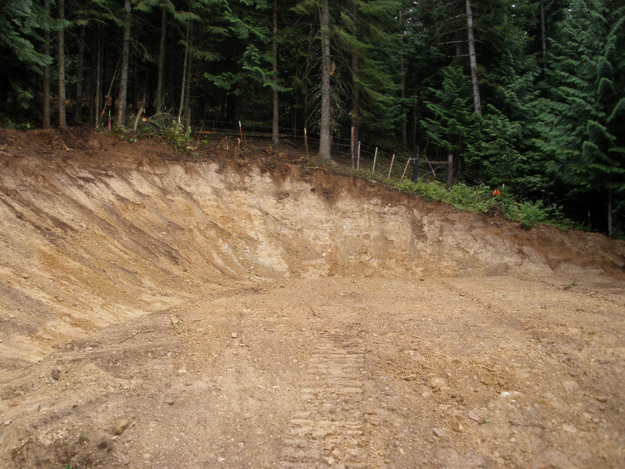

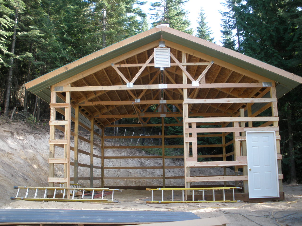

I'm no expert but I was able to but a shop up by digging into a hillside it may not be as steep as yours but your house went in on the same slope. Here are a couple of pictures during the construction.

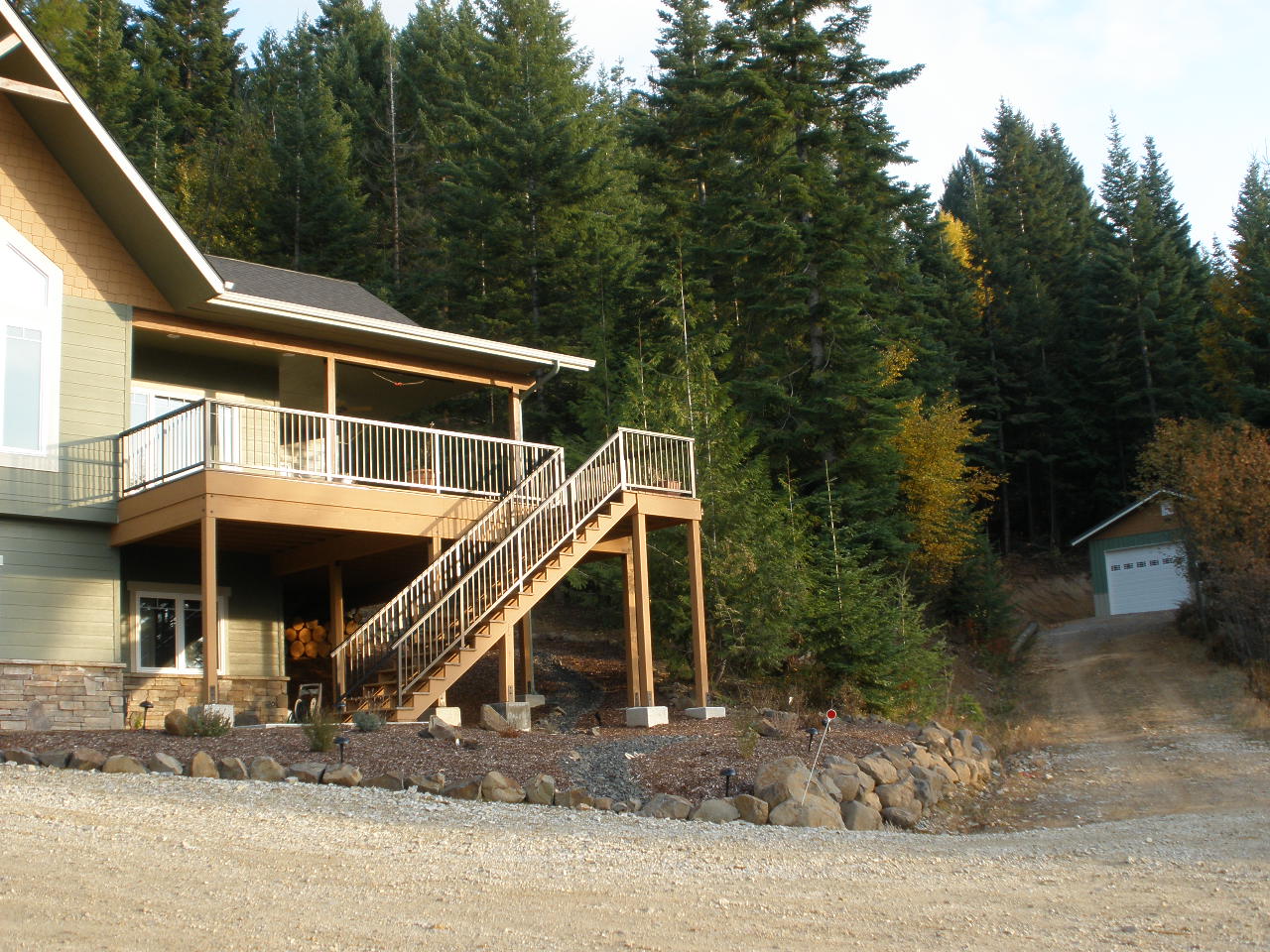

My wife definitely wants to increase the deck area towards the slope/water, and expand the house as I proposed. The lower patio where I store my tractor is the entrance to my 'man cave'. The thought was to expand to the right as it would be easy to just add trusses and scab on to the side of the house and extend the deck in both that direction and towards the camera.
Expanding the size of the house will really add to the cost and scope of the project. Do you need the room? For just a workshop, making your deck bigger would be the most cost effective way that I can see, based on your photo's.

The house definitely does not sit on fill. It is cut into the hill and the foundation is easily 12ft back from where it was cut back. The middle portion of the house extends out beyond that and you can see the posts supporting it and the two decks on either side.

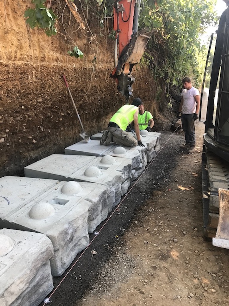

Our soil just under a lot of forest decay is glacial till and quite stable. Take a look at this cut into the bank nearby when my neighbor had a new retaining wall build last year. I am not too worried about a slide unless we have a massive earthquake.
