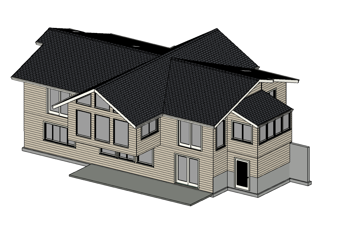

Here is an orthographic as-is view of the house. I don't have the decks modeled. My thought would be to expand to the right but there is limited solid ground as the slope curves back into the hill. But adding to that side wouldn't be too bad except the wife would like a higher ceiling for more glass for the view.
The 'scab on' to the right bottom floor is an uninsulated shed (outside the bearing wall) and a sun room. These could easily be demo'd to make room for a proper two story extension. Note the cement retaining wall extending further to the right to handle the steep grade change. Would have to move my heat pump that is just below in front of the retaining wall. No big deal I suppose.

If you add on to the right, won't you be cutting off your drive-around and down access to your current under deck area, and put that greenhouse really close to the house?

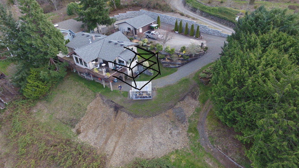

Exactly... the greenhouse would have to go. Sad because I plumbed and wired it and heavily modified the 10ft by 12ft structure to make it a quality structure. Wondering if I could somehow skid it down the hill to relocate it?
The access to the 'other' side would be a challenge but I would keep a wide enough 'easement' for the tractor plus a little but there I would be straddling some unstable soil.

On your side extension if you could drop the roof slightly could you tuck it under the existing eve?
This would minimize disruption to the existing... but would you pick up enough square footage?
