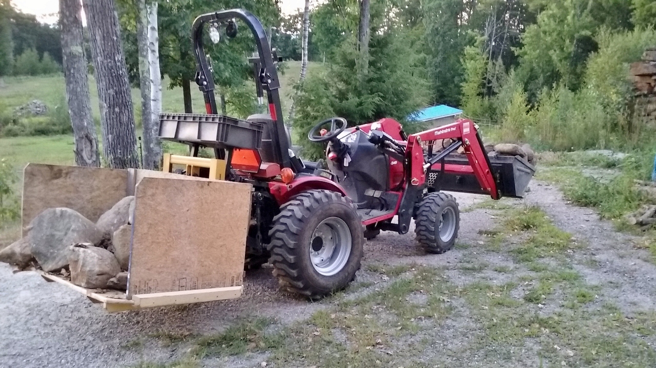

What I do have is a King Cutter, 3-pt carry all that is rated for 1000 lbs. It looks like this
and it is 36" deep (front to back), and 28" left to right. I too would like to have a receiver hitch on it so I could use it to drag logs and move a horse trailer from time to time.
My thoughts are to cut the two forks shorter by at least a foot. and then having a piece of angle welded between them and probably braced to the back as well. Then deck with treated 2x6's and build a temporary wooden box to fill with lead and concrete. I don't have any metal fabrication skills so I would like to keep the welding work to a minimum as I will have to pay to have it done. but what would you guys suggest for bracing, if any, and any other modifications (maybe some tiedowns on top for my chainsaw and tow chain?).

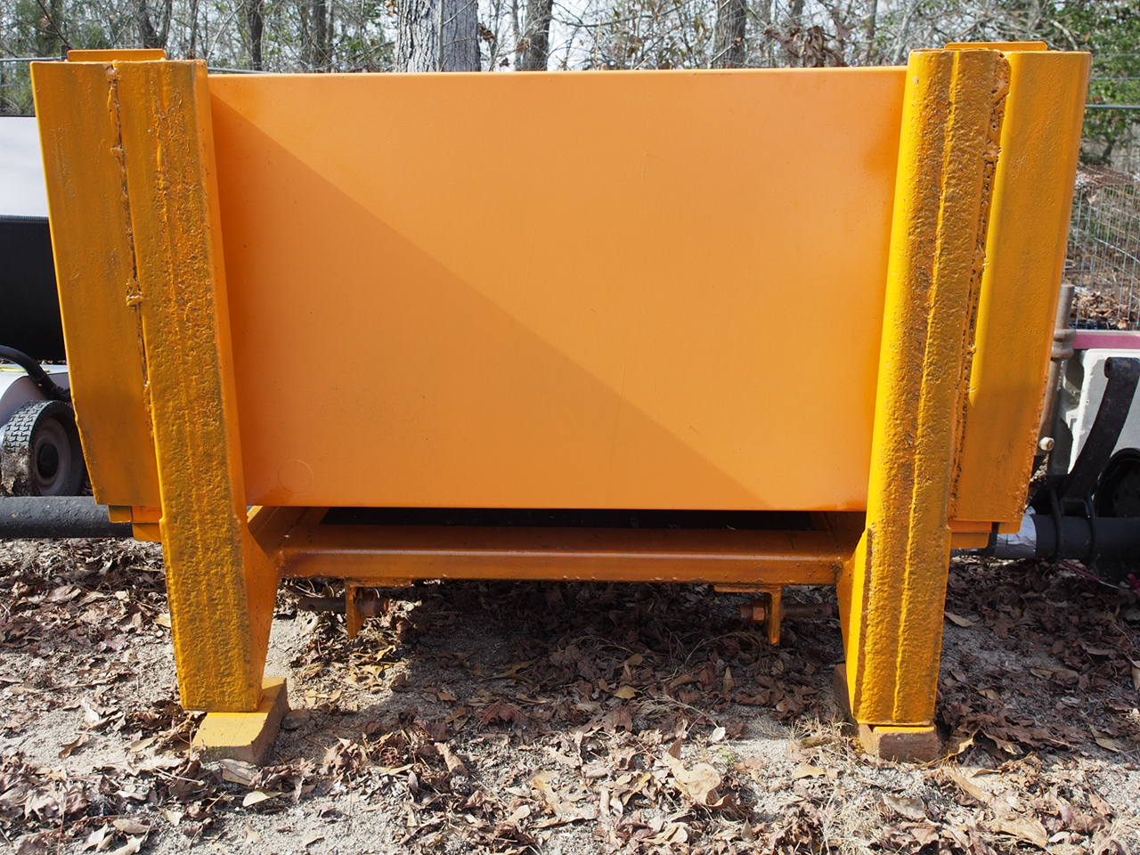

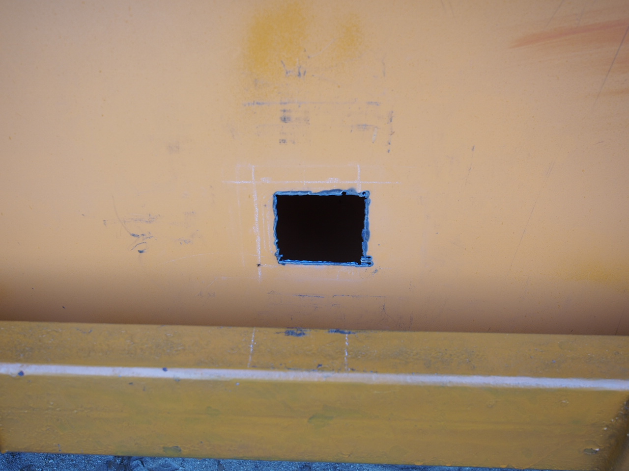

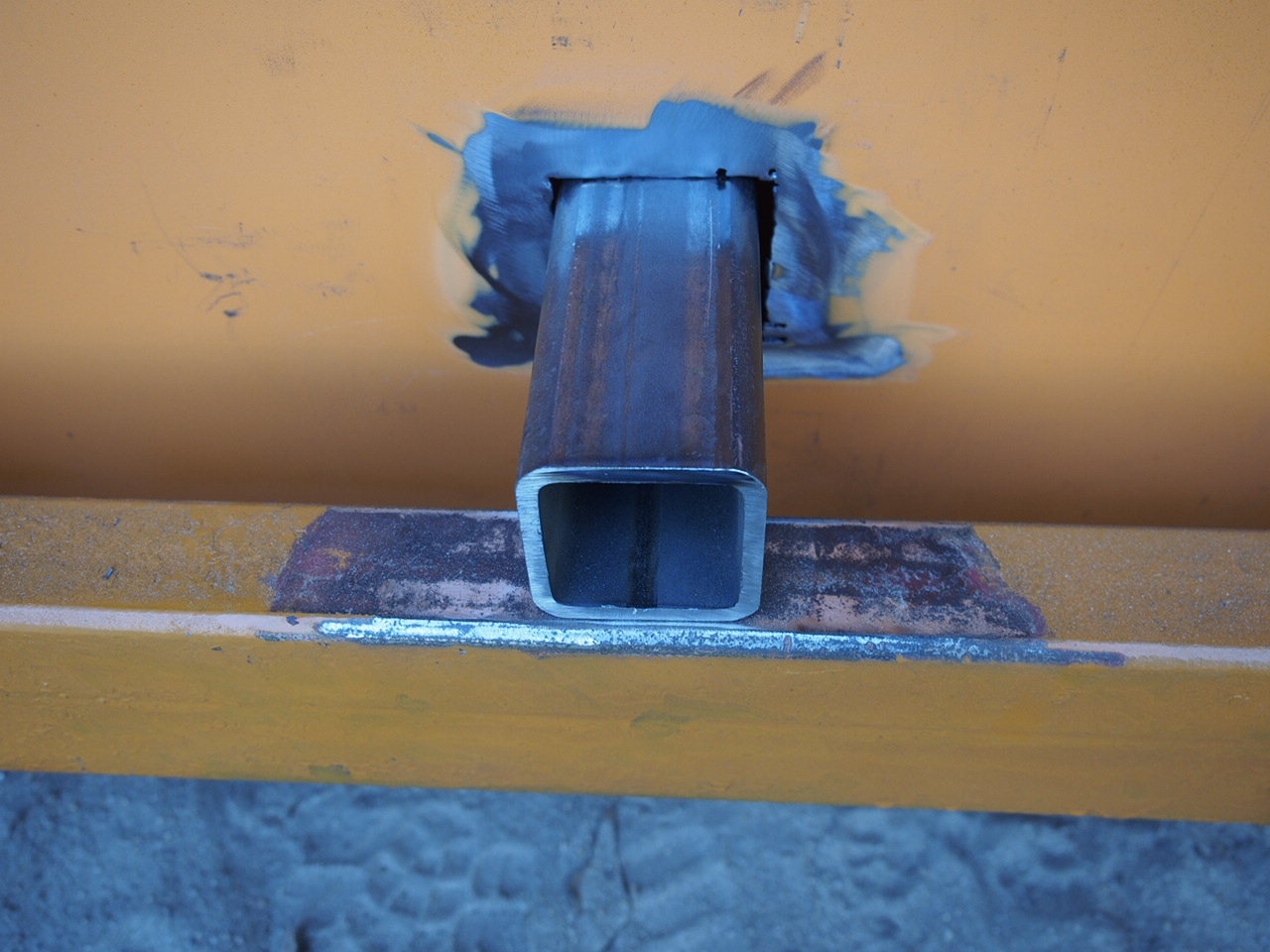

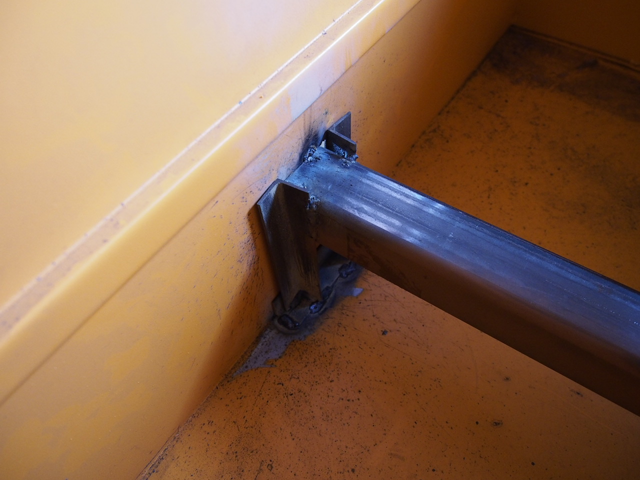

I needed more weight than a 55 gallon drum would provide so am going a similar route you are considering. Goal is to start at 1050 pounds and work up during testing to 1250 pounds, which I think will be my sweet spot with usage vs. loading tractor on a trailer and having that weight on the back while going up the ramps and removing too much weight from the front tires.
mine is based on a donated 3PH pallet lift I modified to carry a 24" x 48" job site tool box that holds 15 cubic feet. I am ready to test by loading 50# bags of concrete up to my specified weights and see how it goes. Once I get to the proper weight, I will remove the concrete bags, seal the box around the 2" receiver cutouts with ribbon epoxy and then pour the mixed concrete. I figure the box will be about half full and leave the rest for carrying other things. I have lots of onboard tractor tube storage so have no further need of that in this weight box.

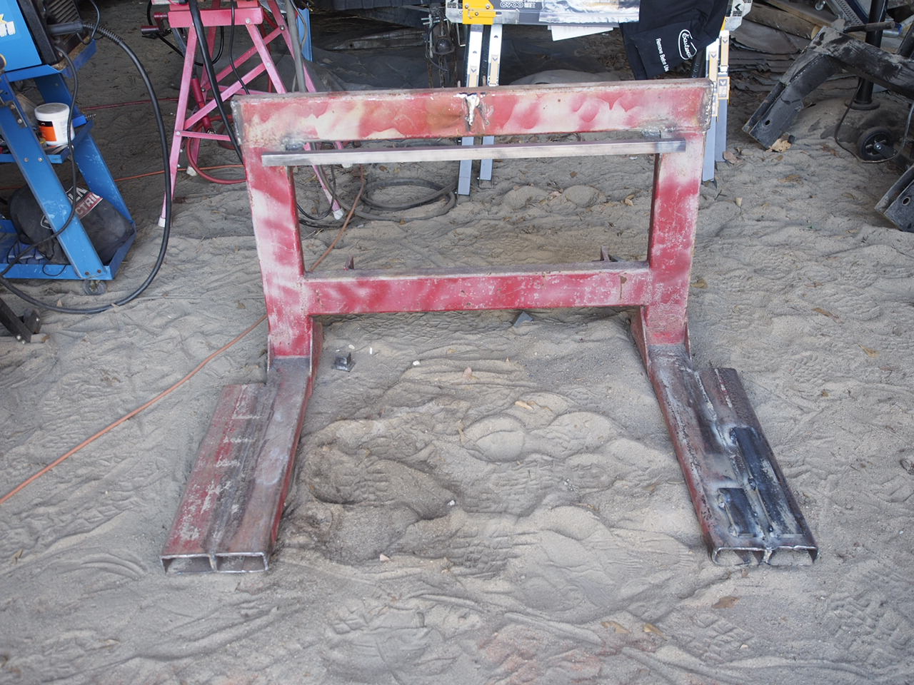

I had a bunch of smaller dimensioned, scrap straight steel lying around and an implement bar like used with a Ford N or Massy TO tractor with the Cat 1 pins integrated into it. So I just tack welded a bunch of that onto the implement bar and slid a couple of 50# wheel weights over it and that worked for me. In the past I have built a form and using a piece of #3 rebar bent in a U shape for a lifting device, just filled it with sacrete. Last one I built was 350#. Course concrete is about half the weight of steel so for small size, go with something in solid steel.

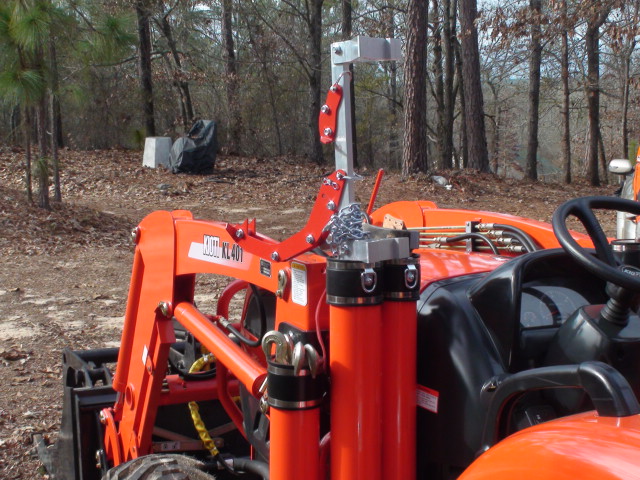

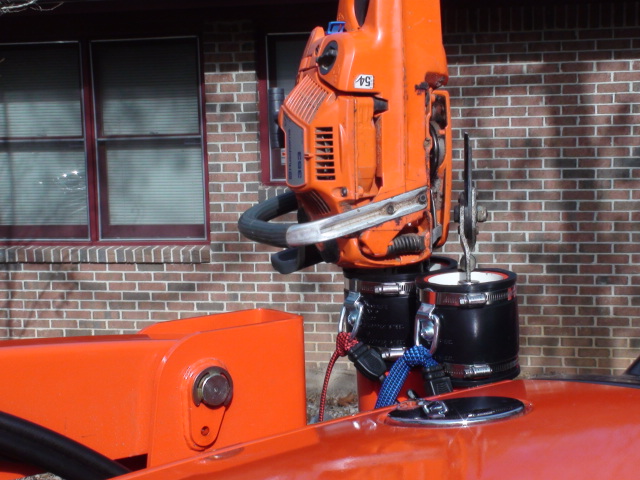

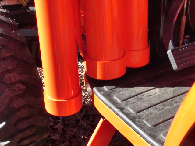

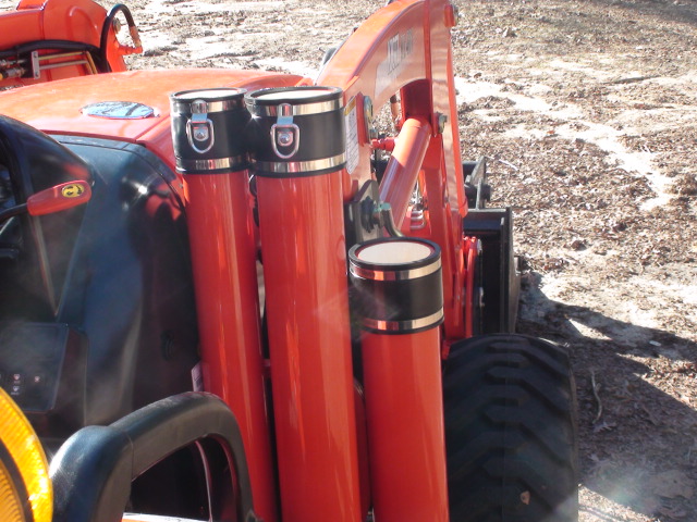

... sdef, I also like that chainsaw scabbard. I have been planning on something like that for certain. I'm tired of carrying my saw in my lap while I drive my 8N in the timber. Looks like yours might be made from PVC pipe? How is it connected to your machine?
Yes, 4" and 6" PVC pipe. Attached with a carriage bolt in two places through the PVC to a square tube framework that is attached to the tractor on the inside and bottom of the square tubing, with the carriage bolts inserted through the inside of the tubes to minimize potential chain saw interference.
If you look carefully between the tubes, you can see the framework- also orange in color. These things work great and mine are always full of chains and various tools. I sized the larger 6" tubes for carrying chain saw bars up to ~ 24" I seem to recall, although mine are 16" and 20". Paint is Binzer primer with Rustoleum finish. I thinned both paints so they would flow smoothly and they came out great. Paint has stayed on the plastic for a tough 2.5 years and 375 hours of work in the woods. Most folks think the tubes are factory installed.

I dug out the old carry all today and stripped it of the mostly rotten wood box on it. Looks like it will work really well for what I want. I can shorten it up from front to back (some serious hacksaw work). I'll put a bottom deck on it with 4x6 treated timbers and then build a reinforced wooden box that is 15" deep, by 30 wide and 30" tall. Total cubic feet will be about 7.8 cf and at 150#/cu filling it with cement will work out to 1170# plus the weight of the carrier frame. Now I just need to find some steel and mounting hardware to make a receiver hitch.
That might be too heavy for a 3039R, but you can know for sure with some math. What's the front loader capacity of the 3039R? What's the distance from the front axle to the approx center of the weight box when it's on the 3 pt hitch?

Just using my L3200 dimensions (4' from front axle to bucket, 8.5 feet from front axle to weight box) as an approximation, you wouldn't need more than 750# to fully offset that 1600#. So I'd plan to fill it for 800-900# as a starting point, but leave room for more concrete if you want to go heavier, or have loads way way out in front.
The loader will have more than 1600# capacity down low, so you might want more ballast if you think you'll be exceeding 1600# frequently. However, carrying around that amount of ballast all the rest of the time will probably have drawbacks. So I'd size for a nominal condition.
