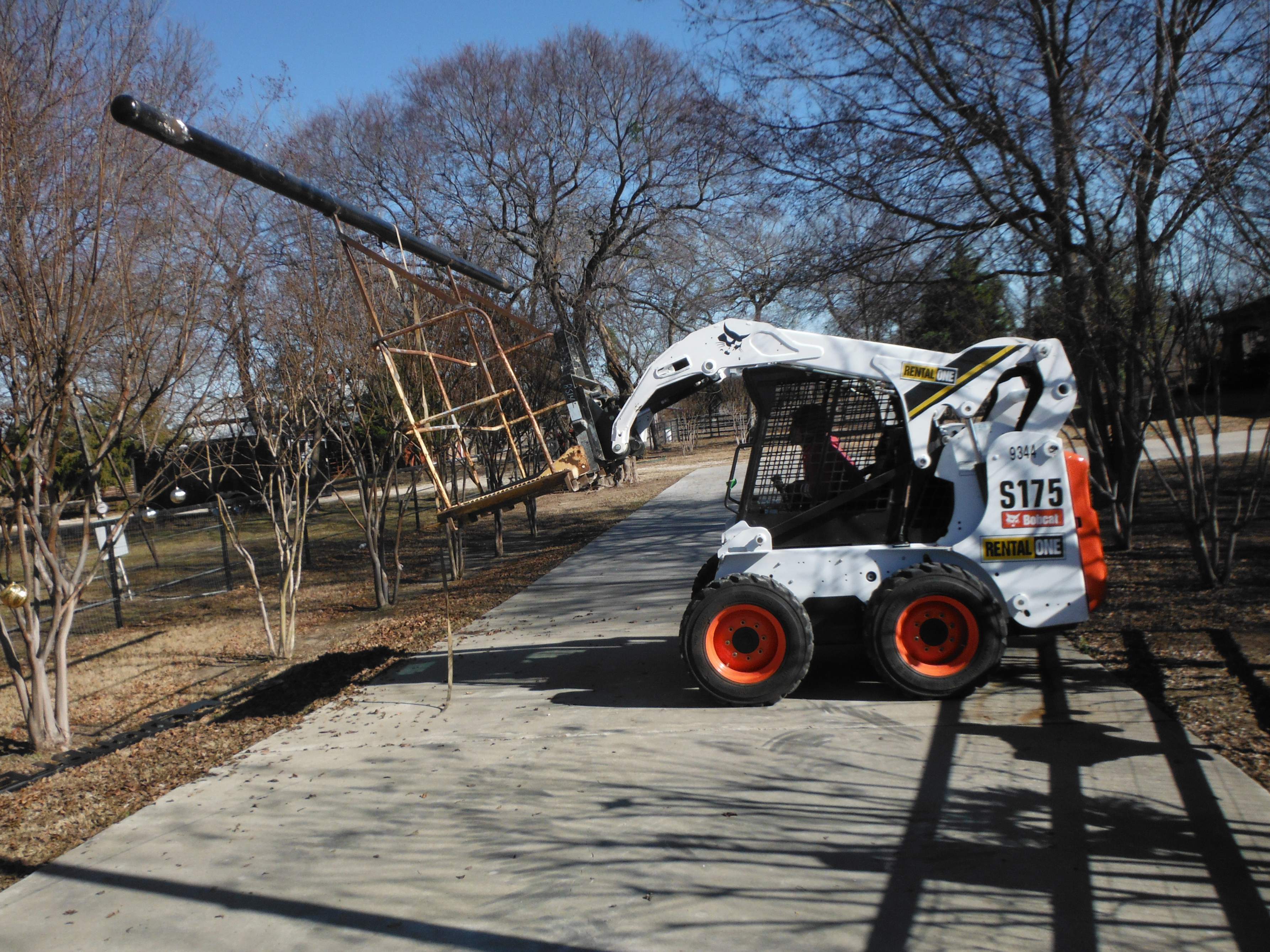

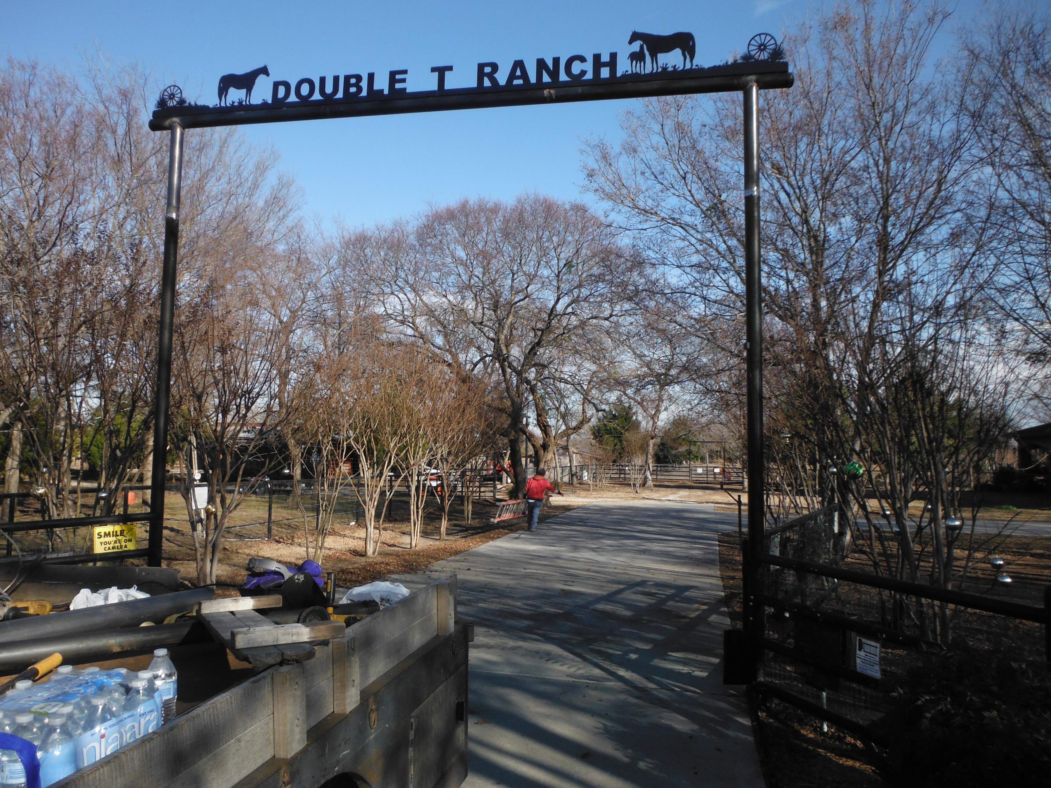

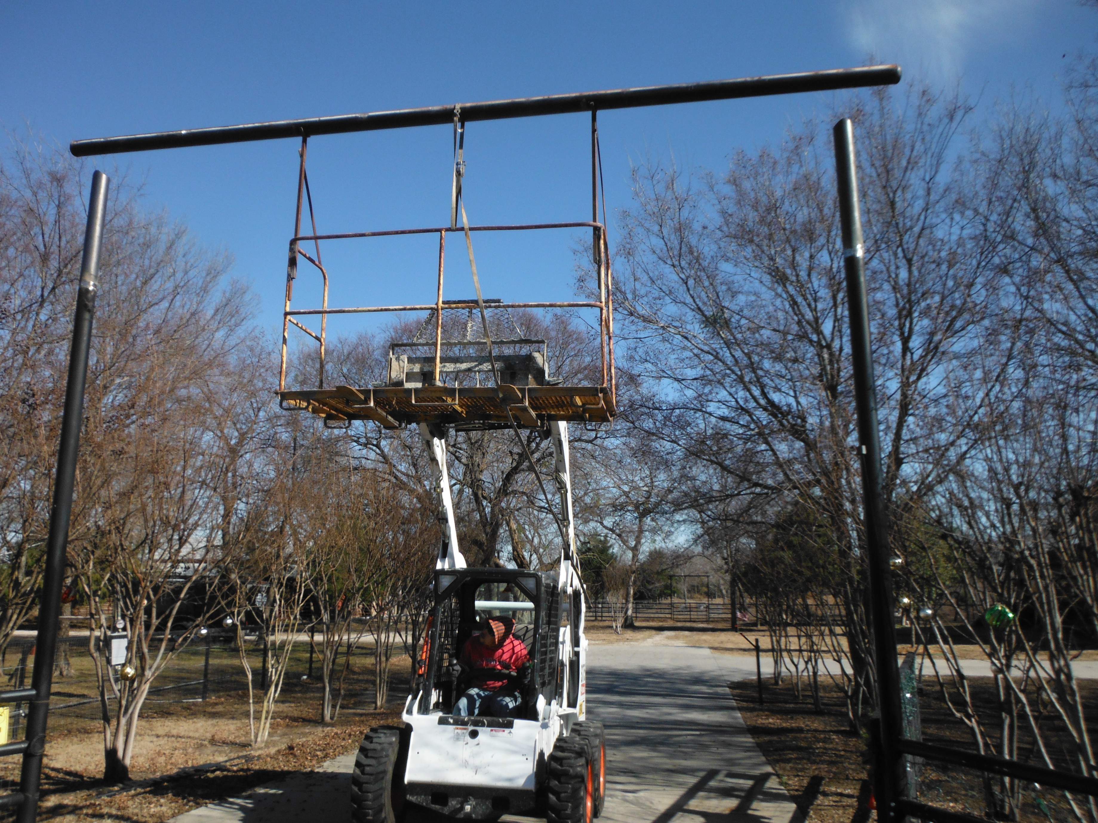

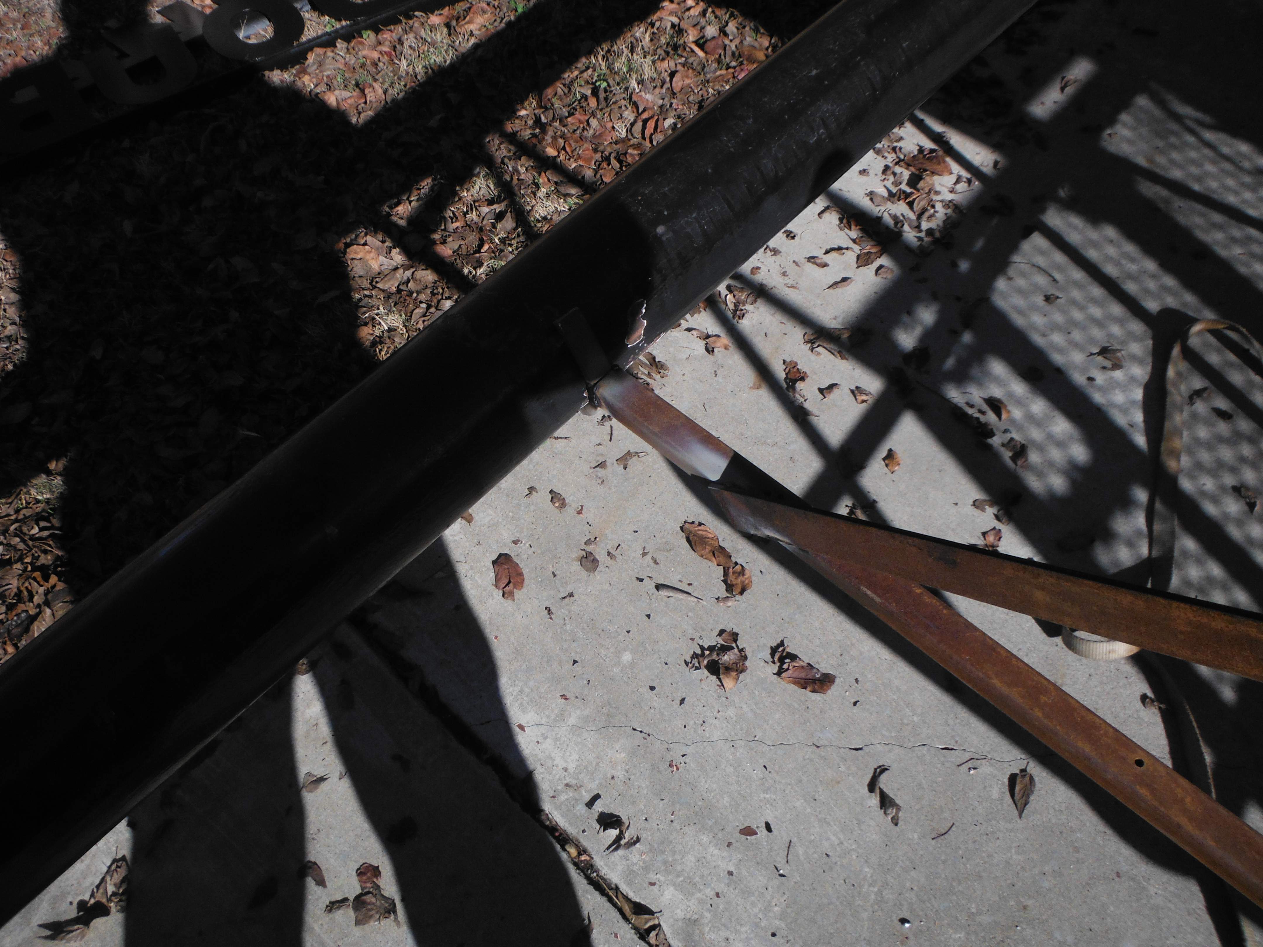

It was a one day job. Client had purchased a new toy hauler and needed their 12' high overheads raised to 15'.
I picked up the new pipe, 4 5/8" for two of the gates and 2 7/8" for the last one. The idea is to cut the overhead at the top of the existing posts. Then trim the post square and add the necessary height already notched for the pipe, replace the overhead. Nothing but a thing. This is how we did it.

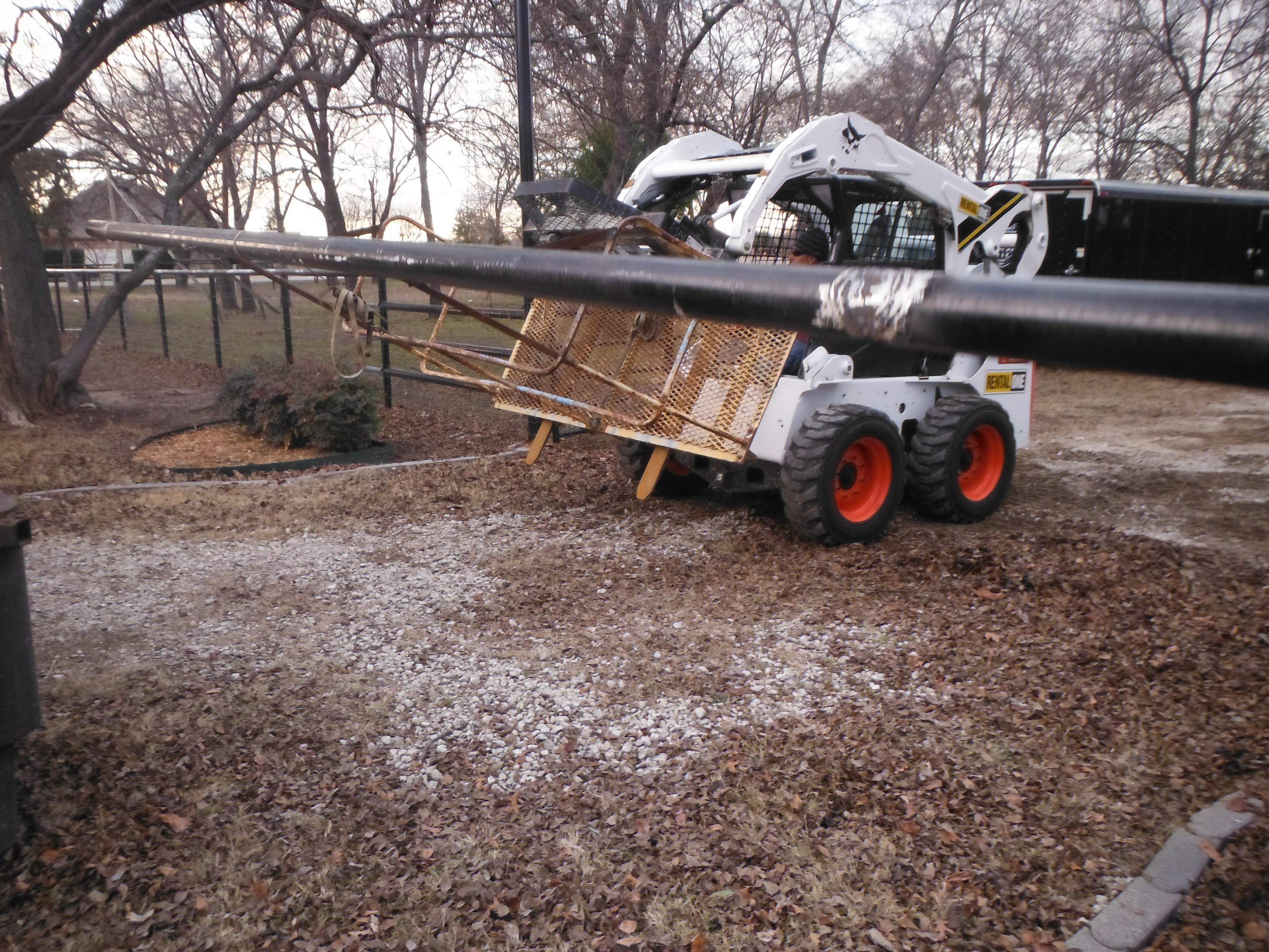

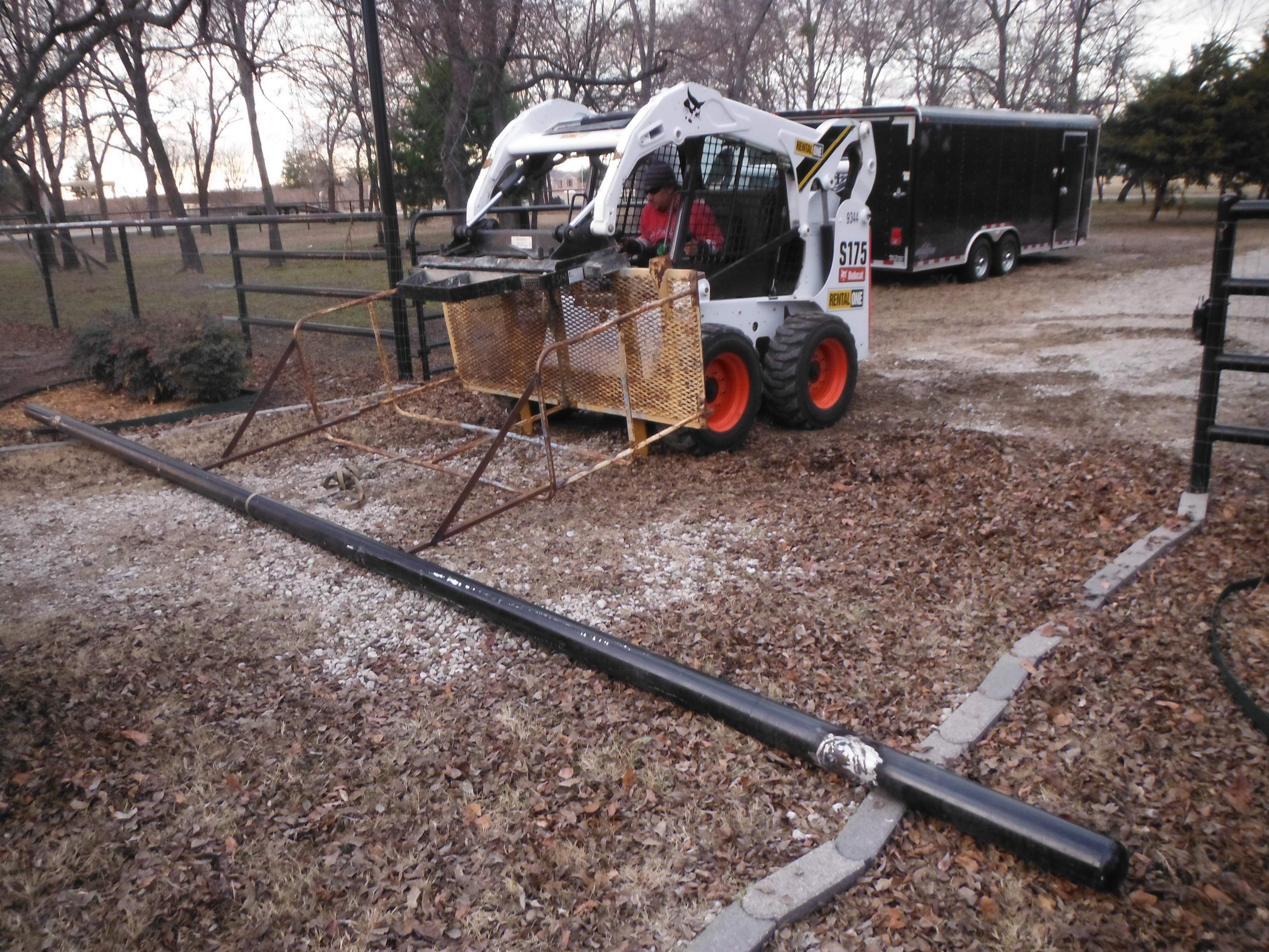

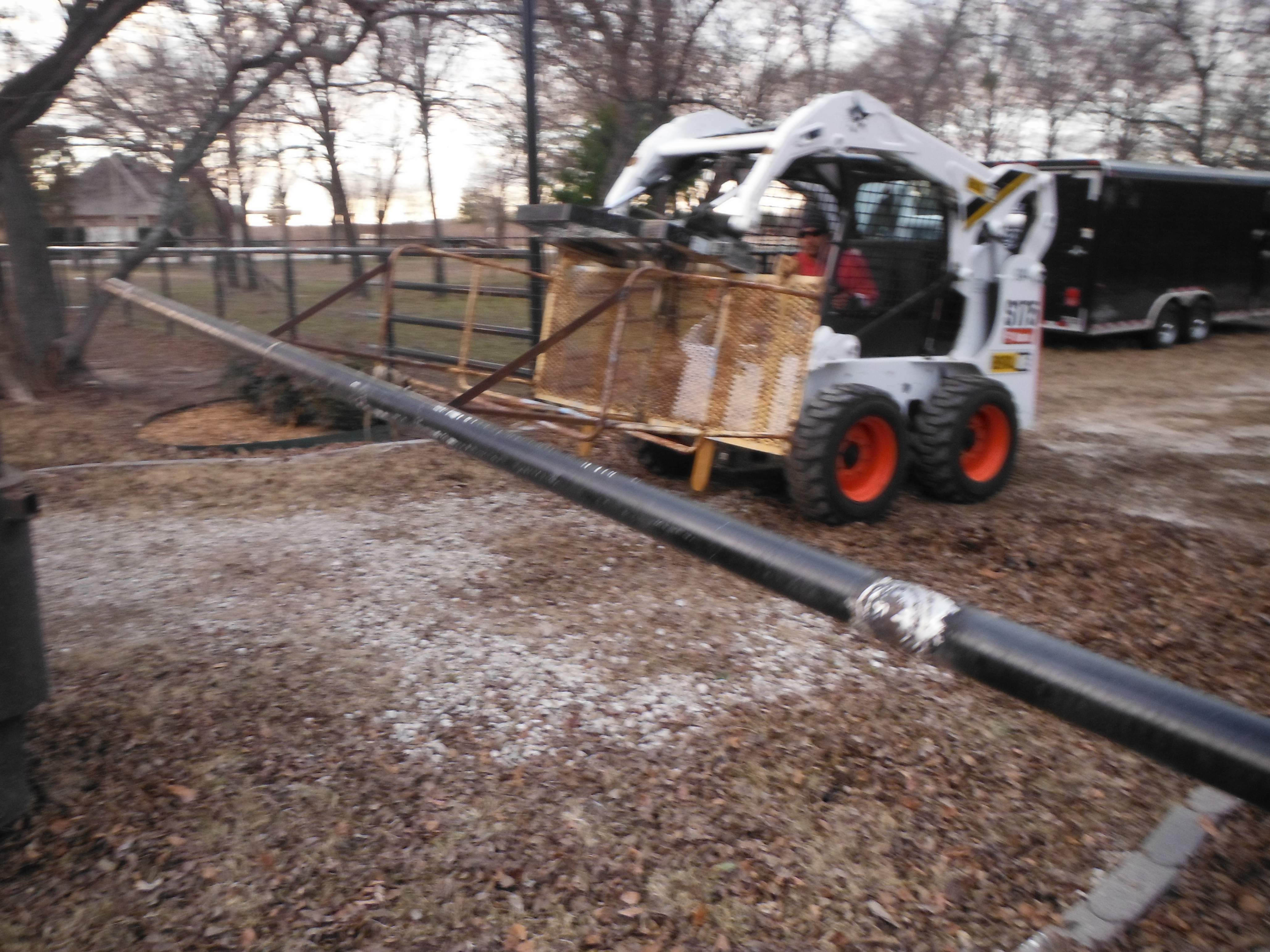

The overhead was pulled without the pipe holder attached. But when we added the new height we had to come up with something that could pick up and place the pipe safely. The 4 5/8" was too heavy to be handled without help at that height. Again, nothing but a thing.
/ Placing Pipe Overhead 15' High for Gates
This is one of those deals where you bid a job and figure that you will figure it out if you get it. I had the platform and after searching through the scrap metal on the back of the truck had the materials required top make the pipe handler.

I use an angle grinder for cutting. The easiest way I know to lay out a notch is with a framing square. It's the same for any size of pipe. I put the pipe on a flat surface and place the square perpendicular to it. I measure in 1/3 from the square to the top of the pipe. On the 4 5/8" pipe that is about 1 1/4". I then go to the end of the pipe to be cut and measure in the above distance at the middle of the pipe. I then arc back to each side. I cut that out. I turn the pipe over 180 degrees and repeat. An easy way to gauge being on the right path is to look at the end that has been cut. You should have approximately one third of the pipe original length in the middle of one third cut out at each side.

If you are looking down a pipe head on you will have a circle. Let's break that into four quadrants. The depth and width of each quadrant will be the same number. That number is what we use to find the depth of the notch we cut in the end of the pipe to make a cope, fishmouth, or notch.
The easiest way I know of finding that number on a piece of pipe that we are wanting to weld another piece of pipe of the same size at a ninety degree angle is to use a vertical line provided by a speed or framing square that is vertical and perpendicular to an edge of the pipe. If you use 2" pipe for instance that measurement will be about 5/8". The five eighths of an inch measurement is what we measure from the end of the pipe center line of the pipe. We then draw out an arc to each side of the end of the pipe from that mark.
You could accomplish the same thing by placing a piece of the same sized pipe perpendicular to a pipe at the end. The idea is to replicate the arc of the pipe on the end of the piece that is going to be welded to the pipe at a ninety degree angle. Of all the way I know of doing this I have found the framing/speed square method the easiest and universal no matter diameter of the pipe.
