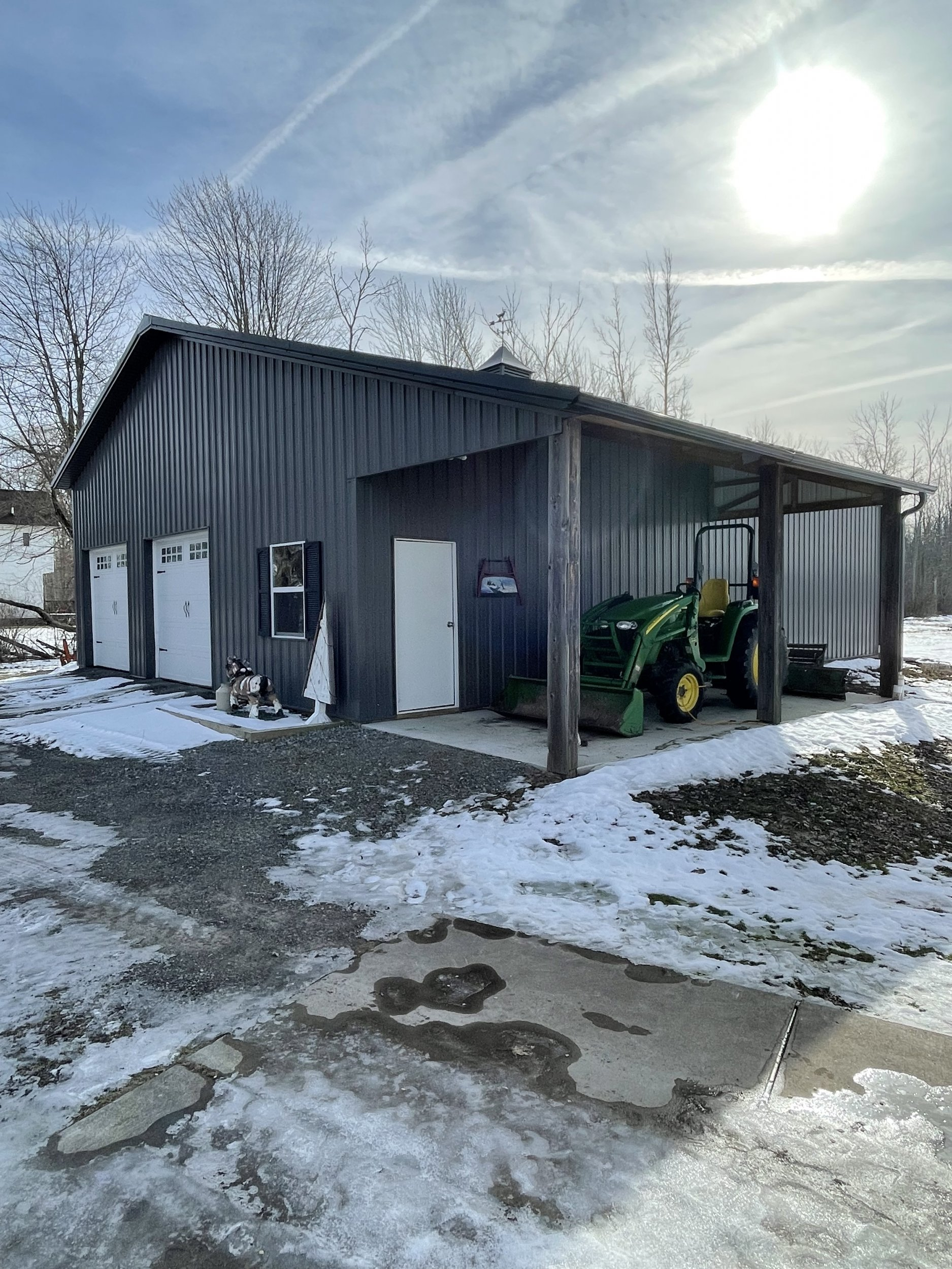

On my 36 x 50 x 12 ft pole barn, I put (2) overhead doors on the front end (1) on the back end, plus a larger overhead door on the back side. We get lots of snow, up here near the Canadian border, so I don’t use that big side door much, in the winter.
It’s the only door that I can get that tractor in, without folding the roll-bar down, so it stays out there under that front side porch until spring.
In the summer, I keep it inside, usually with a bush hog on back.
This (4) overhead door arrangement works good for me. There is a second man door under another 10 x 25 ft porch on the back end, similar to the one under that front side porch, of the same size.
I had planned on using the back porch for firewood storage. I needed more inside storage, so now I’m enclosing the back porch and building a 25 ft x 8 ft lean-to on the back of it, for firewood storage.
I’m going to make a set of swinging doors, 10 ft wide x 10 ft high, for the enclosed back porch. Those also will not be used in the winter.
