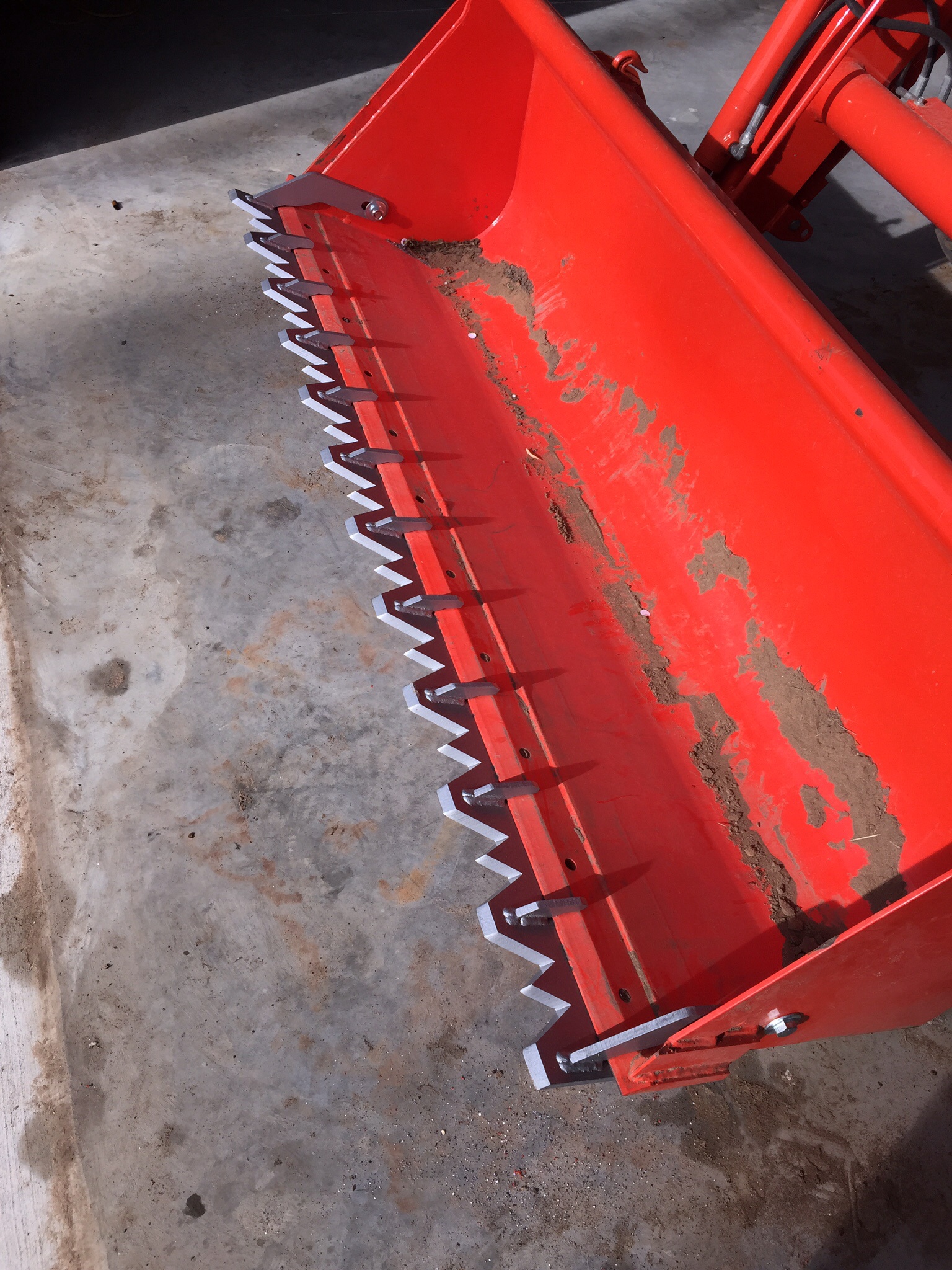

I finally got my PTB put on.
Just out of the package. Notice the missing cutouts for quick-on forks. I requested no cutouts since I don't plan to add forks to the bucket.
Testing the initial fit on the bucket. I tapped the bar with a 4 lb hammer (2x4 between them to keep metal from hitting) to set it as tight as it should be when it's installed. Then I added the welding clamps to keep the bar against the cutting edge. I tapped the bar some more just to make sure everything was tight.
Marked the holes with a permanent marker. Drilled pilot holes with 1/4" bit. The instructions said a smaller size, but 1/4" fit the first step of the step bit better. The final size of the hole was one step below 3/4". When you get close to the final hole size check the bolt in the hole to make sure you don't go too big.
A note about step bits: Don't go too fast and be careful. They like to grab the hole and will twist the drill in your hands. When you get the hole to the correct size run the bit on the other side to clean up the hole.
20150115_191654 (Small).jpg 20150115_191703 (Small).jpg 20150115_191710 (Small).jpg
Toothbar fully installed. Make sure you tap the bar with the hammer and keep everything tight. Tighten your bolts and you're done.
20150115_192503 (Small).jpg 20150115_192509 (Small).jpg 20150115_192520 (Small).jpg 20150115_192526 (Small).jpg 20150115_192559 (Small).jpg

Looking good. Just watch yourself walking around the bucket now. It took a couple of bites out of my ankles until I gave it proper distance. It's a little beast. Also took a chunk out my fence and a deck post getting used to the extra length.

jjs, nice write-up with pics!
I remember someone else saying that when they installed, they decided to reverse the bolt/nut direction. Their thought was that the bolt end may get buggered up some and may make the nut hard to remove. Don't know if it's really anything to worry about, but seeing your pics reminded me of that, and thought I'd just mention it...

Received my step drill bit set last week so had a chance to drill final holes on bucket last Friday.
Step drill really works well and saved a lot of time. Took less than 2 minutes per hole starting with a 3/16" pilot hole.
The PTB bolted right up with no issues.
I'm anxious to get out to use it.
