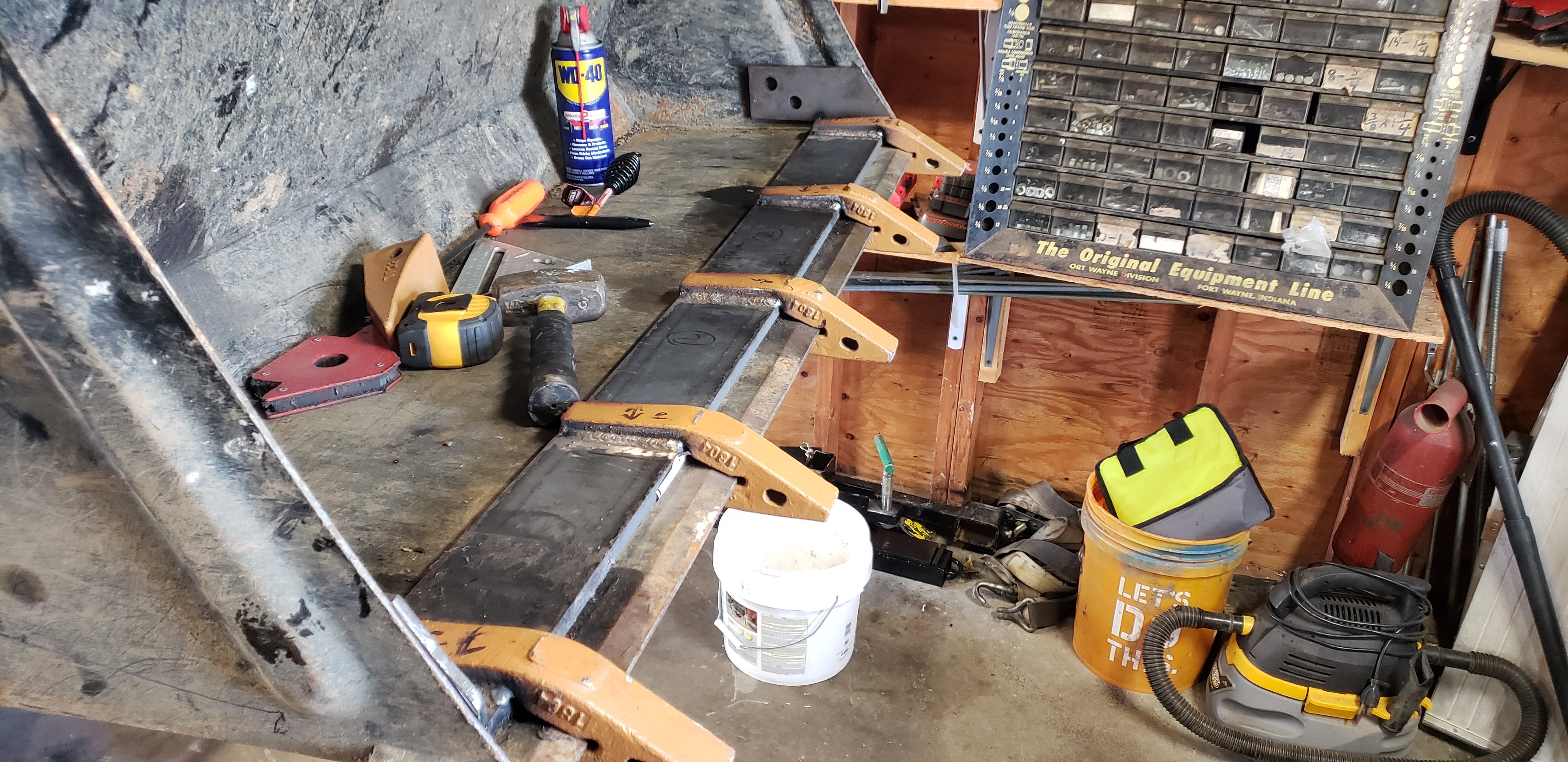

So I decided on the titan tooth bar so I can use my pallet forks and bucket forks for my plow.
I will be welding it up tomorrow. Here are a few pics of the mock up.

Looking good. Those are some serious teeth.

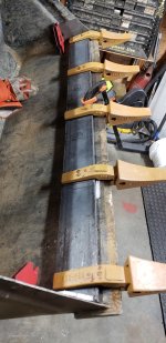

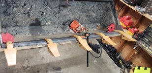

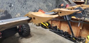

I bought 8 Titan teeth, and then a piece of 1/2" x 3" flat stock.
I made my bar so that with shims, I can use it with either of my buckets.
Easy to swap, and works great.

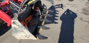

All finished not bad for a amateur....
/ Piranha bar or tooth bar #9
Thats a very cool and great looking job !! Now go dig up the ground !

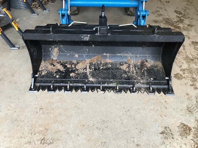

I think our tractors are about the same size. I cut and welded up my own Piranha type tooth bar. It works real well on a smaller rig plus reinforces the bucket. Ours has seen quite a bit of use and the design was to also reinforce the bucket edge. To me the bigger teeth belong on a heavier rig. Probably depends on the uses. Here's a pic of it new. Edges are all good yet, put the paint on the edge some how wore off....bucket.JPG
/ Piranha bar or tooth bar #15
I think our tractors are about the same size. I cut and welded up my own Piranha type tooth bar. It works real well on a smaller rig plus reinforces the bucket. Ours has seen quite a bit of use and the design was to also reinforce the bucket edge. To me the bigger teeth belong on a heavier rig. Probably depends on the uses. Here's a pic of it new. Edges are all good yet, put the paint on the edge some how wore off....View attachment 585728
You did a nice job cutting and welding that tooth bar.
