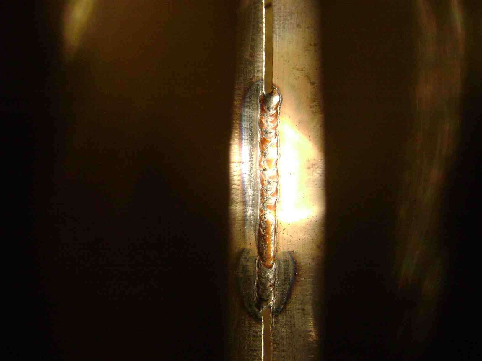

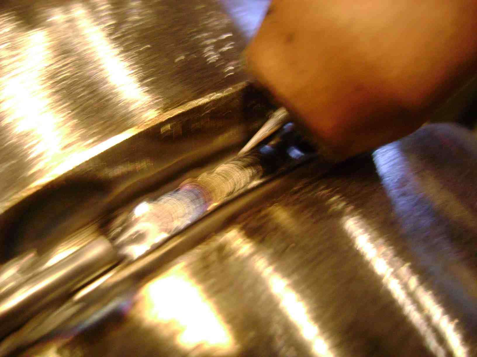

I want to make a hot water heating manifold using 2-1/2 inch pipe for part of it. I have bought 2-1/2" butt weld caps and butt weld reducing couplings. The butt weld fittings are already beveled and have a nose on them. I plan on beveling the pipe to match. I am planning on Tig welding the root pass (open root) then using 3/32" 7018 on the final pass. I have never tig welded pipe before. When I was allowed to weld pipe I always put the root pass in with 1/8" 6010, cover passes with 3/32" 7018. But that was always with 4" and larger pipe.
I am thinking or guessing that I can gap the butt joint 1/8" and tack it in 4 places and put that root weld in with no filler rod. Am I on track or is done differently?

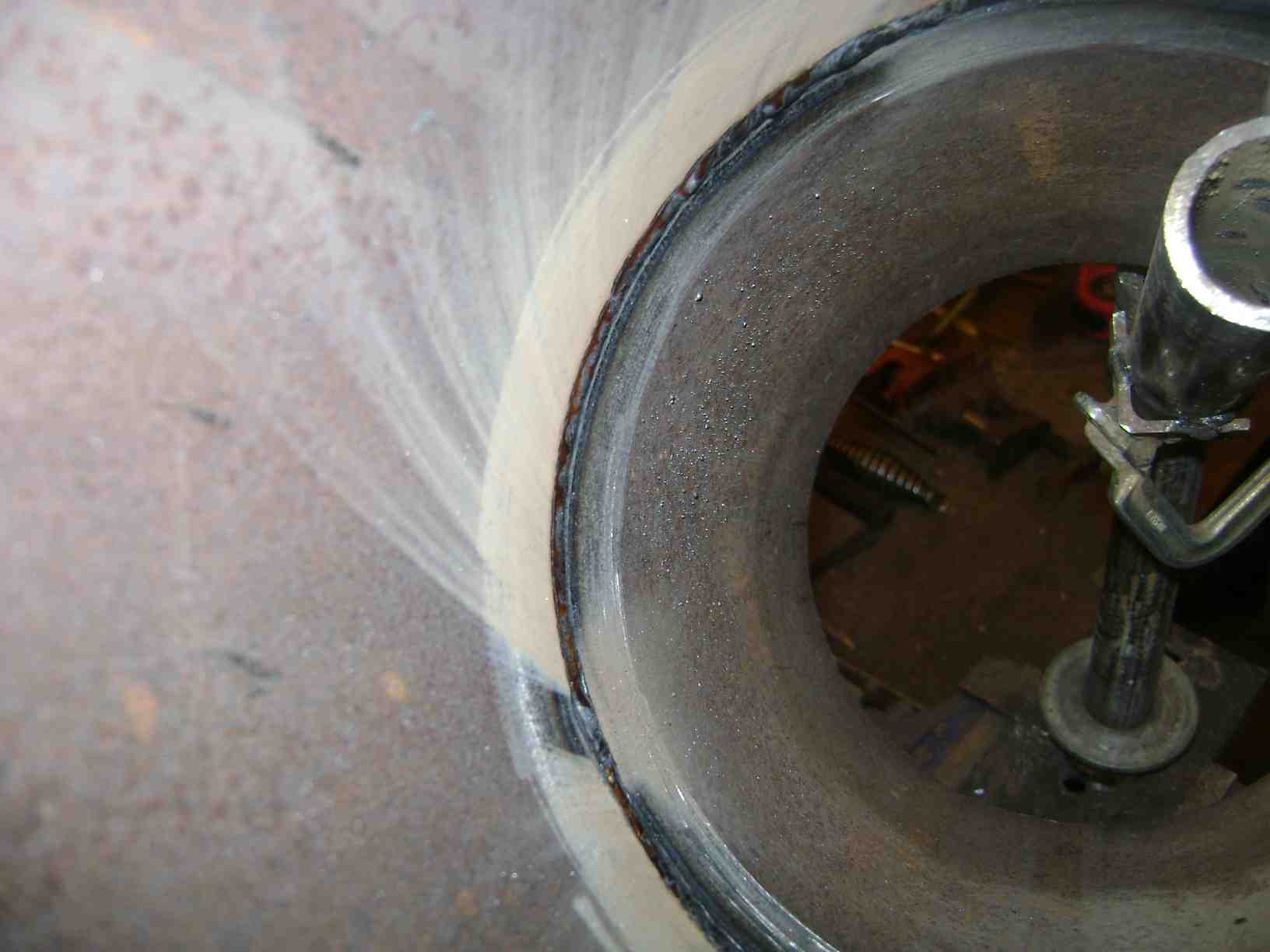

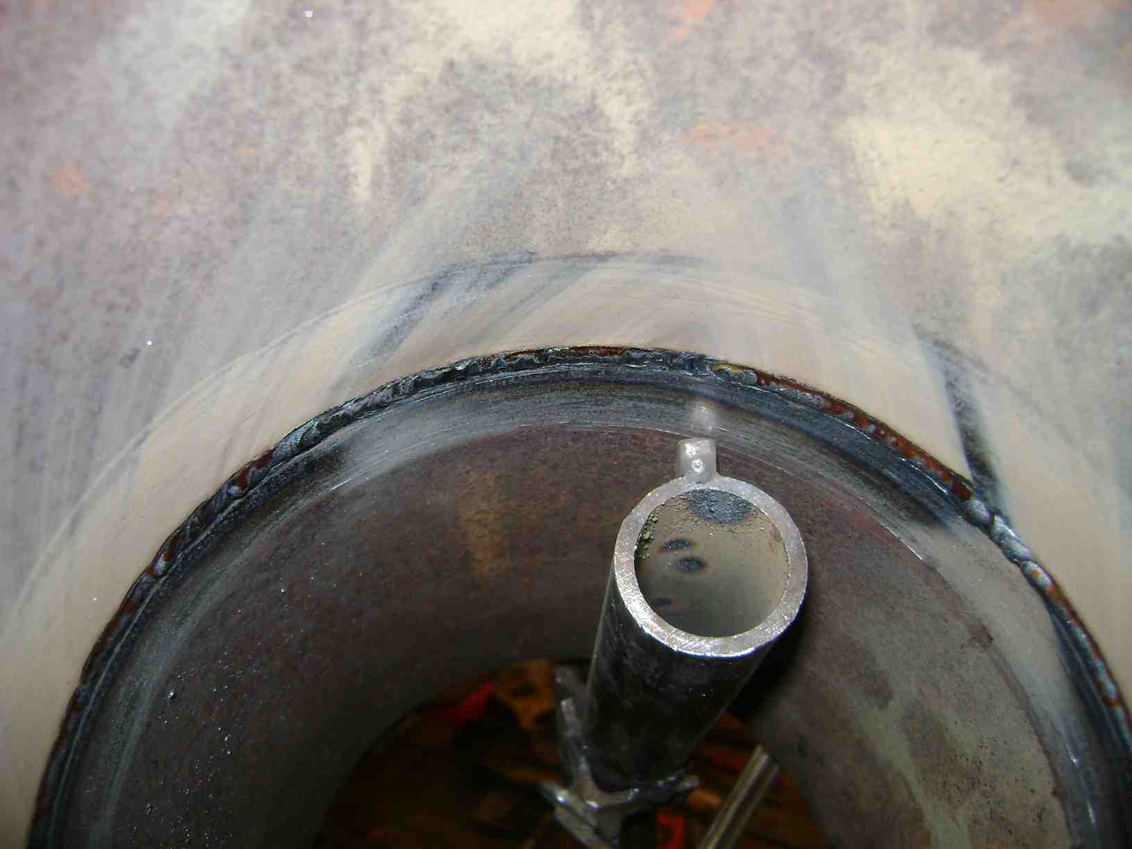

For open root Tig welding like a 37 1/2 degree bevel. About 1/32 inch land. With 3/32 inch gap. I use 1/8 inch filler, at around 95 to 100 amps.

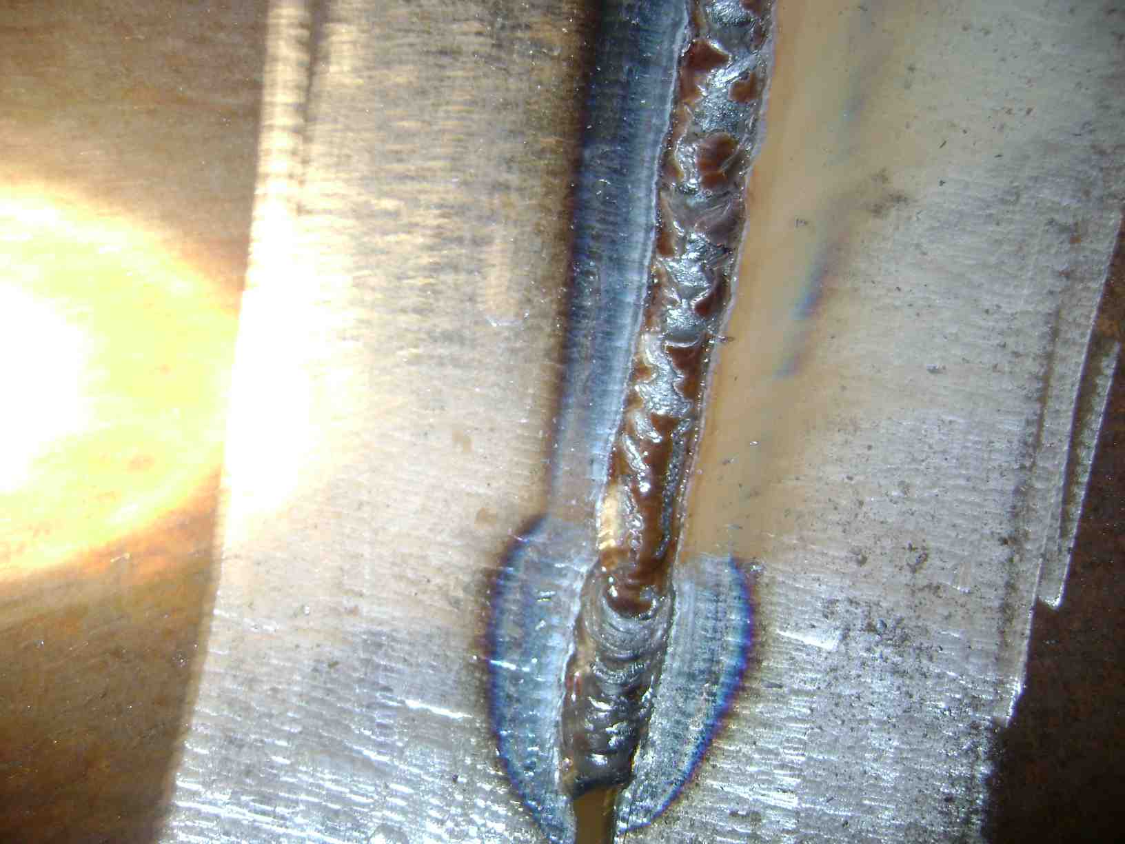

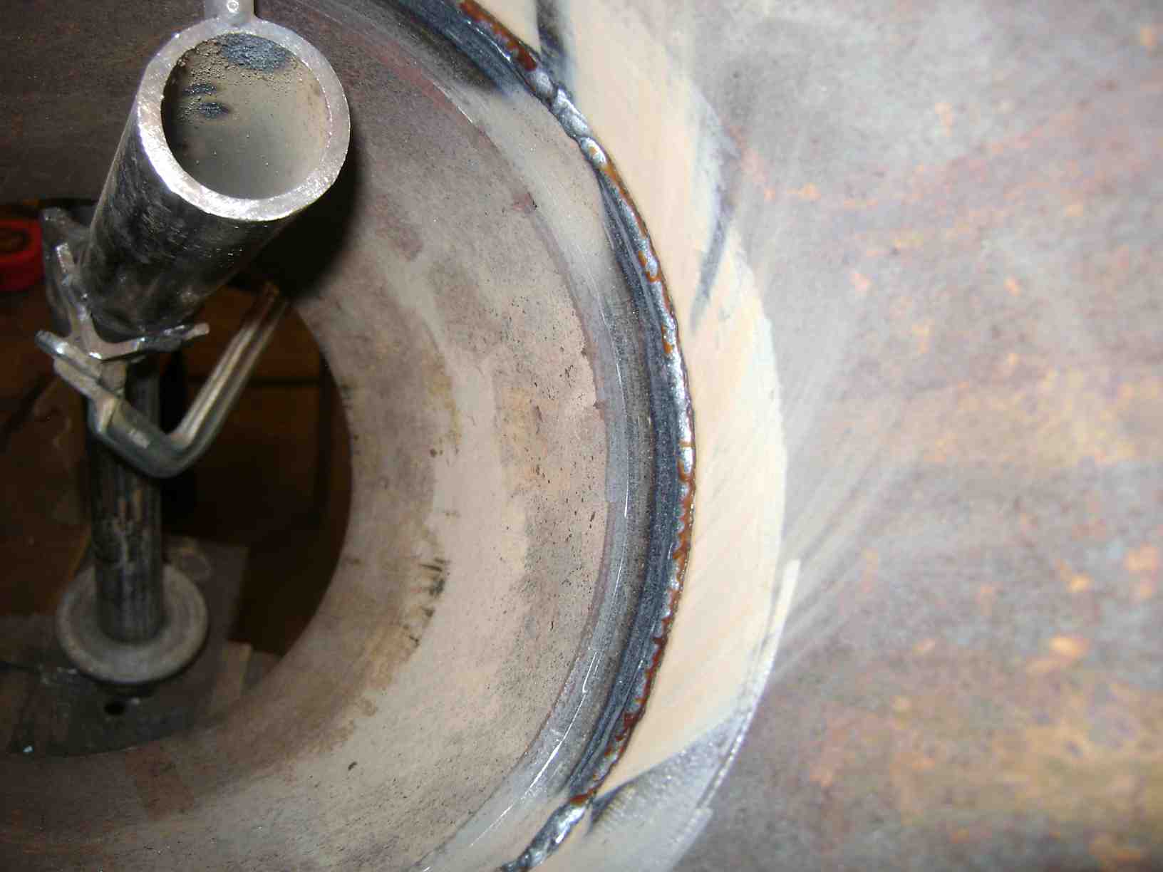

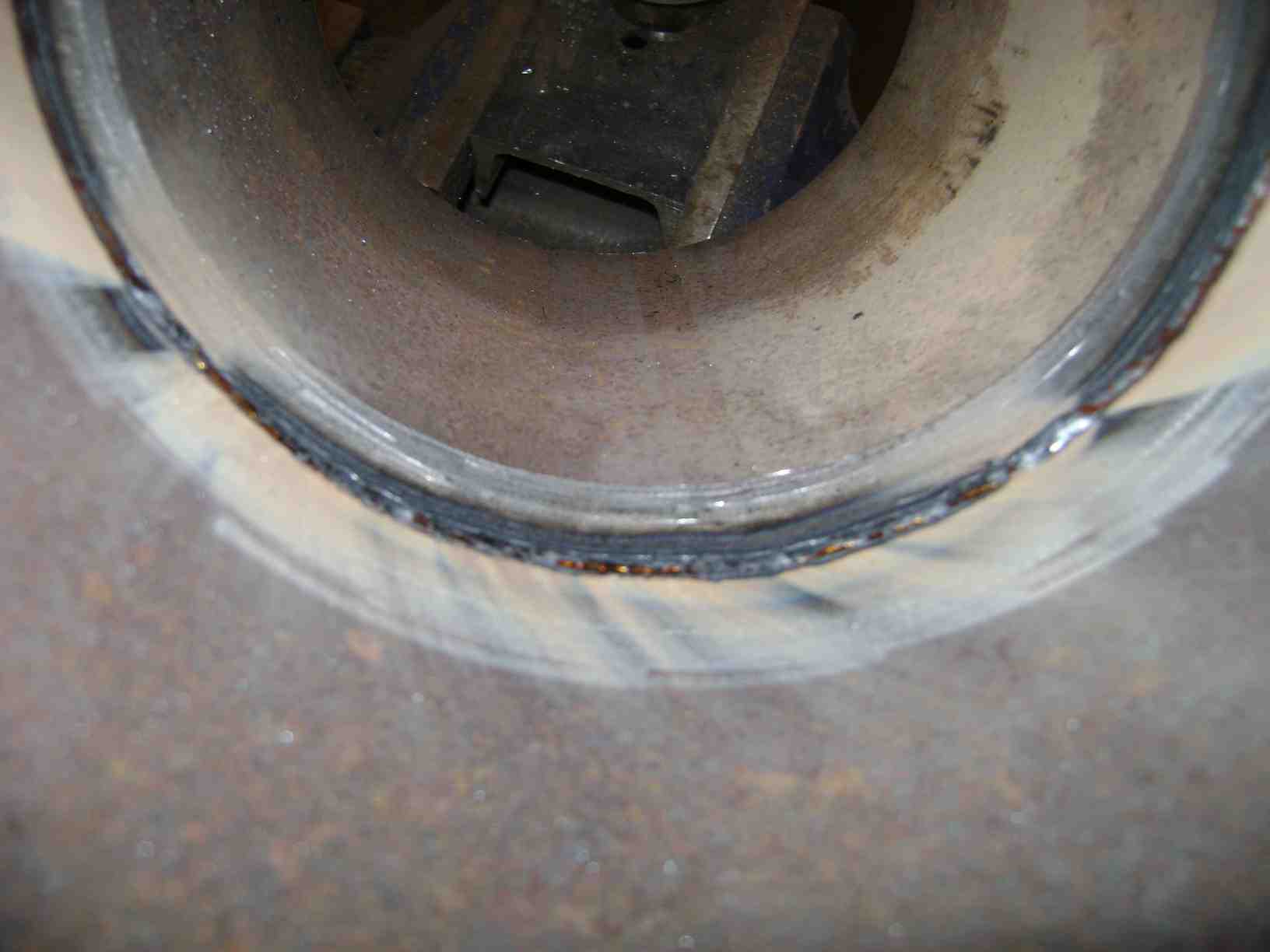

I wouldn't go with anything less than 3/32 inch gap. Reason being, the gap will close up on you as you weld. When it closes up you have to take a zip disk to open the gap up. Or you will not get any penetration.
99.9 % of the time I walk the cup on the root, with the lay wire technique. The hot pass, and fill I free hand and dip the filler.
With 37 1/2 degree bevel a number 7 cup rides perfect in the joint. I also take a mil file and knock off the sharp edge on the outside of the bevel so the cup will walk real nice.

I like a 1/8" gap, feathered. 1/8" filler rod. I walk the cup.
Then a tig hot pass, then stick it out.
This is really advanced pipe welding.

Tack up using the 1/8" rod as a gapping tool(bend in a "u"shape.)
As you finish the tacks the joint will shrink slightly giving a perfect gap for 1/8" filler wire.Yes I would "Tig" all the way out,it's only 2-1/2" pipe.
I have done thousands of joints like this over the years,some 100% X-Ray.When you start to weld up if you have everything right you will see a "fish eye",tells you that you have perfect penetration.

All advice is OK if you plan to roll it out. If done in position using an 1/8" rod, you will need to tack up with a larger than 1/8" rod because you have to insert your rod inside the pipe on the bottom and use the rod to hold the puddle up. I would use a 5/32" gap for 2" pipe and for 6" and above you may need to go to 3/16" gap. I have had to use 1/4" gap on 24" and larger and still sometimes have to use a grinder to open up the gap a bit on top. Otherwise you will have a concaved root pass. This is OK for homebrew welding but it wont pass XRAY.
I think a 1/8" gap is fine for TIG on 2" pipe if you can quarter weld it while always having the weld area on the top quarter. You may need to go to a 3/32" filler rod for the last quarter since the gap will be getting pretty small by that time.
