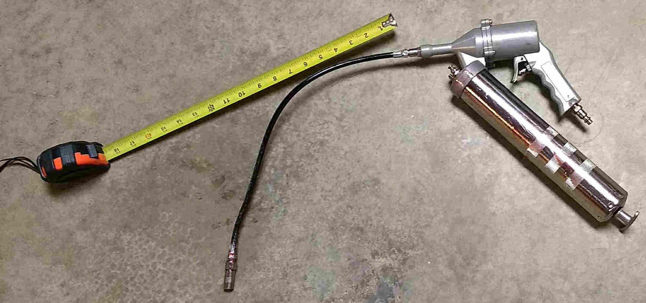

I just lubed mine using this. It has the 18" flexible grease hose from HF on it.

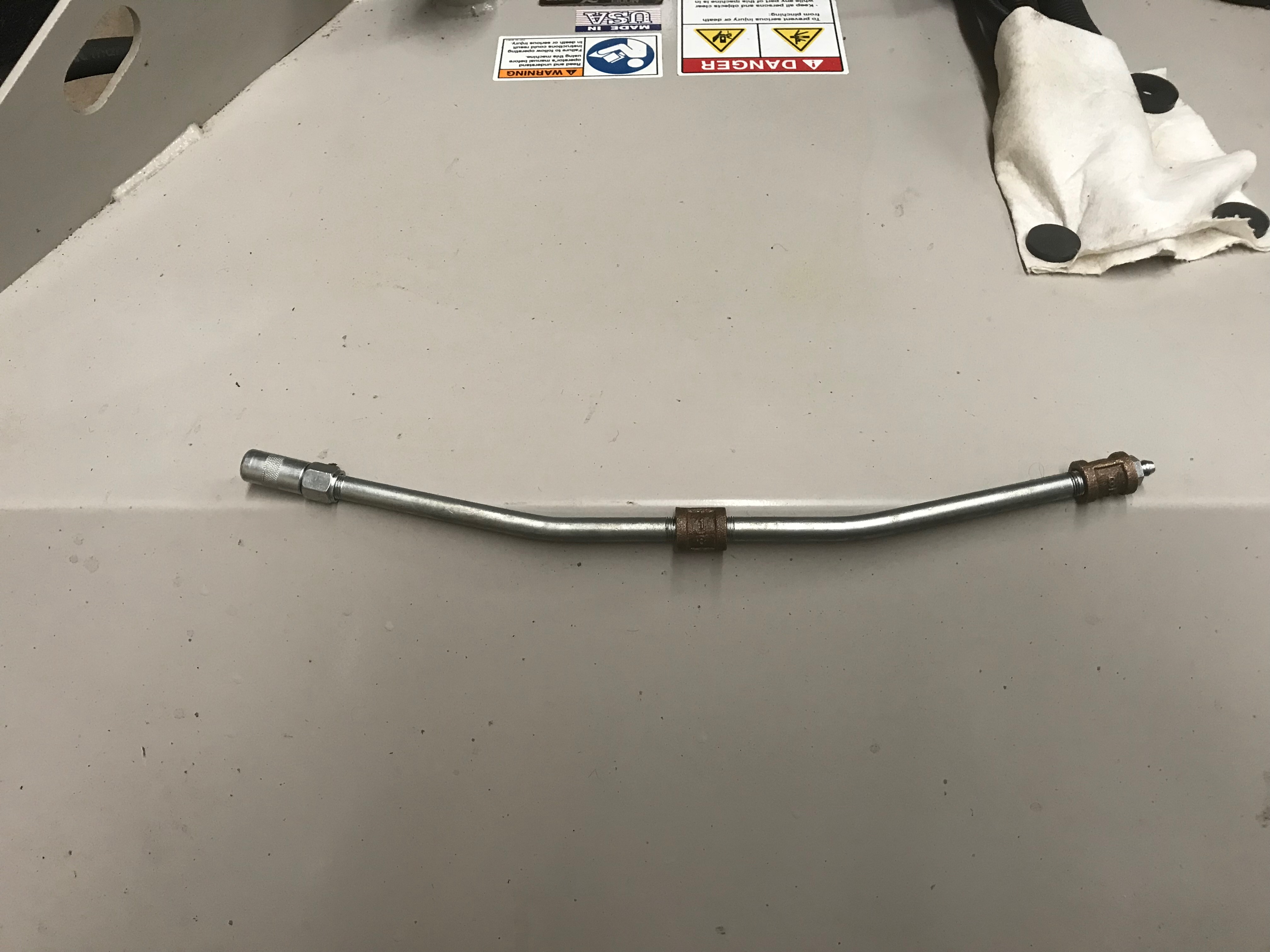

Hi, Murph.
I have made two. One is described here. The second one uses two 6-inch extension pipes with 30-degree bends in them, similar to this one. Below is a picture of the second one sitting atop Broomhilde.
