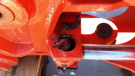

Attached are pictures of the washer freshly ground off along with a side-by-side of a new pin versus the one removed. Best guess is that the assembly has not seen a bit of grease since it was manufactured. Strangely, the other side is greased and is good as new.
I am one dang bolt away from removing the swingframe from the boom. Heat and cussing failed to convince it to yield so the just delivered slide hammer is about to be put to the test. This was after constructing a Rube Goldberg frame to prevent the boom/dipperstick/bucket assembly from falling over and creating a cart that would hold the mainframe and stabilizers so that they could be wheeled out of the way when disconnected. It is an interesting education. Turns out that I have a welder/machinist a couple of hills from here and once that final bolt is coerced out I will be delivering the swingframe and DOM tubing to him. Hopefully, the end is near.

Was the washer ONLY welded to the pin? If so, I still maintain it is purley cosmetic.
If the washer were welded to the swing frame, or both, then I could see it as a temp solution to lessen slop.
But from the looks of it and where it wore, there looks to be little wear around the center of the pin where the cylinder hooks. And this is the only place that should need it. The pin is bolted in place and shouldnt rotate in the swing frame. So there shouldnt be much wear there? Other than the pounding it takes. Certainly an odd occurance

The washer was welded only to the pin. Had I been smart enough to put a mirror to the bottom of the pin, I would have noticed that the bottom bracket was hanging by a thread to the pin and a tap with a chisel would have negated the need to grind. There was minimal wear on the pin where it mates with the cylinder hook, but while I have it all apart I intend to replace that bushing also. Does anyone know if that should simply knock out or do I need a hydraulic press to remove and replace?

Thx for the new pix. This is a real puzzle. How one side would be ok and the other side such a mess. And as LD1 says, what happened to make the pin start chewing up the swing frame, while the part of the pin in the cylinder rod end stayed more or less ok.

I would say that the cylinder end was hard fasted to the pin. No rotation put all the force above andbelow that area, which had no grease so it wore out the hole in the swing arm which is softer than the pin.
/ Pin Hole Too Big #74
Yep. My guess would be that the grease zerk on the cylinder stopped taking grease and whoever did the service didn't notice, or didn't care until the pin fell out. Then they probbaly welded it back together a couple of times and eventually put the washer on top.

The way the pin is retained, it HAS to rotate withing the cylinder clevis. It CANNOT rotate within the swing post unless the bracket breaks.
Which is quite possibly what happened. THEN it would be allowed to spin in the swing post. Which wasn't bushed with hard material, because as designed...it isn't needed

It was broke in the picture
/ Pin Hole Too Big #79
Yep. But could have have broke during removal.
In either case, once fixed and kept freely spinning with lube in the cylinder eye, the swing frame shouldn't wear at all

Looking at the welds on the bottom of the worn pin, I would guess that it was re-welded several times.
