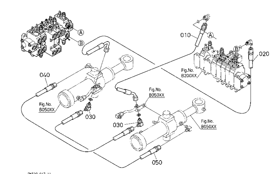

I've done a bit of repair work like this before, mostly on trash trucks and heavy equipment( excavators, wheels loaders etc.).
Couple things I've noticed, first is that Kubota uses a cast swing assembly, what it's cast out of I don't know as I've never had to do any repairs to one. This will greatly effect the repair based on its weld ability. If it's a cast iron you'll have a hard time welding DOM to it and will require a very good press fit, something I've never seen done by hand well enough to last. A less then round hole will quickly pound the bushing lose again.
Even if it's a cast steel it can be pretty hard to get a good fit by hand and the small movement can cause the weld to fail, I've dealt with this first hand a number of times.
This repair can be done on the machine, the best way is to use a line boring setup, not usually somthing you can rent, but depending on your mechanical aptitude, a simple one can be made.
Have you pulled the pin and looked at the lower hole yet? Curious to see if it looks the same.
As for the washer welded on, I'm not going to assume what the person that did its intentions were, but if that pin was moving enough to break or loosen the retaining bolt it may have been welded on to prevent the pin from falling out. I've seen this done before. Somtimes it's done on the job sites by whoever, even on rental equipment when it's long term lease.
Another thing I've found in the equipment business is that good working order doesn't mean prefect and tight, just that it functions as it should and is operable which it sounds like this unit is. Not defending the company as I don't know who did the work or if they did anything intentionally to deceive or not.
Just some observations from being around equipment and rentals.

Actually it looks like a small pin was used.
OEM pin replaced with smaller one and washer added to keep it in place, then left in half-baked state before sale?
Have been using 'stress-proof' free-machining steel for pins. It has extrude-formed uniform OD (like DOM) so surface-toughened a bit similar to shot-peened. Tough enough to work but just soft enough to take wear vs holes getting worn oblong. Drill & tap for 'keepers' etc vs weld, as its free-machining components deny decent welds. (Be sure to add grease groove(s) to pin or bushing(s) as needed.)
TOG
/ Pin Hole Too Big #58
I am leaning towards the last 2 posts
notice pictures side by side?
the wall thickness of the tractor side of pin hole is visually the same about casting web thickness
also notice distance from center line of pin to back of the cylinder diameter
also notice the cylinder is vertical as in the top and bottom pushed back the same
So I think a smaller pin was used; notice it is a lot smaller than other-side? compare pin size to a casting flange for comparison
I say factory pin was sheared, possibly doing some damage to bore which forced an under size pin to be stuck in it and a washer keeps it from falling out...or they didn't have a factory pin to replace it with
