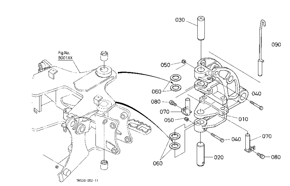

Almost like there's supposed to be a bushing in there that's missing.
/ Pin Hole Too Big #22
Kinda my thoughts in requesting a pic of the other side as well.

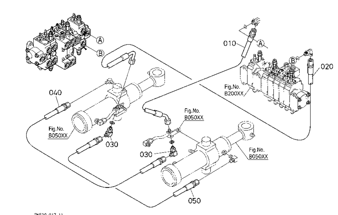

If the boom swing cylinders were push-pull (DA) type (rather than push only SA like a snowplow), and the one cylinder is good an tight, pushing the boom my hand wouldnt show anything unusual.
Looks like its a pair of double acting cylinders with the rod side of one teed to the base side of the other:
That hole looks really big and suspiciously round, I almost wonder if that pin is too small for the hole (ie: the original pin was replaced with a skinnier one)?

Agree about the hole looking too big and too round as mentioned.
If they are DA cylinders as you say Aaron, and the other side has a right pin, you wouldn't see any slop by hand. It would operate similar to a rear blade or snowplow with a single cylinder.
Some are set up as push only cylinders, then you would feel every bit of that slop by hand.

Generally DOM tubing is great to make bushings.
ID is accurate and plenty of OD to machine down to hole size. Also enough 'meat' that there is no distortion when welding the bushing in place. Even if the OD is not perfect fit for the worn out hole welding takes care of that. Just have a length of pin on hand to assure good alignment when welding the bushings in place.
Naturally a reamer assures proper alignment and fit.

Need to break it down and at least remove the pins and swing the rod ends out to see what is going on.
But I notice in your picture the two bolts that hold the pin in, the one on the right looks backed out and the one on the left looks rounded off. Two different type of bolts as well, by looking at the markings on the heads.
/ Pin Hole Too Big
#27
The left side pin is good to go. Proper pin size is 1-1/4 in. and the covered, oversized hole is roughly 1-3/4 in. There is no bushing on the swing frame but there is between the pin and cylinder's swing rod. The swing rod has the grease fitting and the guess is that it wasn't lubed, resulting in the swing rod freezing to the bearing which froze to the pin with apparent impressive adhesion. The best guess regarding the nice roundness of the oversized hole is that for every movement of the backhoe to the left there was also one to the right and the two swing cylinders were nicely balanced. I still haven't ground off the washer as I found that they also messed around with the wiring to disable the seat safeties and for some reason installed two in-line 40 amp fuses that were mysteriously installed underneath the body, so now I'm trying to re-trace their logic and return those things back to spec.

PILOON - Thanks for great suggestion. DOM tubing is something new for me and, in looking at its specs and price it seems that a length could be fit and welded to go from the top to the bottom of the frame, filling both holes, and then the middle portion cut out to make room for the cylinder's swing rod. That should assure (pretty much) alignment of the two holes. If all goes well, that might mean that the work can be done on site instead of having to take the swing frame to the machinist.

1.25" ID x 1.75" OD is a standard DOM size. A couple pieces welded in top and bottom, using a pin to hold them in line. Done. Might have to work on the holes a bit with a small flap wheel to get the 1.75" OD fit. I would guess it can be done without further disassembly.
