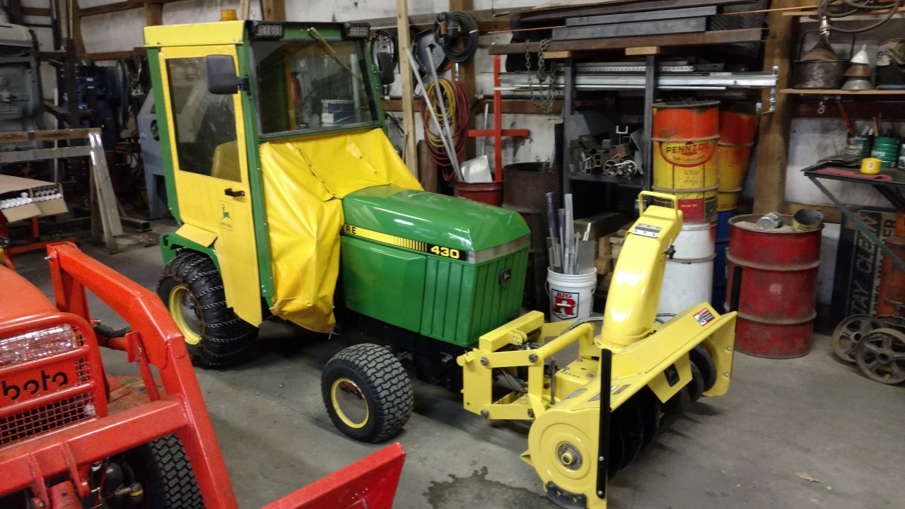

Finally got my JD430 restoration finished up. Last thing was to get the fabric cowling modified at the local tarp shop to make it fit better. Got it back and mounted the blower to it with the new mount that keeps the drive shaft happy when raising and lowering it.
Weatherman says we may get snow every day for the next ten days, but I'll believe it when I see it.

Nice work! Love to see this old equipment gain new life. Looks great!
Thanks. I had the seat pan, side covers and grille blasted and powder coated. Did some other minor repairs while I was at it too.
It's a '91 model I bought in '93, used for mowing in the summer and snow removal in the winter. Got tired of swapping the snow equipment and the mower deck twice a year, so I bought a BX2230 that is on mowing and landscaping duty now.
The 430 is hardly broken in, only has a little over 1000 hours on it.
