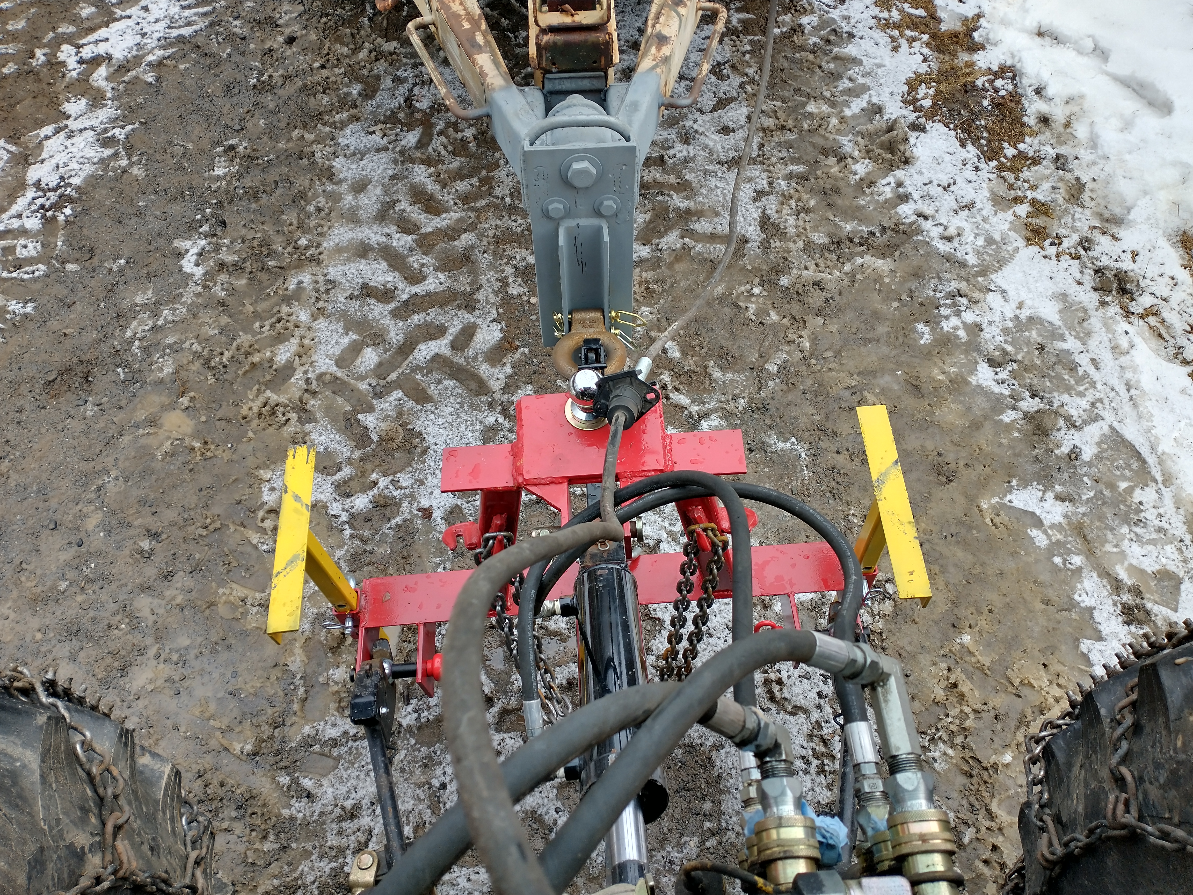

Hey all. Just wanted to show version 2 of my snow rig. The first was a 2016 l6060 with a 7.5 Curtis with wings. The biggest change to this new tractor is a 8-10' western wideout. The Curtis was used on the first because the mount is much narrower and fits between the front tires. The Western has a very wide mount and required some modification to fit. Western makes a mount for these tractors now but it pushes the blade way too far forward for my liking and they want like 900 bucks for it. The blade I used was the oldest wideout in our work fleet since I'd be cutting off the lights, hydraulic unit and parts of the mount. The raise and tilt is plumbed to the loader valve with flow control valves on all lines and a crossover relief on the tilt. the wings are plumbed to the rear remotes with 1/4" lines.
The other things ive done are front and rear led lights including integrated strobes with a separate strobe controller because i got tired of my old lights randomly switching patterns. The only problem is i accidently got spot beam instead of flood lights so i may change them at some point. They're all dirt cheap ebay lights anyway.
As for the Tires, these were saved from the previous tractor and ive loaded all 4 with bulk washer fluid. The tires that came with it are in storage until spring and wont be loaded. Estimated weight added is about 80lb to each front and 400 to each rear. With the estimated 1000lb weight box it puts the total weight of the tractor at around 7000 which is pretty comparable to a 8 lug pickup. The added weight makes the tractor very stable and predictable which is super important for my route because i plow around many vehicles including ambulances and news vans and really dont want to risk sliding in to anything. The only downside to such a heavy tractor is that the few places i have to plow uphill is lots to ask from 60hp.
Otherwise, the fenders were made by me for the first tractor out of a 40 dollar trailer fender and some scrap since the only set i could find was like a grand and the plow mount was just the same one i used for the curtis cut up a bit and added to. The weight box was also made of salvaged 1/4" plate and whatever scrap steel i had poured in to concrete.
So how does it perform? In wide open lots it performs about as fast as any 3/4 ton truck but, of course thats not what its for. In tight cut up lots, high traffic areas, and lots with blind corners and obstacles I cant imagine a better machine and ive plowed in just about everything including well set up skid steers and wheel loaders. If I was told that all of my accounts would be 24 hour fast food and gas stations from now on, I'd be totally fine with that.

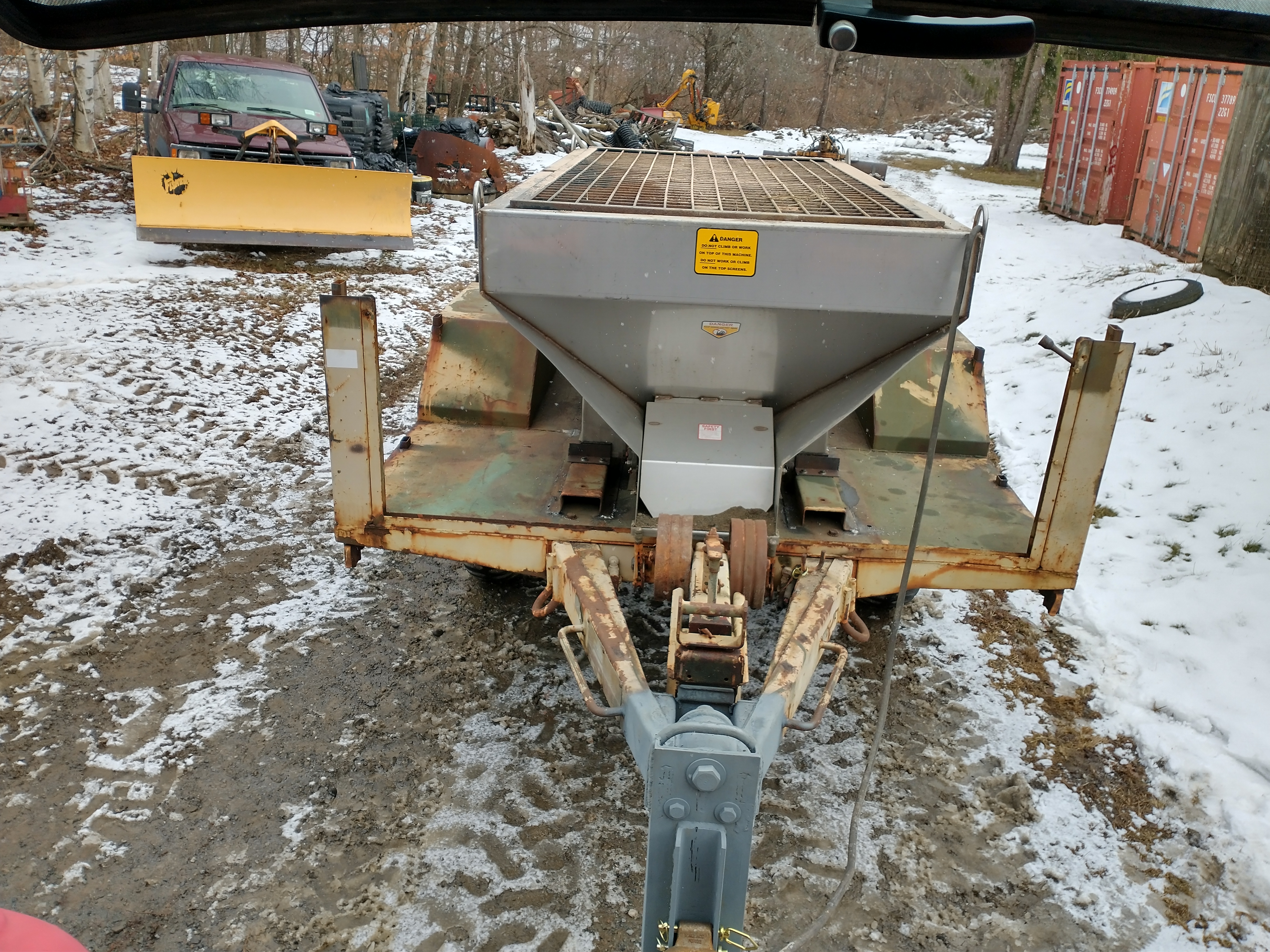

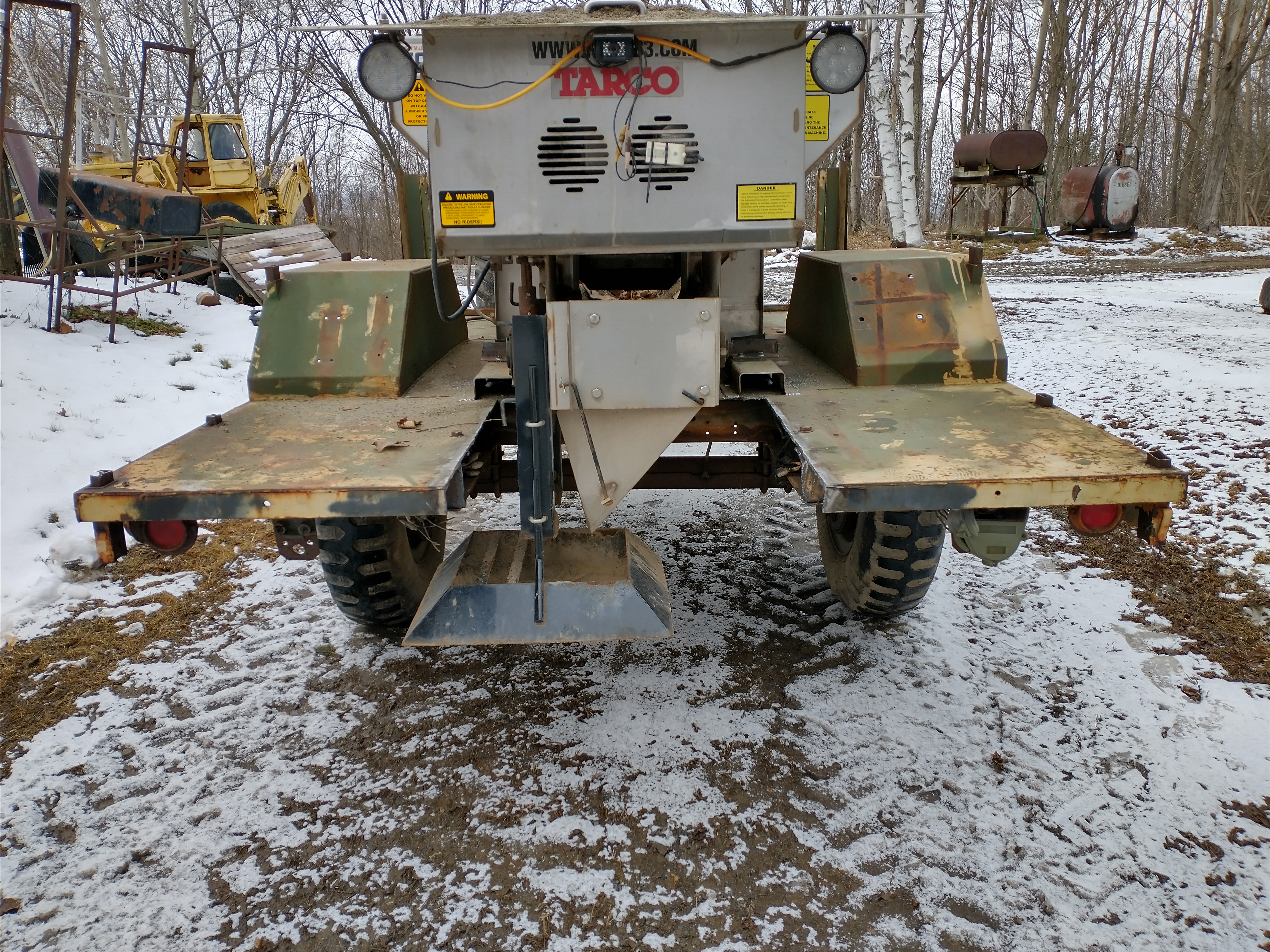

Been slowly getting my sander transferred from an old pickup that the mice have been having a field day and I'm tired of keeping insured and licensed to a trailer;
to this;
Bringing her out for a small test run today
Fairly well secured to the trailer
View from the cab looking back
looking out the rear window down at the hitches
She works now just the finishing up to do,
add an electric hydraulic brake actuator, get it plumbed in, get the the brakes on the old M-103A in shape,
add a trailer brake controller to the tractor, and get some chains on the trailer tires.

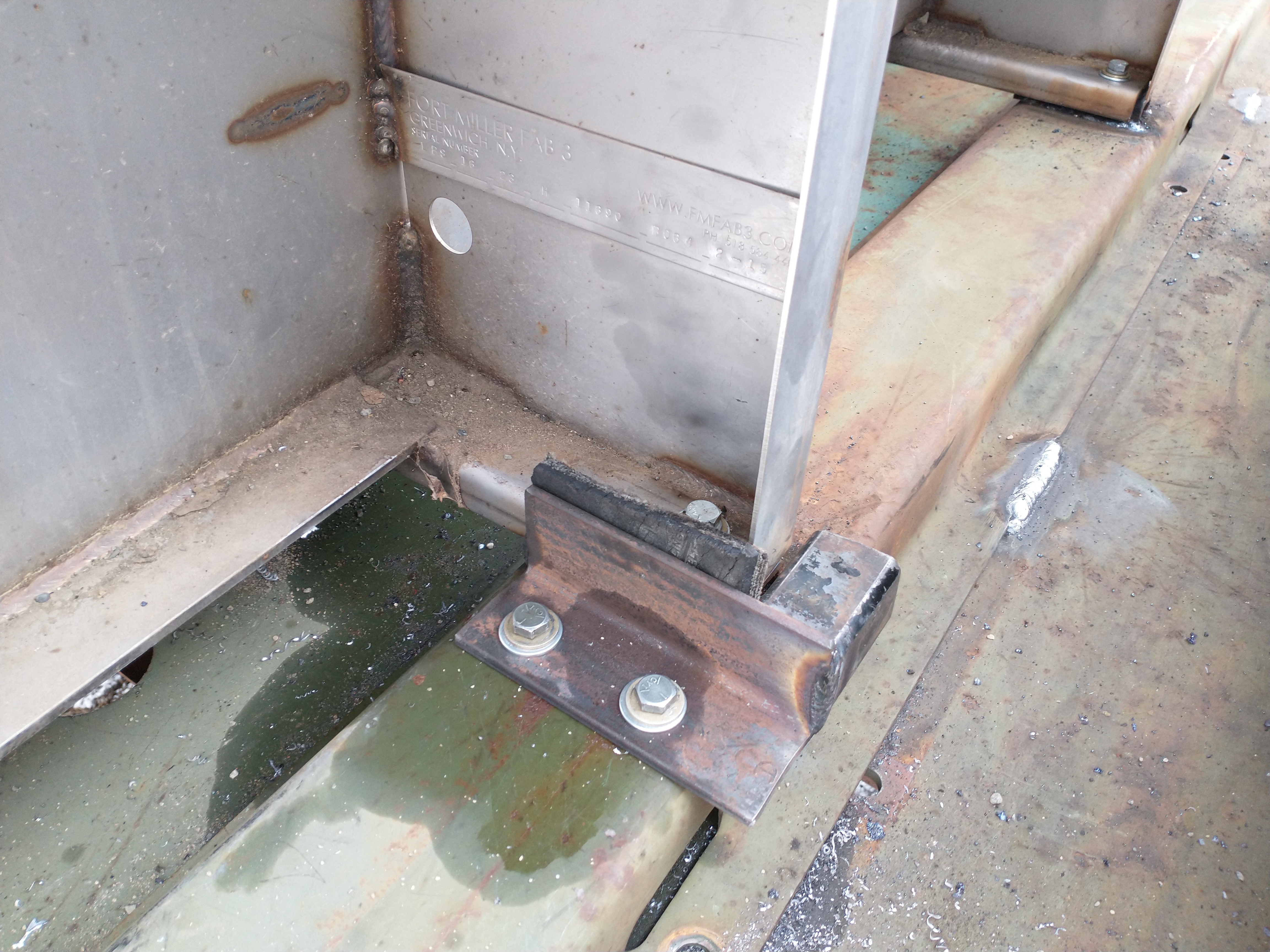

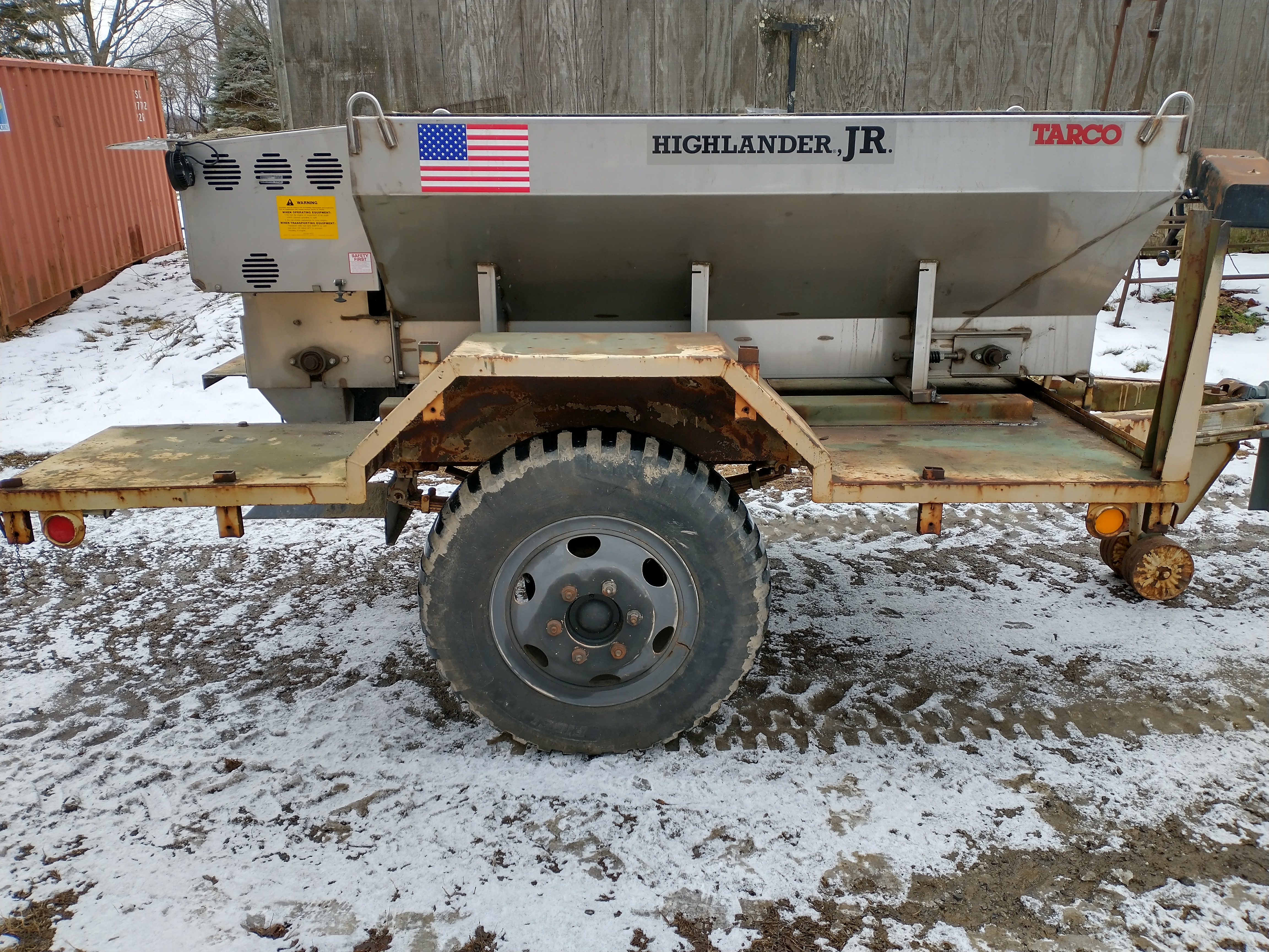

It started life as a generator trailer for two generators,
I had to move the mounting rails for the spacing I needed as well as put quite a notch in the rear for the center of gravity
of the sander. And remove the high hitch and dropping it down a bit.
The nice thing is the height of the bed was just about ideal. And the original brakes are air over hydraulic so they should be
a fairly easy swap to electric hydraulic.The single axle with 9.00-20 tires will take any rough roads (occasionally I sand a few feed lot trails)
that I get on and it can handle the loads easily even with a full yard of sand.

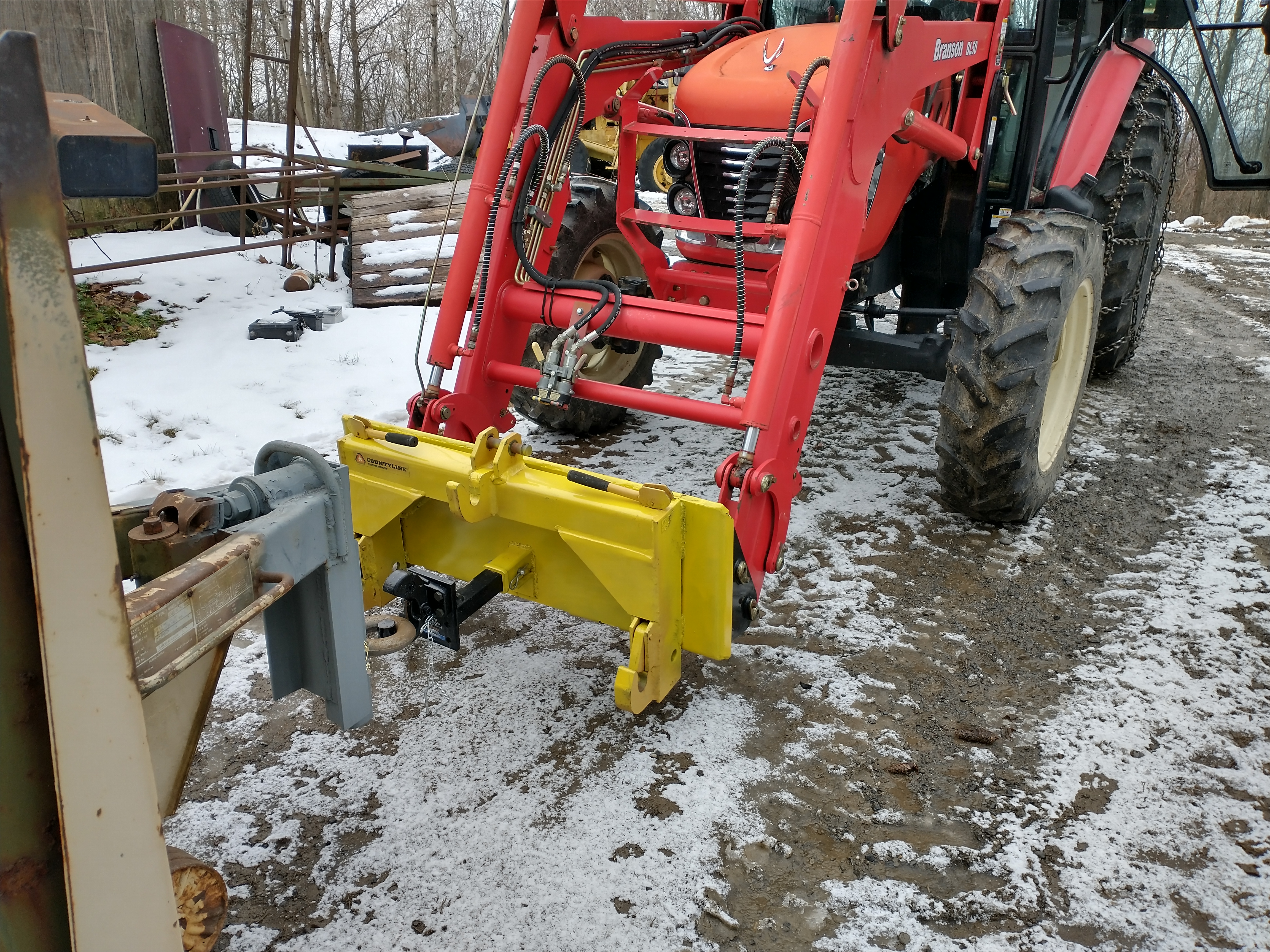

Mr. Lou, just wondering...what's the benefit of chains on the trailer? Are they primarily for stopping purposes with the brakes?
I know you've got a few tractors, so not an issue for you - although do you think the single axle trailer would be stable enough to be disconnected and loaded by the tow tractor?
I've wondered about the similar situation when using dual axle dump trailers also (feasibility of using the tractor FEL to load the trailer while it is stand-alone, disconnected from the tractor).
   / Pictures of your snow weapons #6,038
The chains on the trailer tires will be to keep the trailer from trying to pass me going down my driveway, it's quite steep.
So yes the brakes and chains are to keep every thing under control.
I am intending to fill the sander with the same tractor I am hauling it with,
the stability while loading was one of the reasons for notching the rear of the trailer to get the center of gravity of the spreader,
forward of the axle centerline on the trailer including the gas engine and spinner assembly.
Also the ability of the jack to be able to handle the stress of loading close to a ton and a half of weight to the sander.
A cubic yard of sand is around 3000#.

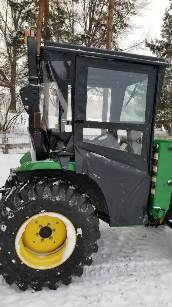

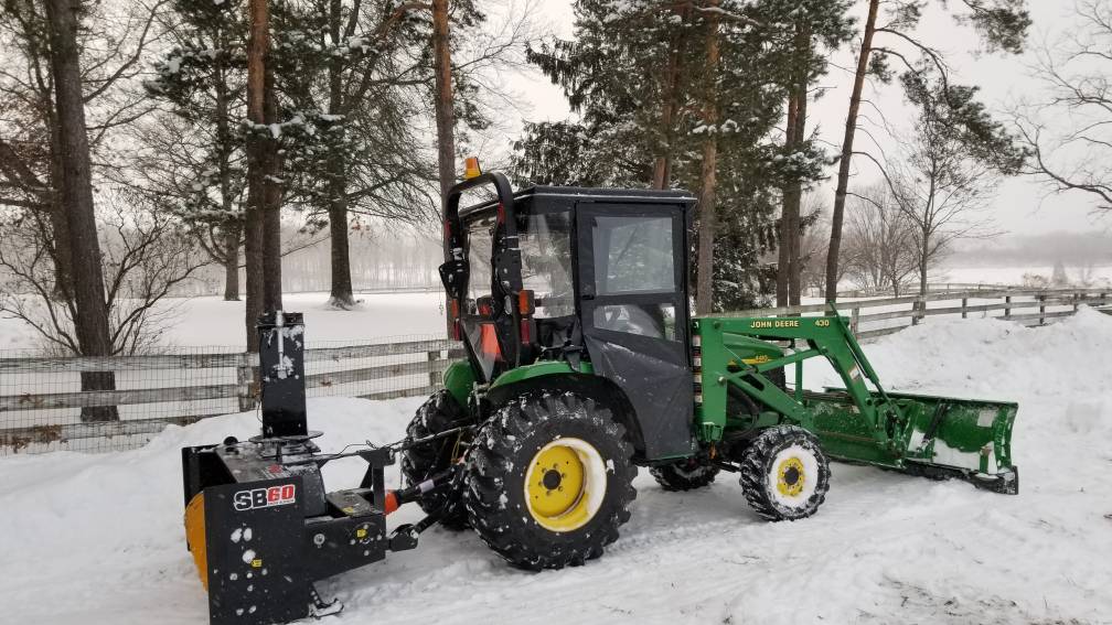

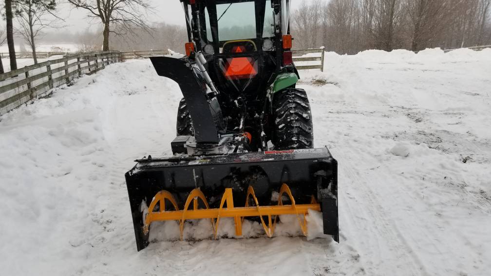

Thanks to some advice on this thread, here is my upgraded Snow Removal Tool. For the past 6 years, I've had an open station and front mount plow, which was fine for about 80% of snow we can get in the snow belt of upstate NY. This year i added the Original Tractor Cab and the Woodmax snowblower. I finally got a chance to give it a nice workout this weekend with 8-10 inches of light fluffy snow. It was nice to be out of the wind and blowing snow and the blower is really heavy duty. I won't have to worry about big snowbanks or driveway edges anymore. With 1000' of driveway, that is a big relief. I can say based on short term use both the cab and the blower was money well spent!
