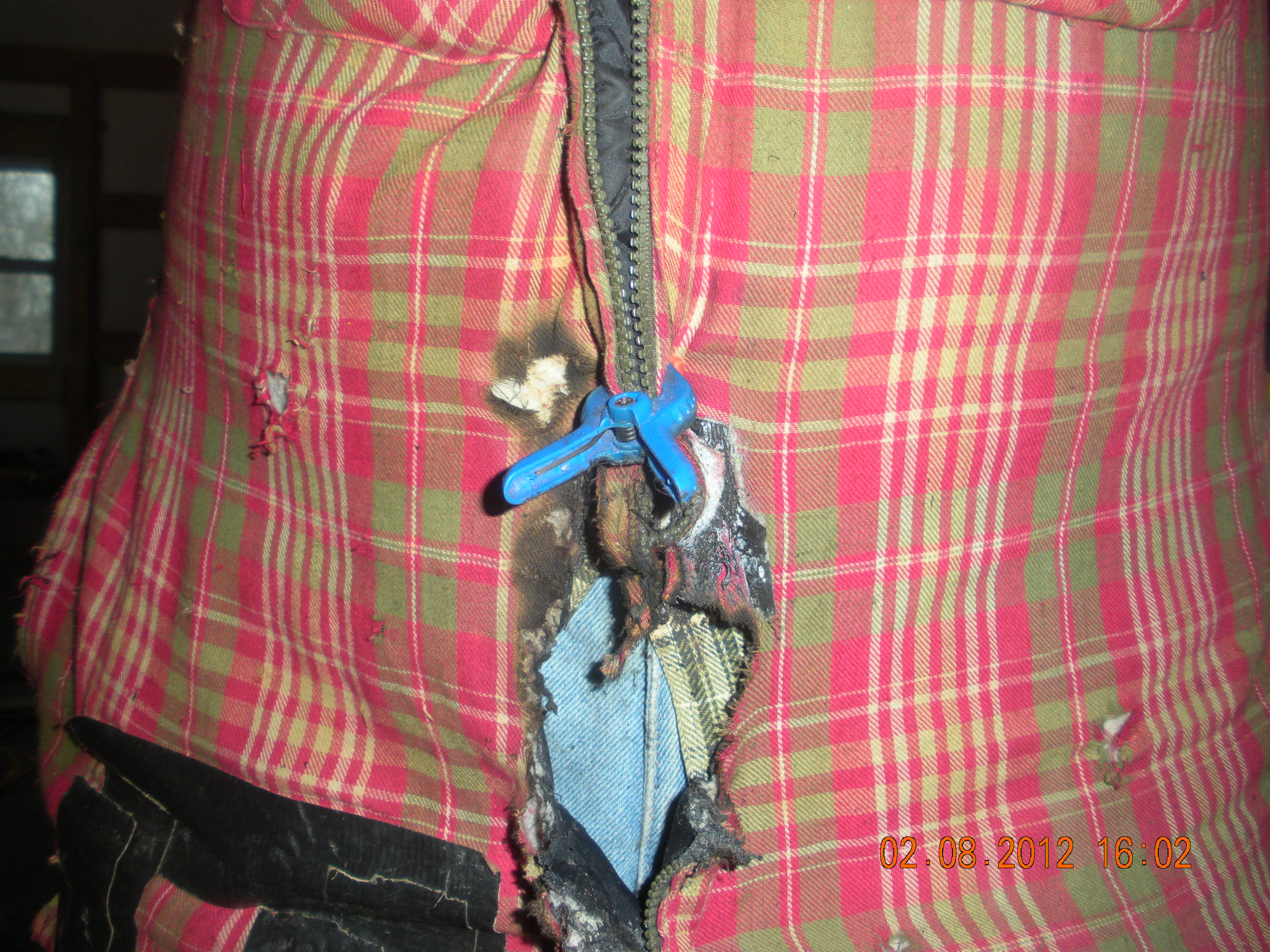

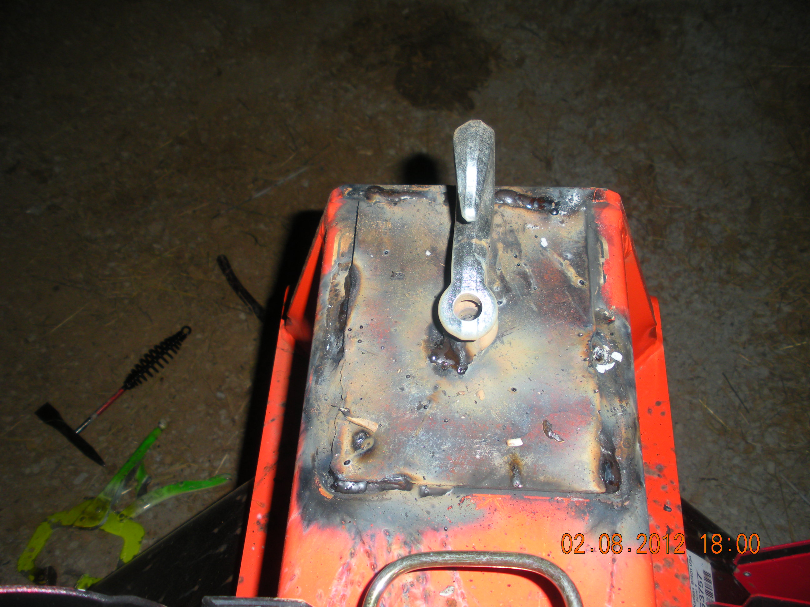

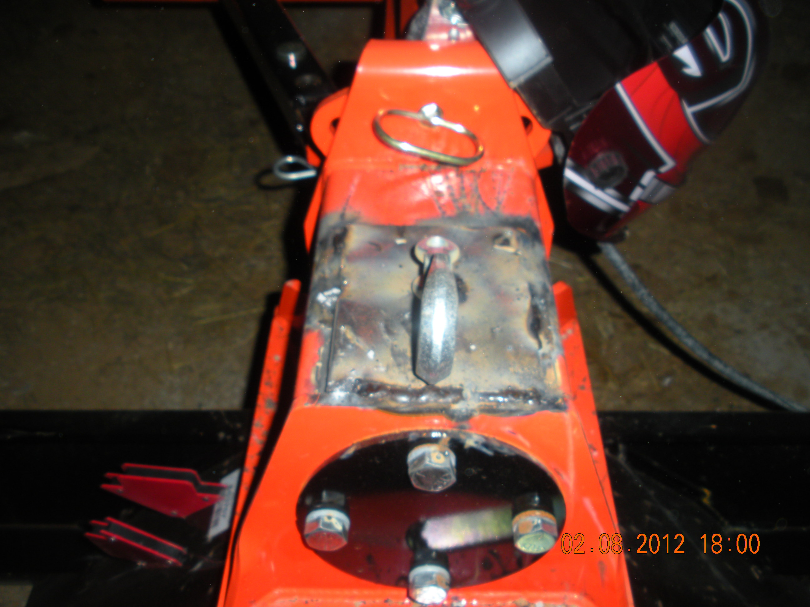

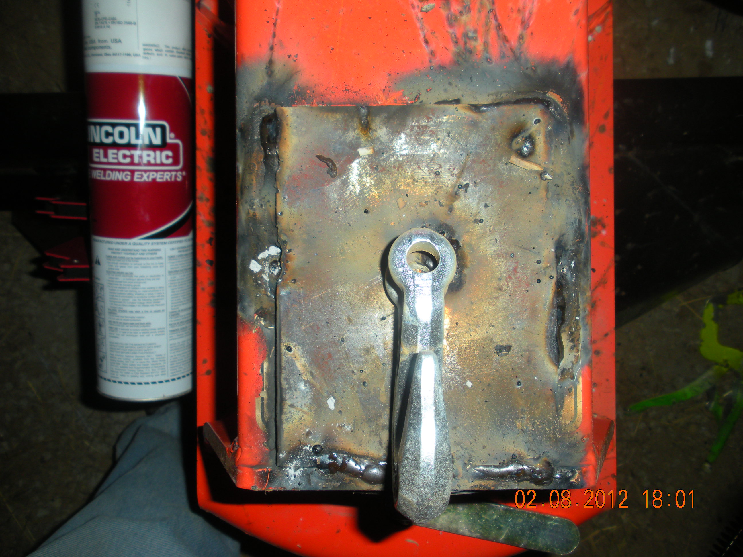

i`m probably should not post this it is real bad, but that is how you learn.
tell me all the things i did wrong & how to correct them. my first time ever welding. i bought a powerarc 200 from mark .
one of the many problems i`m havng is the rod keeps sticking & i can`t see what i`m doing, the shade # is to dark. ?
i`ve got a lot to learn & a long way to go.

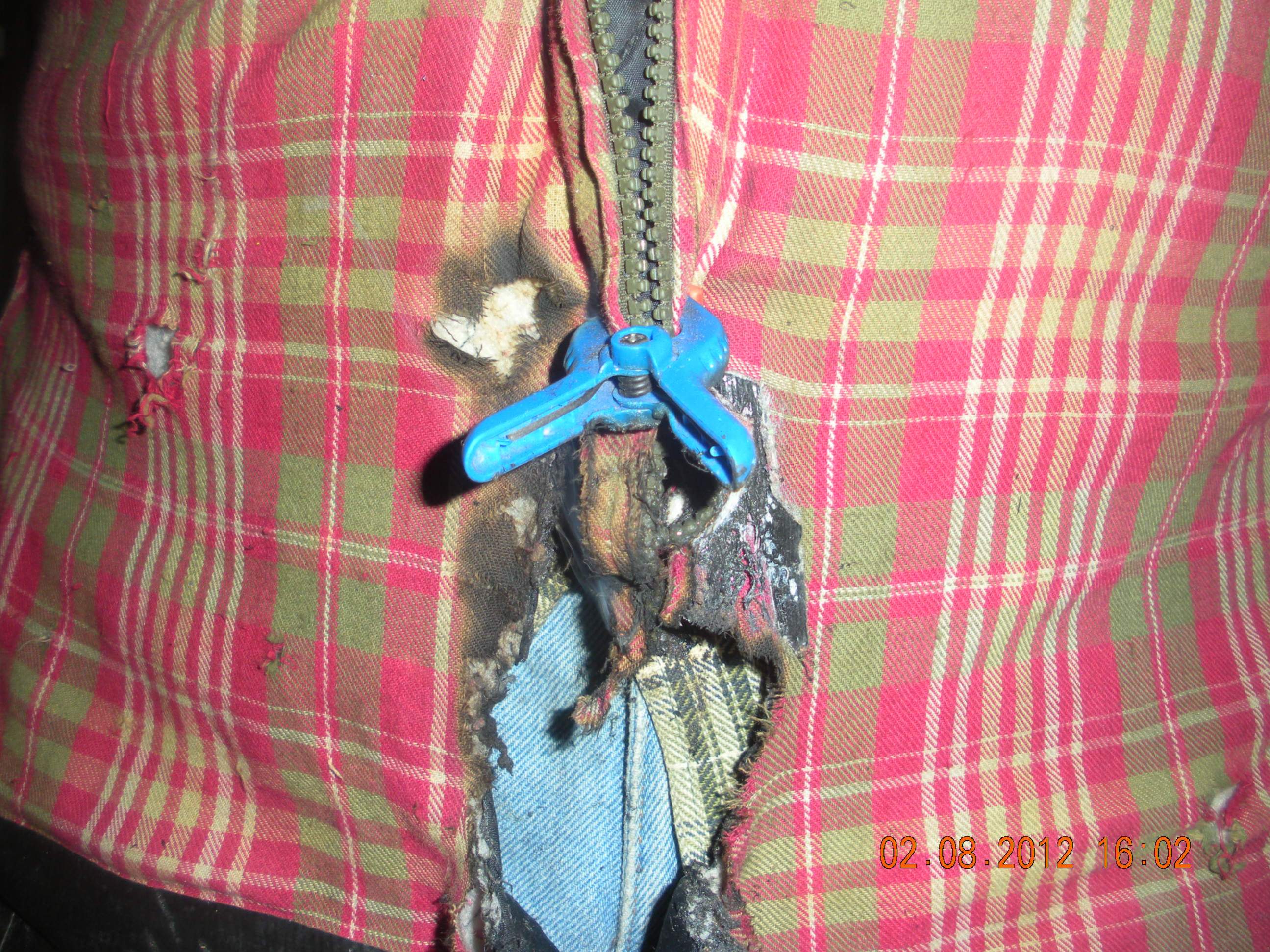

oh, also when your cutting metal with a grinder, be careful that you know where to sparks are going.!!!
some may think boy that guy is a real bozo, well..

yes, we all have to start somewhere.
that will not be the last jacket, shirt, pants, boots to get ruined.
perhaps get some scrap practice metal, then tackle a project.
how about some some top notch video to help guide you
Welding Tips and Tricks - Old School Stick Welding
better yet, find a welder willing to give a little guidance. watching over someones shoulder you will learn more than burning hundreds of pounds of rods.
try starting with 6010 or 6011 rods, the arc will not be partially submerged like with 7018 and you will see a little more of the work surface. also position yourself so you are not trying to look through the smoke.
have patience and good luck

I would suggest taking a class on welding at a local school or trade center.
Don't feel bad about your burnt clothes, I did something similar by not paying attention to the sparks from a cutting wheel and set my pant leg on fire. One helpful thing I could add is to wear all cotton and pants with no cuff or use the leather protection outfits.
On the electronic welding helmets, you can adjust for different levels of light. Try and not have very much light behind you.

I probabally would have started by grinding the orange paint off. I am not sure where you had your ground clamp hooked, but if on te orange peice, it can be a pita to get the arc to strike through the paint. You have to tap it onto the peice pretty hard.
And make sure you are doing everything in a horizontal flat position. NOT vertical. Save that for when you master flat.
And you didnt say what rod you were using. But I'd probabally start off practicing with 6013 or 7014. Those two are the easiest rods to run, and there fore the easiest to learn with.
Others may argue about their strength, but I have stuck a lot of metal with them two that is still together. So get some of them for practice. And then if you decide you want to try 7018 or 6010/6011, so be it. But if you are trying to jump right in with 7018, IMO that is 99% of your problems

I am just a self-taught farm welder so it can be done. Others that have posted have given good advice about rods to try and use.
The Everlast PA200 is about the easiest to use stick welder around so you are good to go there.
My advice:
> Find a small (4" x 4" or so) scrap piece of fairly thick metal. Grind on it until it is shiny on both sides.
> Put the ground clamp directly on the metal and then try the rod on the piece. Try to go from one side of the piece to the other without losing the arc. Then do it several times until the plate is filled with rod "trails". (Not sure what rod and what diameter you have from the first photo.) Post up a photo of it and you will get much help and advice.
> 6011 rod requires a little gap between the rod and the work (metal plate). The other rods (6013, 7014, 7018) can be just dragged along with the flux resting on the work.
On the original grab hook photo - you should probably grind off all those welds before starting over. A grab hook is not the best choice for a beginning welder to secure to plate. Special hooks are made just for that.
https://www.truckntow.com/pc-11373-147070-weld-on-grab-hook-38-pellican-hook.aspx
Also grind the paint area where welding until it is bare metal. The ground clamp also needs a bare metal hook-up.
More help after your next post photo of the practice.

Not all of your autodarks are shade adjustable. Even you more expensive brands offer a "cheapy" that is a fixed shade. Get one adjustable from at least 9-13 shade. My go to helmet is adjustable from 8-13.
As for the sticking... You should GRIND the area where the welds will be before you start welding to remove the rust and paint, particularly powder coated stuff which may be what you are welding with there. The difference will be night in day in both starting and how it welds.
IF you are welding that hook to whatever it is to use...don't. That hook is not considered weldable. And the welds are not good enough quite yet to trust them. They may hold, then again, they may not. Chip the slag, so you can see what is under the weld. A smooth surface on the slag does not mean that the weld itself is smooth. It could look like bird droppings underneath, or it could look like a fresh roll of dimes laid over on its side.
I see rod flux laying on top of the mount plate there...that is not good. If that much comes off you MUST trim the rod back until you have flux on the rod. Even though that can is sealed from new, I'd almost say the rods are wet, or you are having problems with pounding the rod when starting, and breaking off the flux

Oh so many things appear different in the welds. The first pass on the left in the first photo looks like you were too hot but the others look like maybe you turned it down too cold. Get rid of the paint and rust, even a professional welder cant make a pretty weld over paint and rust. Grind all surfaces at least 1/2" back from the weld area to clean, bright, grease free metal. Some areas of the weld look like you were also holding your arc too short,just dragging the rod. While some rods will weld this way, hardly any will to it over thick powder coated paint. It looks like you were using a 70xx rod, if so, a 1/16-3/32" arc would be preferable. Set your machine to where it starts welding without excessively sticking but not so high that it undercuts the base metal. Undercut is caused by either running too hot or travelling too fast. Adjust your travel speed according to the amps used.
Finally, get yourself some all cotton shirts. Even if you are using a welding jacket or leather sleeves, it is best to use cotton clothing underneath. They dont melt and are harder to catch fire than polyester or polyester blends.
