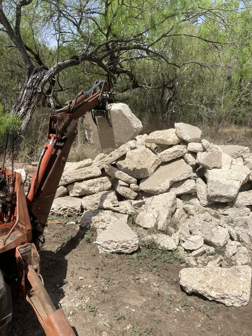

So it's not great, it's not on my backhoe right now, but when i needed to place a bunch of broken concrete around a culvert i installed, i bought this $250 'rock grabber' from Northern Tool. They sell it for their towable hoe but i figured out the pin diameter and spacing would fit my small backhoe.
It didn't work exactly like i wanted it to, but it did get the job done that i was doing, and i still have it. Im going to convert the thumb portion to hydraulic but i need to cut out and rebuild the middle section so it will lay back further when 'stowed', and the 'bucket' thing it came with is nearly useless except as the basis for building something better out of. I plan to build a kind of bucket off of it.

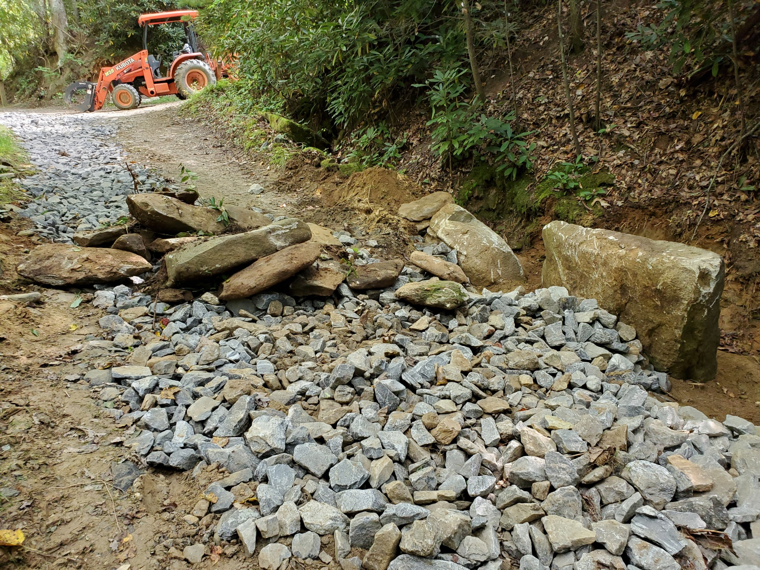

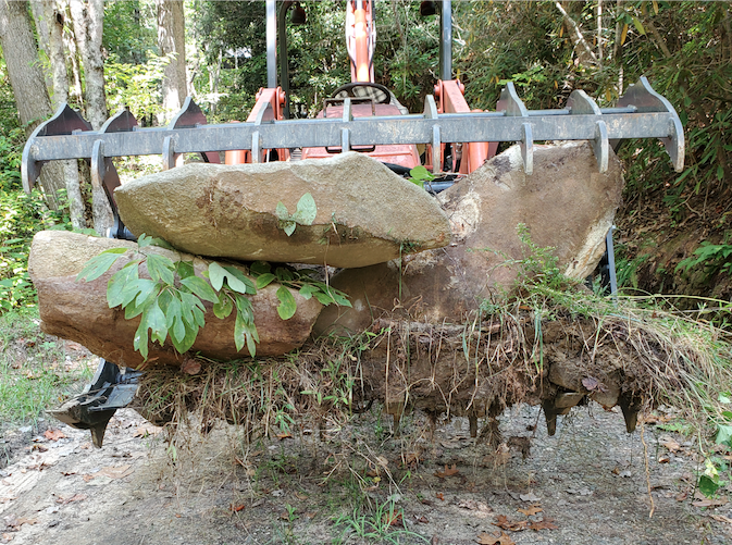

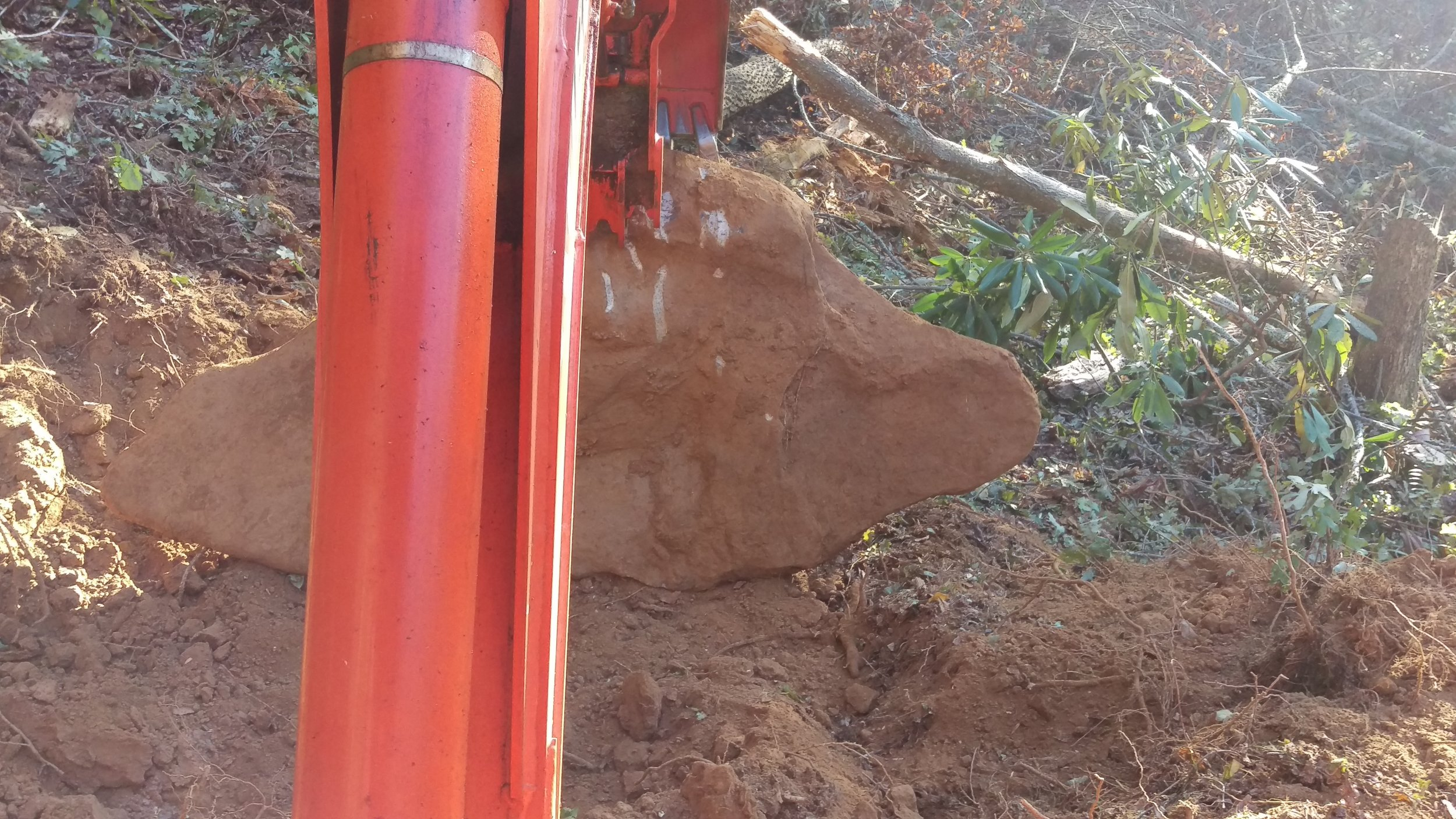

I am going to politely disagree that a hydraulic thumb is "only slightly more useful for moving rock" unless your talking about moving rock from one location to another some distance away. A hydraulic thumb allows me to keep the pressure on whatever I have grabbed ( rocks, logs, upright tree ) regardless of the angle of the bucket. I can roll the bucket all the way out or full curl in and not drop whatever I have grabbed. Great for placing rocks/ slabs into almost any position and place I can reach with backhoe.
I use the M59's hydraulic thumb for adding rock slabs, shingle style, to the creek bank to prevent erosion. The road is too narrow to face to creek with tractor, so tractor is ninety degrees to creek and hoe reaches over bank edge to place rock slabs upright against the bank. Precise work that requires the control/grip of the rock, that only hydraulic thumb can provide.
Rebuilt a road and ditch due to bad water erosion. Used backhoe to place row of upright, shingle style, slabs of rock. Pics attached.
The M59's thumb's hydraulic circuit has a lower relief valve pressure than the bucket cylinder so curling the bucket causes the thumb to move while still maintaining full pressure on gripped item.
I use the grapple to move a bunch of needed rock to the location, then use the backhoe to choose and place the rocks into final position.
