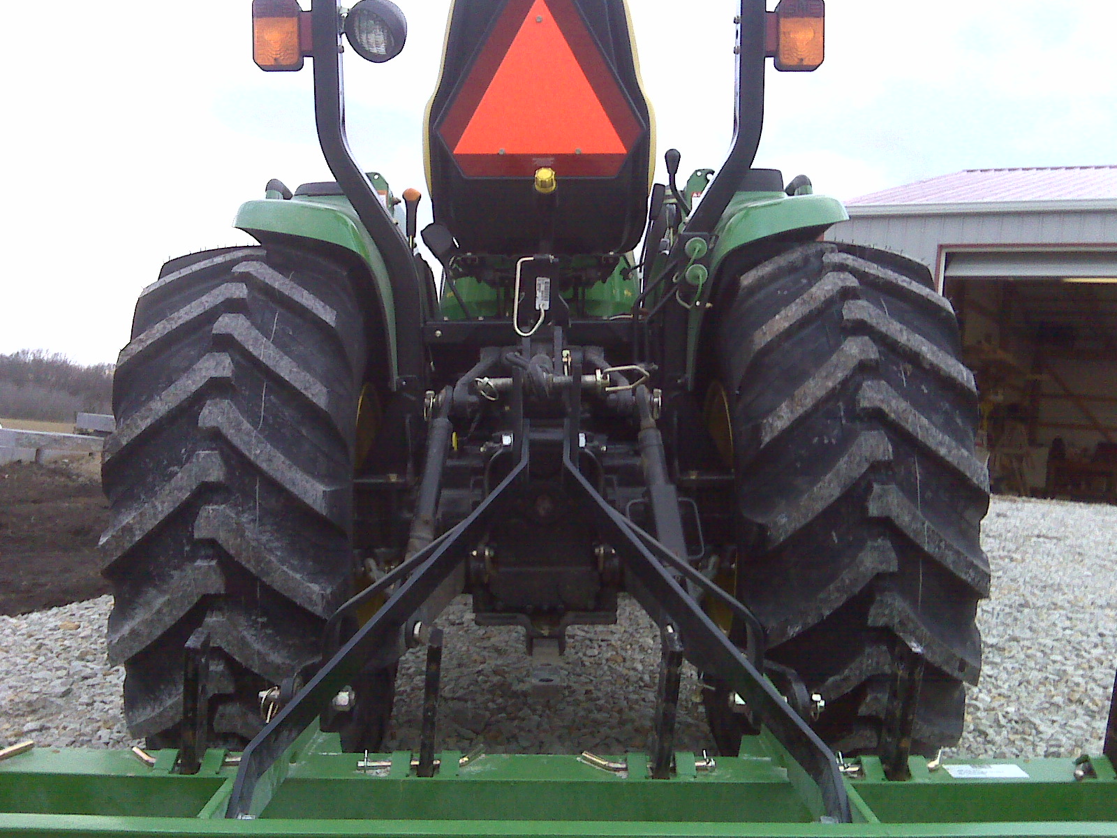

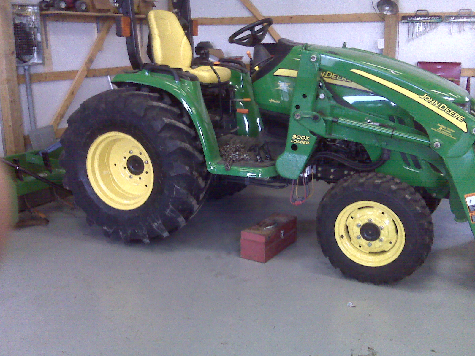

Here are some pics for the Michelins I put on. Really like them so far. All I have really done is seed with them, but they leave such a nice flat footprint on the ground. And with two steel belts in them, they should be very good when I mow brush in the summer.
That is one sweet tractor! Nice tires. Would you recommend to others buying this tractor to do the same upsize on tires? Why or why not.
/ picked up 3720 #23
The original large R-4 are 43X16X20. The Michelin tire of the size is a 400/70R20. That would be the same basic size.
The michelin are much closer to the actual dimensions. They are actually 16inches wide. The Galaxys r not.
If I had it to over again I would put the stock size back on.
The reason is so that I could have put the Michelins on the front.
I like the bigger meats though, but they r overkill
One of those tires can carry that entire tractor and loader and still not be maxed out.
I lost a little top speed I think. It will go about 17 with no load on it.
For reference, the tires I have on now r 425/75R20
