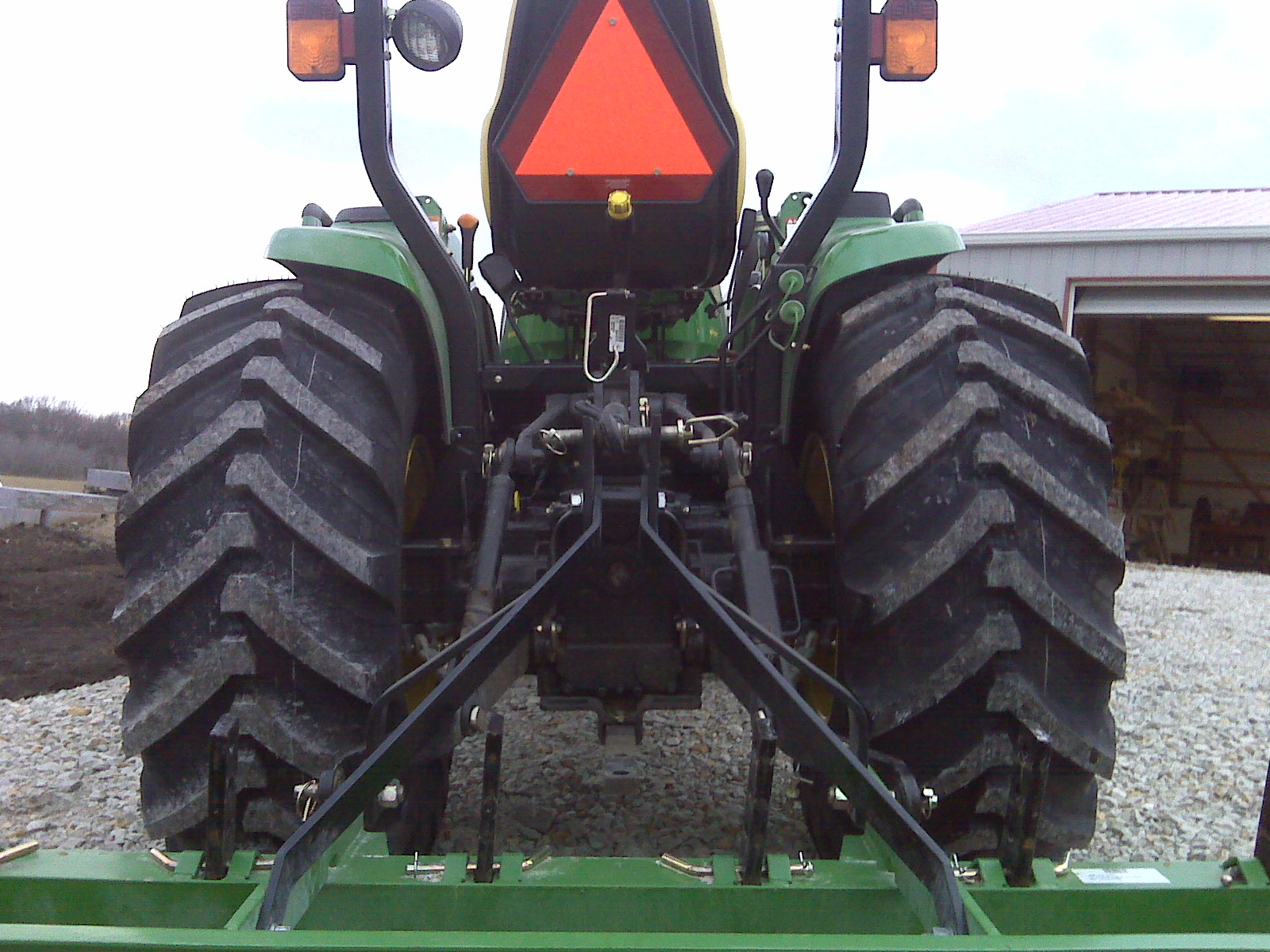

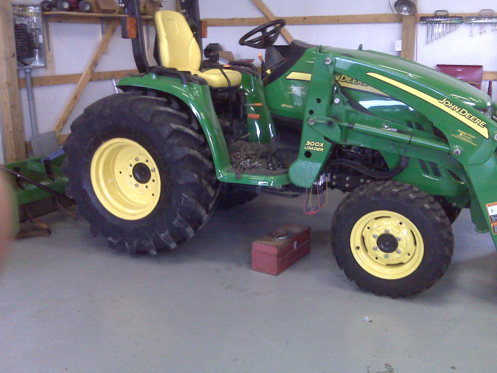

Here are some pics for the Michelins I put on. Really like them so far. All I have really done is seed with them, but they leave such a nice flat footprint on the ground. And with two steel belts in them, they should be very good when I mow brush in the summer.
/ picked up 3720 #16
Thanks for the pics...
Those are really nice tires, looks like a cross between the profile of an R4 and the tread from an R1....
Did they have matching fronts avilable? Looks like you got the factory fronts still on it?
/ picked up 3720 #17
You are correct, Michelin doesn't make a front that I needed.
I went one size bigger on the rears, so I had to go up a size on the fronts.
I put 28x8.50x15 on the front. That kept my ratio correct.
They do make a front and rear tire in the original sizes.
The rear is a 400/70R20 XMCL, and the front is a 27x8.50x15 XZSL. That setup would be almost flat proof.
