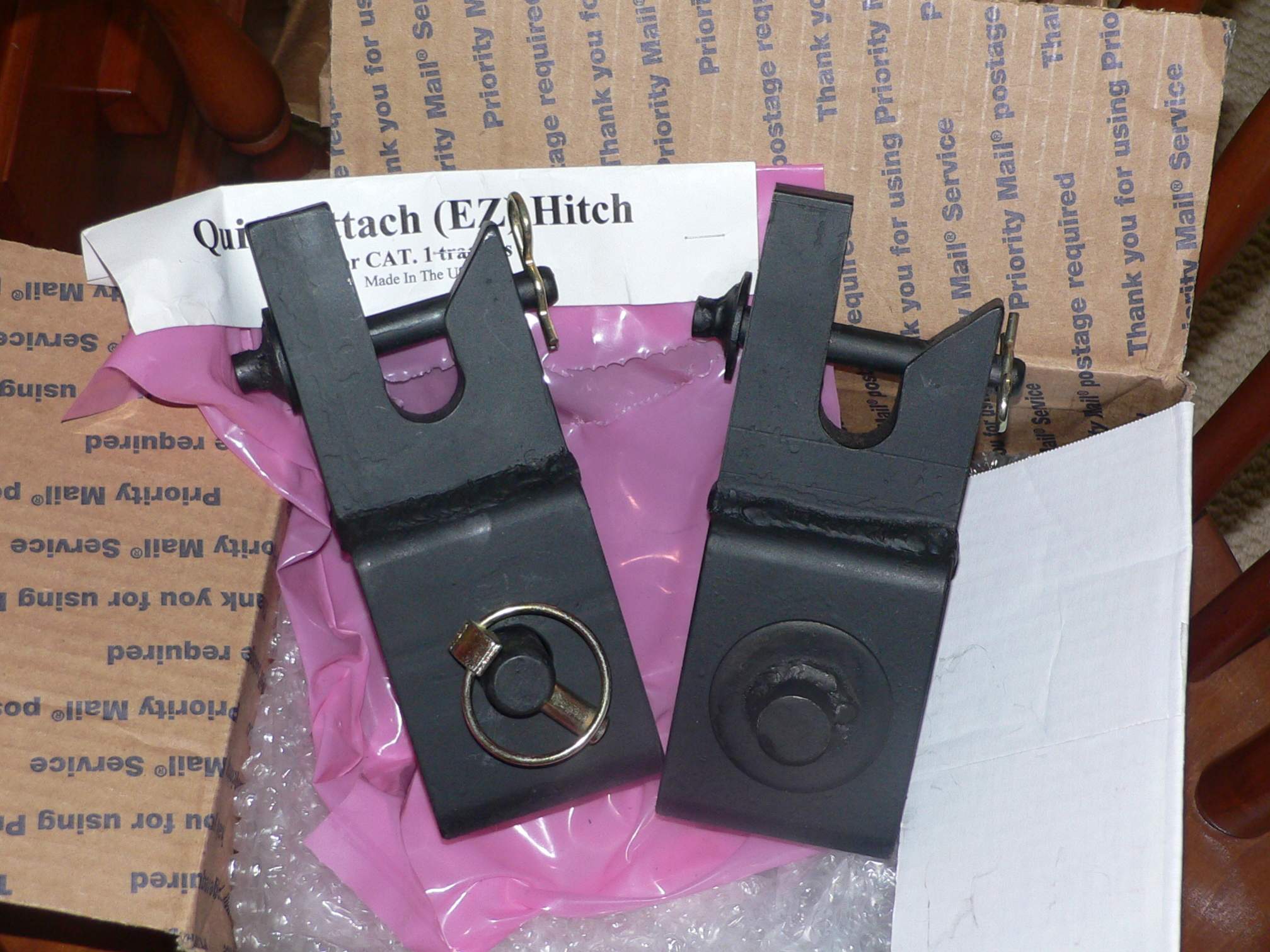

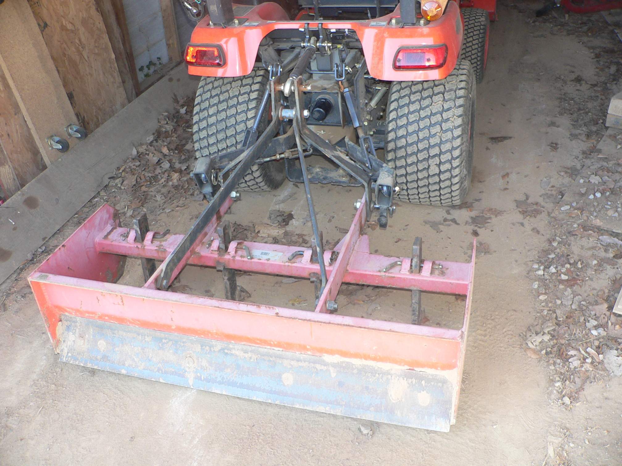

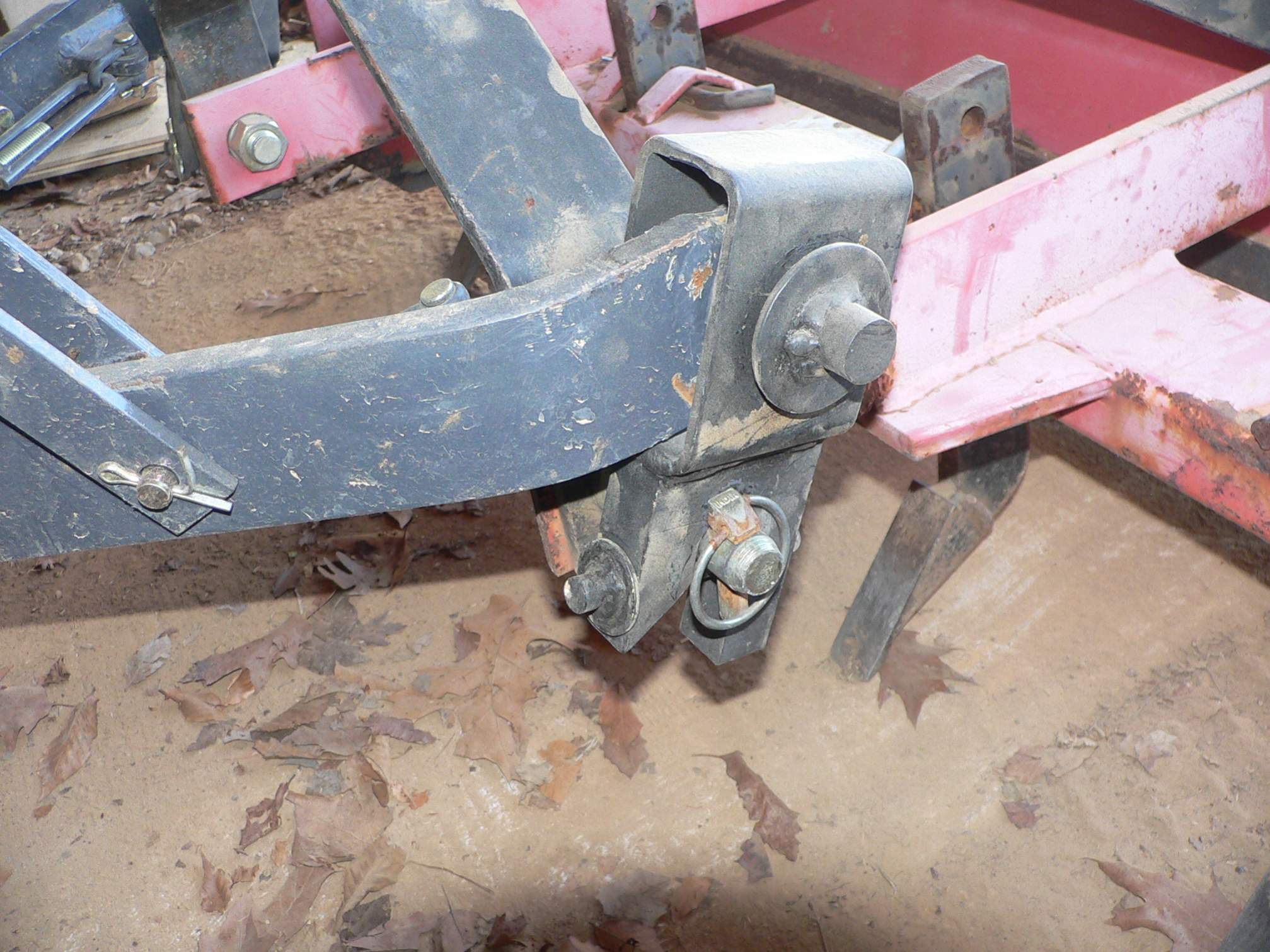

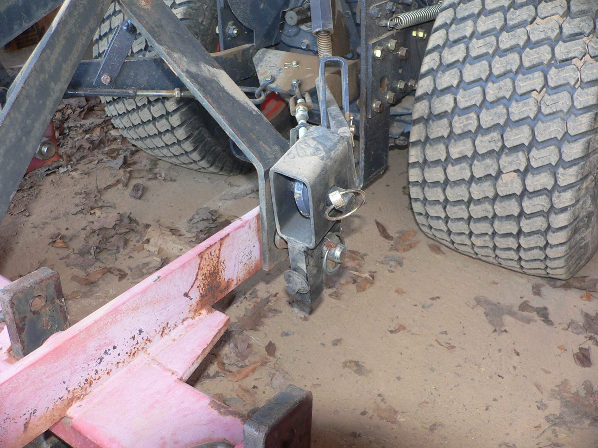

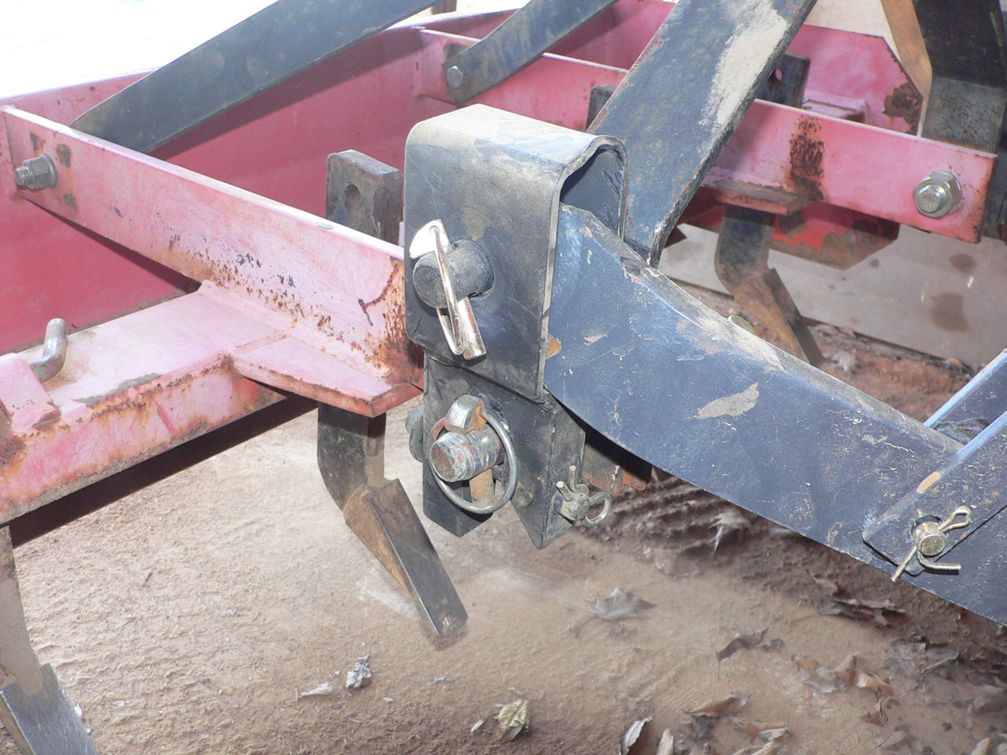

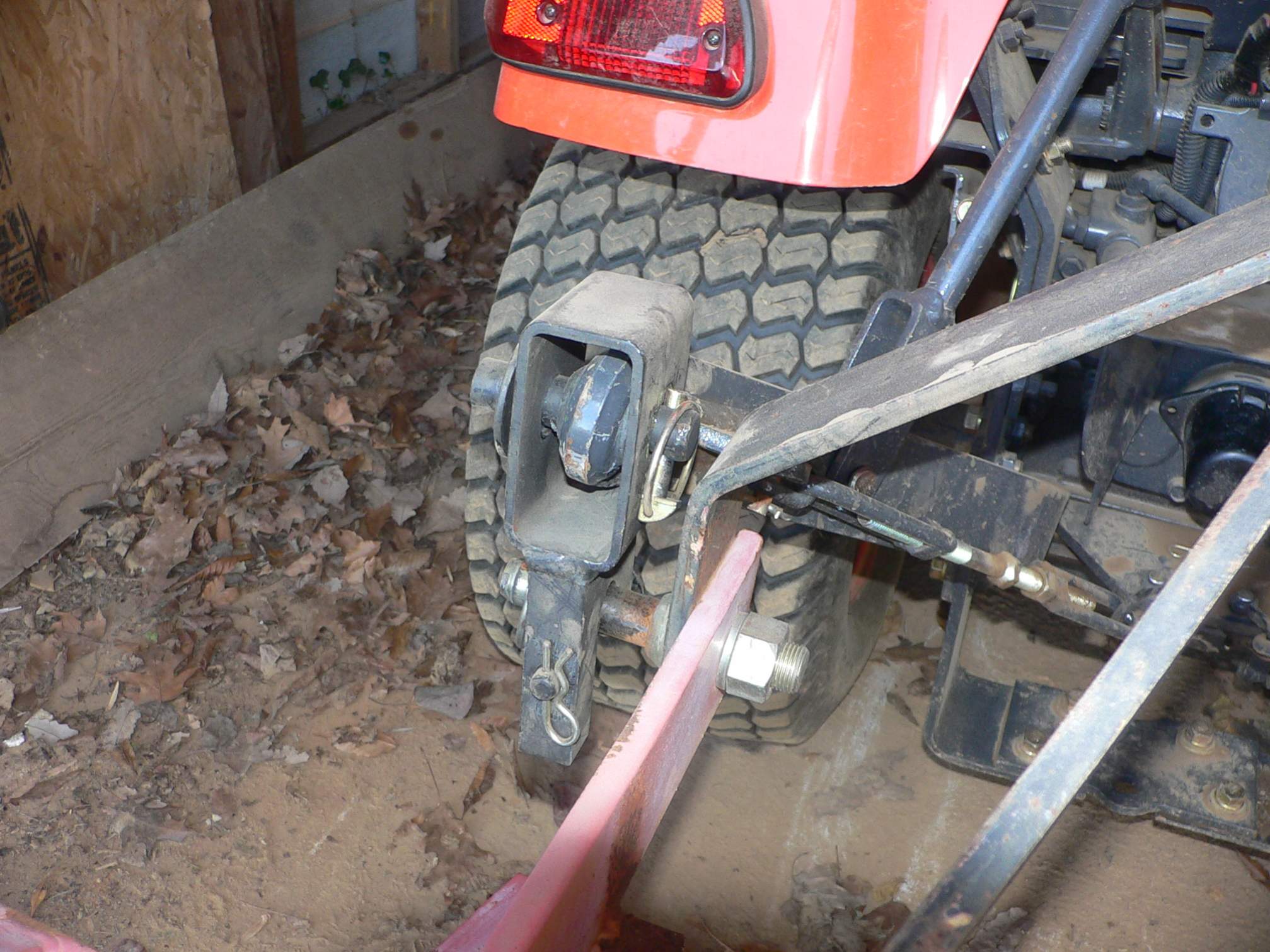

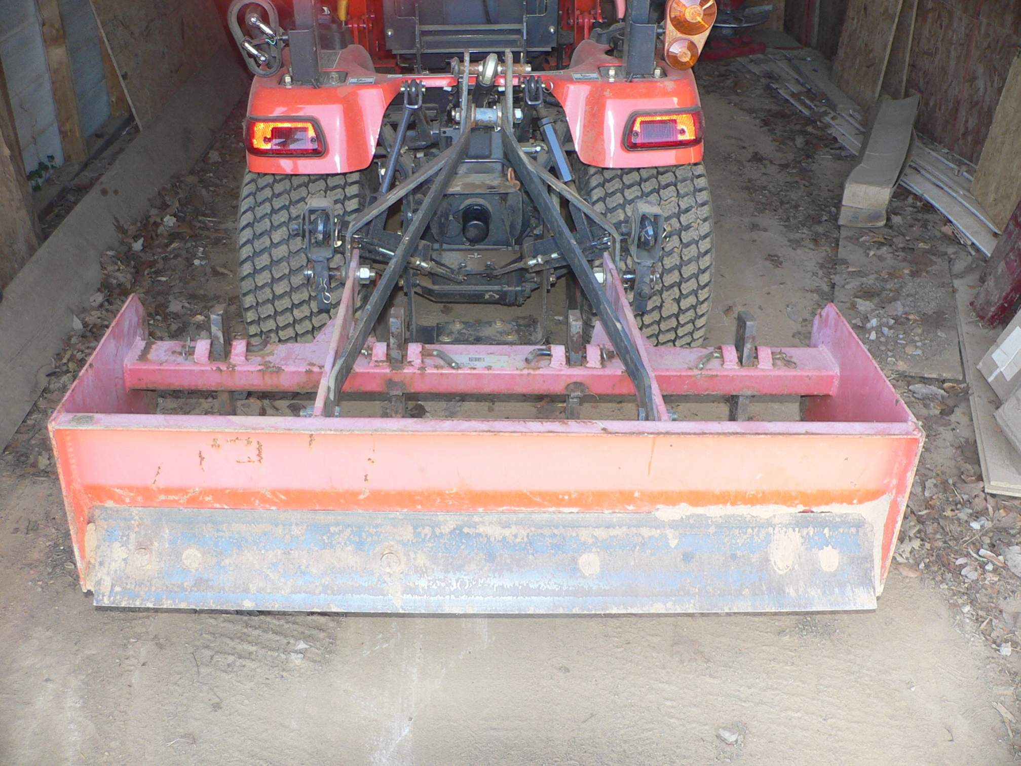

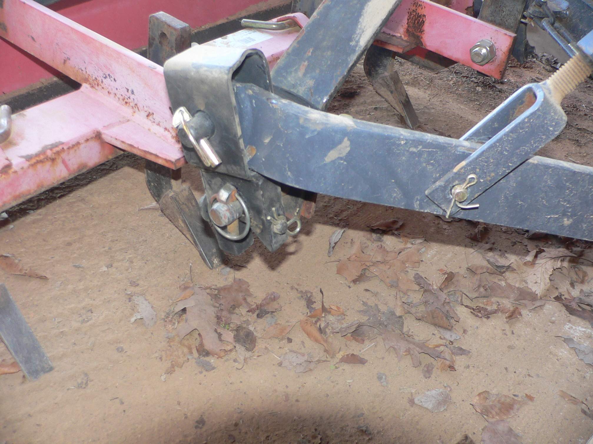

Here are pictures of the $70 ones hooked up to my boxblade upside down to see if they will work OK upside down. Maybe they're not upside down and are supposed to be this way,:) they don't come with instructions. I could have put them up but would have had to lift boxblade up to them or lifted boxblade with fel and put blocks under the front of it then come under the bb pins. Really tested these with some extreme rock digging and had no issues. Subsurface rocks stopped tractor and big rocks gave up their grip and rolled out of the way. I feel confident of the strength of these now that I have tested them at the extreme.
They slip off and on in less than a minute.
