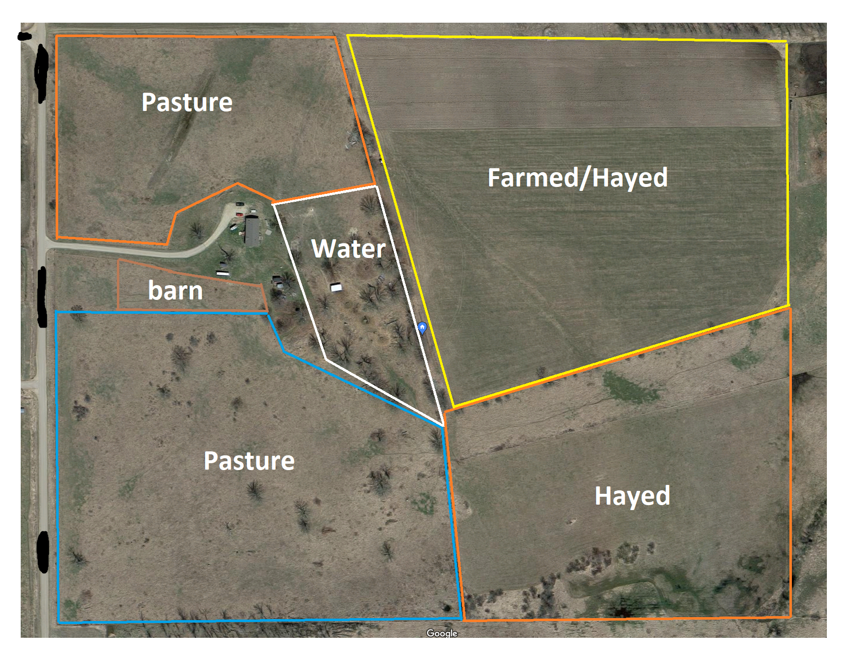

I have been reading whatever info google presents me on converting rough pasture into hayfield but I wanted to see if anyone here has any tips that will make my life a bit easier.
I have gotten a few different opinions on what the proper procedure is but I should preface that my pasture is rather boulder-y. I was late getting cows out there to keep the grass down so they are working on it now but I'm in this kind of catch 23 situation where I need to mow to see the rocks better to pick them out but the rocks would make mowing almost impossible. Is there some sort of method that people do where they just light it all on fire and start from zero using an excavator to pick the bigger boulders out and then plow it over?
My current plan is to be patient let the cows do there thing, a local landscape company will come pick boulders and pay you for them, but the thistles are taking over a bit as well. Not to mention the buckthorn which I should be able to finish shredding once I get my new cutter.
after that I was thinking:
1) plow it over
2) disc a few times
3) likely pay neighbor to drill seed it
4) mow weeds while grass takes
My neighbor suggested planting corn for 2 years to help break up the sod, saying using a disc wouldn't be super effective or something. Anyhow if anyone has surefire way of converting rough pasture into hayable field im all ears.

Alright well I appreciate everyone's contribution. It sounds like the thing I was missing from my own plan was the roller/cultipacker
I wish I could do fewer steps but I think the field is in such poor condition that I just need to invest in the dozer work to get it in a much better starting place. I literally can't drive more than 2 mph without getting bounced out of the seat currently. I have a meeting planned with the local NRCS and they can also advise, but this is probably going to be a 2 summer project at minimum. I figure the rest of this season will be boulder / shrub removal and maybe dozer work, next spring discing/packing and planting and then let it grow unmolested depending on when I get it planted.

Truthfully the real reason I want to just get to to workable state is so that it doesn't get worse and I lose the little bit of value the land has now. When I purchased this place I had no idea pasture should be "mowed" a few times a season, I just figure if I'm going to bother to clean it up I might as well do it properly so I can hay it 2 years and have cows out there on the 3rd year. From what I understand if you can rotate hayfield / pasture it will help keep the soil better than if you just hayed 1 field endlessly.
edit: I should add that I have a suburban upbringing but I never really enjoyed the city, I bought this land with the intention of renting out the fields and to give myself space to spread out. It's funny how things change once you insert yourself in various situations.
