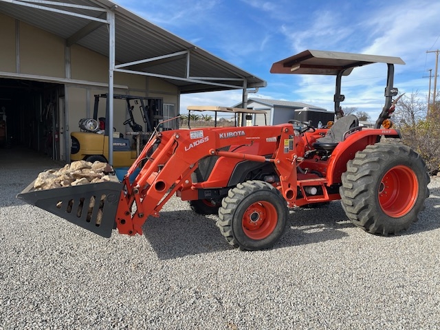

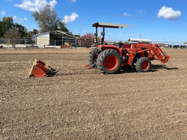

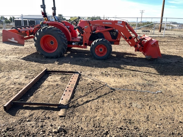

Went through this with the neighbor's field. Disc'd it, drug it, picked the big rocks out. Still linka rough. Squirrels aren't helping digging burrows... I suppose it will just take more dragging. The landplane clogged up with cuttings pretty fast. I made up a drag and found an unconventional use for the bucket dragged behind the tractor.
