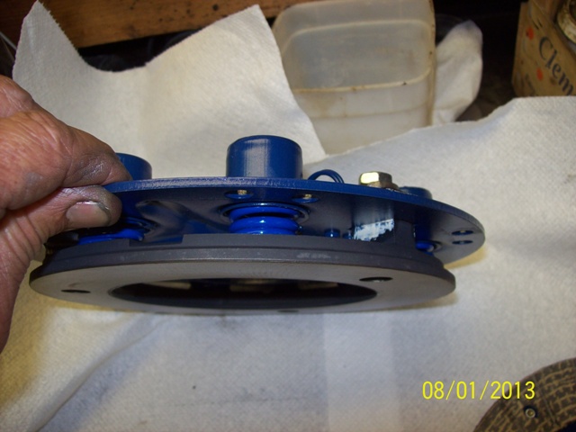

I broke the clutch cable on my 997 a couple of weeks ago and have been going over the tractor to take care of odds and end stuff that I’ve been meaning to do.
I have two 997’s with FEL that I use very hard. One I’ve had for 5 years and another for 2 years. This is the first broken clutch cable between the two of them.
The clutch always seemed very difficult/binding somewhere. Just before I bought it someone had done a clutch job on it…as it was advertized “new clutch”. A number of problems contributed to the issues that ultimately caused a stiff pedal and broken cable.
The 3 finger pressure plate had at some time been rebuilt and installed incorrectly.
I took it to the good folks at Buffalo Clutch in Cheektowaga NY that did an incredible job rebuilding the pressure plate properly using Model A pivots/pins and Air Brake springs.
When I went to install the new set up I found that it did not seat properly on the flywheel as it sat up partially on a lip at the outer edge of the flywheel. Some careful cleanup on the periphery of the pressure plate did the trick.
I take a lot of before, during and after pictures on projects like this to document things.
I looked at my “before” pictures and I could see where the pressure plate was not installed correctly when I got the tractor. The improper pivot parts also caused much of the stiffness in the pedal. Now it functions very well.
I can’t help but think that regular breakage of cable is indicative of a problem elsewhere….does it always break in the same place?

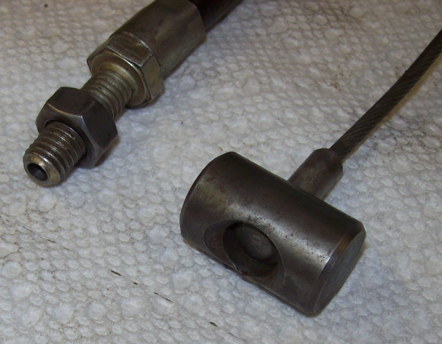

I am curious as to what your cable end at the cultch pedal looks like.
It seems as though it is not pivoting with movement from the pedal.
Picture 1 shows the parts from my 997 clutch cable….are they familiar or do you have a different set up?
Picture 2 is the rebuilt 3 finger clutch with what I believe are air brake springs that are what determine clutch pressure. I just installed this…effort is increased but not objectionable.

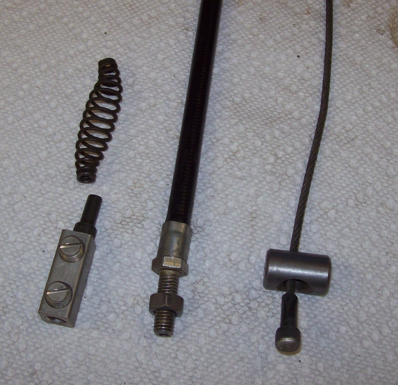

The first picture shows all of the clutch cable assembly components that I used to redo my 997.
This is a typical setup often called a Bowden cable.
Starting at the lower left is a terminal block. This one is aluminum and I have some in steel. This is available at Lowes or Home Depot in the electrical department. It is the last part to be assembled on the cable at the clutch fork under the battery.
The next part up was made from a ¼” Allen Screw and fits into the top hole of the clutch fork. It was drilled out on a lathe so that the cable would slide through it. It is not at all necessary and I only used it because I had it.
The spring is the stock Pasquali item that goes between the clutch fork and a protrusion on the transmission.
Going to the right in the picture is the outer sheath. It is 40.75 inches long and the internal diameter is adequate to pass a 1/8”
cable though it.
At the end of the outer sheath is an adjusting bolt. This was made on a lathe. It is a standard 8-1.25 x 25 metric bolt. Drilled through to pass the 1/8” cable and the hex head end bored out to accept the end of the outer sheath. This keeps everything concentric. This is installed into the threaded tube on the foot rest.
The cable is 1/8” 7x19 aircraft cable 54” long. Available at most hardware stores etc. Be careful of the 7x19 designation as there are a variety of different ways cable is constructed. This is good for strength and flexibility.
Here is where we get to the parts that are breaking. If the terminal on the end slips off the cable that is one issue. If it breaks off with a stubble of cable stuck inside that is a whole different matter.
Quit simply if the terminal slips off it was not properly attached… regardless of clutch pedal effort. In other words a cable will break long before the terminal will slip.
If there is no stepped terminal on the very end of the cable at the clutch pedal this is an issue. If the cable end is secured with any other kind of screw on terminal this is a source of problems, as it will not allow the cable to pivot properly.
The last component is the solid steel lug that is cross drilled and step drilled. If you look at it the holes are a different size on each side of it.
Looking at the 2nd picture you can see where the cable end will not pass though this lug. As it is assembled in the clutch pedal
It allows the cable and the lug to rotate as the pedal moves. This relieves the stress on the cable and allows it to stay aligned better.
The cable that broke for me was passed all the way through both holes in the clutch pedal and then terminated with a cable clamp beneath that. A No-No in my book…
That’s all I have to say about that…
Joe
