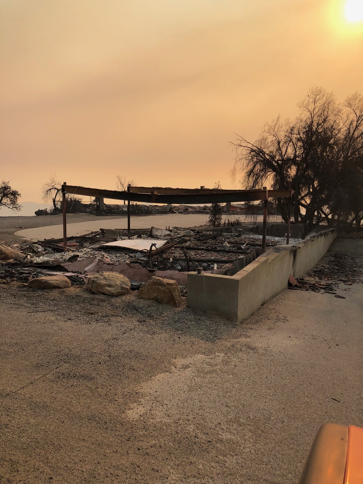

One could build a garage that would withstand two side-by-side Tesla fires.
I dunno. That closest steel I-beam, about 18 inches tall and quite thick, is obviously bent from the heat. The far one survived much better.
Yep, there was a Tesla under the bent one.
Yep, there was a Tesla under the bent one.View attachment 827067
Is that a photo from Hawaii.
So, a wildfire, not a Tesla fire. So, the whole house would have burnt independent of an EV parked in the garage, and the heat came from far more than an EV.
One issue is the duration. The wildfire burns for hours, although the burn over may be relatively short. But still a lot of heat on all sides of the beams.
If we can build a Space Shuttle that can survive 3000 °F reentry, then we could design a structure that could withstand a car fire, whether it is 100% passive, or also includes active elements such as sprinklers, or cooling pipes.
Australia is building their fire trucks to withstand wildfire burnovers, or at least saving the entire crew inside the truck. Lots of water.
Nonetheless, if one has a $500K house, and a less expensive garage. Design it so the car damages the garage, but doesn't also take out the house.
