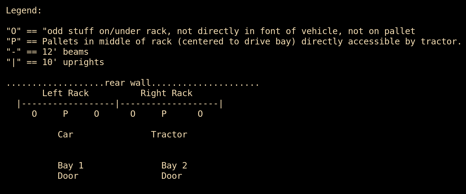

I have three connected garage bays I'd like to use for attachment storage (as well as vehicles/tractors), with a strong hope to restrict attachment storage to two bays if I can. I'm trying to figure out if this is viable, and what size racks and pallets to order and/or build. A car/truck will be in one bay, the tractor in the other. The racks and/or stored attachments will be in front of the vehicles except for whatever is mounted on the tractor. There is no room to maneuver the tractor with forks other than forward/reverse, so I'll only be able to store things on the floor or rack directly in front of the tractor if it requires forks to move it (in either bay).
Here's my initial equipment and storage assumptions (if it's stored and not on the tractor). I do not have this equipment yet, so this is all based on paper specs, delivery expected in T-3 weeks :)
The rotary cutter will almost always be stored, favoring the blade on the 3PH.
At first guess I'd think standard size 48D 40W pallets on 42D racks would be the way to go, only...
Seems like the only things which could actually reasonably go on the pallet racks are the grapple, _maybe_ the rear blade, and possibly the bucket, I just don't know until I get some advice or get these implements on some pallets to see how they position. The forks will never be on the racks because I'll need them to access the racks.
Wheeled pallets on floor? That rotary cutter isn't going to fit in _front_ of anything, unless, ... I can angle that PTO attach off to the side on the wheeled rack. How does it even fit on a pallet, it's far larger than a standard size pallet. I'm guessing the only way to avoid storing that in the third bay is if it's attached to the tractor, and frankly I'm not sure my garage is deep enough even then. So unless someone has rotary cutter insights or inspirations I'll just write off my third bay for that.
That's a mess to read about, sorry. I'm just looking for your personal experiences with any of this. What works on racks, what doesn't? How deep should the racks be? Can I use shorter racks (e.g. 32"D) for anything. I don't really want to us a 42" deep rack if I can avoid it. Where do you get "short" pallets? Or do you just have to make your own?
I'm finding plenty of places to buy used rack stuff, though southern Vermont area recommendations appreciated.
Ditto for finding a source of pallets. I have 3 pallets that have been sitting for years out in the driveway, don't think I'd want to trust those to any actual heavy equipment, they're probably worth what I didn't pay for them. Any good DIY designs? It'd be a lot faster to make a pallet if I just used plywood, is that a bad idea for load purposes? (Probably not good from a weathering standpoint).
Based on reading what I just wrote, it almost sounds like I should make do solely with wheeled pallets and forget the racks until I know more. Some of the equipment would be a fair sight larger than a standard pallet, so looking for advice from the masters.
I have a bad back, it is fully a goal make sure the tractor does any heavy lifting. All loader stuff is quick attach. Given that I presently only have two seldom-swapped rear attachments I haven't invested in a quick hitch yet.
If I do put up racks, I'm hoping for 10' uprights and 12' beams, which should nicely bisect the two-bay area which is a bit over 25' in width. The pallet forks can only reach the middle of a rack, but I have plenty of other junk to put to either side for general garage storage. Not sure if those plans will work out either, just what I'm thinking of so far, and avoids a lot of danger of vehicles hitting the uprights because they're well to the side of the parking areas.
Thanks for your advice!

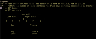

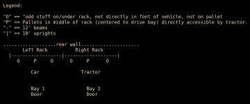

Fancy ascii graphics of what I envision (since recaptured as an image because TBN strips all spaces in formatted text :-( ):
So the question is can I squeeze all my equipment into the P slots under/on the racks and in front of the vehicles. I'm thinking I can, though that rotary cutter on a wheeled pallet sideways under the rack would still crowd whatever vehicle is behind it.

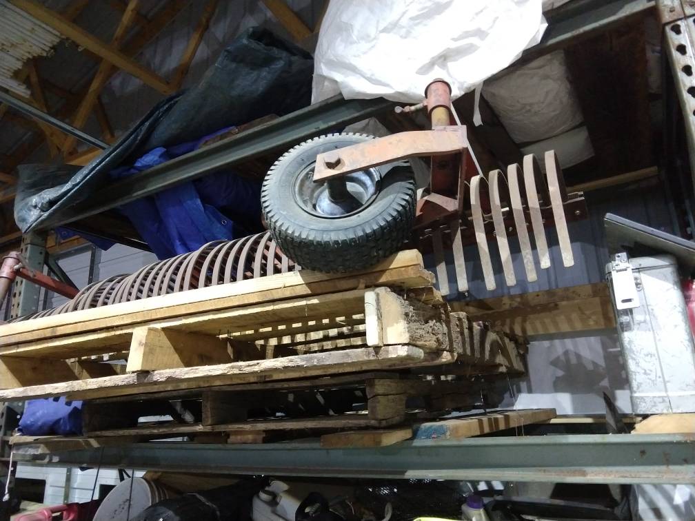

I have pallet racking in the shop in an L shape and keep the landscape rake, the bakblade and a couple of mower decks on it.
We ended up picking up a walk-behind electric forklift to put stuff on and off which makes it far more convenient than trying to use the tractor on the side that is not straight in from the door.
For what you're doing, it sounds like a tractor should work fine.
If you look around you can find pallets that are different than the normal size, I have my landscape rake and backblade on a wider/deeper pallet than a standard one which I picked up someplace, might have been a place that received in equipment on pallets. Can't remember off hand.

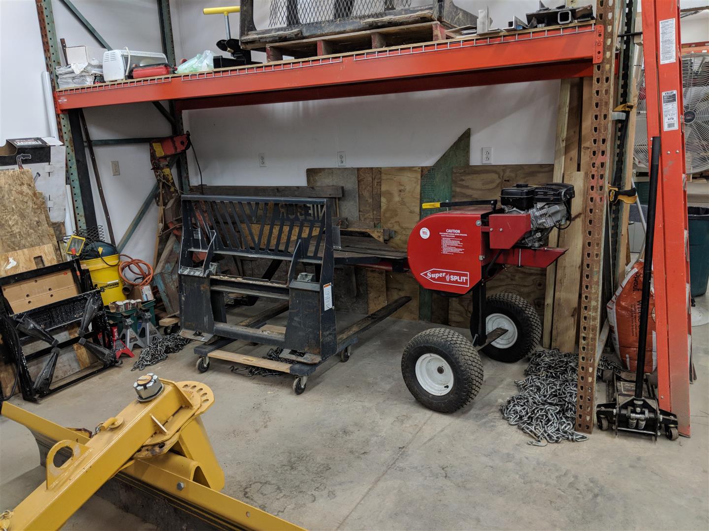

I would not suggest that you can pick an implement off the rack with the SSQA directly. You need a lot of vertical space to be able to get it hooked, lifted up and curled to make sure it doesn't fall off. If you only have one pallet rack at eye level or so and nothing above it (or at least say 3' clearance above any implement), then you might be able to directly pick it. I put my grapple on a pallet and up in the rack with the forks. The forks are on a dolly below. You can barely see the grapple in this pic and the forks below. I only have a few inches clearance above the grapple and the forks are a lot more flexible in picking it off the rack
You could always come up with a way to stand the bushhog up on edge. I've seen it done with mower decks, but haven't seen anything as large as that done this way. Could work, especially if it is a very rare thing for you to use.
Your picture certainly looks something like I was thinking of. It looks like your entire fork fits underneath the shelf, what are the rack dimensions?
I don't think I would ever try to stand my rotary cutter up. At 745 pounds that sounds like a good way to kill myself, or at least break a lot of stuff!

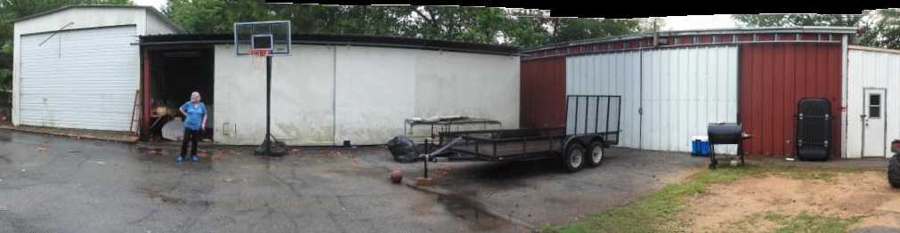

I've 4 workshops with a few feet of racks:
646385d1584766182-pallets-racks-attachment-storage-not-outside-shops-cropped-jpg
646381d1584766044-pallets-racks-attachment-storage-not-8x6sam_0727-jpg
646382d1584766044-pallets-racks-attachment-storage-not-8x6sam_0773-jpg
646383d1584766044-pallets-racks-attachment-storage-not-8x6sam_0768-jpg
646384d1584766044-pallets-racks-attachment-storage-not-8x6ford-rv2-jpg
plus 8 more units not pictured and 2 sets of beams for 12' shelves, 3 layers that I need to get teardrop uprights for.
So all told I'll have about 200+ linear feet.
Pallets racks are like tinkertoys for big boys. I've set up several sets and then a year or two later taken them down and moved them around. They are heavy but a lot easier to reconfigure than anything else that will hold a few tons.
I store things like my 5' tiller and rotary cutter on 2x4's resting on HF's $8 furniture dollies for rolling under the first layer. So they can be pushed partially under.
Most of my sets are built so I've got the first level so with a sheet of 3/4 plywood topped by a sheet of 3/4 MDF it comes about elbow height and makes a good standup worksurface that I can mount a vice on etc. And plenty of storage underneath.
Then on many of them I set the second shelf up so I can fit a 30 inch high kitchen wall cabinet on my HF's $8 furniture dollies. Thus I have a loaded cabinet I can roll to the back, but if needed (because it's hard to reach) I can pull it forward. I've got a bunch of kitchen cabinets free from a remodel.
I'd recommend you be flexible with the height of the uprights, I've trimmed off some 12' to fit under a 11' rafter, because I got a bunch of 12' uprights for $10@, but try and get the longest beam you can afford.
You don't mention cost or availability.
Most of my racks I bought for about $150 to $200 for 3 or 4 sets of beams and 1+ uprights, but I had to search for about 3 or 4 years to get the 12' beams cheap. However with the economy crashing there will probably be another flood of bankruptcies and sales of cheap pallet rack.
Some people are able to get them free.
With the stock market crash I expect another buying opportunity.

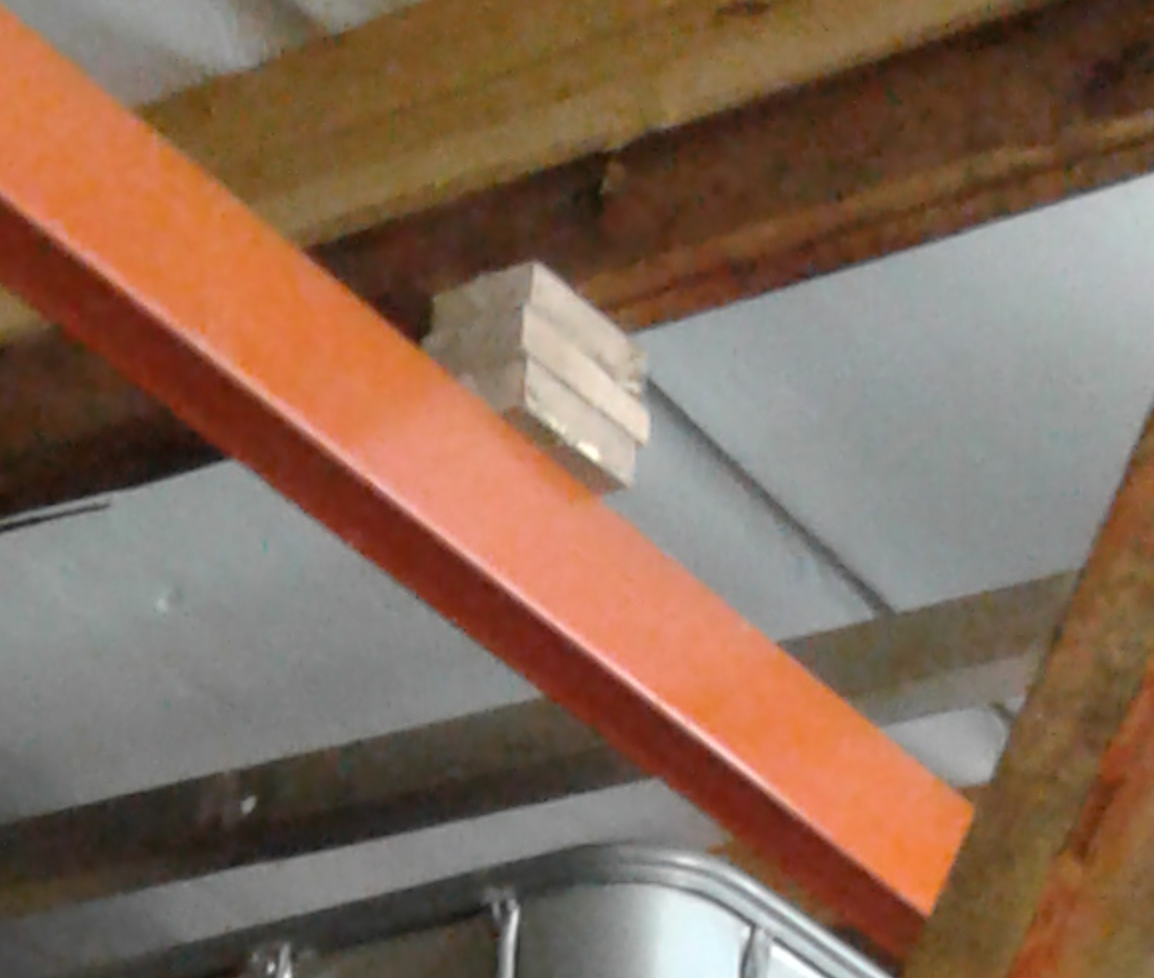

I don't currently store any attachments on the racks. But I do store a full tote of water (see pic).
On cutting down some 12' uprights I can't tell from your pictures which were cut, but I'm guessing there's some trickiness finding uprights which you can cut at the right hight without compromising structural integrity of the cross bar pattern. Interesting to consider as an option based on price and availability, certainly the 10' uprights aren't as plentiful as the 12's, if I recall correctly.
10' footers are rare, you may find a lot of 16 and 20 footers. All the 12' rack uprights I bought have about 6" above the top horizontal bar. I trimmed that off so I could maneuver them around under the roof which is on top of the rafters.
On price, I haven't done too much pricing yet. I've been looking at places like Used Pallet Racking for Sale Buy Warehouse Pallet Racks at (which has a depot in Massachusetts, as close as most providers of used racks, which is to say not close enough at all ...). Their prices don't look horrible to me, without much to compare to yet. So I'm not sure what I'm getting myself into, but as I'm only talking about 24' of horizontal space hopefully it isn't too bad. I'm guessing delivery is what would kill it if I needed that. Still, it's all cheaper than a new shed for attachments, which is what I'm trying to avoid. The Brentwood vendor mentioned by someone else is also on the wrong side of NH from me. But based on the supportive advice to this thread, sounds like I'll begin calling around this week. Just need to figure out what shelving depth I can get away with. The deeper the rack, the more it eats into the space I've taken for granted for opening the gigantic hatch on my 220" Ford Expecdition EL without opening garage doors. I suppose some sacrifices must be made.
For your purpose figure out the widest attachment you need to store UP. You can always rig up a pulley and ramp system to drag it up a level. And remember you can leave the lowest level EMPTY. I've one section I left the lower level empty up to 4' high, except for a Fiat a buddy stored there for years.
