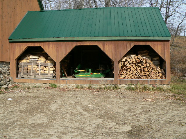

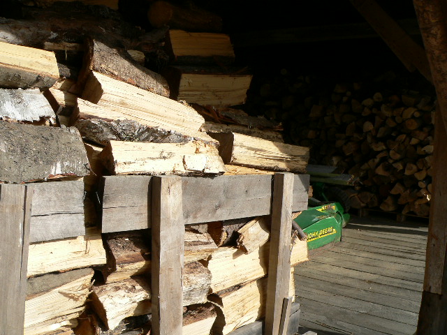

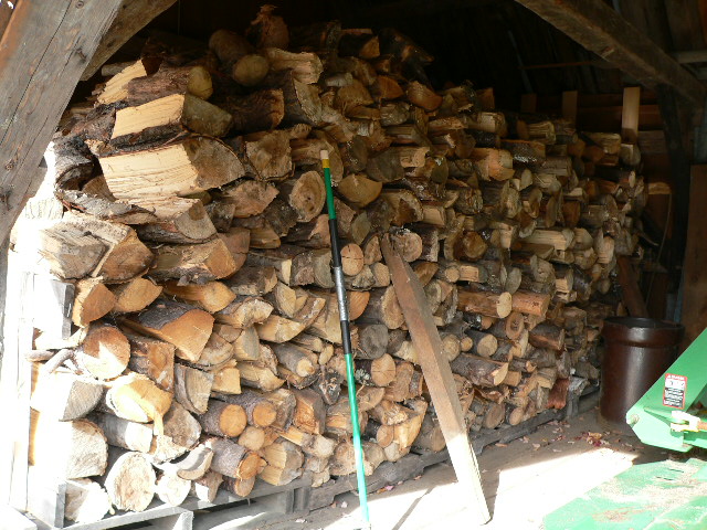

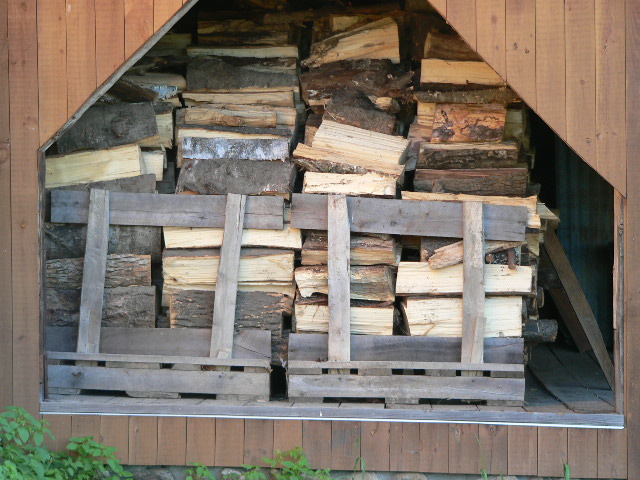

I try to handle the wood the least amount of times as a primary goal of my logging/wood cutting activities. I put up 25 cord myself this year, so every little bit of efficiency matters.
I like the idea of pallatizing immediately off the splitter, but I have not found a way of handling the loaded pallats into my wood shed that both uses the space efficiently and allows me to load them up to 8 feet high.
Putting that much wood up in a tin roofed shed, such that air can move around the whole of the inventory is important to sasoning the wood quickly as well as keeping the bug infestation down.

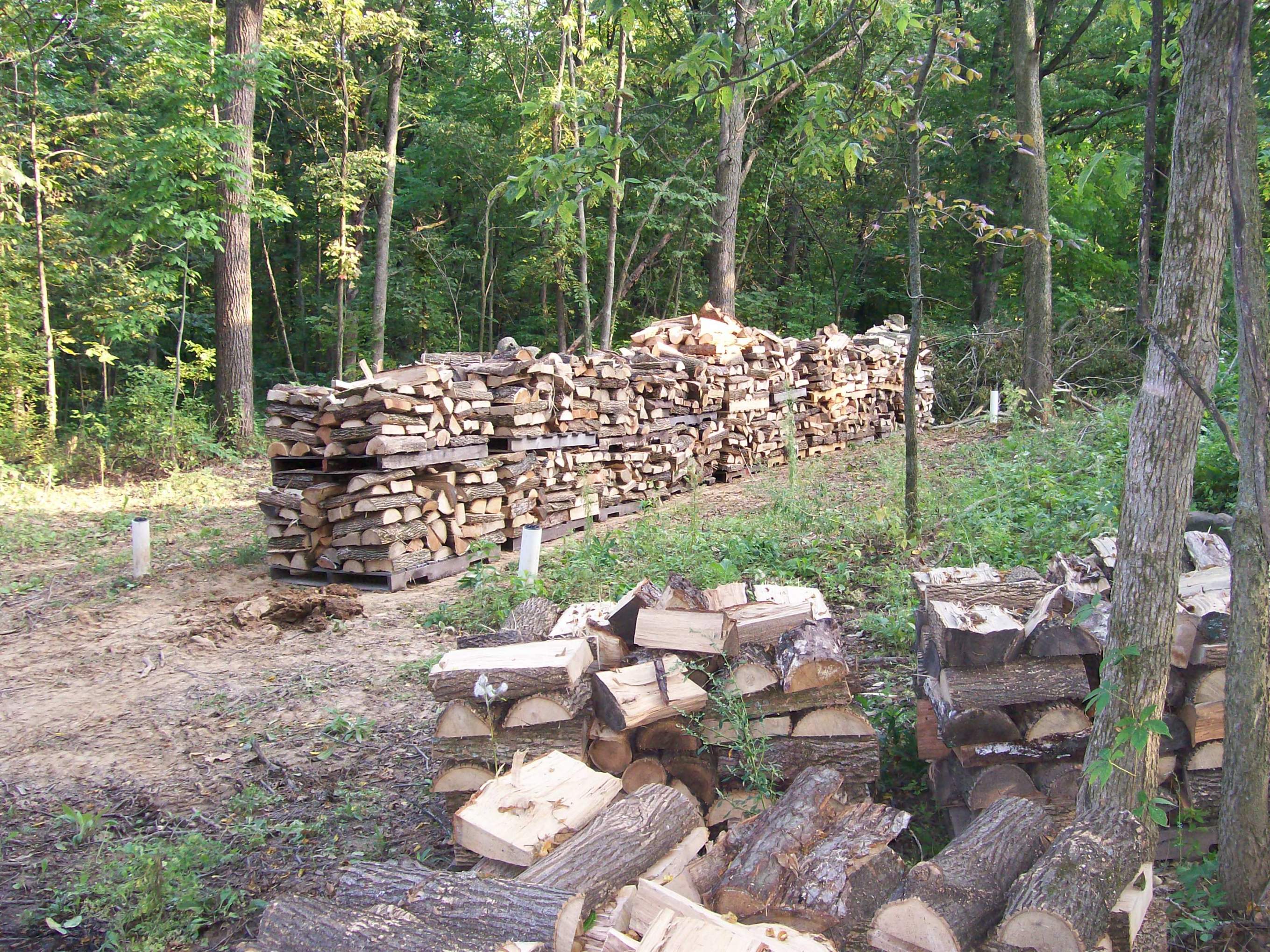

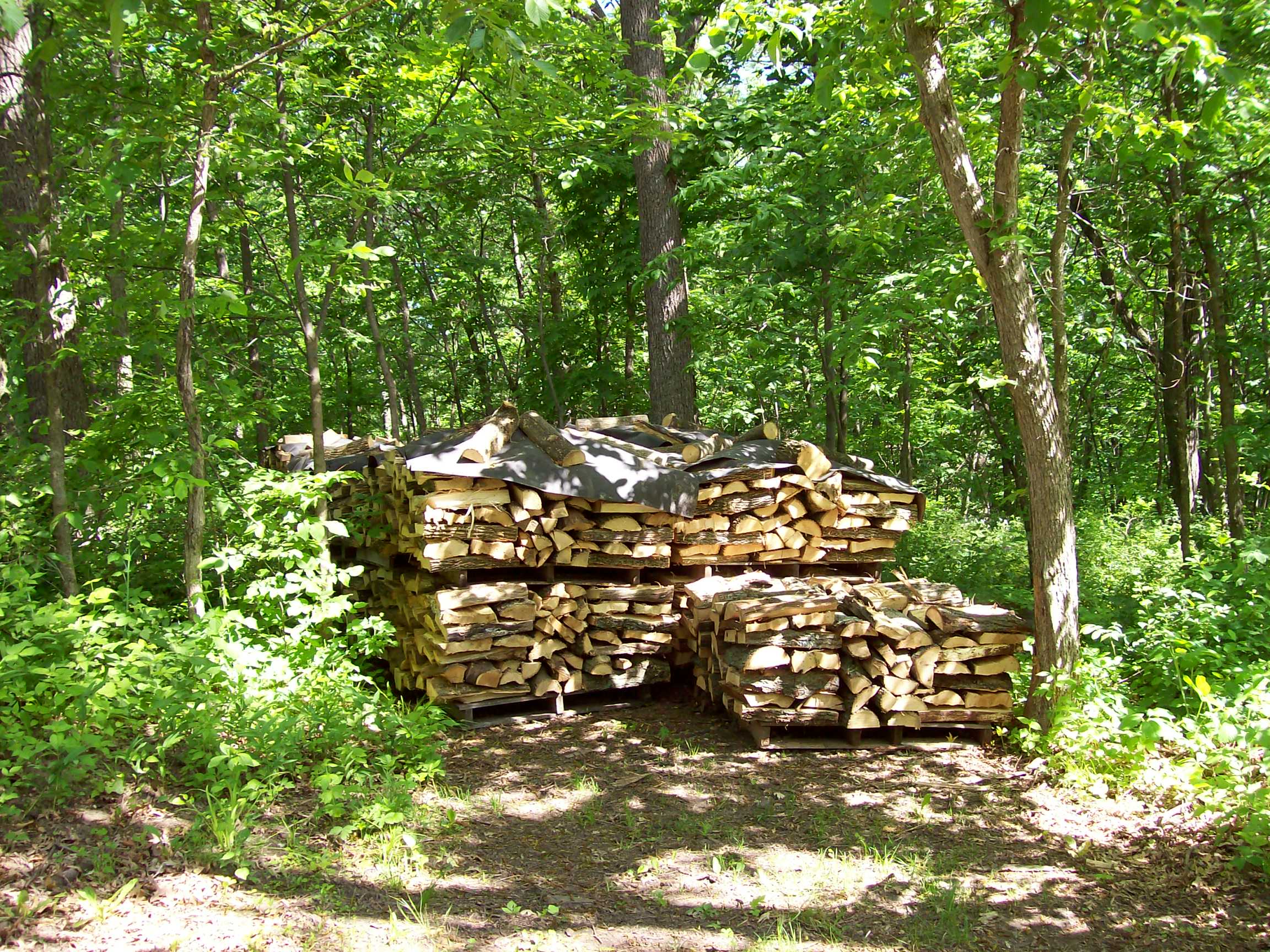

I stack on pallets, and only use upright ends (other pallets) for the small round unsplit wood. I dry it for two years (that is even marginal and better if three) minimum. Rodents are handled easily by putting a packet of poison in the stack a week or two before moving into garage. No mice :)
I put a square of rubber roofing over the top to shed water.

DeadHorse, I like the shed, very sharp! Why not put flat roller conveyer sections auctions always have the 3" high ones cheap) so you can set the pallets down on the rollers with the forks and roll the pallets into the barn.
