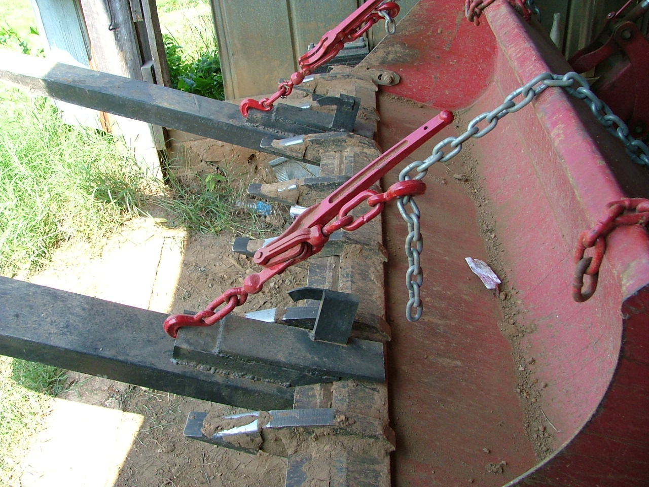

I do alot of heavy lifting with forks just keep it balanced and maybe use your BH as balast on slopes,be ready with your hand on the FEL stick to drop the load. You and your friends will love them! you can even use them to change your oil!
I would and will recomend a quick attach type as your lift ratio is rated at your link pins and not the front of your FEL bucket. So if you want to lift heavier things or have a smaller tractor? it will help considerably also when lifting(very important!) place your forks under the load fully then curl the forks/load then lift. remember you ratio is at the pins and the closer to them the easier the lift. its much easier to lift heavy loads when you curl first.
I use Gearmore forks and am very satisfied.
good luck.

We picked this set up from the NH dealer when we made a package deal. I use them quite a bit, and they have stood up well so far.

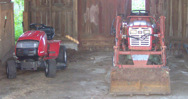

I'm not sure how I would turn my bucket or loader into a quick attach:confused:. I would probably be better off with either clamp on forks or the ones with chains and binders. If they are heavy and hard to move around I can always make a dolly for those too like I did for my rotary cutter and box blade.
The empty weight of my tractor without fluids or loader is just over 1400lbs.
Mad Referee sent me some plans to make some nice ones. I am running that idea past my neighbor who welds to see if he thinks we can do those.
I will try to get a pic up of my bucket to see what you guys think.

A picture of my front end loader.
I suppose you could call this a picture of my "garage" too, Timber. My garage though is a corncrib!

Oh, if I were to get the ones on ebay, what would I have to do to my loader bucket? Weld some hooks to hold that bar they are on?

That's the down side to the quick attach bucket forks, you need to weld the hooks to your bucket. We would need to see a picture of your bucket from the side to see how difficult this would be. If the bucket has a top flange, people will sometimes use "L" brackets to create a flat surface for the hooks to be welded to.
The other option would be to have your neighbor weld the hooks to a long piece of flat bar the width of your bucket; this flat bar with hooks could then be bolted to the top of your bucket. This would allow for removal of the hooks later on, if needed.
Clamp-on bucket forks may be your better choice (no welding). I would lean towards the type that Timber has as opposed to the chain on type. I haved also seen clamp-on forks that allow for a vertical 2x4 (wood or steel) to act as a back stop. One example can be seen here:

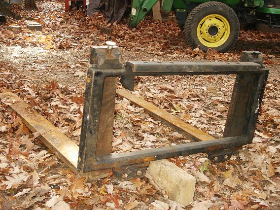

If you can weld or have a friend that does you fan build them fairly easily.
I bought the bare forks and frame at an auction for $80. Bought the attaching hardware from Deere. I figure the total cost was around $160.
