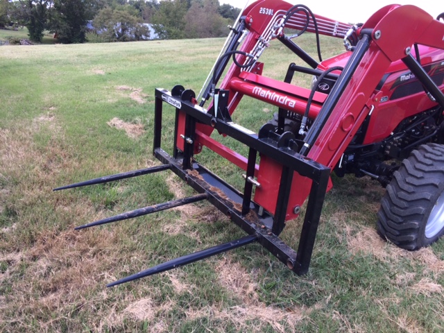

I have that same set-up on my 2538. The "forks" actually move. There are about 6 or 8 different holes they will go in. The middle one can be taken out all together if you want to use as pallet forks. Tractor Supply sells the whole set-up for around 500 bucks.
To my eyes the Titans look better and easier to adjust while they are also cheaper.

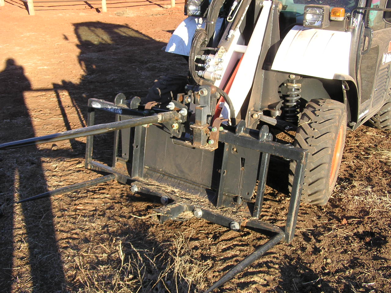

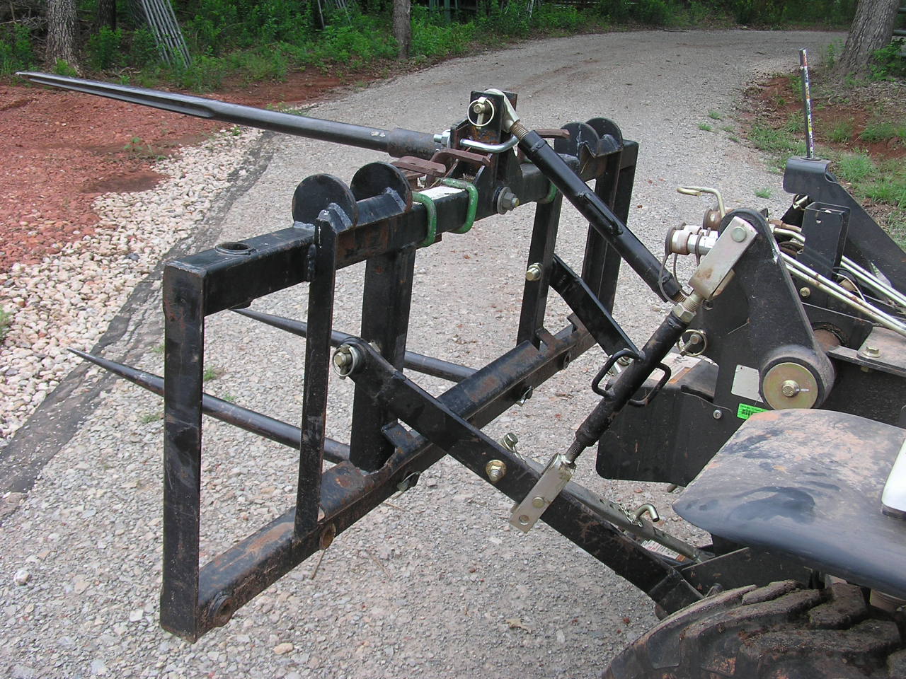

I was just showing how a fork frame can be made to fit on the 3 point or FEL QA.
I like the trailer receiver in the first pic. Very handy to move trailer around. Did you make that?
/ Pallet Forks #28
Yep, cut the ends off of a receiver hitch and drilled holes through it so it would bolt on through the holes in the Speeco UltraFork frame.
