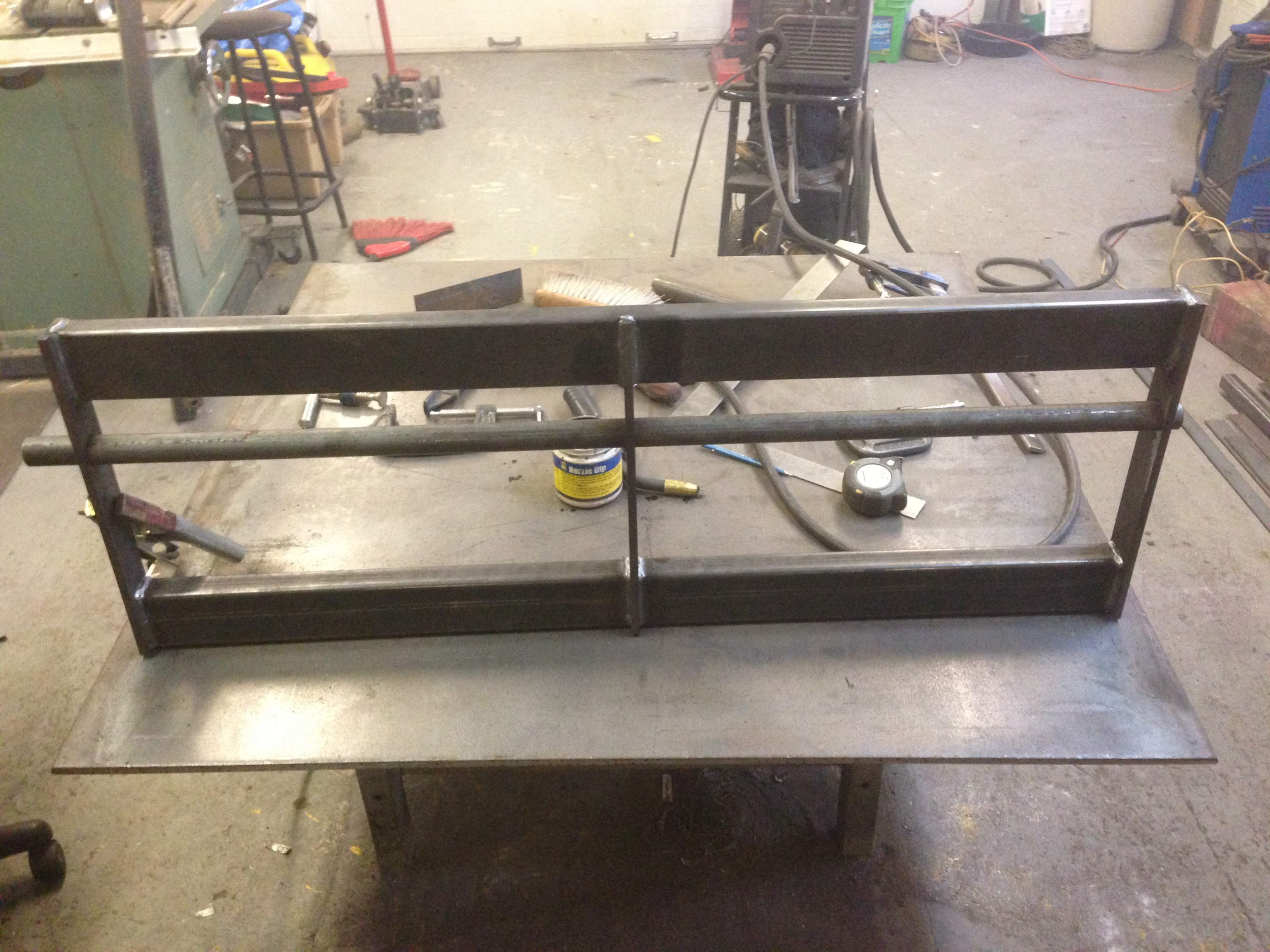

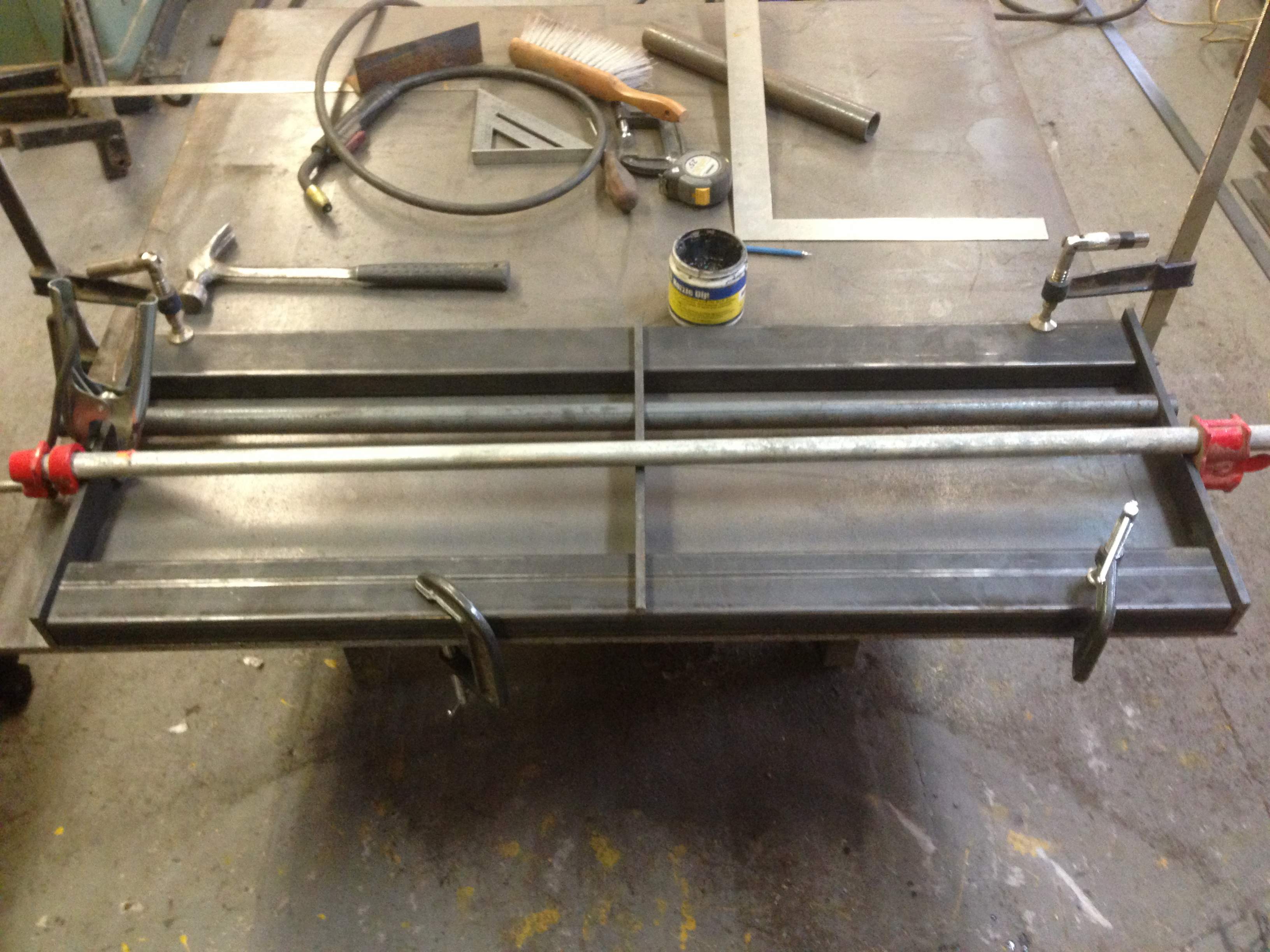

Next job was to lay out the frame and clamp it down to the what will soon be the new top to my welding table. The two ends and center support were drill on the mill and machined to 1.28" in diameter.
Frame all welded up.

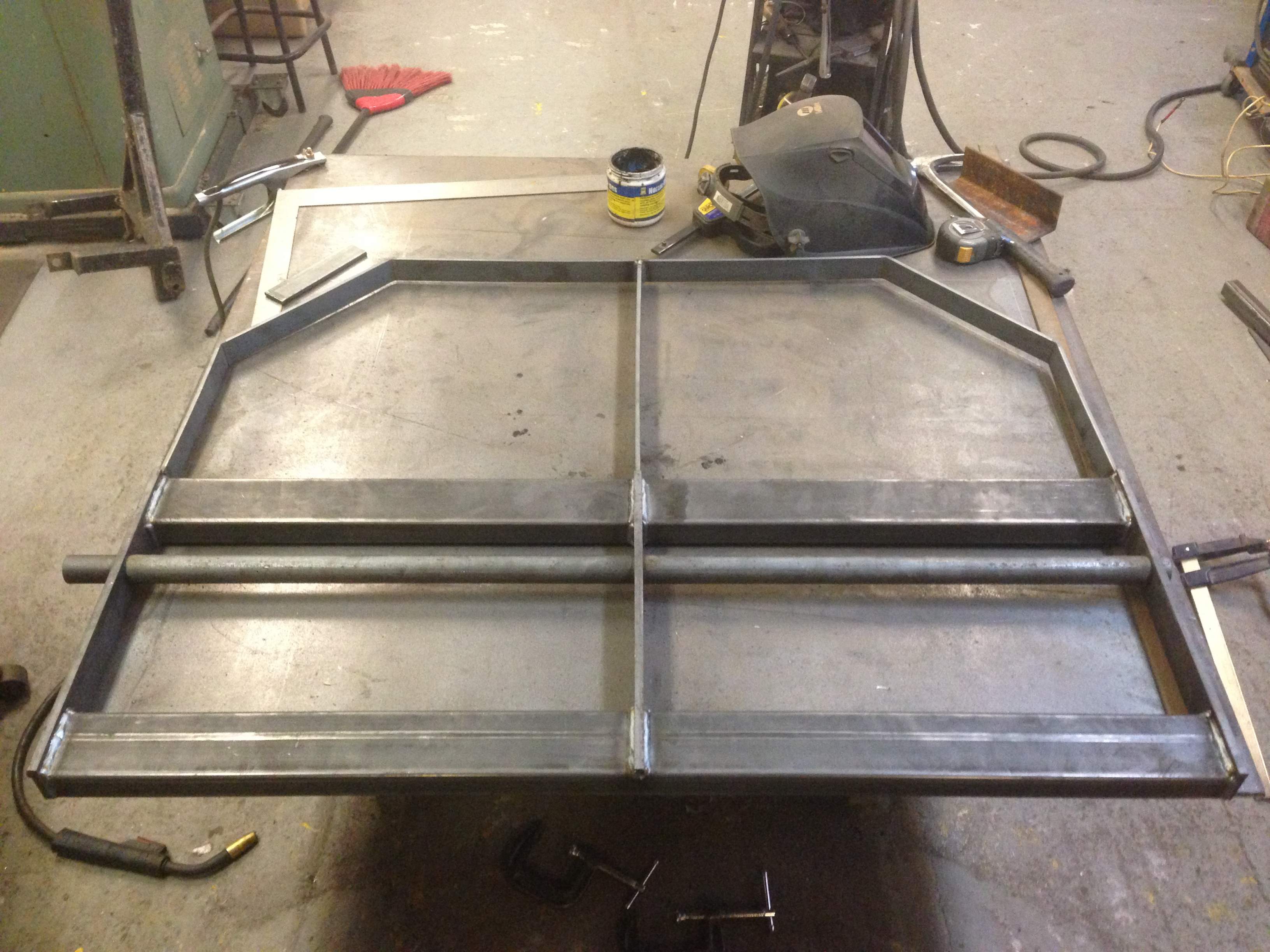

Start of the guard. I ran out of steel so I will have to finish it up latter.

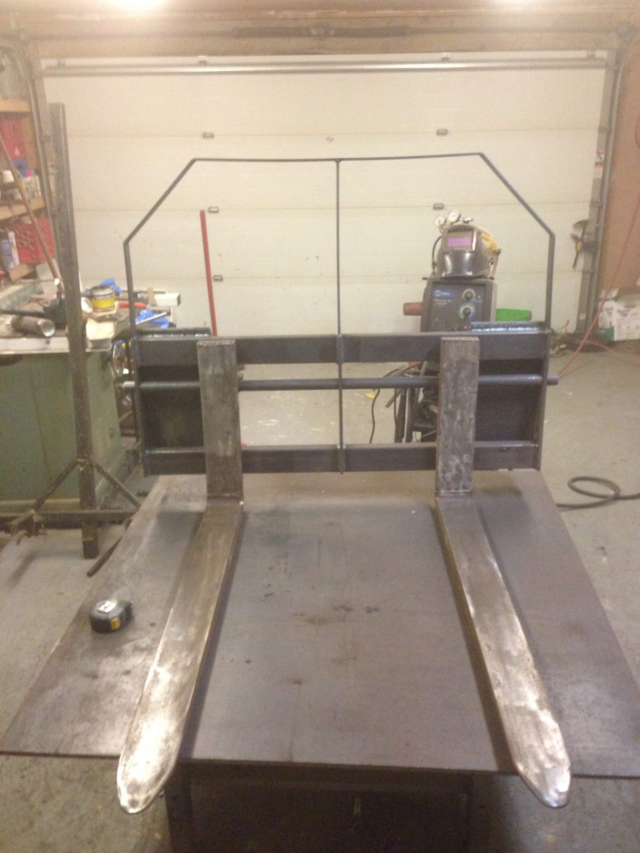

Forks installed.
Lifting the table and 1/2" steel plate. Total weight is around 375Lbs. Lots of capacity left in it yet.
