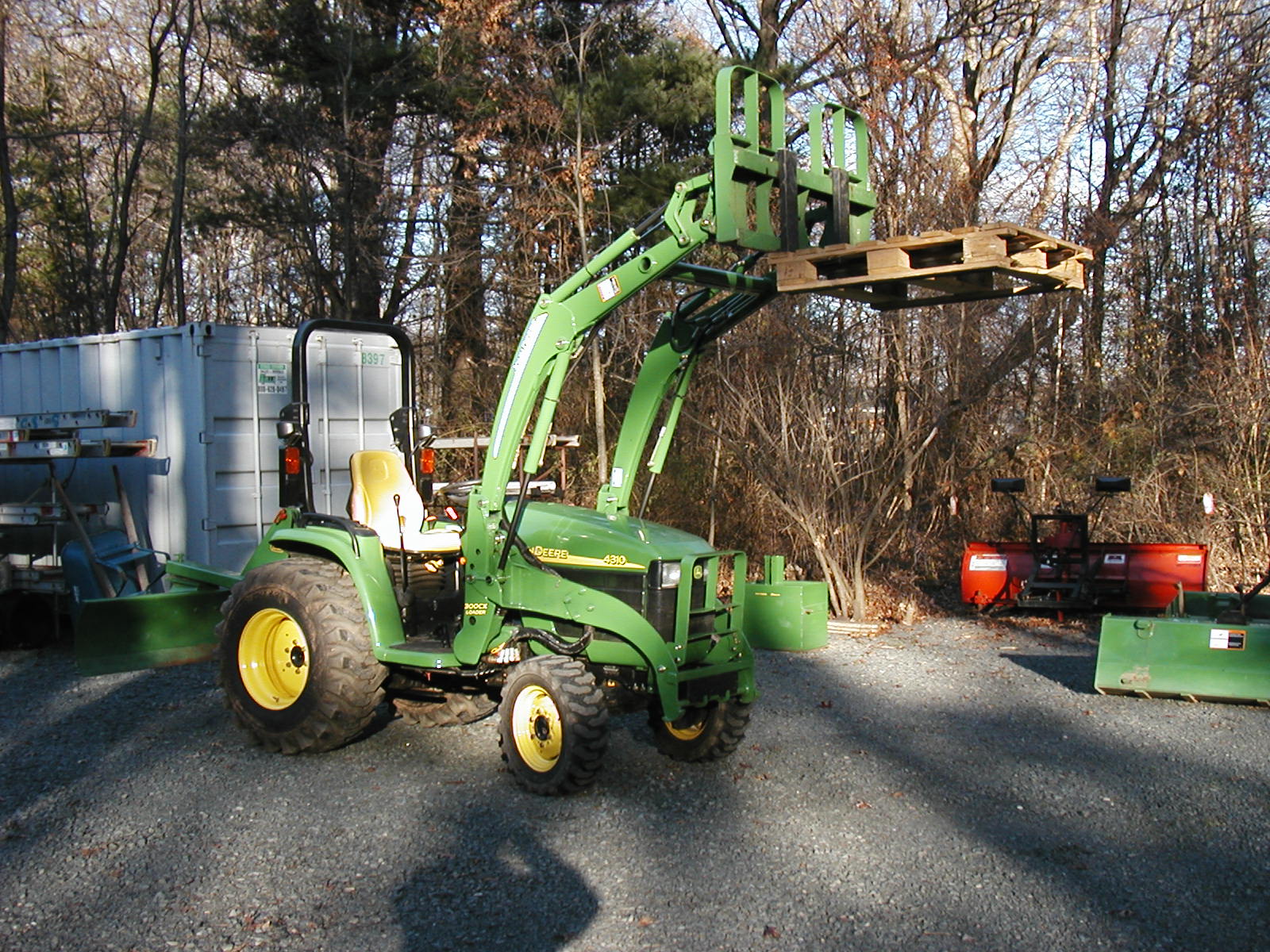

I've got the Horst 2K 42" cast forks, not the cheapest but very well made. I made mine to work with imatch QH as well.
JB.

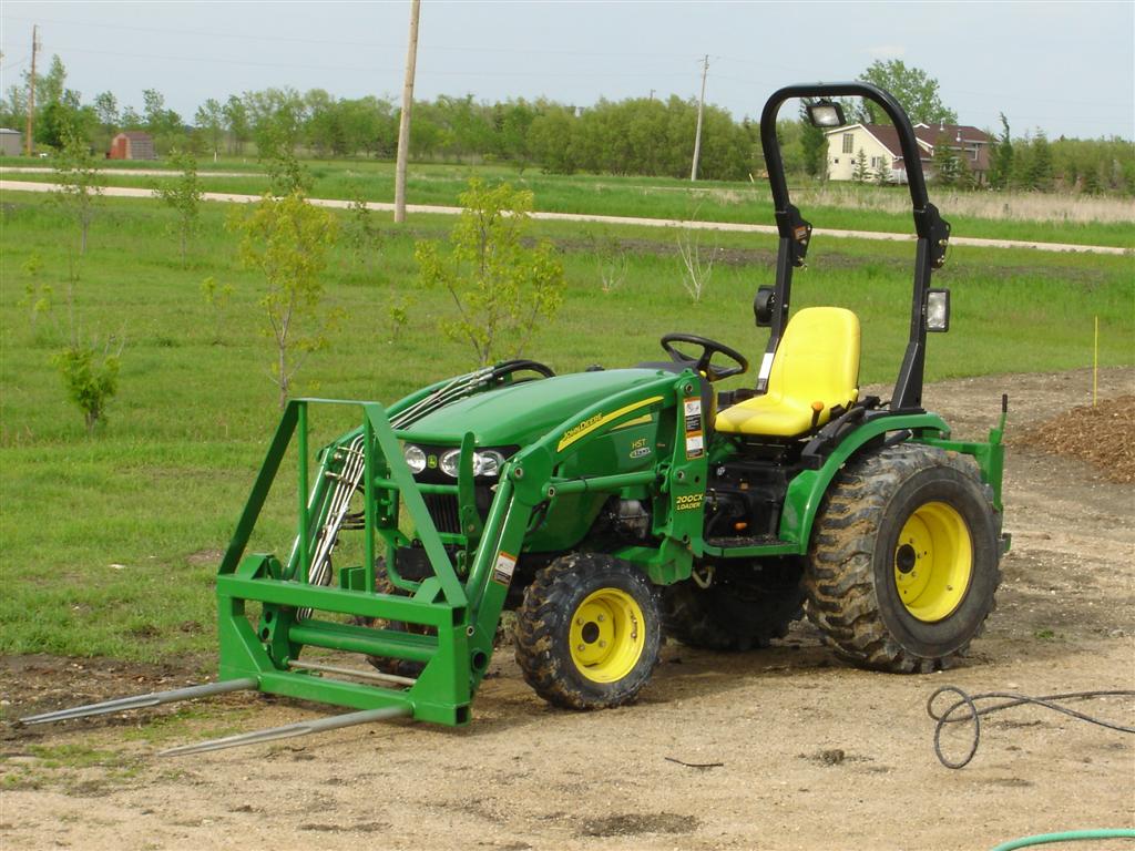

I use the Frontier 2 spear hay spears. They are spaced a little further than the pallet forks but you just spear the pallet the opposite direction and they work extremely well. They then also work perfectly for picking up trees/branches etc... IMO, 3500 lbs capacity is not an issue on a loader than can only pick up 2000 lbs max especially something the size of a pallet. Figure about 1000-1300 lbs max hanging out that far from your pivot point.
Mine looks like this one below except it doesn't have the extra top protection.

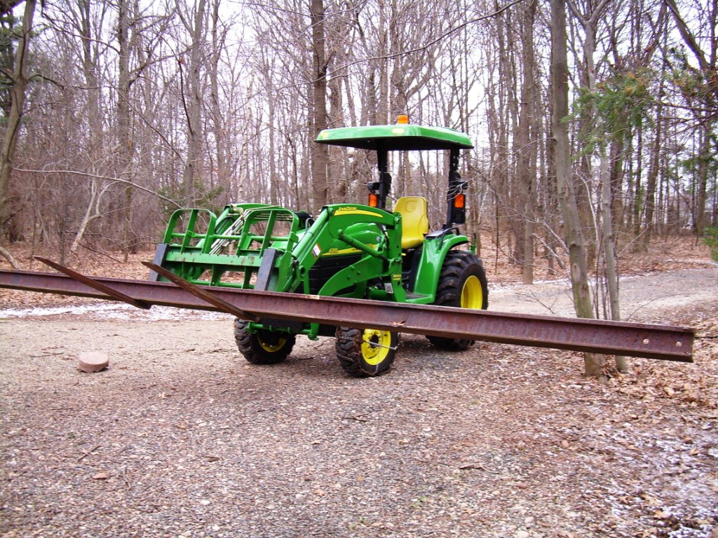

Not sure what's meant by fixed vs floating, if floating means you can adjust the width, Mine are adjustable and I move all kinds of things, not just pallets.
I didn't realize any better quality forks would even come un-adjustable, seems that would be a detriment.
JB.
