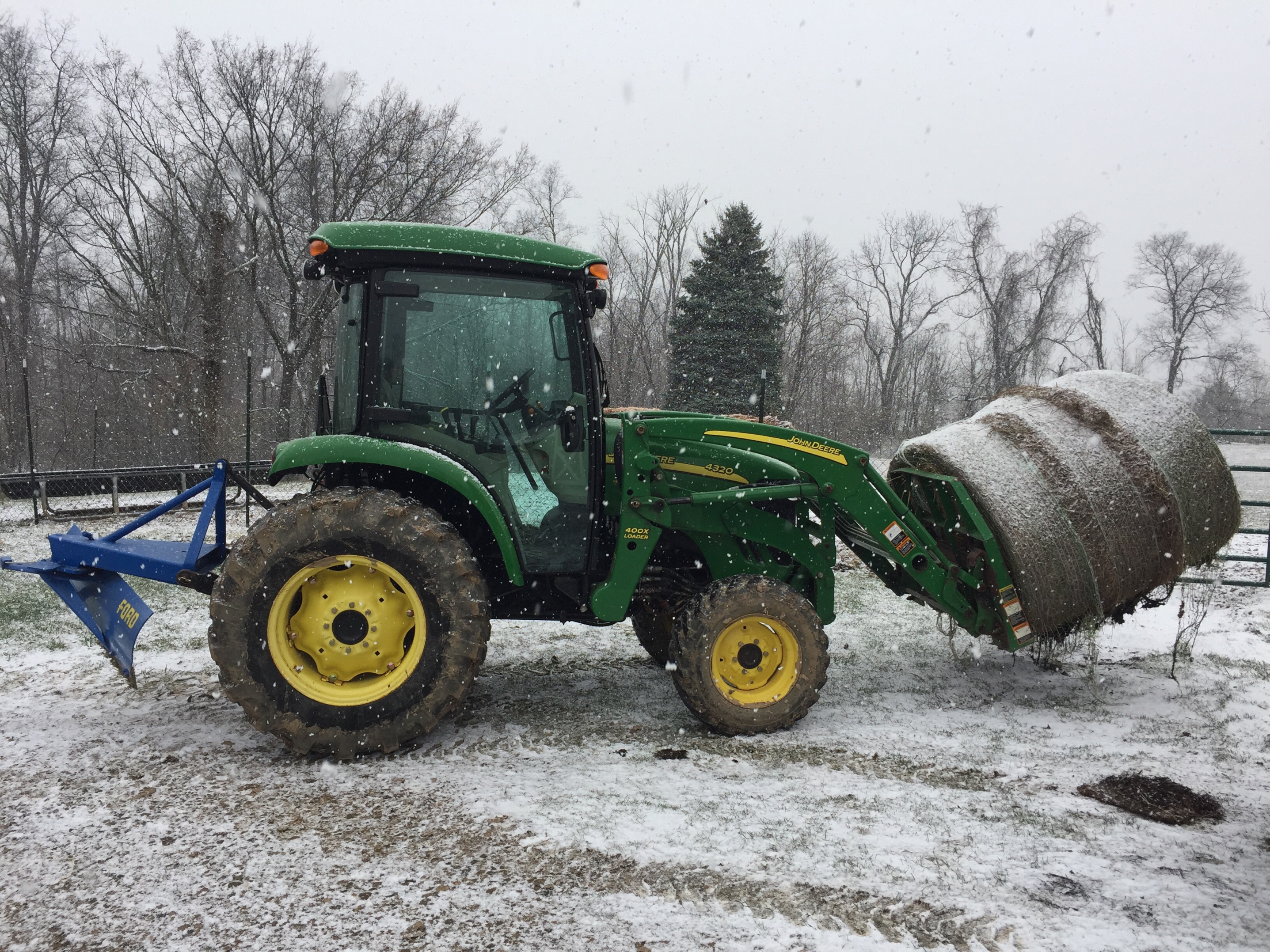

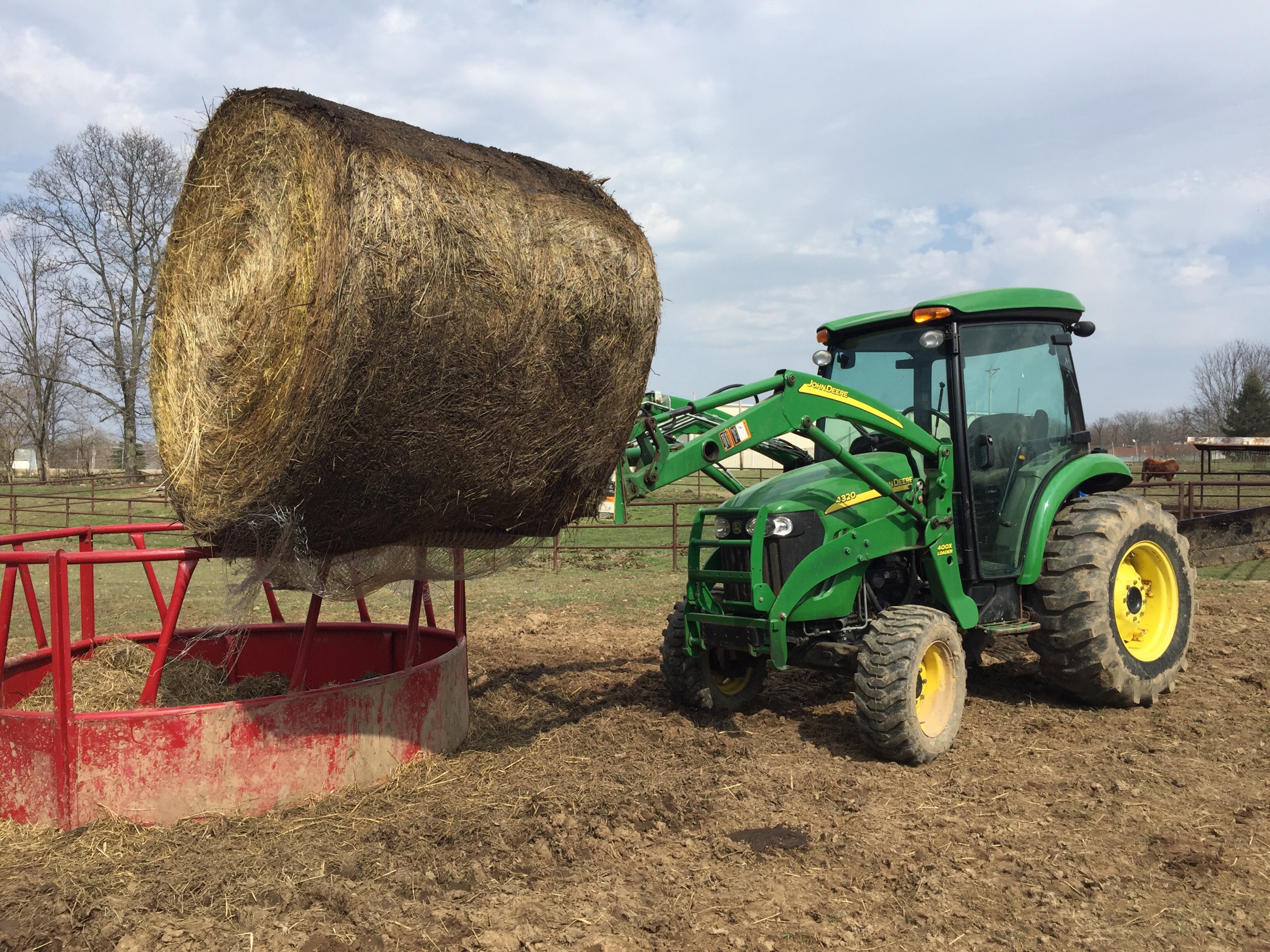

What I use my pallet forks for. I have never measured what there length is. I know there about 6in shy of covering a 4ft round bale. So 42in? I often wish they were longer but these get the job done.
I love my forks, never even had the bucket mounted, I have been able to do EVERYTHING with forks and a rear blade lol. Snow removal, hauling, light ground engagement, feeding cattle mineral tubs (250lbs), feeding cattle with round bales (700lb-1500lbs) ext. that big bale was easily over 1000lbs.
If I had to buy them for what I use them for, I would go with 48 but 42 should be just fine.
I would get one with a nice tall guard like mine or taller, saves crap from falling back towards the tractor.

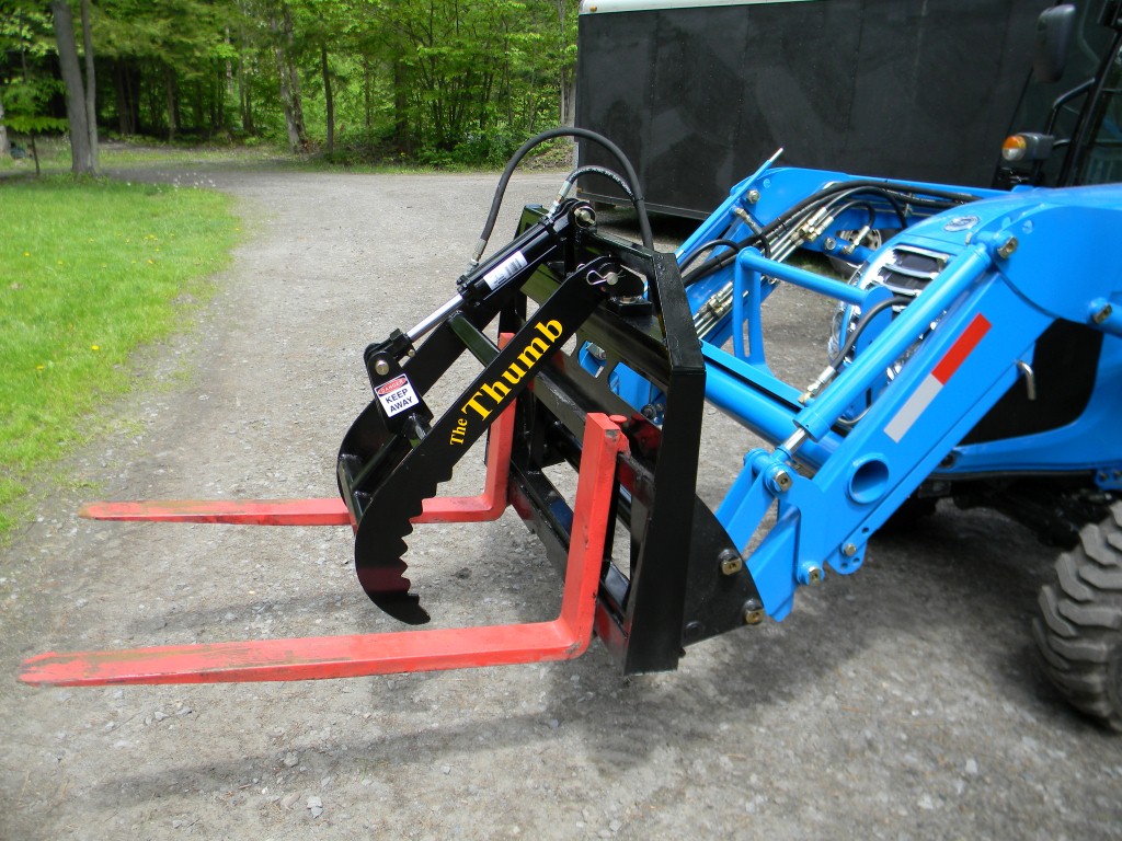

It depends on what you will be using them for. I started with 24", no pallets, mostly brush.

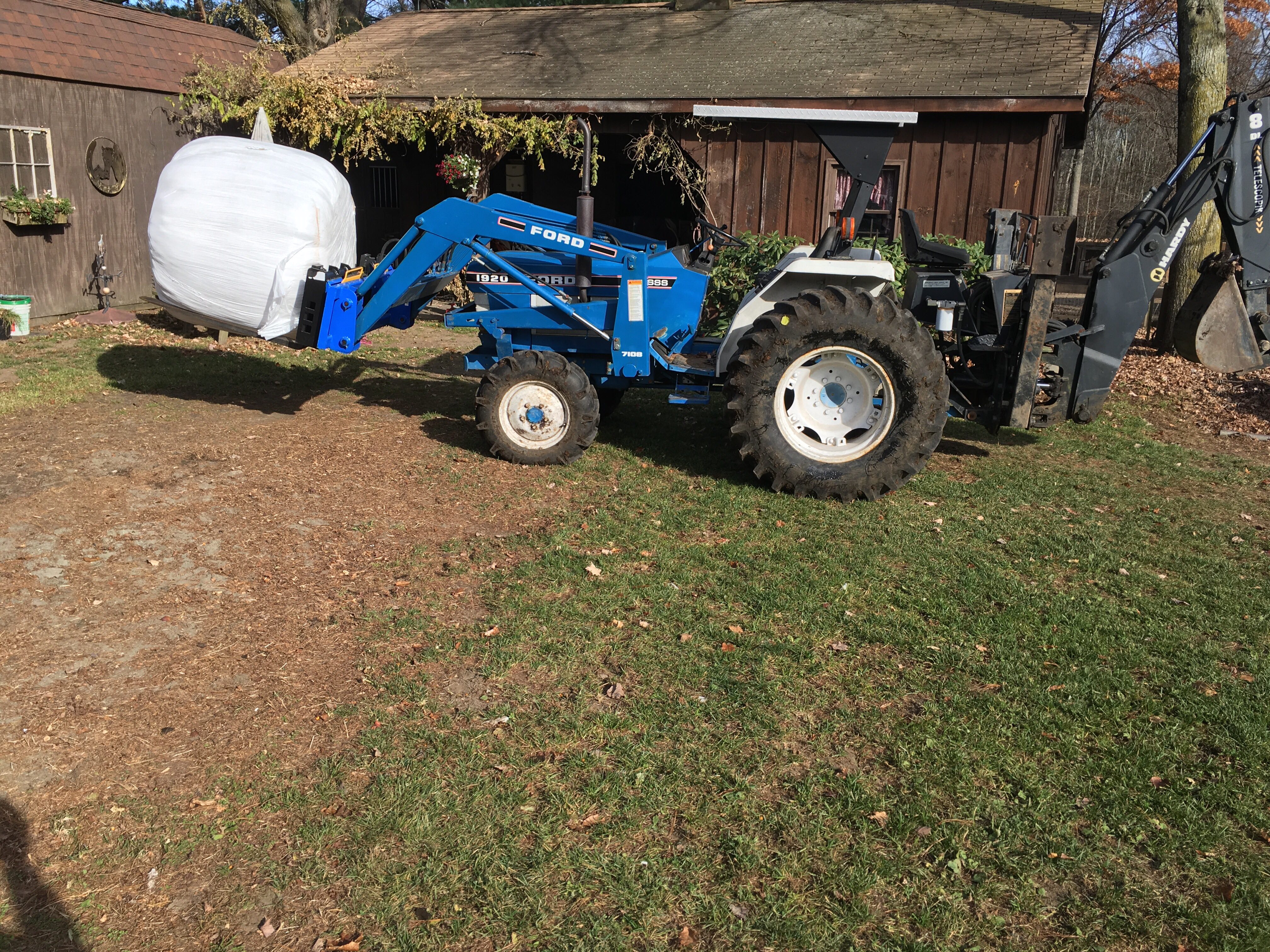

Yes the problem has been corrected. I have a pair of 42" forks and have no problems. IMG_0594.JPG
