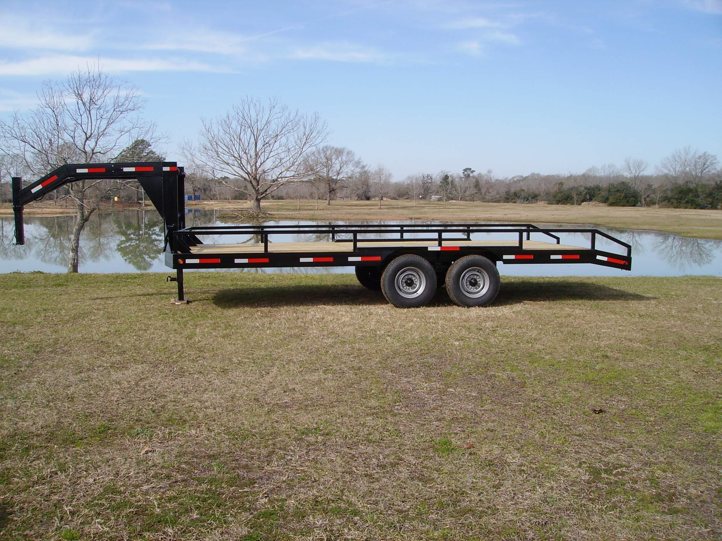

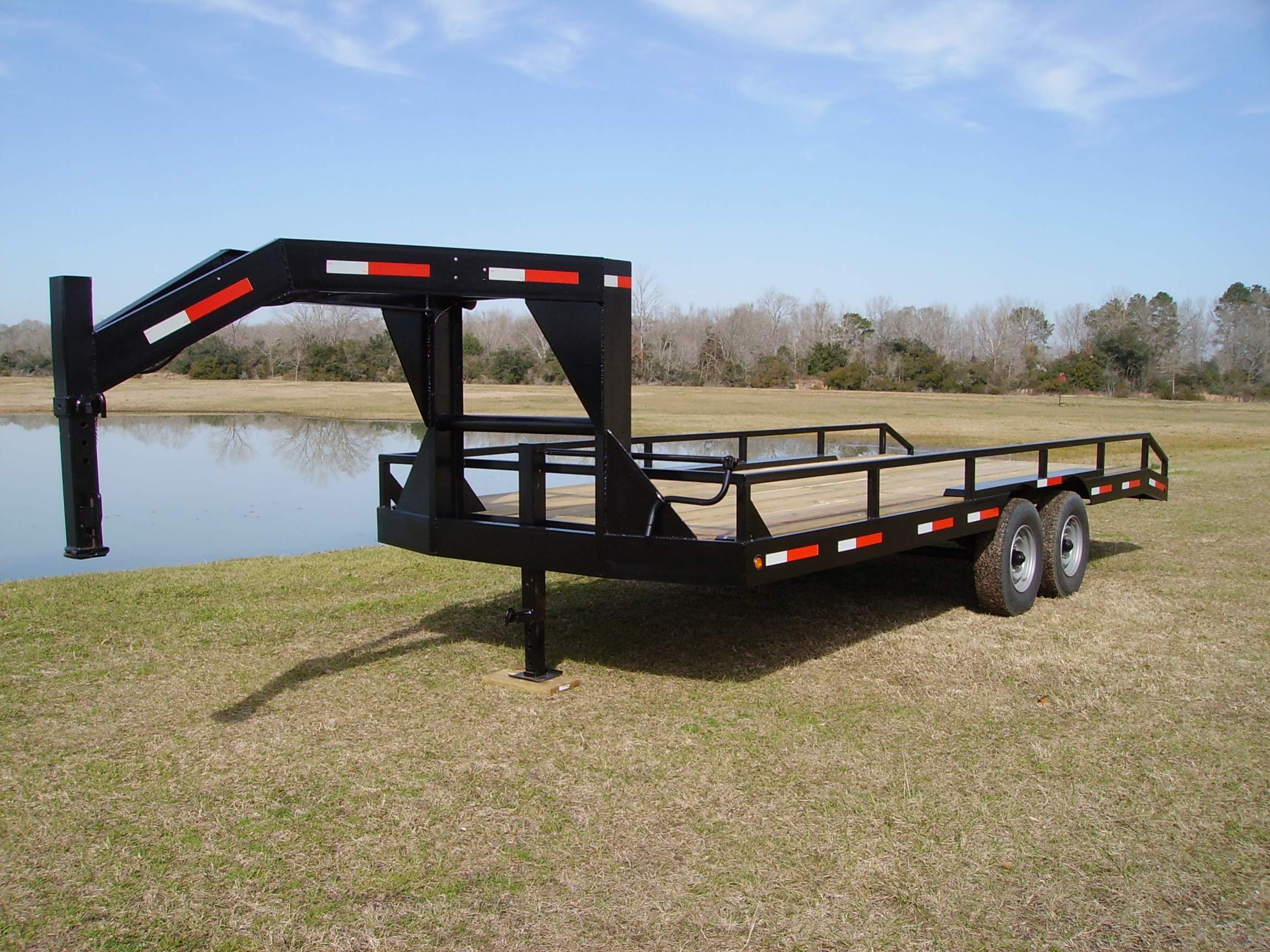

I used some paint from Tractor supply, I think it was called Truck and Trailer paint or Implement paint, if you do use this paint be sure to put a hardner in it, its makes it shine better and helps from rock chips, after about 3 years it still held good color, had to paint a few places here and there, but that was from the way I used the trailer. Good luck

After I painted this trailer I keep it for 3 years before selling it, the paint held up good, just had to keep it touched up from normal wear from chains and tie-downs, other than that it held its color. Reason for selling was I needed a longer and more heaver axles, I went from 2 7K's axles to 2 12K axles.
I keep it inside and outside, hard to tell if the sun faded the color or not.
