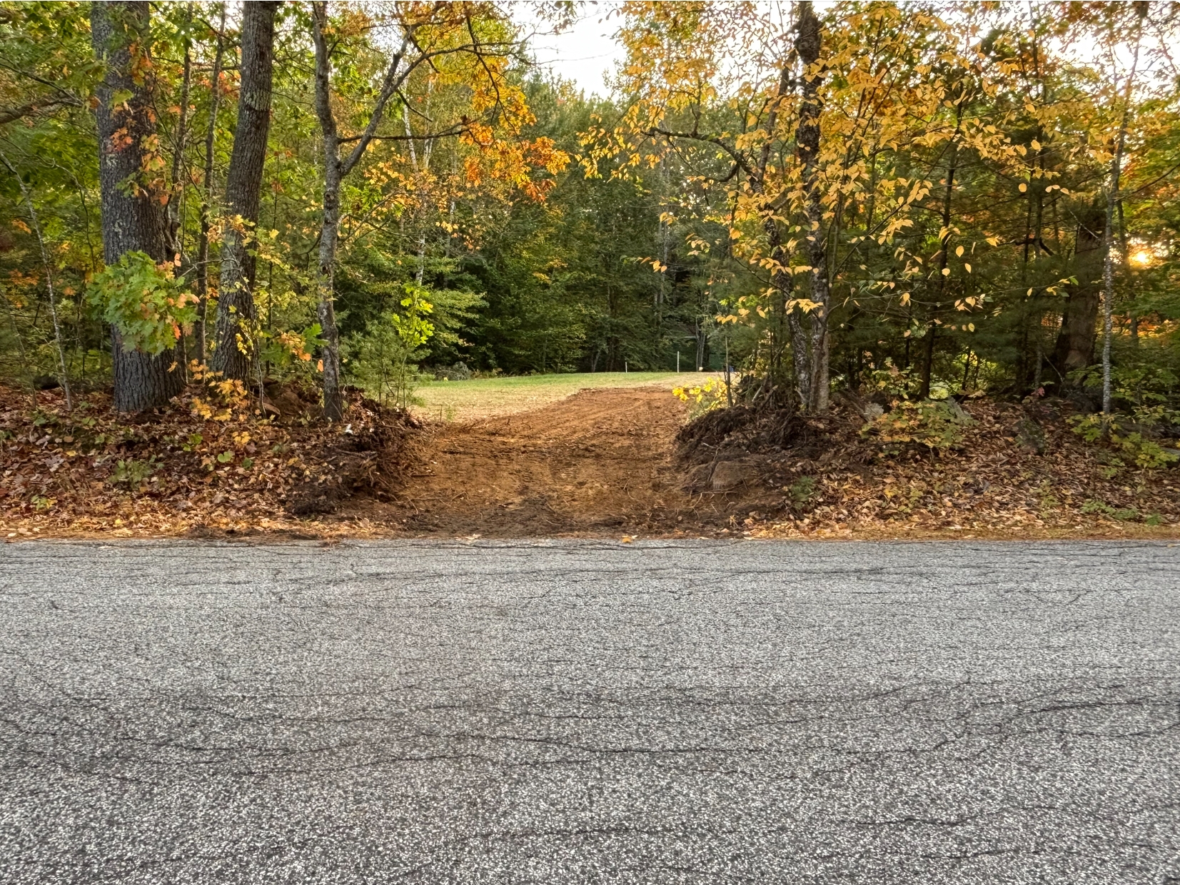

I put 50 hours on last season and about to hit another 50 now. That’s going up every couple weeks or so. If I was there full time it would be higher.
Here’s my latest job, breaking through this old embankment to start a driveway. This is about 3.5 feet high and 10 feet or so deep of hard packed soil with rocks on the interior, and roots from the trees grew on top. This was old farmland that was sold off in chunks. An excavator would be the right tool for this job but I don’t have one, just a bucket and piranha bar :).
Still a work in progress. Have to clean up the entrance and shape it. Also need to use the box blade to dig down so I can put down a base. Pic is misleading, that’s a bit over 75 feet in length and will be probably 100 when I’m done.

That looks awesome.
