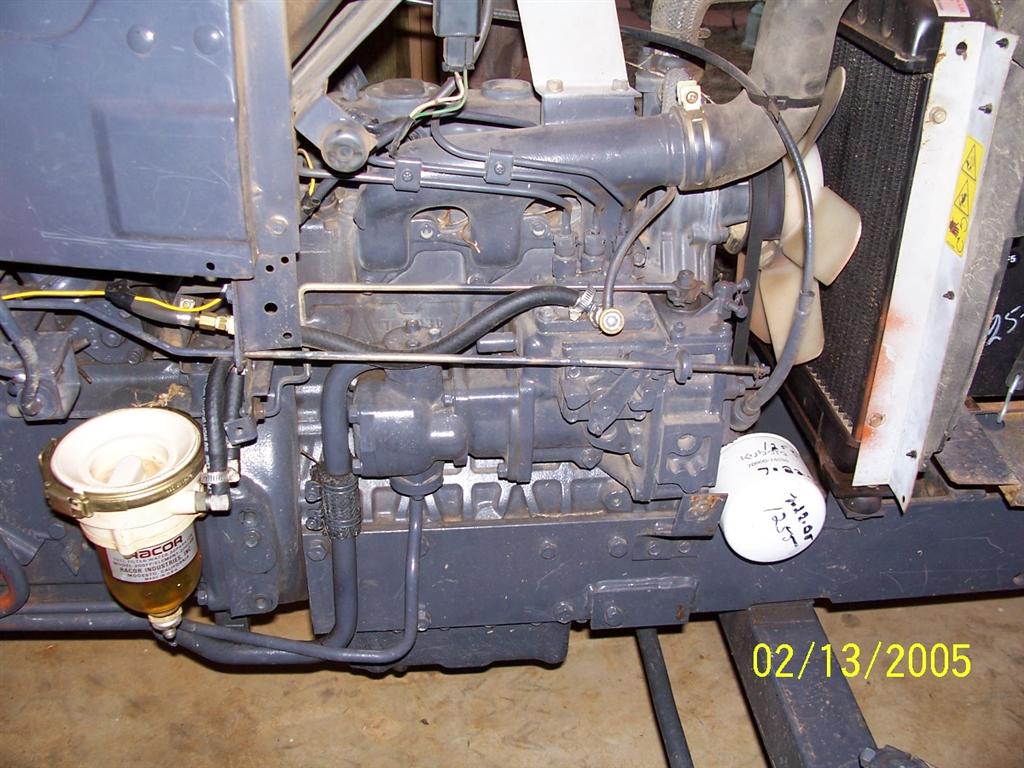

It seems not all models have a fan shroud. At least my L2500 does not. I don't see one in the parts manual either. Mines been running hot lately to. After flushing the system I left plain water in. The temp got up there but no weeping from the overflow tube. An this was while under a heavy load (disking). I'd heard a while back that plain water is best for heat extraction, but antifreeze keeps it from freezing and keeps rust out of the system.
A pic of a sticker L2500.

These little Kubota engines are more like a car engine. Solid cast with machined sleeves. The sleeves on my L2500(looking at the parts manual) are not replaceable like on My BIL's JD350 or his old International 384, both engine I rebuilt for him. So with a solid set up like this a couple weeks shouldn't give me to much trouble, but I plan on putting the anitfreeze back in. I plan on pulling the radiator and flushing it out to make sure. I've actually bought a new head gasket and may replace it this winter. So I'm holding off on the anitfreeze while I keep dumping the system. I flushed it again this weekend while scratching my head on the overheading problem.
BTW while looking at the parts manual I noticed the pistons and rings come in standard and a +.50mm (about +22 thousanths). Here's hoping I never need any of those. ;)
