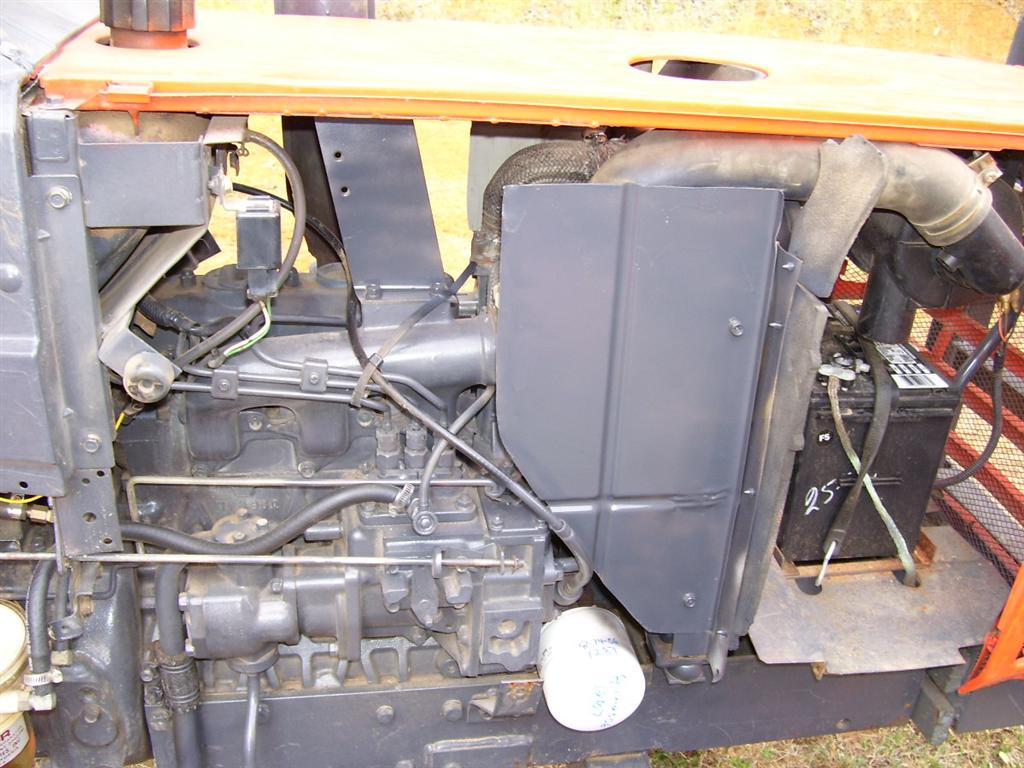

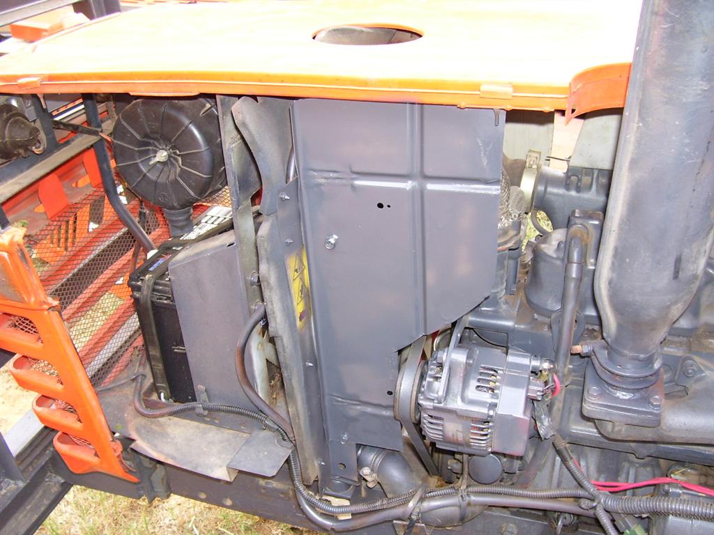

A little update....
OK Rob here is my resourcefulness at work. Washer went out and replaced it, friends coming up to the weekend place this weekend so wifey says haul it off. Drag it over to the dump with the ATV. Get home, look at the tractor and think about the shroud. What could I use...oh yeah, parts of the washer I just dragged off!!. So using the back of the washer sheet metal I fabbed these. They really did help tunnel the air and I believe I could see more ait being pulled through. Temps did seem to remain stable (still on the upper side of the gauge). But when I got into hogging some 4' goatweed (stems as big as your thumb, the needle creaped up some more. I hate to think the designed cooling system can't work better on a 95 degree day. The humidity was even down this weekend, but I'm not sure how that effects the tractor cooling system, made me feel cooler. But even with the needle up there nothing blew past the cap. Not a squeal one.
Gonna change out the head gasket this winter and see what happens. But for sure the more you load it the higher the temps.
Rob

/ overheating? #29
RobJ said:
A little update....
Rob
Wow that IS resourceful indeed! Great job and creative as all get out. I'm glad it helped a little and I'm sure now you can imagine if your shroud fit perfectly around the fan and radiator so every bit of air passing along the front of the radiator was sucked through to cool it. You are right however, to think it should run cooler and not on the high side.
I may not have mentionded this before, but in addition to cleaning out the radiator fins that were plugged, my air cleaner got very plugged up and it made a big difference after cleaning that. It turned out the engine was "starving" for air and was the deciding factor. After cleaning it it ran normal again (80°C) without moving off the dime. Now I check it everytime I brush hog and grade in dust, pollen and straw.
