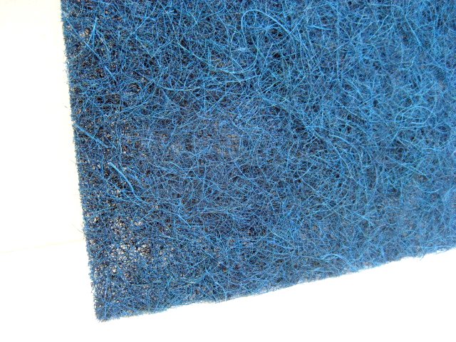

   / Overheating problem #10
FWIW, I use washable furnace filter material. Inexpensive, easily cut to fit with a scissors, available at most WalMarts. Stands up will to either water hose or air compressor. It's a full inch thick, so I don't even need to fasten it. And is big enough that I can cut two tractor filters from one furnace filter.The air cleaner housing bracket holds it in place nicely. Pulls right out for cleaning, and it's tough stuff. Have had the same pieces on both my tractors for several years now, neither show signs of needing replacement yet.
//greg//
