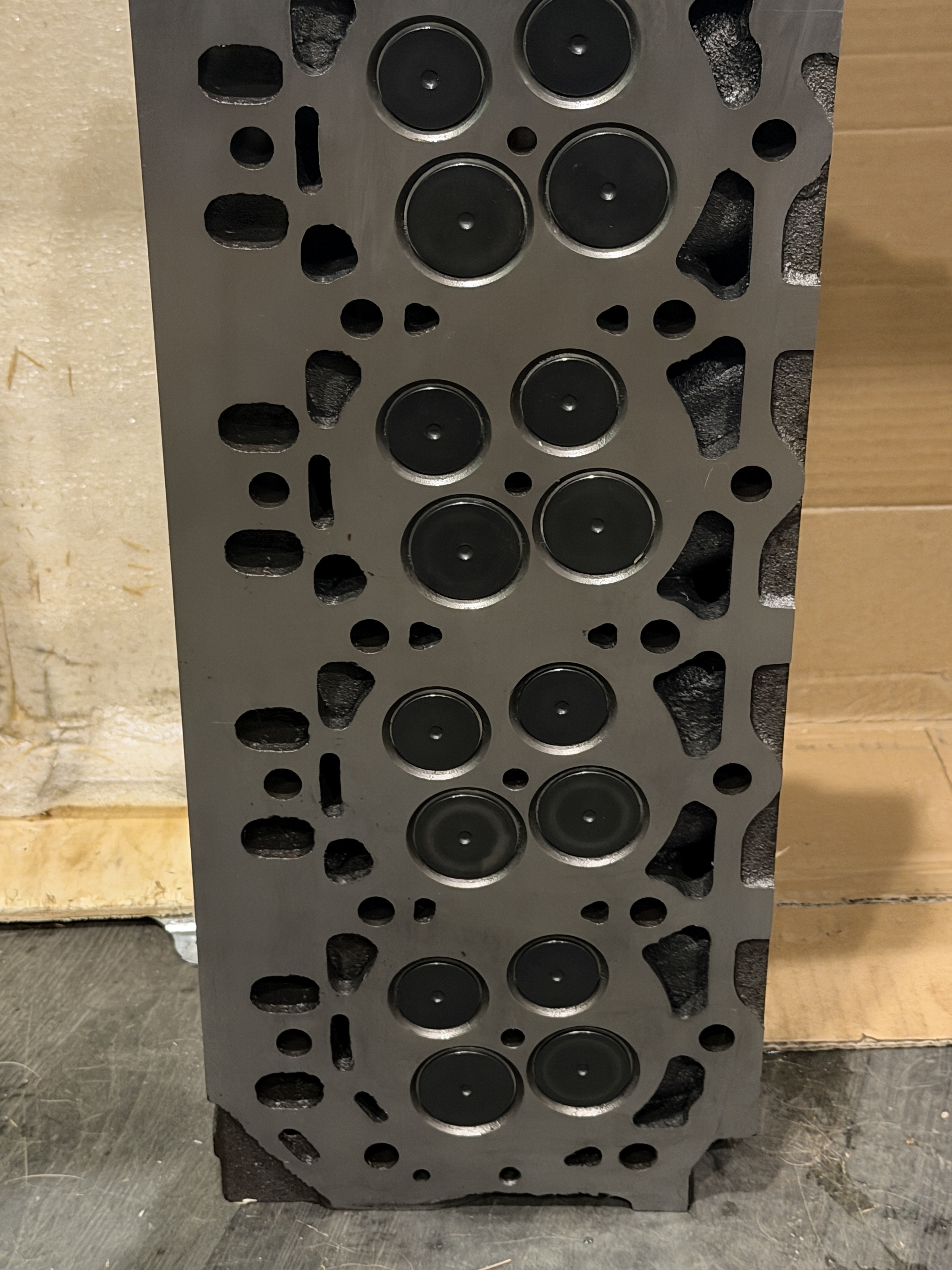

Ok sounds good I’m not pulling the pistons. I ordered a new head from fridayparts with the valves in it. I am finding the bolts are not torque to yield so I can reuse them. I do have a pic from the manual that shows the torque specs and process. I had to use that to remove the bolts in the same order. They do half torque first the final. I do have a gasket kit for the engine so I can install all new on the head, intake, exhaust etc. looks like the granite I got is 12x9x2 and the paper is 11x9 so there will be some non sandpaper edges it seems and I guess that’s ok. I just ordered the Dykem steel blue also. Getting close to done, thanks again for all the help.

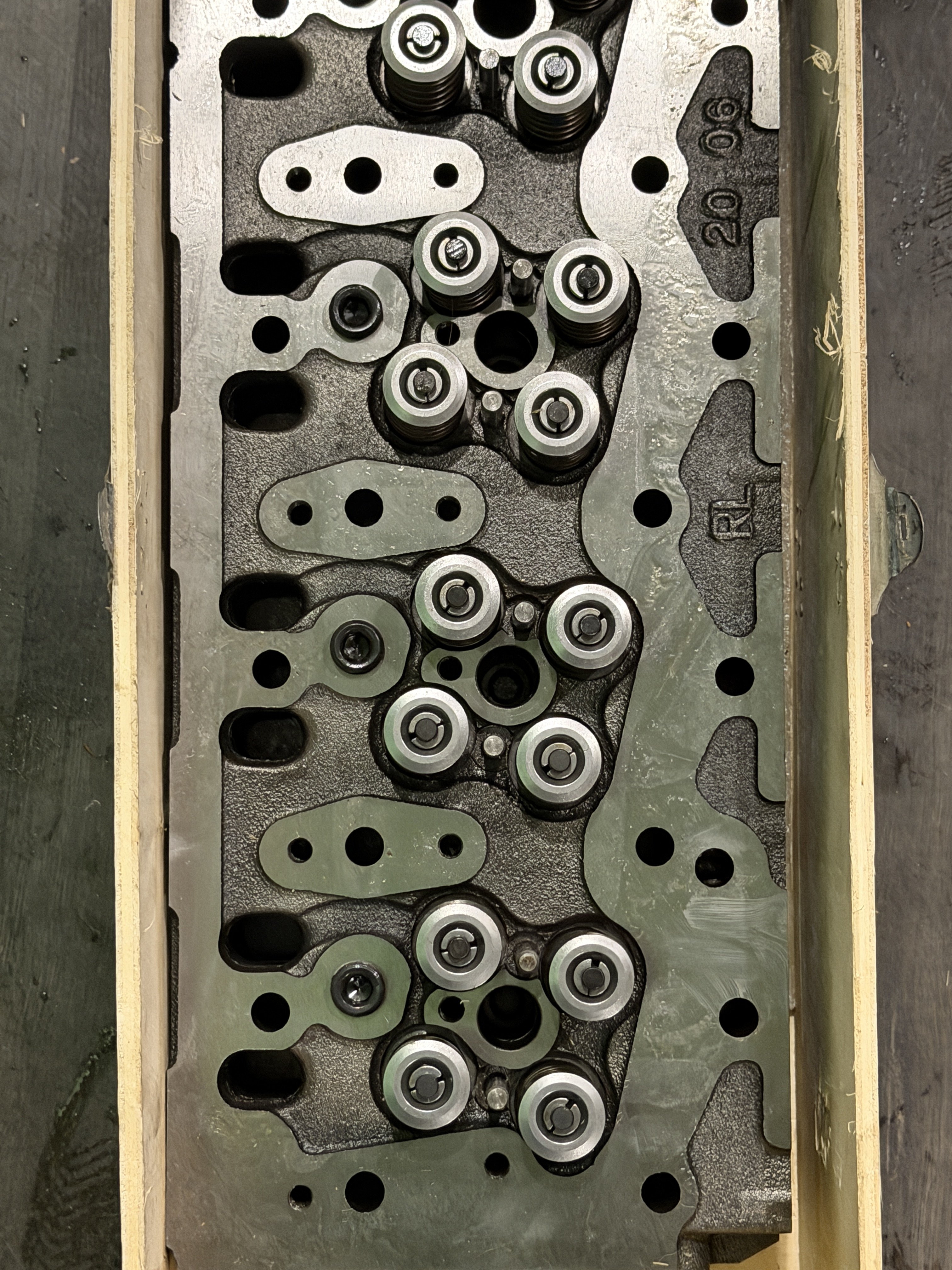

There's a young fella I watch on YT, 2vintage he buys old bikes mostly and rebuilds them, not a mechanic by any stretch but a pretty smart fella.
He had bought a Kubota RTV900 with a bad diesel engine, ends up the head was cracked so he bought a new one off EBay. Long story short it was the correct head but the wire the valve springs was made from was too big a diameter. It ended up breaking a rocker arm when he got it going as there wasn't enough space to compress the valve with the too big diameter wire. Just something to keep in mind to check when you get the head.

New head is in, almost ready to get started with this fix.
