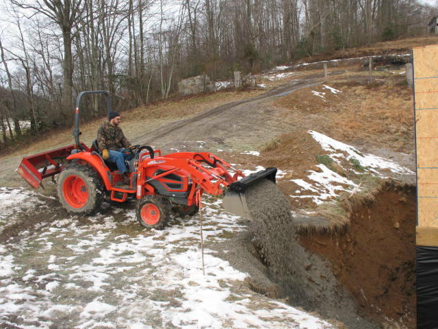

Update:
We've got the electrical and plumbing inspected and approved. We plan to install all the wall insulation over the next few days and begin staining the siding. Our HVAC contractor has begun his work also.

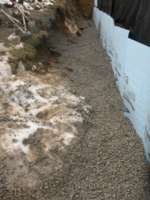

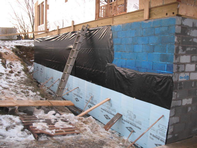

I've pretty much completed all the backfill around the basement walls (sorry, no pics yet...). I've left some space around one side and the back side of the house as I plan to put in another perforated drain pipe just below ground level to run my gutter downspouts into. Once the gutter are on, I'll install this pipe and cover it up.
Once we get the insulation in, we'll start on the drywall! Moving right along...

Why are you going to use perforated drain pipe? Won't that cause a big moisture problem? There is going to be a lot of water coming from those down spouts.

You know what, that makes sense. Maybe I should use a solid pipe. But it would seem that most all of the water will run through the pipe and out the end as opposed to through the perforations. But undoubtedly some will. I might have to rethink this...

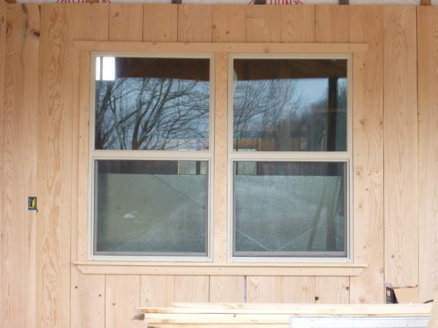

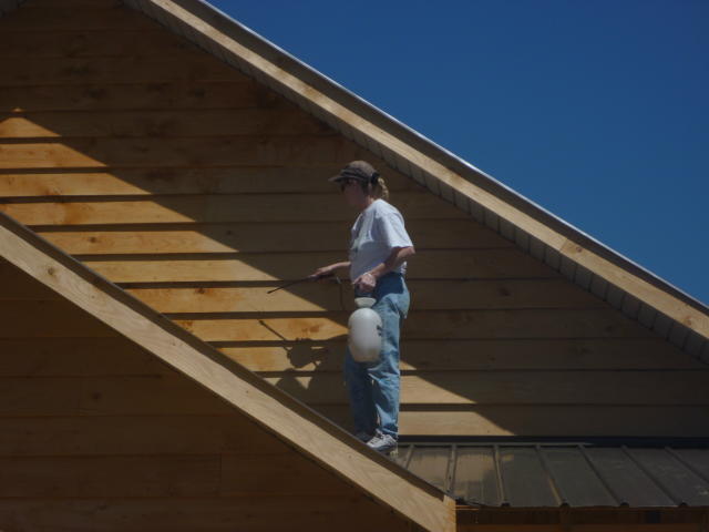

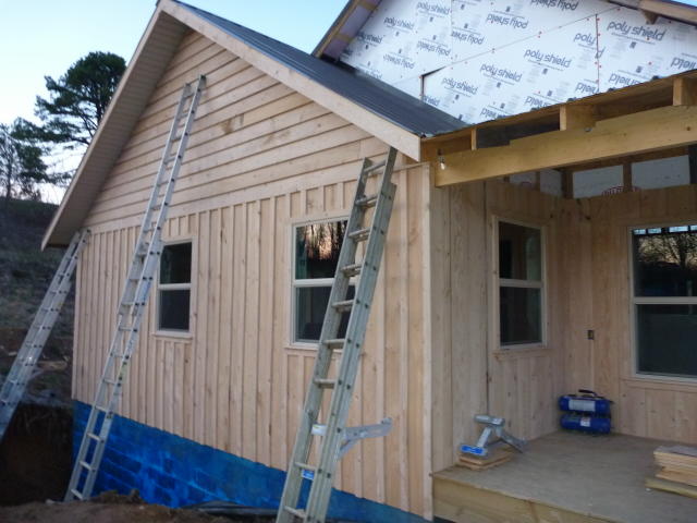

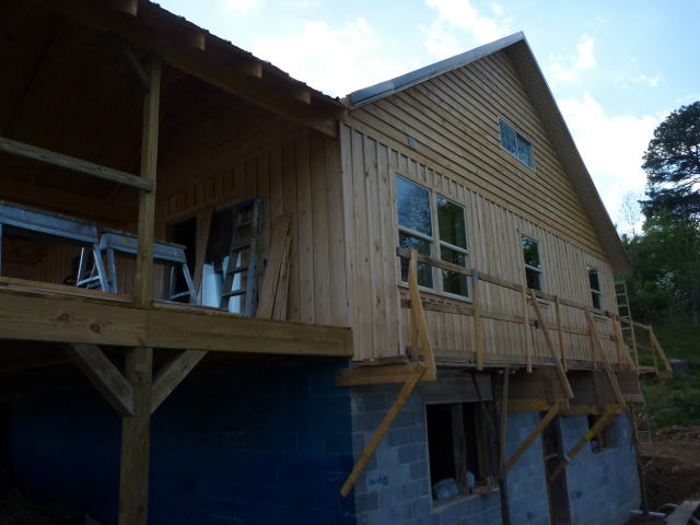

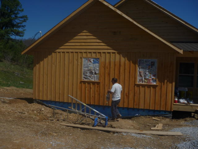

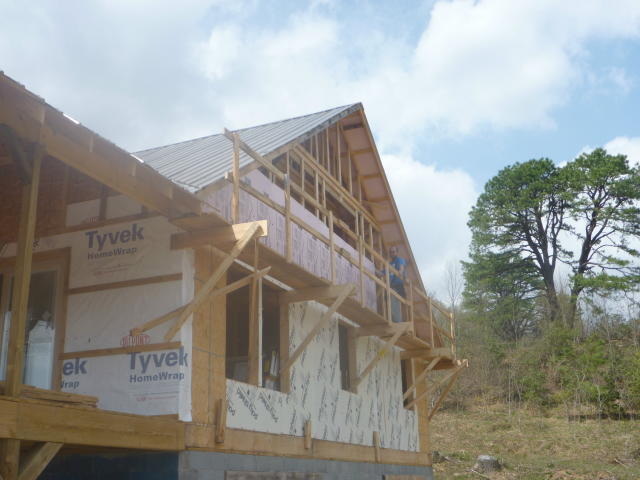

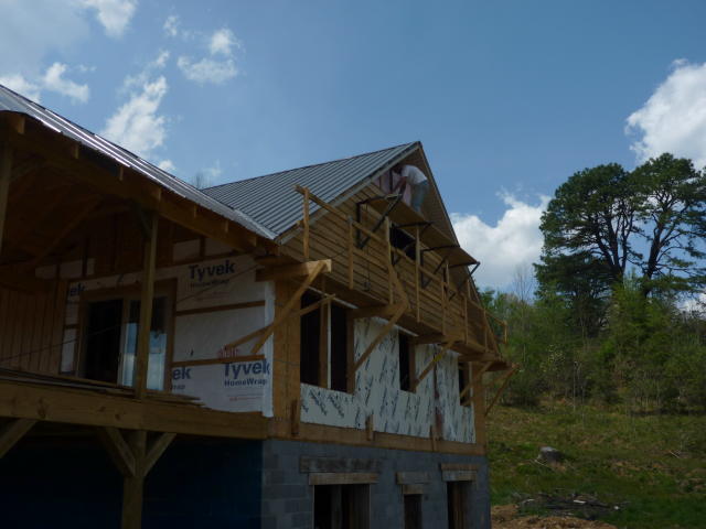

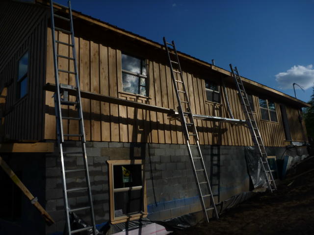

Some pics of the siding in progress. The 2nd pic is of the scaffolding we had to build in order to get up on the high side. That peak is probably about 30' off the ground. The 3rd and 4th pics are of us spraying the siding with clorox water prior to staining. Unfortunately, we didn't around to actually staining that day and still haven't. The weather isn't cooperating. It has to be above 50 degrees for at least 48 hours after staining...

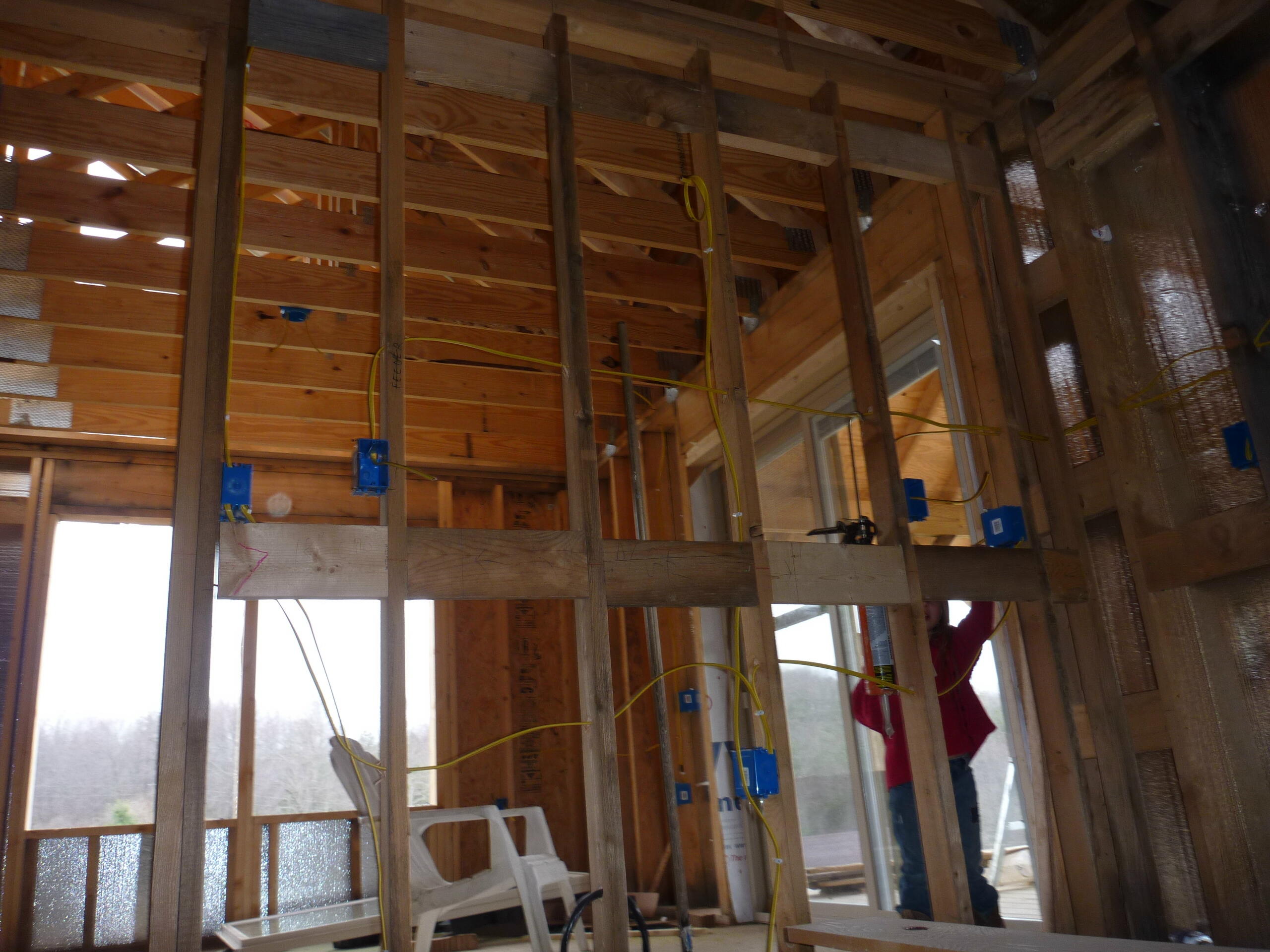

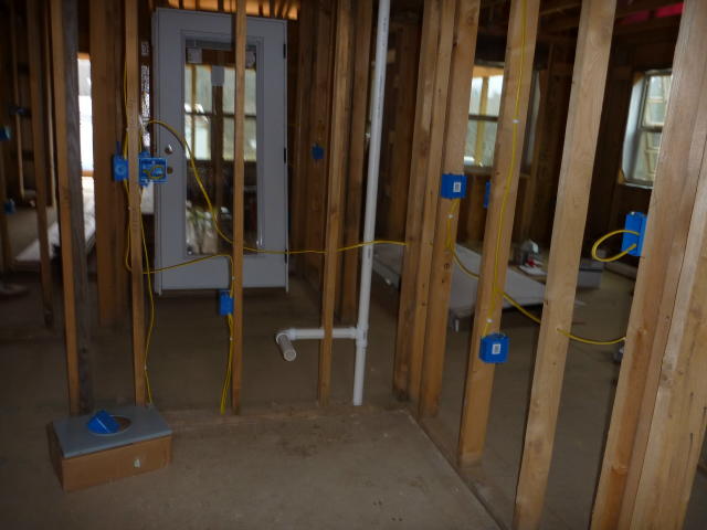

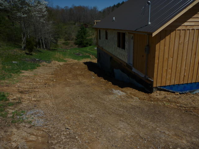

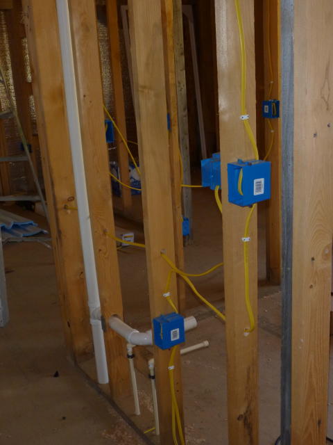

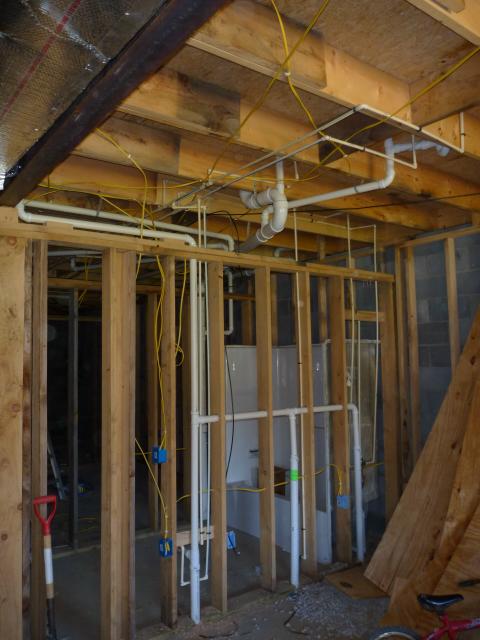

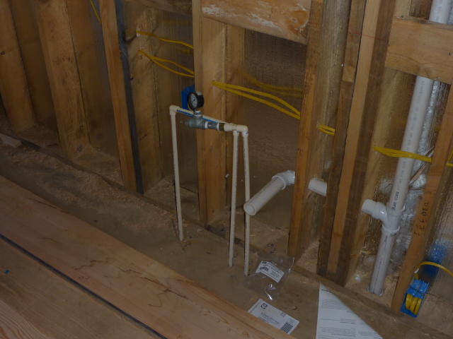

A shot of the back of the house after I didn't some initial grade work. The others are of plumbing and electrical work. The 4th pic is in the basement. There will be a drop ceiling to cover it all.

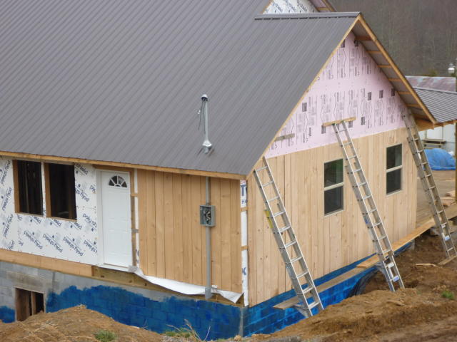

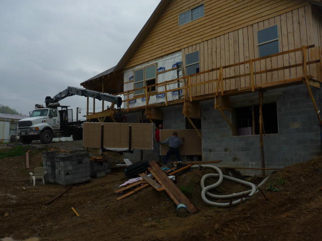

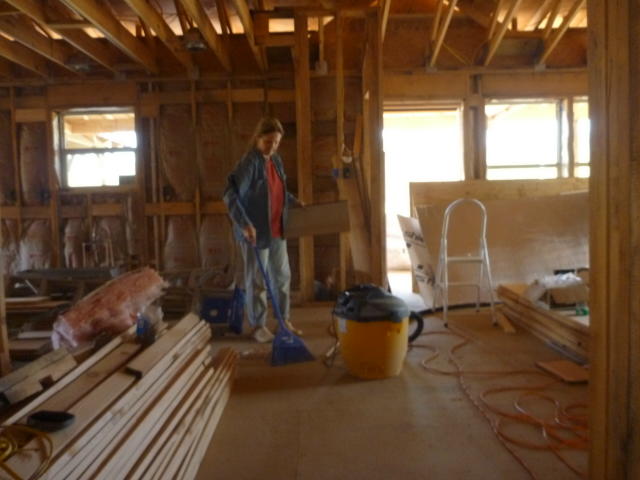

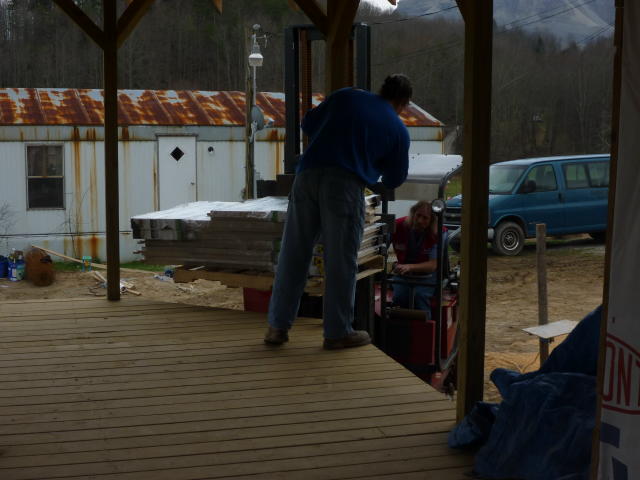

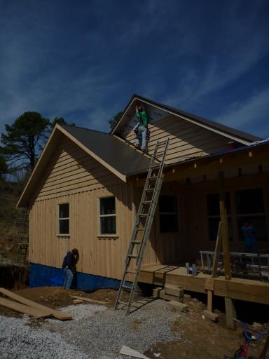

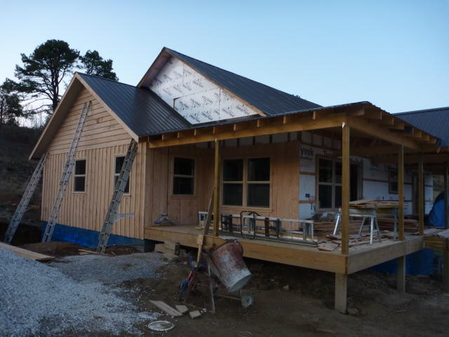

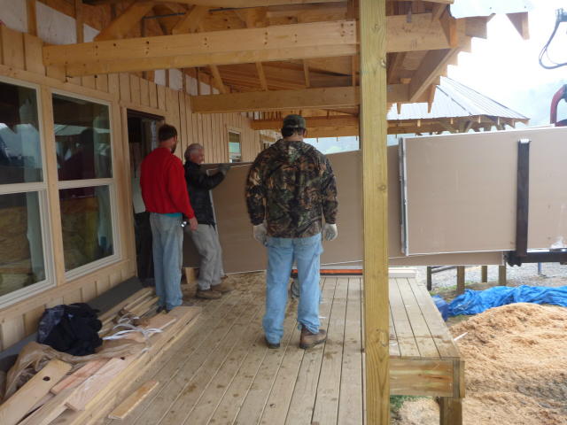

Pic 1 is of the siding going up on the gable end. Pic 2 is something we've done a lot of...cleaning up. I don't know how we'll ever get all the dust out of the place, and we've only just begun the drywall. Pics 3 and 4 are of the drywall delivery. It was a rainy day, but we got it in with no issues. The boom truck helped a lot!

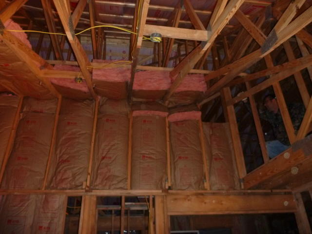

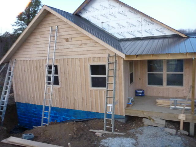

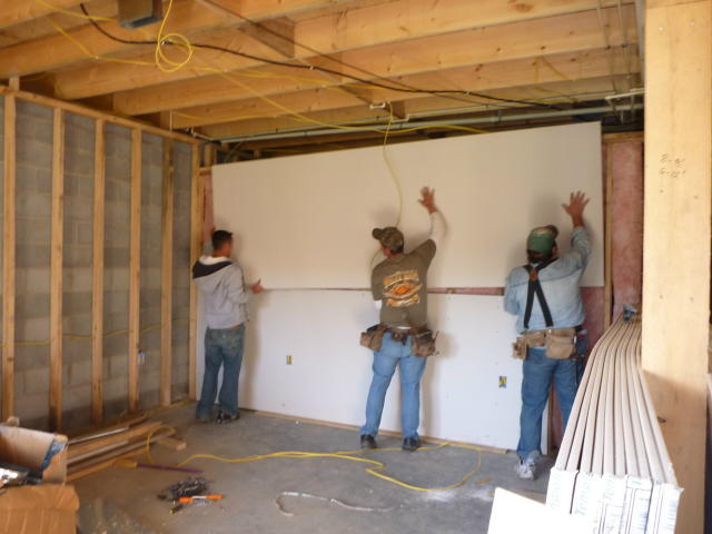

Insulation going up. All of that is done now. The drywall contractors on the job hanging some up. Siding on the back and the high end of the house is done.

Going to go with a solid pipe instead. Thanks for the tip!

The house is looking really good.:thumbsup: I like the look of the board and bat siding with the beveled siding above it.:thumbsup:
