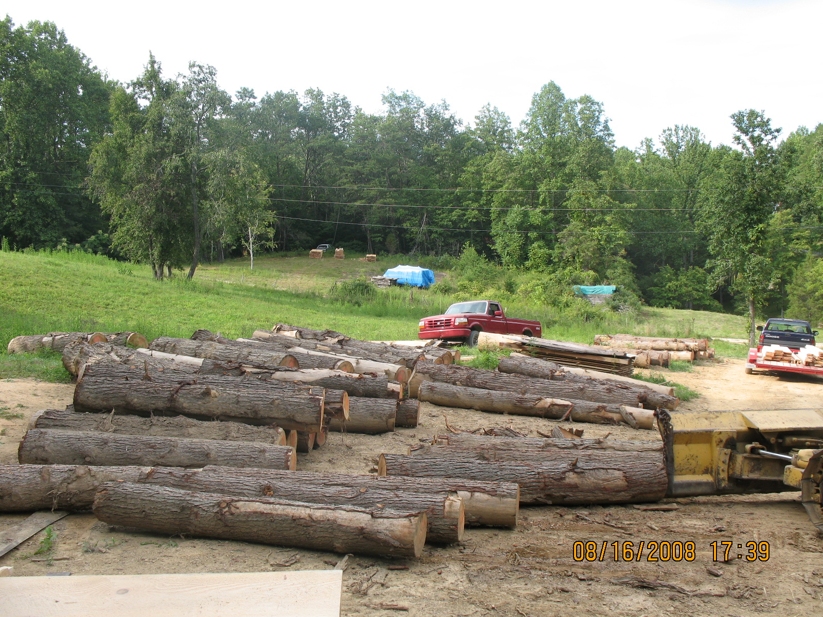

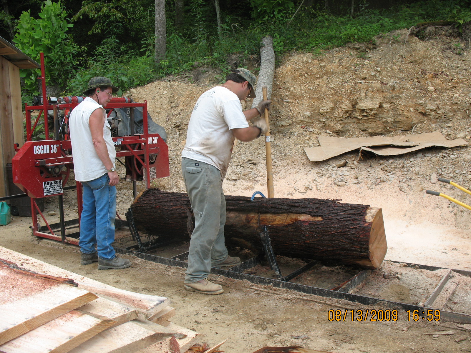

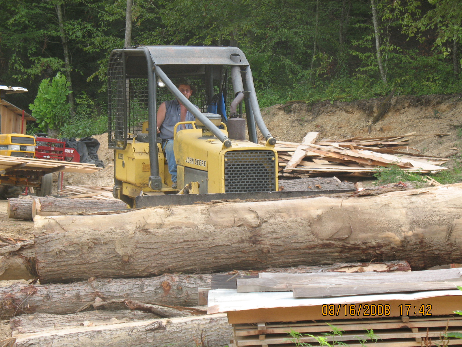

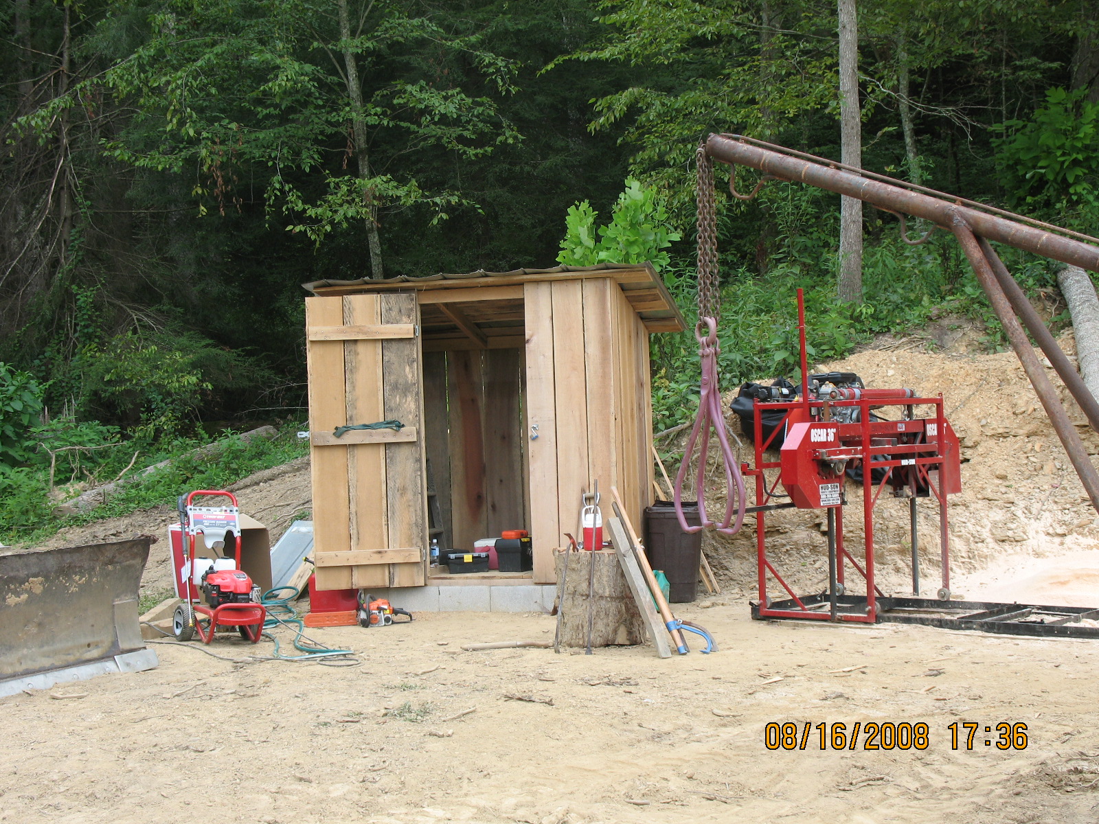

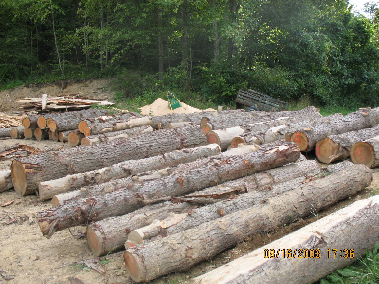

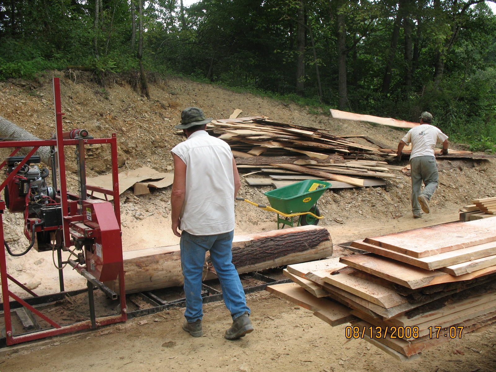

The sawmill operation.
Our process was to bring the usable portion of the tree out of the woods once the limbs were removed (and hemlock has A LOT of limbs!). At the lumber yard, we'd cut the logs to the estimated length of the boards we wanted. We'd peel the bark off with crowbars and wash the logs with a pressure washer. Then we'd put them on the mill.

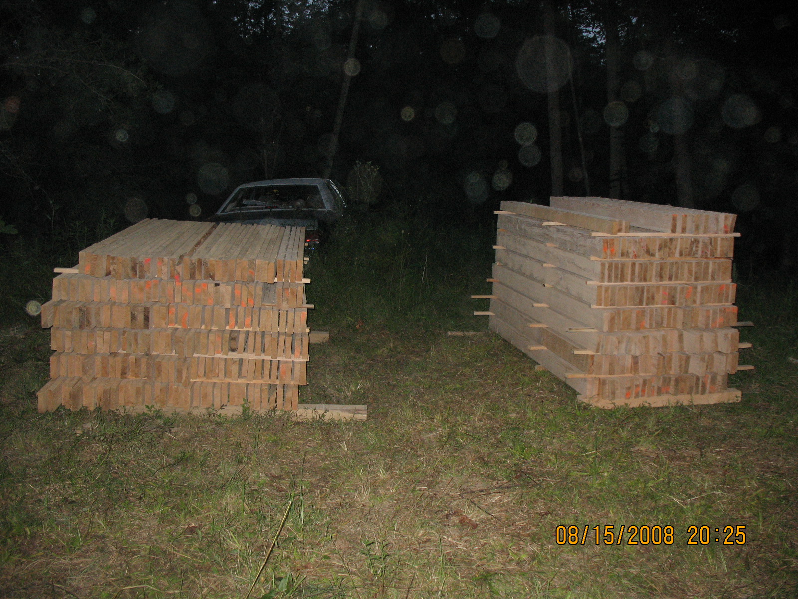

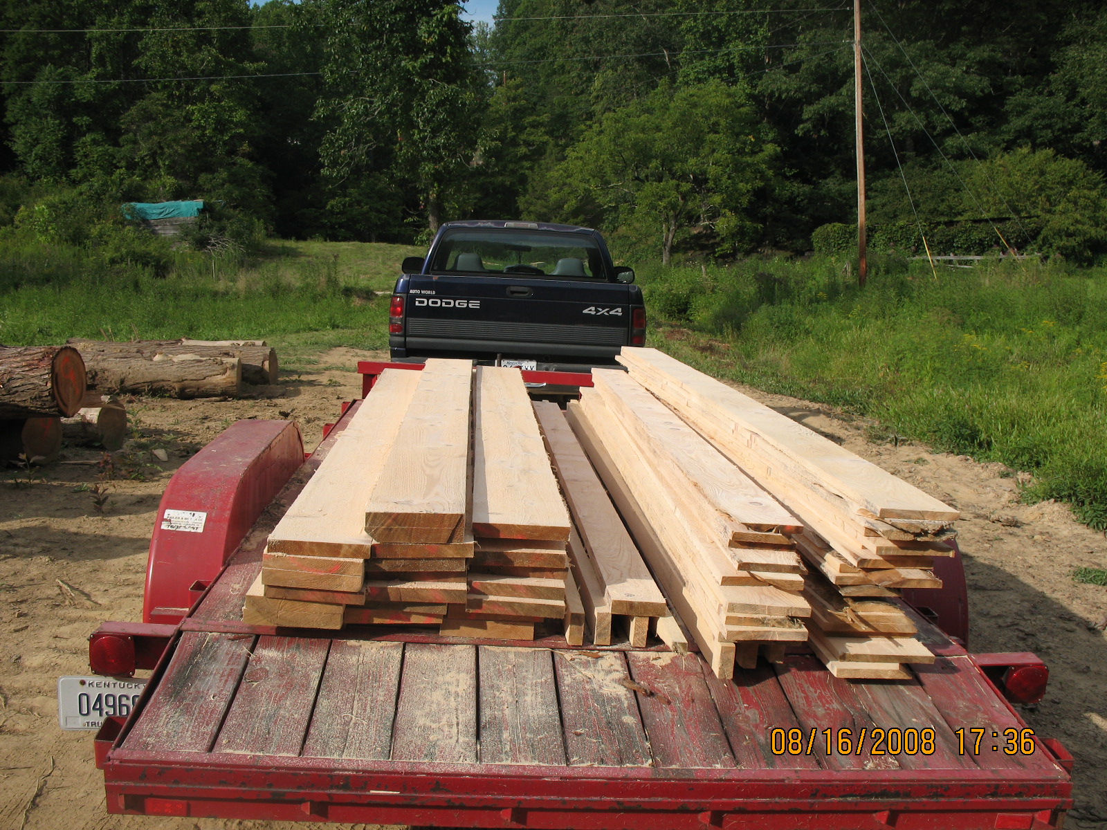

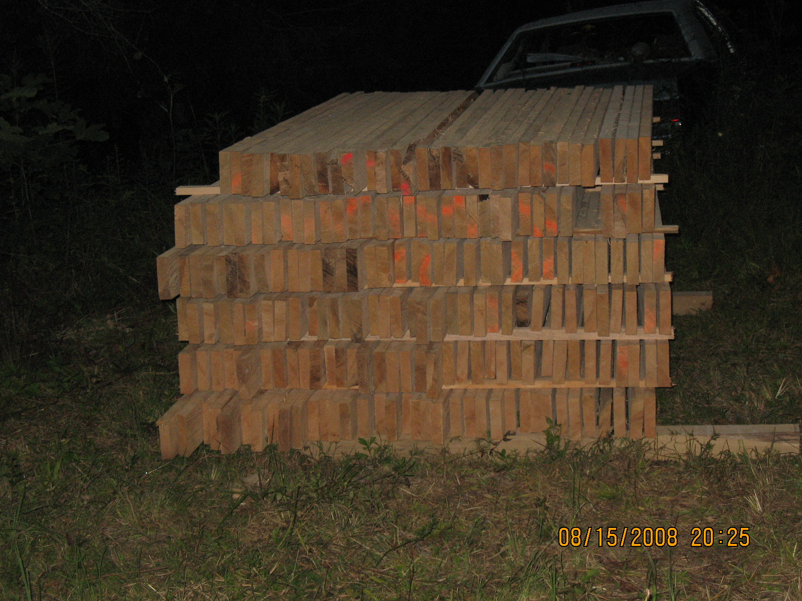

The finished product...stacked and stickered. That's just some of it...

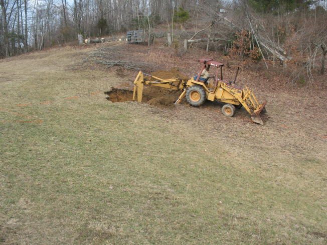

After about six months of waiting, we finally broke ground in February of '09.

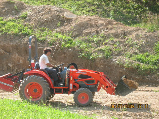

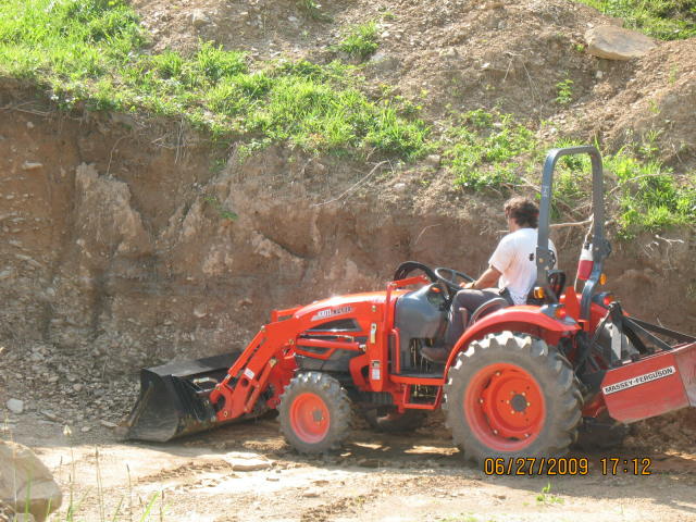

During last summer, while trying to figure out how to get financing for the house, I passed some of the time cleaning up the house seat with my new tractor (FUN!!). At one point, you could have played a tennis match on the house seat it was so smooth! :thumbsup:

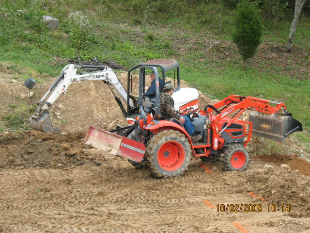

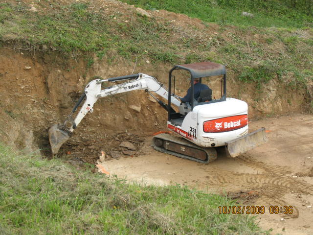

/ Our House
#11

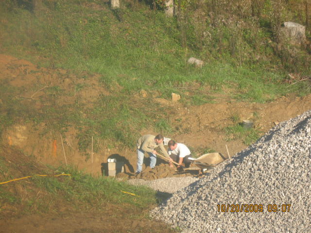

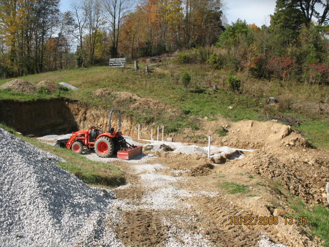

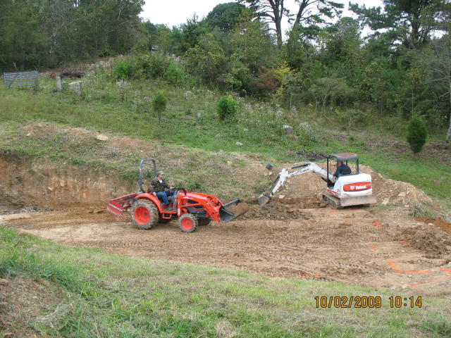

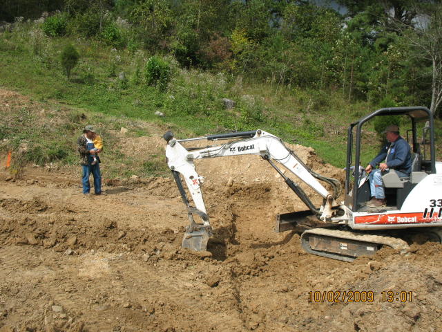

In October of '09, we finally started digging the footers...

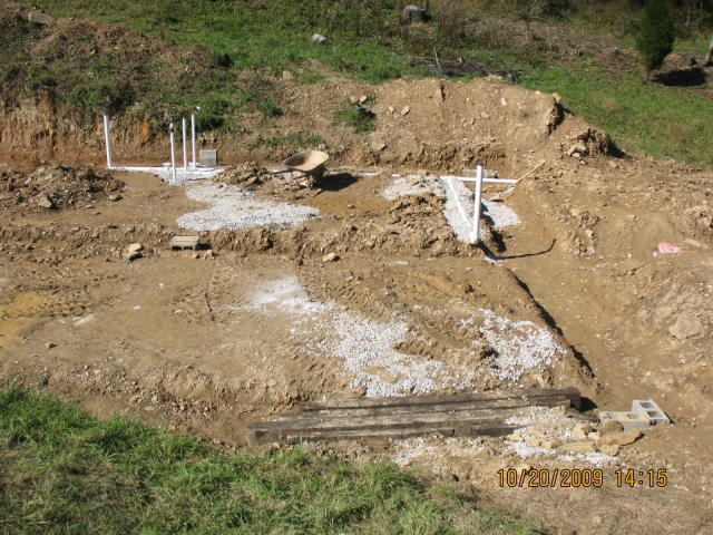

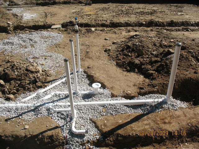

/ Our House
#12
Next, the plumbers stubbed in the plumbing...

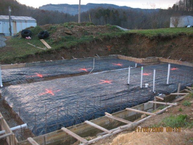

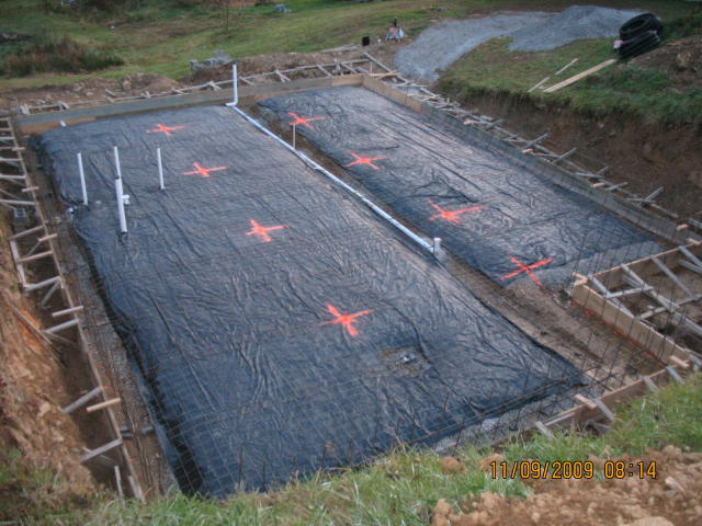

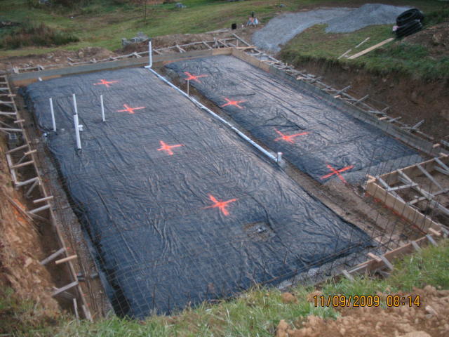

/ Our House
#14
The gravel was spread and levelled, with plastic laid down as a water barrier. We put a copy of the Holy Bible in one of the footings.

You have a good-looking set up. I like how you've to it raised off the ground. My father-in-law set 6x6 treated posts in the ground (bedrock sandstone) and attached the rails to it. It works pretty well, but we noticed that when it rains a lot the tracks can get out of plumb just a little and the boards will be slightly thicker on one end than the other. We figured that the wood was absorbing water and swelling.
Here's a funny story...one Saturday we went into the woods and cut down an absolutely enormous hemlock. It was every bit 3' in diameter at the base. We worked all day on that tree, cutting it down and limbing it. It was on a very steep incline on the mountainside so we had to take our time and be careful. Anyway, we finally hauled it out of the woods to the mill. We got the bark off of it and put the first (thickest) part on the mill. That was a chore in itself!. We were very anxious to see just how much lumber we could get out of it. Well, we started sawing it and noticed that the wood was very soft. It was like styrofoam. I could embed a hammer a good 6" into the wood. We thought it might clear up, so we continued to cut. It never did clear up. We inspected the rest of the tree and found the same thing...the wood was like styrofoam. We wasted the entire day on that log.
