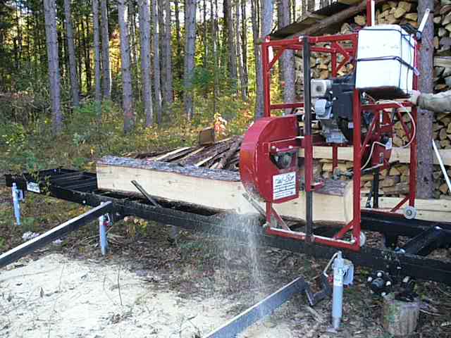

You have a good-looking set up. I like how you've to it raised off the ground.
I added an extra 10' so that I can cut up to 19' logs. I like having the jacks so when the ground does shift{from season to season} all I have to do is make a couple of turns and I'm back in the game. I've also built a shed at one end so that I can just push the head into it and not worry about weather.
Here's a funny story...one Saturday we went into the woods and cut down an absolutely enormous hemlock. It was every bit 3' in diameter at the base. We worked all day on that tree, cutting it down and limbing it. It was on a very steep incline on the mountainside so we had to take our time and be careful. Anyway, we finally hauled it out of the woods to the mill. We got the bark off of it and put the first (thickest) part on the mill. That was a chore in itself!. We were very anxious to see just how much lumber we could get out of it. Well, we started sawing it and noticed that the wood was very soft. It was like styrofoam. I could embed a hammer a good 6" into the wood. We thought it might clear up, so we continued to cut. It never did clear up. We inspected the rest of the tree and found the same thing...the wood was like styrofoam. We wasted the entire day on that log.
I hear that loud and clear, did the same thing last year. The tree was so big I even had to trim it so it would sit on the mill{over 36" diameter}. Made a huge cant and then started working through the log{we wanted wide boards} center was garbage. What a waste of time plus all the crap we went through loading onto the mill. We did get a couple of pieces of wood but not even a 1/4 of what we should have :(. Sometimes them big logs can be deceiving.

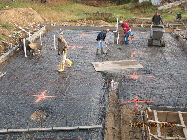

#24

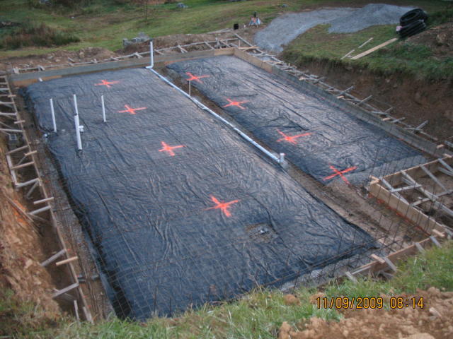

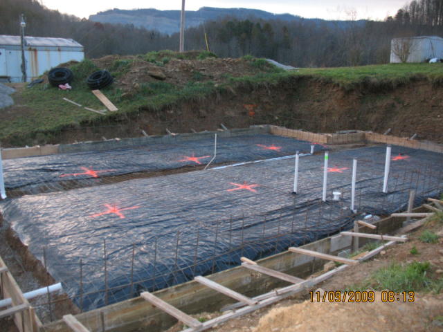

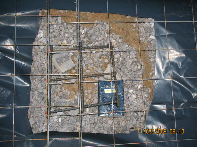

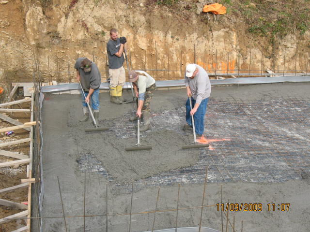

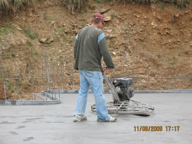

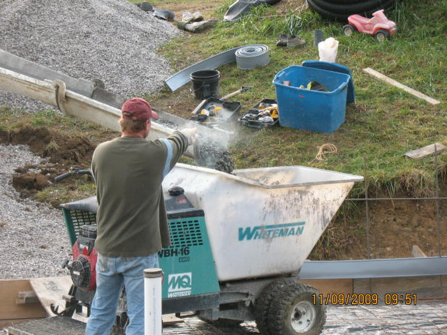

Pouring the concrete...
We used 64 yards of concrete!! But those guys were great. They got it all down in 1 day, came back the next day and took down their forms.

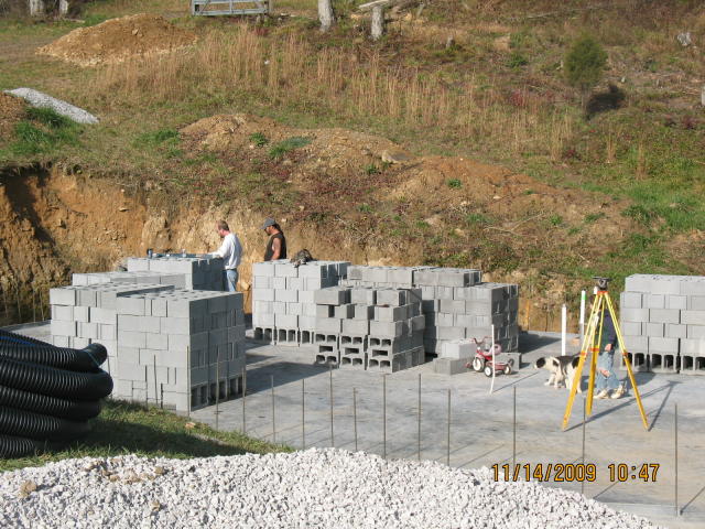

   / Our House
#25

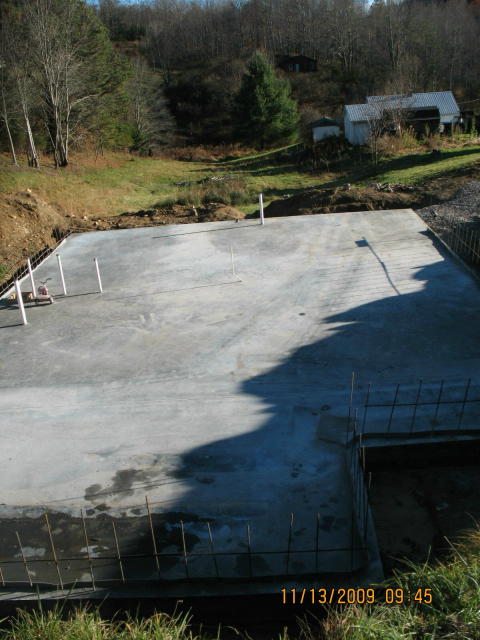

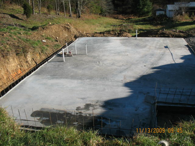

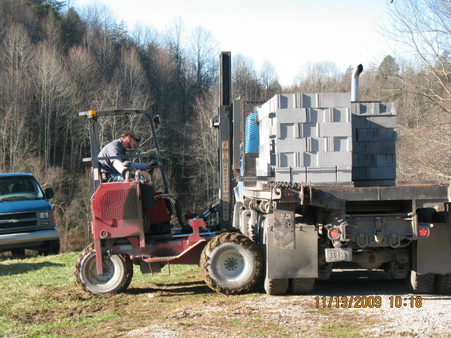

The finished slab and delivery of the 12" concrete blocks for the basement.

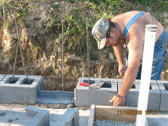

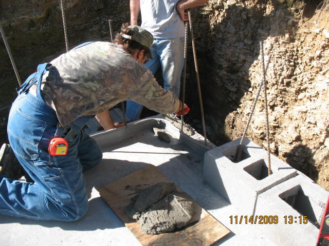

   / Our House #26
I'll have to say, in all my years of building, I have never seen a basement slab poured as part of the structural foundation.
Typ the foundation wall is laid on the footer, with a floating slab 4"-6" above that, so any water that gets through the wall is UNDER the slab, not on it ?
Nick
   / Our House #27
Nick
I have to agree Nick Ive only seen one similar but the walls were poured and besides the rebar up in to the wall there was a key below wall section and a plastic dam cast in to that key and the walls were poured spanning the key/dam any vertical joints in the poured walls had the same arraignment rebar key and dam material and it haven't ever leaked
tom
   / Our House
#28
Nick
We did install what they called a "water stop" in the slab which is a 6" wide strip of rubber that goes around the entire perimeter of the slab. About 2" of the strip is embedded in the concrete and about 4" sticks up. We then used what was called "knock out blocks" for the first run. There is a picture in an earlier post of me cutting notches out of one of these blocks to set down over the strip. We then filled the entire first run of blocks with concrete to give it extra strength. Actually, we filled all the blocks that were below grade about halfway up the wall (5') and then filled the remaining cores on 42" centers with 2 pieces of 1/2" rebar per state code.
Thanks for the feedback!
   / Our House
#29

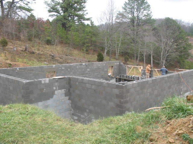

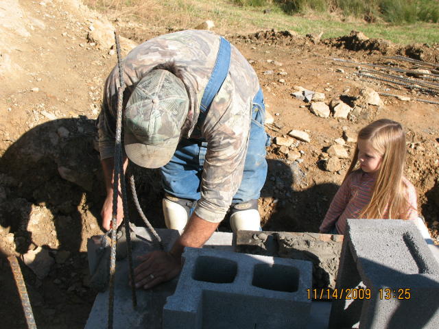

Laying the block...

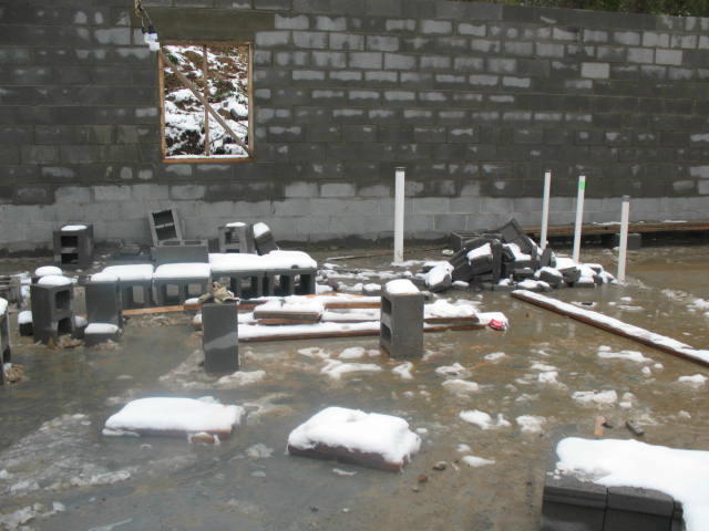

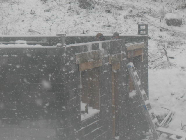

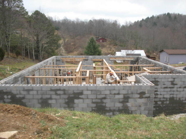

The final blocks are laid...
This was on Dec. 5, 2009. As you can see, it was snowing pretty hard. And the weathe just got worse and worse as the winter wore on. This has been the worst winter to try to build. If there wasn't a foot of snow on the ground, it was so muddy you needed webbed feet to move around. But I take my hat off to my builders. They came snow or shine. He's originally from Canada, so I guess he's used to it. :D

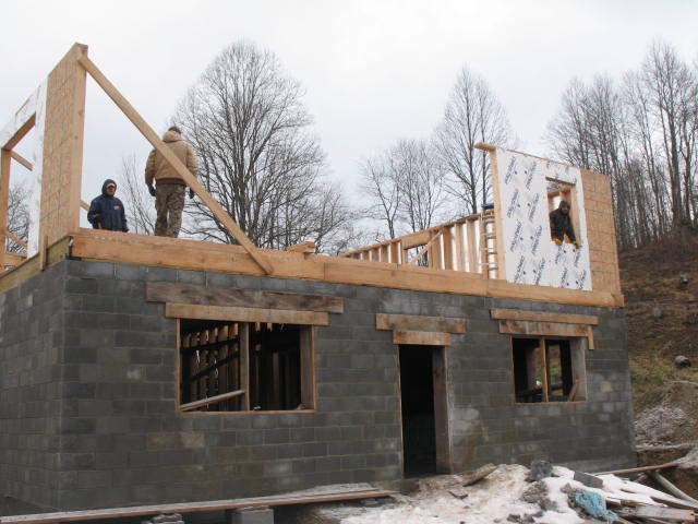

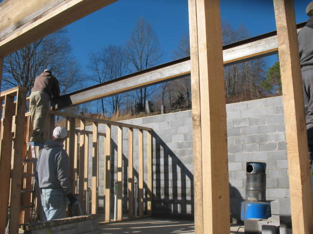

Interior walls in the basement complete. I had to use some I beams to span 2 wide areas down there.

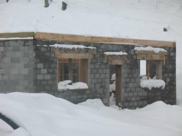

Then, on Dec. 18, we had a huge snow storm. Most everyone in the region (eastern KY and southwest VA) were without power for at least a couple days. We were without power for 4 days. Some went as long as 2 weeks. We were lucky I guess. It was a very wet, heavy snow that snapped trees like twigs and downed countless power lines. We had electrical crews from all over the eastern part of the U.S. here trying to restore power. A big THANK YOU goes out to those guys. They worked their hind-ends off. :thumbsup:
But my good ol' Canadian builder was right back at it as soon as the power was back on.

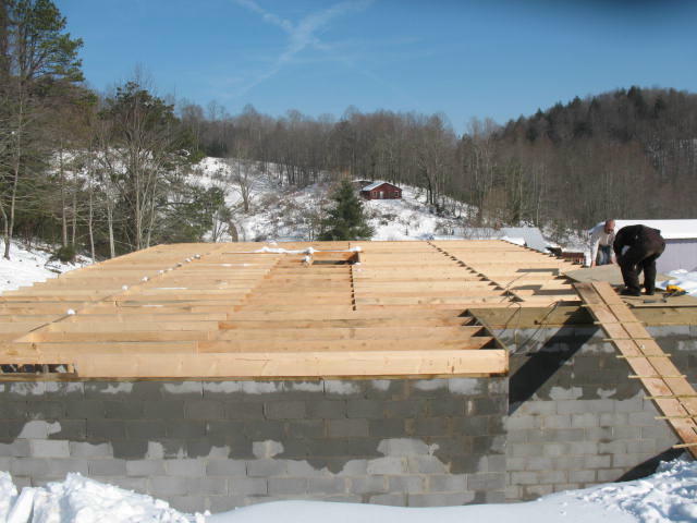

With the basement walls up and the joists in, it's time to start laying the plywood flooring. We used 3/4" Advantec. That's some good stuff! Been wet as Brazil (without the heat!) here this winter and it's held up very well.

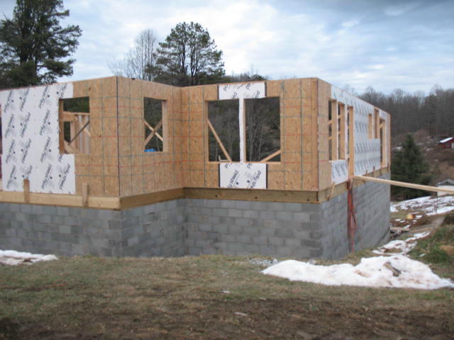

#35

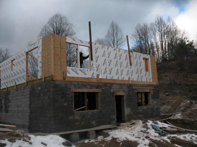

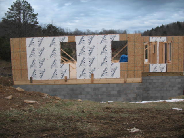

Exterior walls upstairs going up...

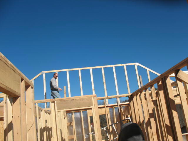

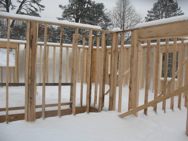

   / Our House
#36

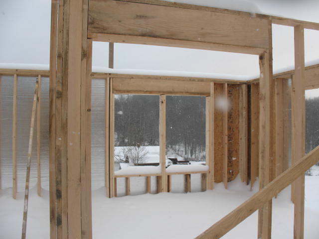

Jan. 5. Interior walls are going up. Yes, it's snowing...again. Just one of many snows we got this year. From Dec. 5 to about March 1 there has been at least some snow on the ground. My little girl liked it though! :laughing:

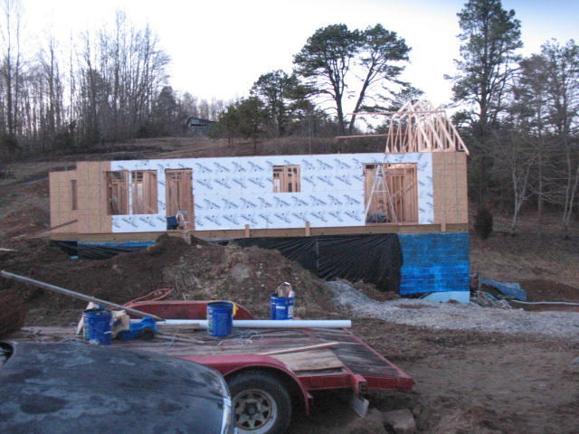

   / Our House

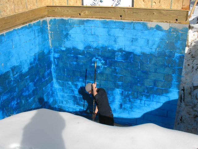

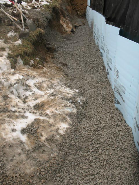

#37

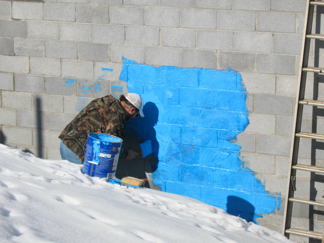

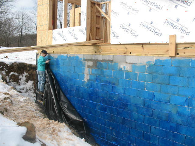

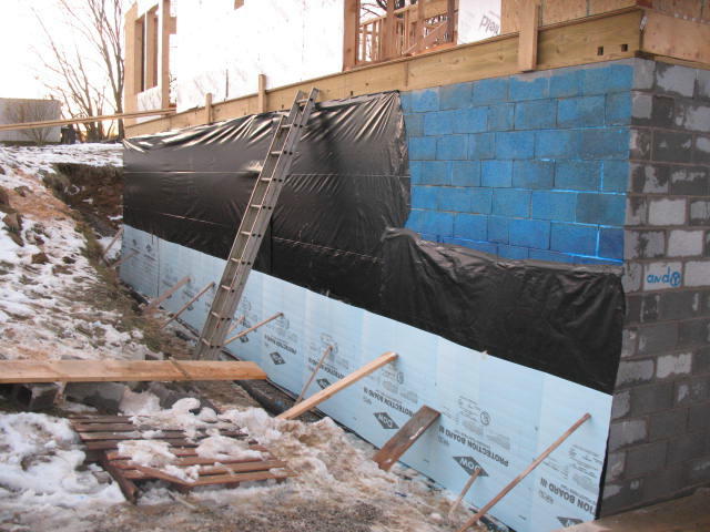

On Jan. 14 it finally warmed up enough to paint the basement walls with the waterproofer (Ames Blue Max). It got up to 50 degrees that day! (After a 10-day stretch of never getting above freezing...a new record for this area). We put 2 coats of Blue Max on, 2 layers of 6 mil plastic, and 1/4" extruded styrofoam protection board. Better not leak!!! ;)
My only concern would be the morter possibly freezing and not curing properly. Even so, there are ways to do it and he very well may have done what was needed to protect it.

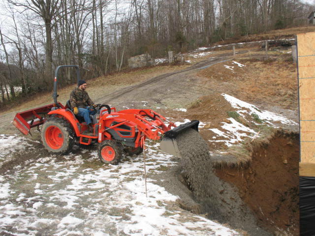

#39

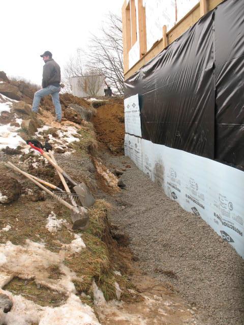

Next, we started the backfill. We had to do the front of the house first since there will be a porch there...and the porch was next in the construction process.

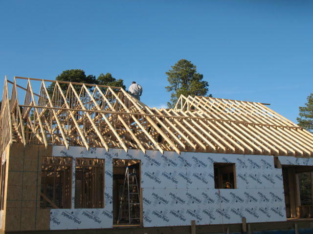

   / Our House
#40

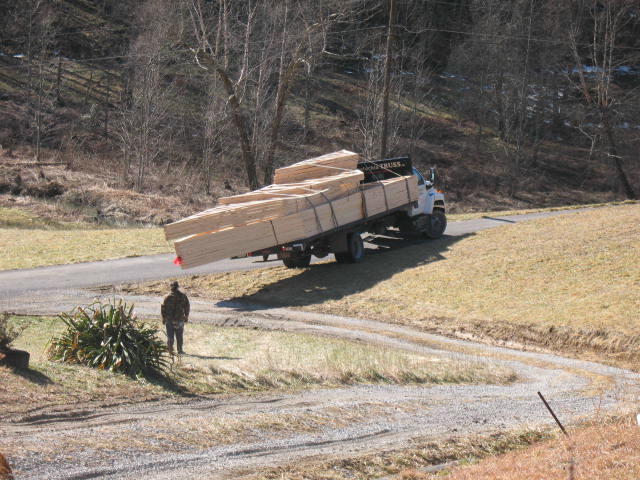

The trusses arrive. We went with attic trusses over about half of the house. We ended up with a 14'x27' attic room. The trusses, which are 8/12 pitch, were too tall to be transported whole. So, the truss manufacturer sent the bases and the tops that we assembled on-site.
