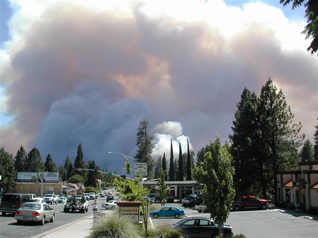

Yep, that Concow fire is nasty.
Most of the businesses in Paradise are closed due to smoke,even if not in the evacuation zones. Ever seen a K-Mart close? I heard they moved their inventory to Chico (maybe just a community rumour?). Even Wells-Fargo & BofA closed.
The fire is still 4 or 5 miles from us and tho headed directly this way there's still a river/lake to cross before we'd burn.
Without TBN I likely wouldn't have bought the machine I did (PowerTrac 422) and therefore wouldn't have been able to clear the amount of brush I have. If the fire makes it this far I have reasonable expectations that we'll survive just fine, again due mostly to 'seat time' over the past couple of years. Were it not for "the book" and this site I could have spent my money on a much less capable machine.
